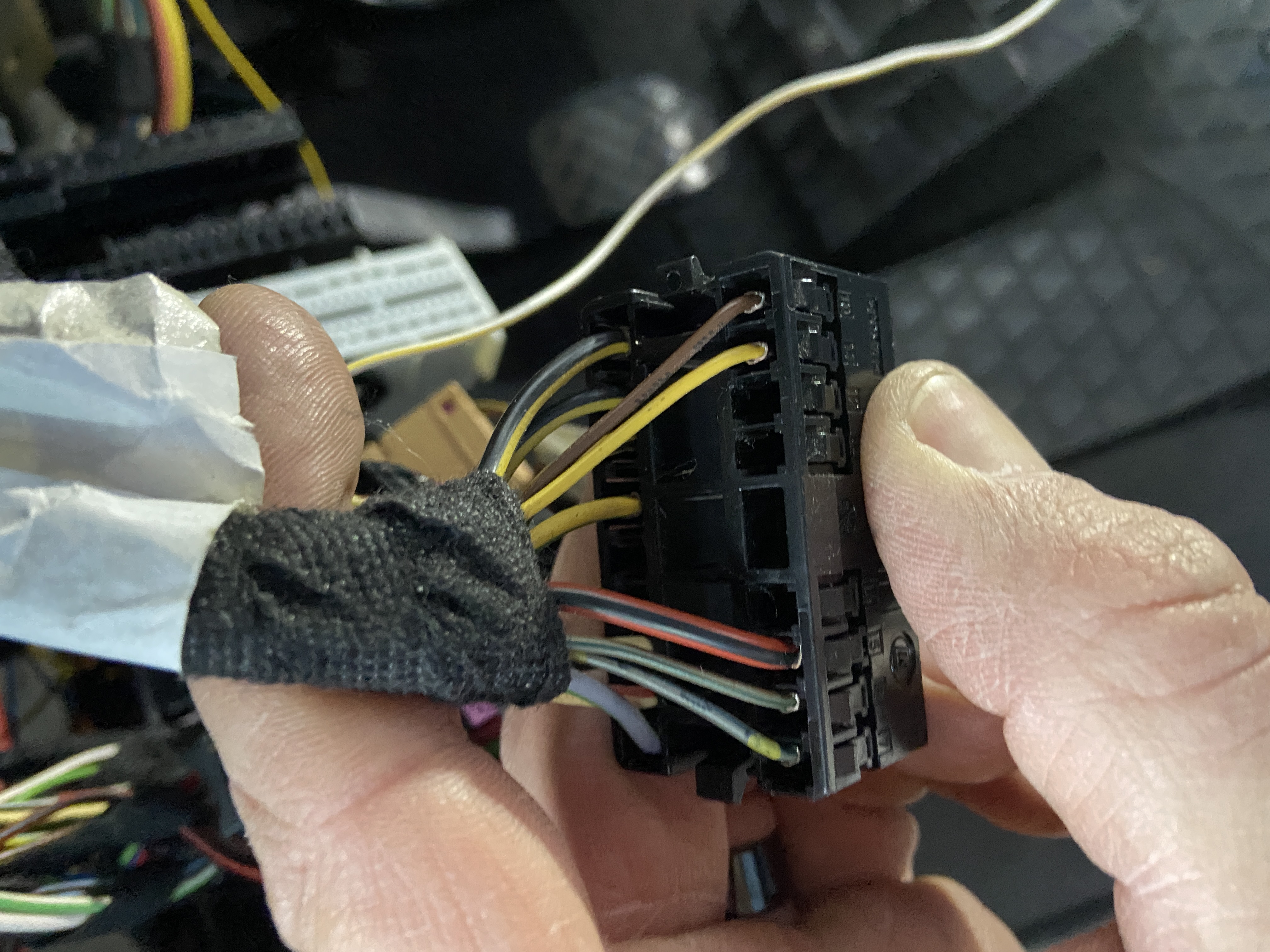

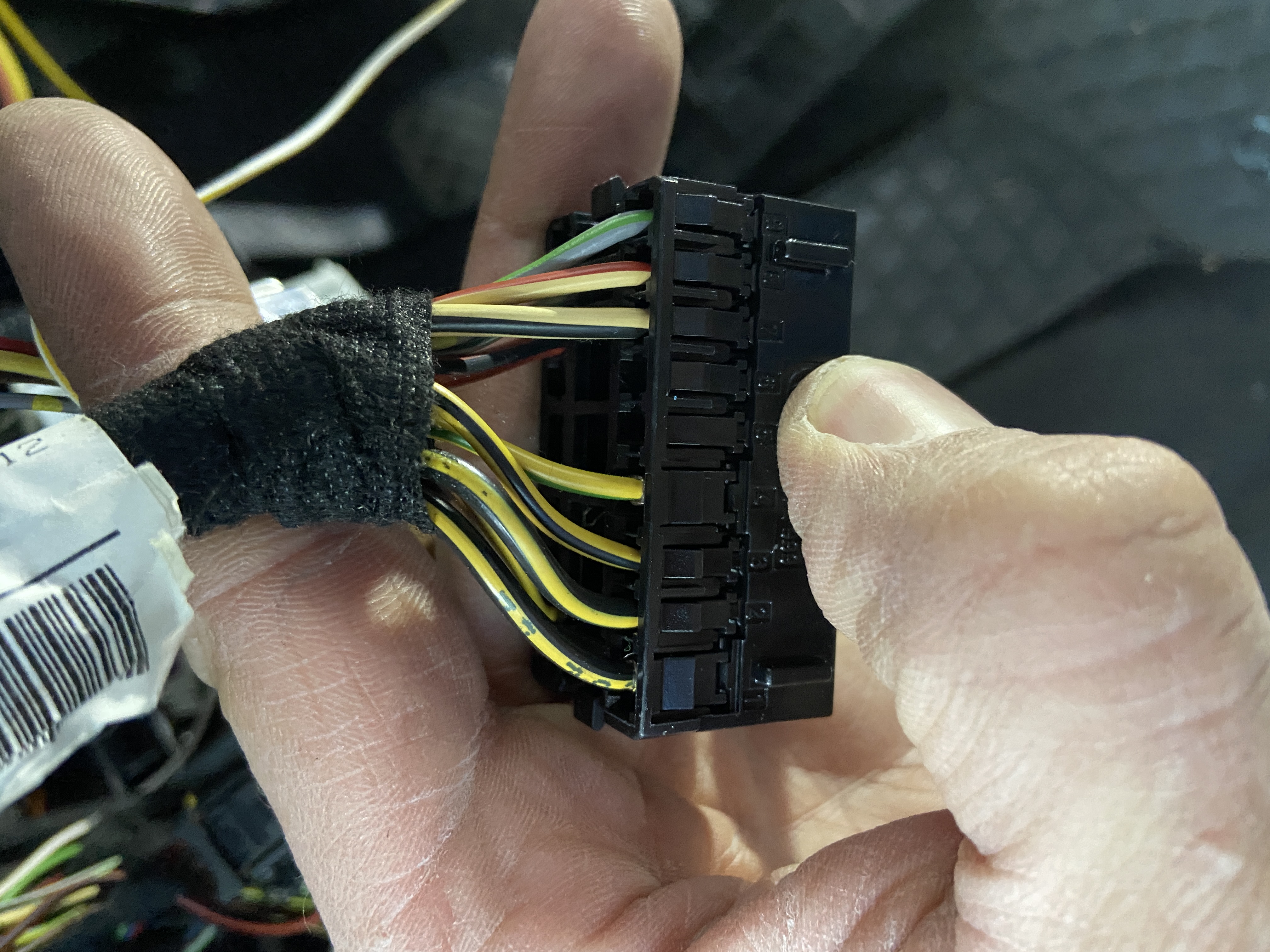

Hello everyone,
my name is Cristian and I have a 2014 t5.
In this forum i found a lot of valuable info for the modification i'm doing on my t5 even if i think i've done something wrong.
I went from BCM 7H0 937 087 M to 7E0 937 090 B, I powered it as indicated by Ciclo, which I thank, and I followed the guide by fitting the wiring for the modified bi-xenon and the car lights wiring.
I purchased the lights control 3C8 941 431A and the dimmer 6Q0 941 334.
After having installed everything I see that the dimmer does not work and with the light switch in the positions the ignition is turned on without having the keys inserted. In addition, now I also have an error on the control unit 8
the bi-xenon are still on their way and will arrive soon.
hope you can help me solve my problem
I had installed the photochromic mirror and the rain light sensor in the past.
t5 with standard h7 headlights.
below some photos and scan of t5
Friday,18,February,2022,10:43:46:20530

- Posts: 8982
Hí.
It seems that you have not done this procedure correctly. Replacement
http://wiki.ross-tech.com/wiki/index.ph ... eplacement
Please post an old Autoscan with BCM 7H0...087 installed.
edit: Please link me to the guide you have followed for your electrical installation.
