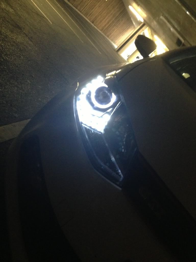

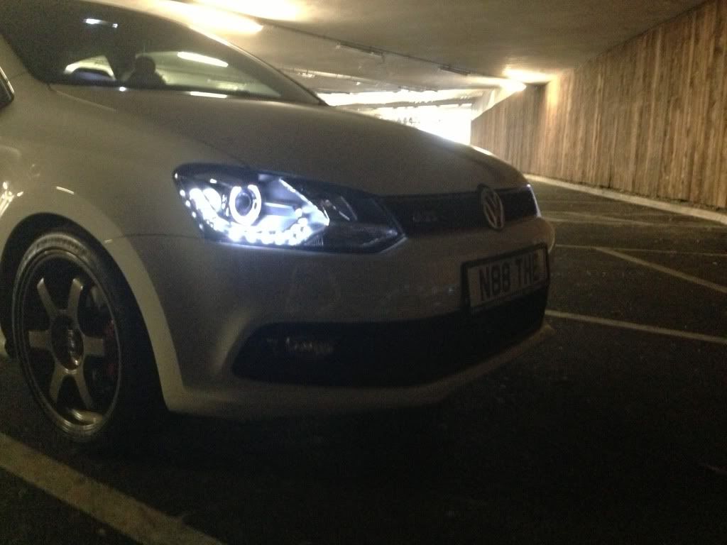

Just taken delivery of my special order straight from the factory!! OEM style LED xenon headlamps. They make such a huge difference to the front end of the car. Looks awesome. And having the hid's installed in a proper projector headlamp makes driving of a night much better. Anyway, i shall let the pictures do the talking
And a quick video
And a quick video

No sorry pal, took me ages to get hold of someone in order to get these. Had to have them specially built for RHD as all others are LHD. I told them there was lots of people asking for these and they said they would look into selling them. So keep an eye out for them!
- alexperkins
- Site Admin
- Posts: 14874
Re: NMavs's Candy White Polo GTI - Retro-Fitted Xenons
They look like dectane dayline headlamps?
Yep, but dectanes are only for LHD
