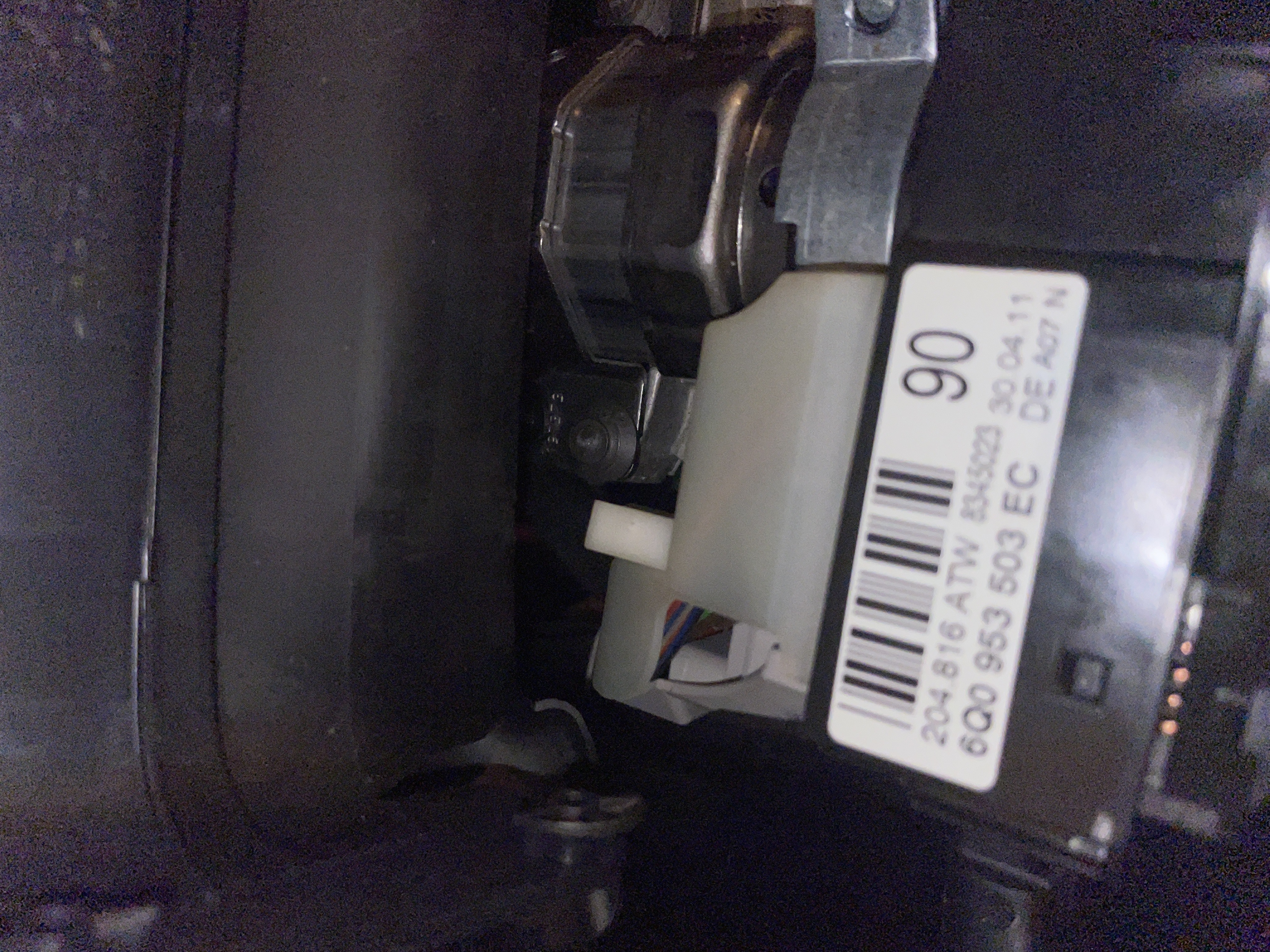

you can just take off the whole assembly with the switch and the slip ring assembly. it has one black allen bolt on top, on the aluminium ring.
then undo the white/grey L shaped plug, and it will all come off in one go.

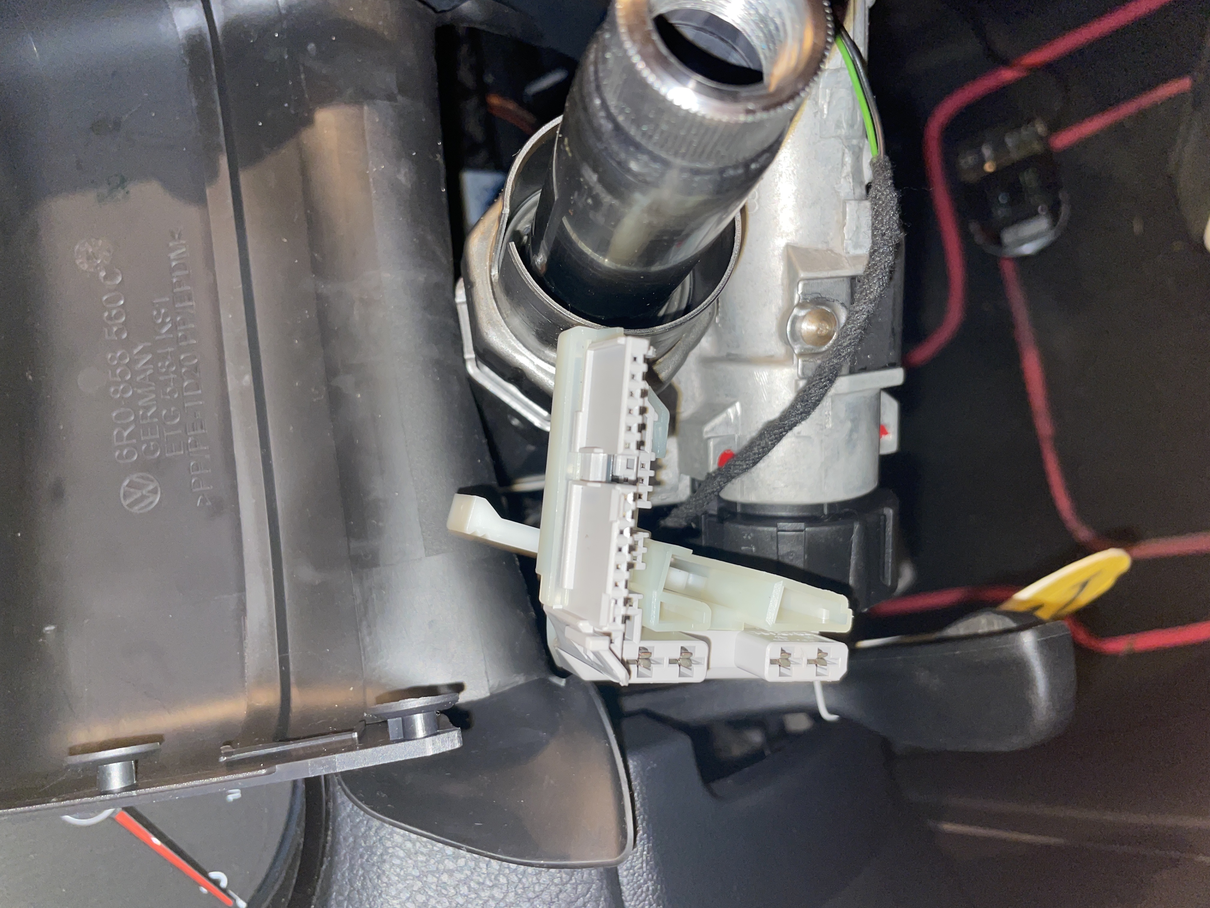

how do i remove that white clip from the back of the stalk? is there clips that have to be undone?
Re: 6c headlights onto 6r ?
Look for a square locking tab on top and pull it upward.

this is what i’m currently looking at but i can’t see a tab to pull

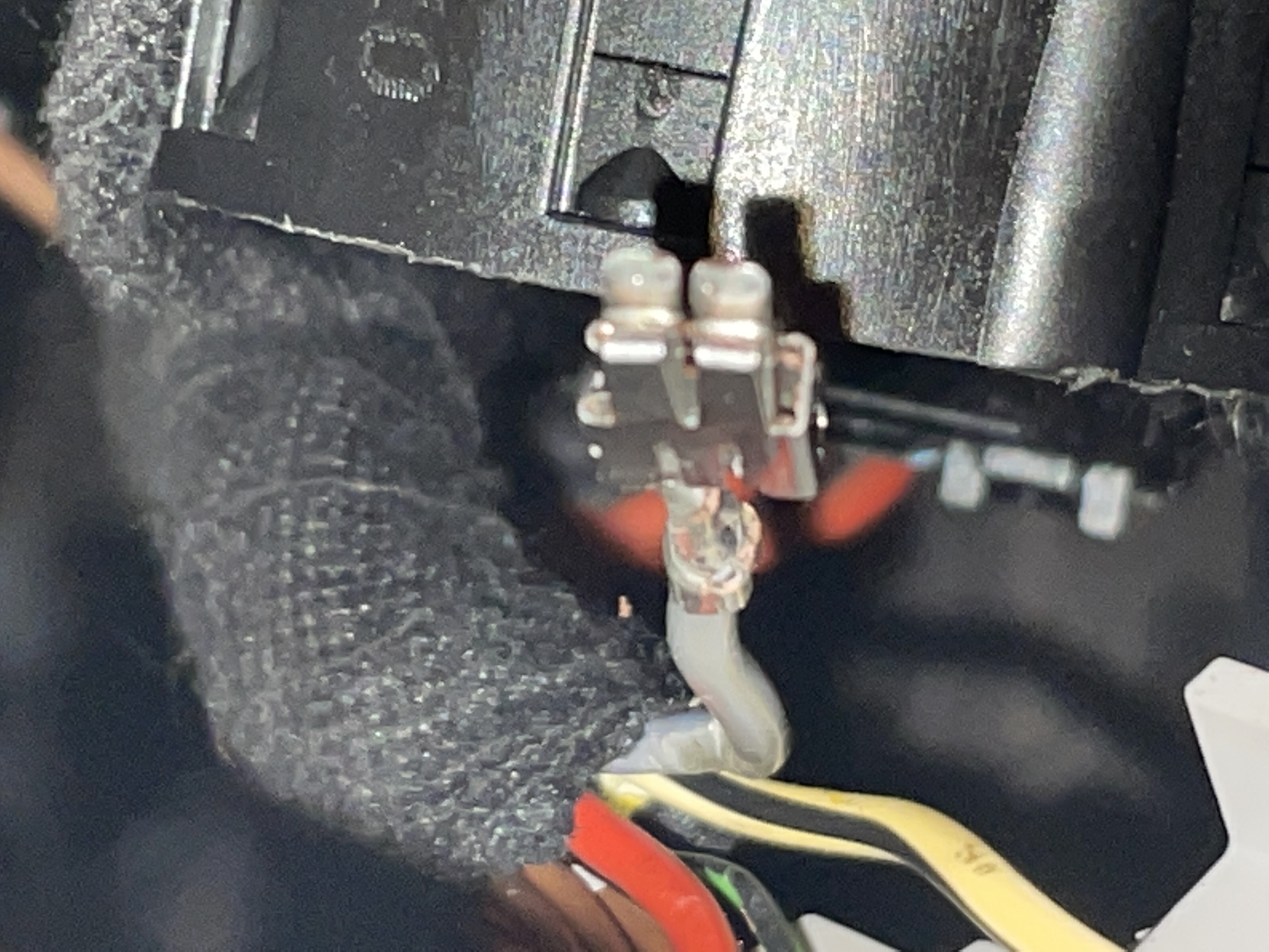

done :mrgreen: now, where / how do i get to the grey wire that i need to remove, thankyou for your patience by the way :roll:
looks like you can just push it out now. it's one of the four vertical ones on the left.
