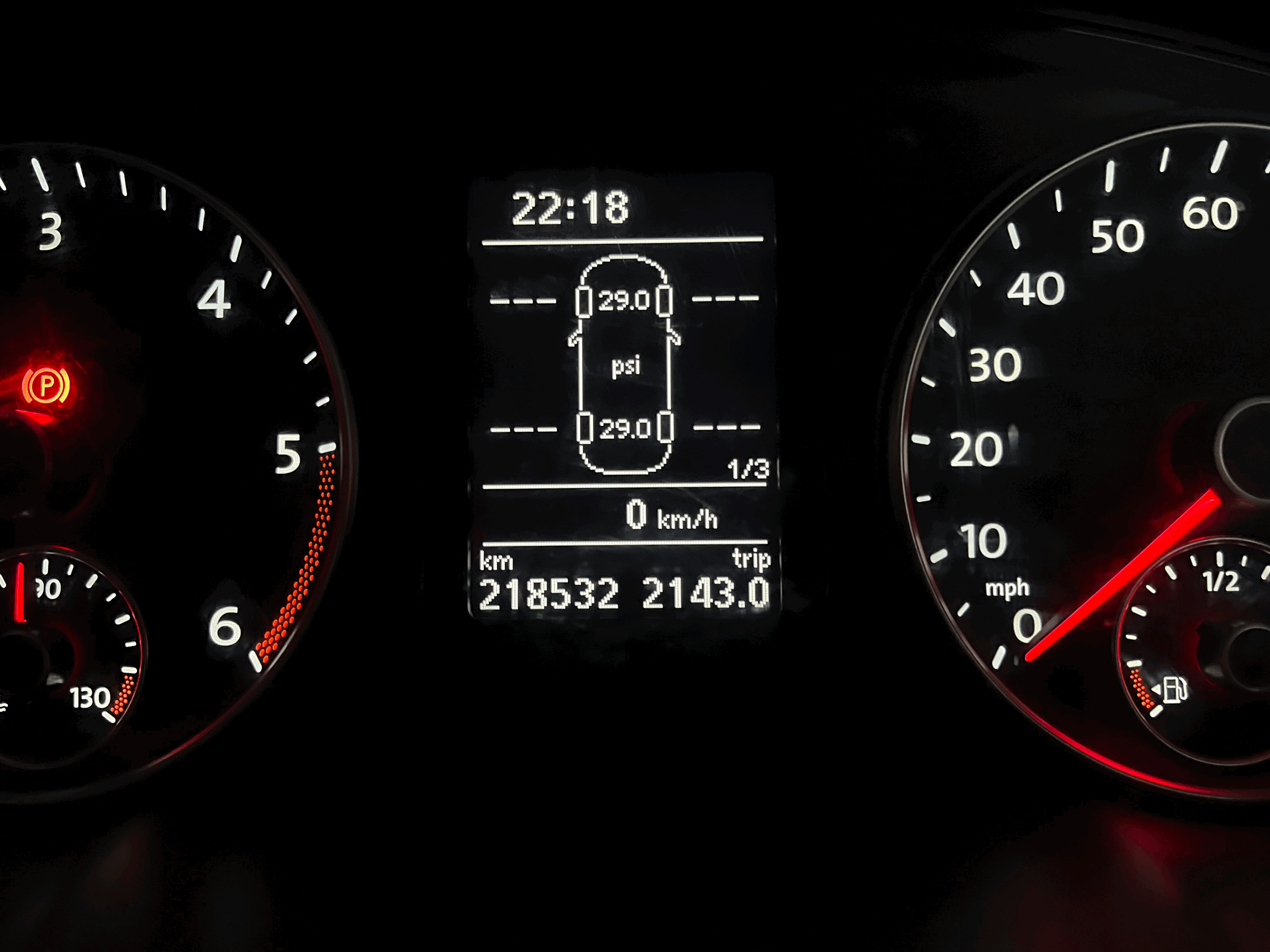

Once the new parameters are loaded, you should take the van for a short ride until the TPMS unit receives the signals from the wheel sensors.
For me it worked once I had traveled about 100 m, but there are people who say that they had to do a few km.
Then each day, or each new ride, you have to wait to go a certain distance for the tire pressures to update on the MFD. Tire pressures are highly dependent on the temperature of the tires.
I can no longer live without this invention. :lol:

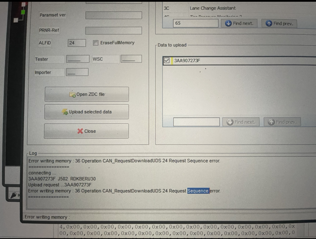

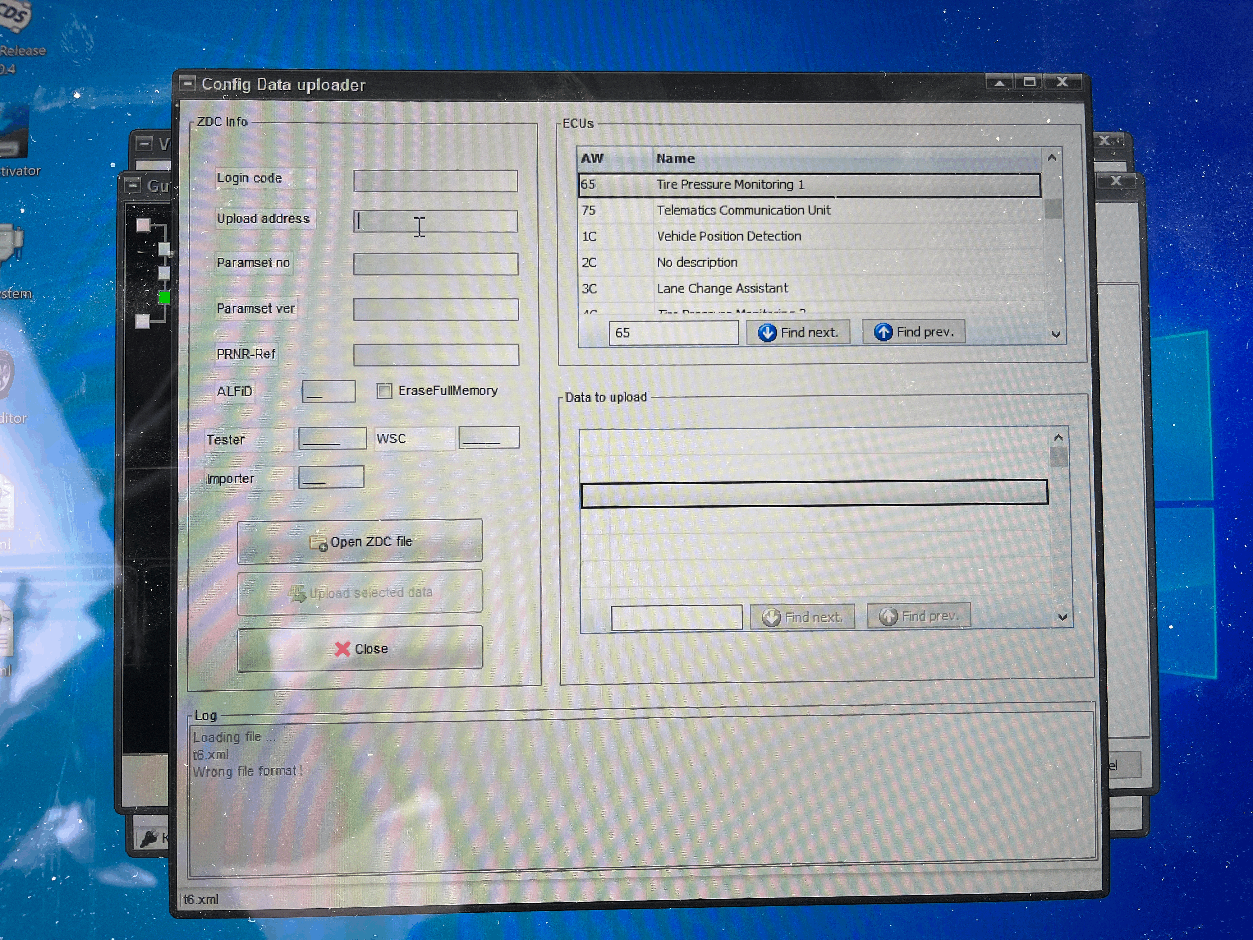

Yesterday I have tried the RDKS editor, But VCP didn't accept the file (wrong format) as seen in the pic
today I have tried the github, VCP had accepted the file, but another error had came when writing the file
Posts: 8976
Re: BCM Max Transporter 2013
You have to check the box where it says 'EraseFullMemory' before clicking on 'Upload selected data',
and everything will work like a charm. 🧙‍♂️

What do you mean 'still no numbers on each tire'? In what conditions? Do you have a picture of what you want to say?
If you have the 'Vehicle Status' menu selected in the MFD, the first image you see (always) when you turn the key in the ignition switch is with the wheel pressures in this "---" state.
Until you start to move with the van, the numbers-pressures will not be displayed. The control unit has to receive the signals from the sensors (orange) you installed on the wheels, and this only happens when the wheels are in motion.

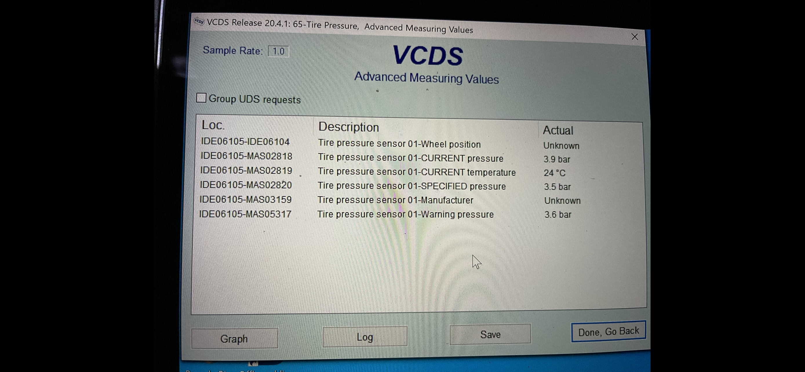

I have traveled with my car three days, but the number pressures never came up, I have tried to re-flash the TPMS unit, reload the zdc file with the parameters, but still the same
According to VSDS all sensors are working probably

From the information you've provided, it looks like the tpms module is unable to determine the wheel position in which sensors is present.
Where have you placed the tpms module?
In advanced measuring values of address 65, the sensor location should be displayed, see mine below.
Posts: 8976
Thank you very much for the more than clear explanation.👌
Robert, a great guy and also a user of this forum, developed a thread on the T6 forum about installing direct TPMS on T5/T6.
Due to the same symptoms you are having, some users found that the placement of the TPMS unit (for vans) is very important so that it can receive the signals from the wheel sensors properly. They determined that it should be in an external and centered place.
You already have the correct TPMS unit and sensors for your van (instrument cluster), read the last pages of Robert's thread, or the entire thread if necessary.
:arrow: https://www.t6forum.com/threads/direct- ... ost-222702 maybe here is the solution 4U.
Thanks so much for the info
I guess I will try different place for the sensor
