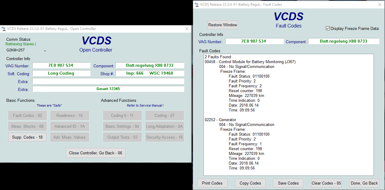

Error in module called Battery regulator. I did not have visible this module before and it cannot be unchecked in installation list. I tried to locate J367 control unit and I don't have it. It seems that this is related to start-stop system but I don't know how to disable it (I have unchecked everything related to start-stop in BCM long coding). Maybe this is also reason for the Control Module Incorrectly Coded in CAN gateway.
enable 61 in installation list, set the coding of the module to all 00, and then remove it again from gateway list. that will clear the errors for the BEM

iichel wrote: Mon Jan 22, 2024 9:17 am enable 61 in installation list, set the coding of the module to all 00, and then remove it again from gateway list. that will clear the errors for the BEM
Thank you! It does the trick. I forgot to check the coding of this module. It does not allow me to set 00 everywhere, but there were combobox with option that I don't have installed the regulator and I also unchecked other start-stop related options. So CAN gateway no longer shows incorrect coding error and module 61 disappears from the list.

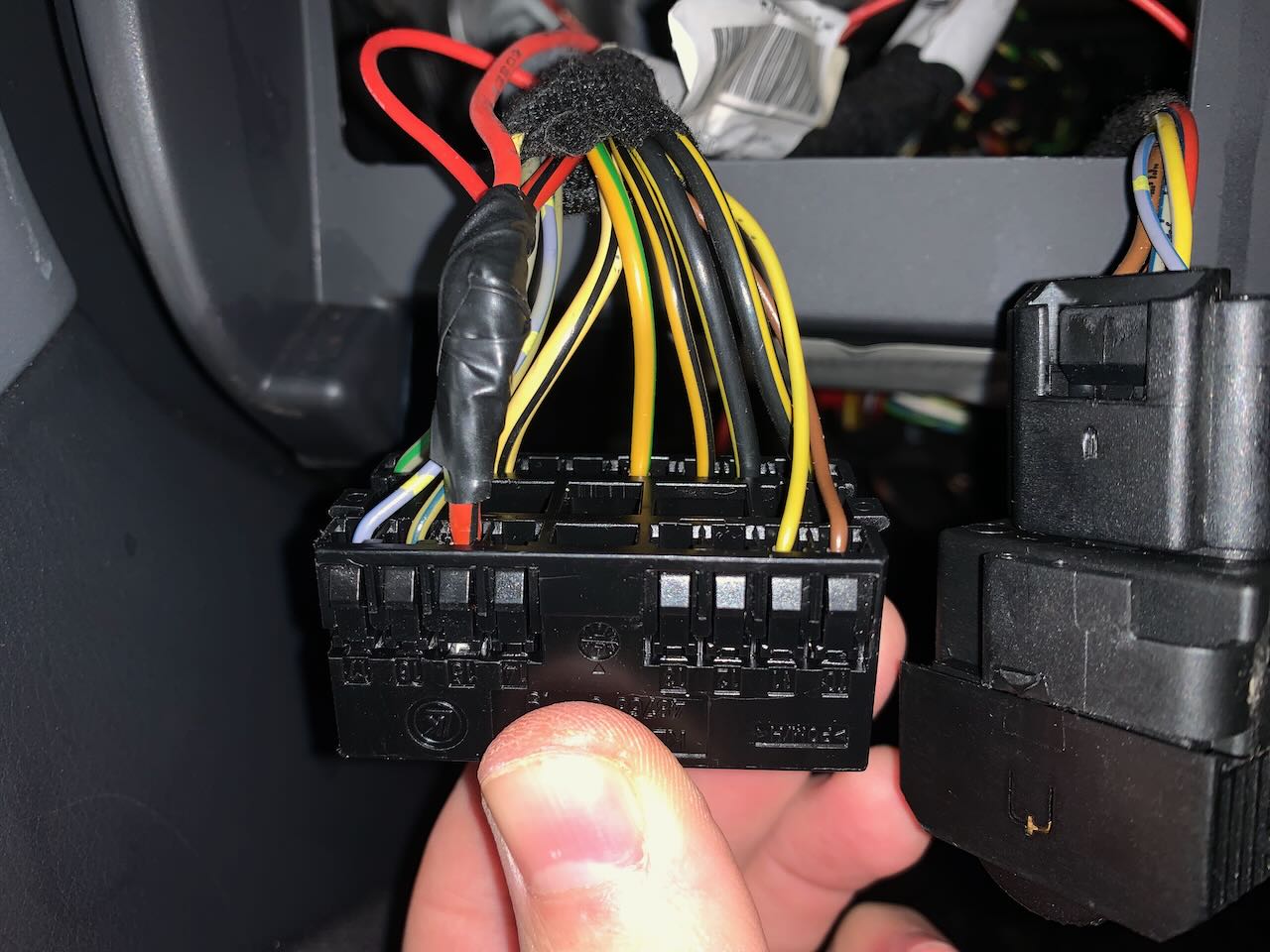

I made some progress with installation. I created all the wirings and plug it into bcm, fusebox, light switch, etc. I have double checked everything, but I'm stuck with this issue:

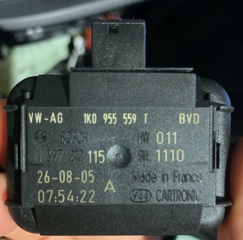

It seems that it is somehow related to RLS sensor. The sensor is not visible in subsytem of bcm (I have checked other scans on this thread and everybody has it). If I unplug the sensor than this error disappears and it will show new error - Light and Rain Recognition Sensor no signal/communication.
I don't know If my coding is correct or if there is a problem somewhere else. The sensor is connected to T73b/24.
Otherwise it seems that the lights are working, but I'm not able to fully check it with this error. I do have H7 with front fog lights.
This is my sensor:
Posts: 8977
Check the wiring.
Although I am not sure that your RLS sensor can be recognized by your new BCM. (2005!, seems too old)
Alternatives that will surely work with your BCM 7E0:
RLS
- 1K0955559AH, square shape. (-->2014 - T5, 6R, etc)... take a test with this one.
- 5K7955559B or C, round shape. (2015--> - T6, etc)
RLHS
- 5K7955547 round shape. (e-UP)
BCM coding for the RLS is fine, the RLS must also be coded once recognized by BCM.

I thought they are interchangeable. Every shop have them as compatible, but may be they are only backward compatible with older revisions not in opposite direction.
Wiring should be ok, I tested everything with multimeter and insulation tester. So I have ordered a new one with AH revision and I will hope for the best :). Thank you for your help.
Posts: 8977
I agree with you, there are many parts marked as compatible, but then... it is best to stick to what is established in the ETKA.
RLS software and possible functions have evolved quite a bit in the last 20 years, however, AH will work for the functions you want to achieve.
Hmm... installing a 2005 part on a 2011 VW with a retrofitted 2015 BCM is pushing the envelope a bit... right?
Without a doubt, humans are a successful species, there is always someone testing the least likely options, ... to infinity and beyond.🚀😄

I have installed new RLS sensor at it works. Now I have done all the electric installation except reverse lights. And almost everything works except DRLS and high beam (but flash works).
AUTO switch - same as in 0 position. When I cover the sensor nothing happens.

I seem to remember that the Rain Closing function does not work with square-shaped sensors (AH), only with the newer round-shaped sensors and WRMs with software for folding mirrors (I don't remember exactly all the compatibilities, I wrote it here in the forum ), I got it working https://www.youtube.com/watch?v=cOOTwodRdTo but finally disabled it. 🤭
That is, in your case neither of the two possible circumstances are met for it to work.
Since I don't know the electrical installation you have done and there are two possible configurations of electrical installations, try the following BCM codings:
1-Electrical installation (-->2014, ...with relay for automatic lights)
20F0F93A4A21301201288E007CEB8ED40718610F60842941300400020000
2- Electrical installation (2015-->, ...with T73b/8 for HB)
20F0F93A4A21301201288E007CEB8ED40718610F60842940300400020800

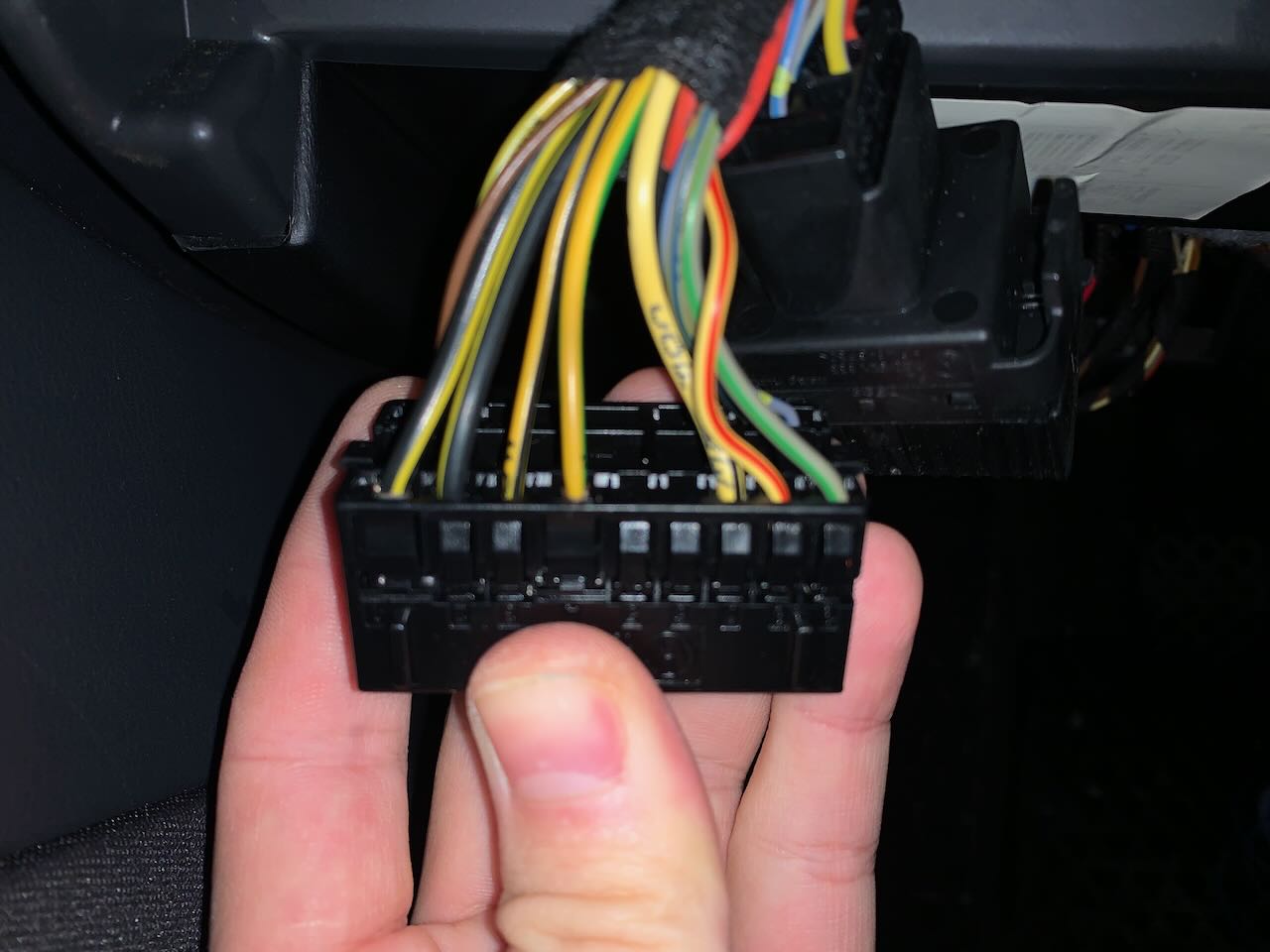

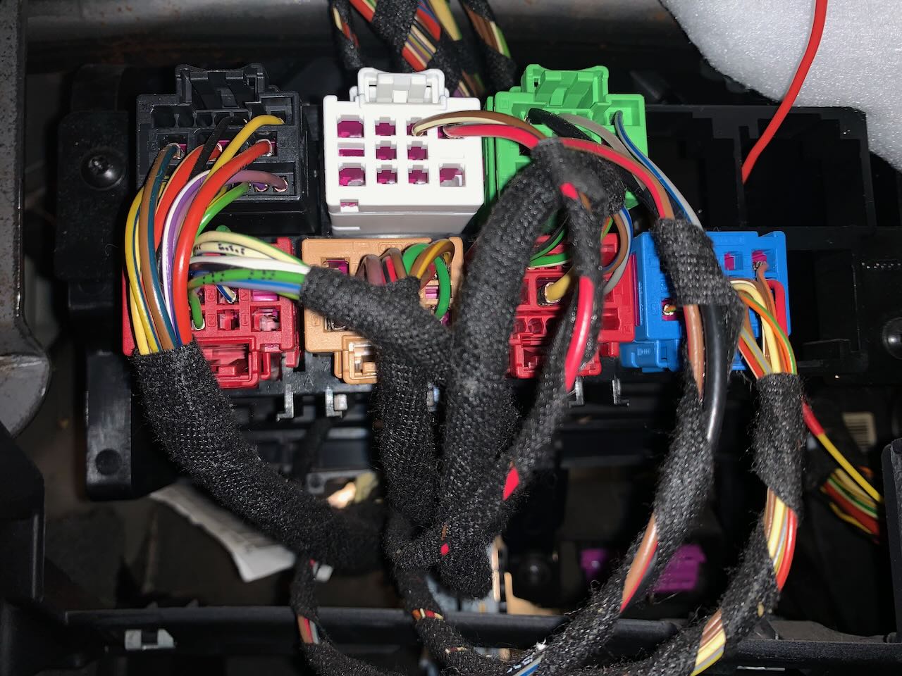

And so... after reading 44 pages... I ask for help...
I believe our case is not detailed (put please correct me if I am wrong, or stupid, or both!)
We have a T5.1 2013 7EM Multivan/Caravelle (as called here in the UK) it is specifically a highline executive. Now in difference to most of this thread I wonder is we have from the factory the H7/H15 "Twin Head Light" or I have seen it referenced by Osram as "Double Head Lamps"
We have already in the vehicle 7H0937090B BCM PQ25. And from the factory the 10pin light switch connector. Good News or so I believed. It also has automatic wipers and rain sensor from the factory.
From this post: viewtopic.php?p=585539#p585539 I believed it was possibly an easy install, new cable from BCM T73/a Pin 37 to T10 Pin 2, code with VCDS and add the 3C8941431A switch. Which was all completed with ease. However the bad news... No Automatic Lights :(.
No fault codes in VCDS scan. Coding for BCM is currently B8F2793A0A612413932089706EAB9ED40780602F7E844841320003020000
Function on the vehicle is when the switch is turned to 'Auto', it illuminates orange but the lights do not come on automatically only the DRL comes on as if the lights are in the off position. The switch acts exactly as the "non auto" version IN THAT . Could you also advise all compatible switch numbers so we can isolate this as a switch issue potentially? However I doubt the switch is at fault. As I understand the switch is only a signal are we missing something else?
Or do we need to make a modification like iichel suggests here: viewtopic.php?p=593084#p593084
ciclo, iichel and others I need some help please?
BCM coding: B8F2793A0A61241393208F706EAB9ED40780602F7E846841320003020000
