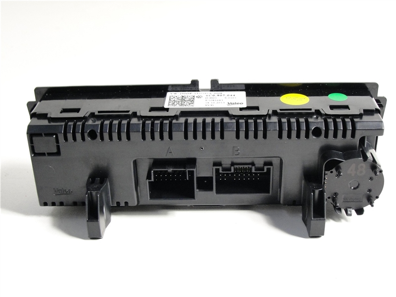

Any idea, if a climatronic-module from a 6C will fit in a 6R? :? Just as a idea for a new mod ;)
Re: ciclo's Polo. R-line 1.2 TSI 90hp 119gr.
i don;t think climatics and climatronics are exchangeable between 6c and 6r
Posts: 8980
ThueringerVR5 wrote:Hi ciclo!
ThueringerVR5, at the moment I have not raised this issue, first we have to look if possible Plug and Play, connectors and shape, then the dificult part... electronically...I'll take a look. :wink:
Thank you very much for the idea and sorry for the delay in the reply, lately I'm very busy.
iichel wrote:i don;t think climatics and climatronics are exchangeable between 6c and 6r
iichel, about a different issue I will have a secret to tell you (it's in testing phase), I will contact you by email ... :lol:
Posts: 8980
ThueringerVR5, with a quick look at ETKA the first drawback is that the connectors of the control units are different from one model to another.
Bad start... :)

ciclo wrote:ThueringerVR5, with a quick look at ETKA the first drawback is that the connectors of the control units are different from one model to another.
Bad start... :)
But that's just a small problem. Guessing 30-40 minutes will solve that.
The really problem is for example new sensors or more/fewer 'ventilation motors' (don't know what they are called that controls the ventilation)
I'm looking for the same retrofit since my climatronic is the ugly blue color and it's definitely not looking good together with RNS315.
Posts: 8980
diskoboy, you're right, but what I meant is that it is not as easy as in the Golf VI:
Pay attention between 2:27 - 2:29 min. What is that? What has he done?
Anyway I have no diagrams Polo 6C for entering the wires into the correct position in the connector ... and test if it works.
6R
6C
Urgently :lol: you need to remove the old blue control unit. Black= 6R0907044F, 6R0907044H...
for example:
http://www.aliexpress.com/item/GENUINE- ... 85521.html
