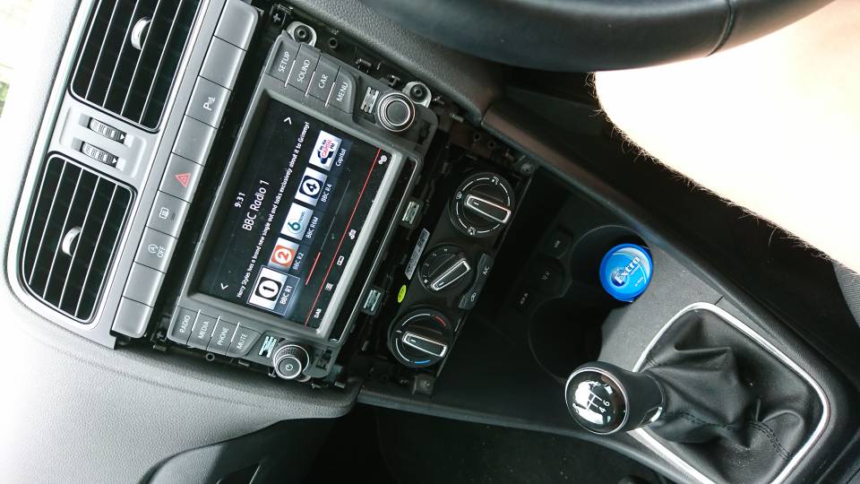

So I was able to remove these two no problem although I struggled to find the correct area to pry off the trim around the vents - this comes off with the button unit right? Any help for that panel would be much appreciated!
richards_owen
Posts: 10
Joined: Thu Dec 22, 2016 4:57 pm
Drives: SEL 1.2 TSI 2016
Location: York, North Yorkshire
Re: Removing Plastic trim around the stereo POLO SEL 6C
Post by richards_owen »
What I managed! Image

Thank you - so there's clips at the top and sides and then the panel of button comes off from the bottom too... :)
