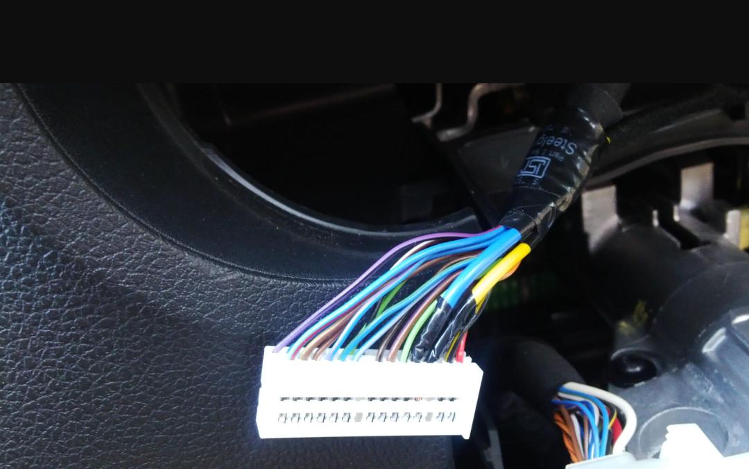

Re: Help Retrofit OPS Module
No in your car the instrument cluster of not on the power train can network bit it has its own network in bcm max and high (7e0 937 089/090)
Take the can lines from the steering column wiring loom, orange with black and orange with brown.
After that it should work.
kctai
Posts: 4
Joined: Tue Mar 20, 2018 2:40 am
Drives: polo sedan
Location: malaysia
Post by kctai »
Hi iichel,
It's mean that the method below is not working?
The attachment IMG-20180320-WA0008.jpg is no longer available
In your case this won't work, I'm sorry.

May I know how to identify the steering column wiring loom?
it's on the steering column
