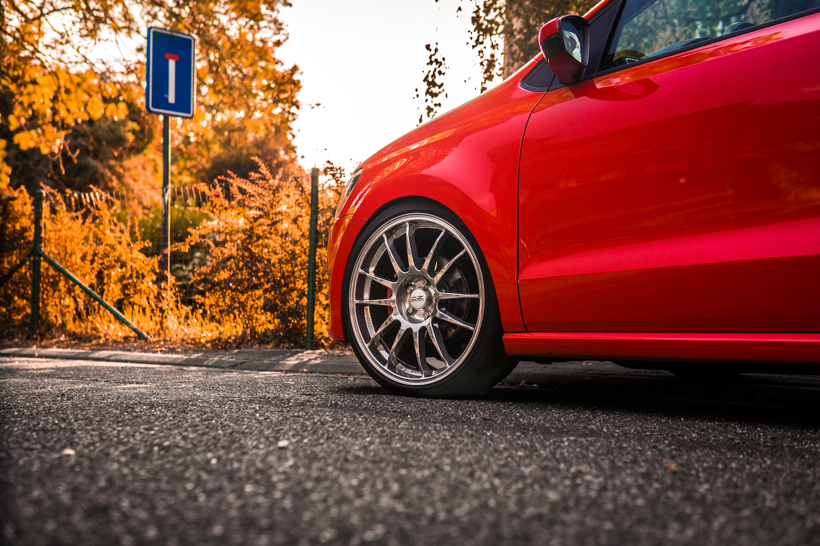

BUT to end my introduction, one thing more has to be done. Here are some photos of my car. Hope you like them!

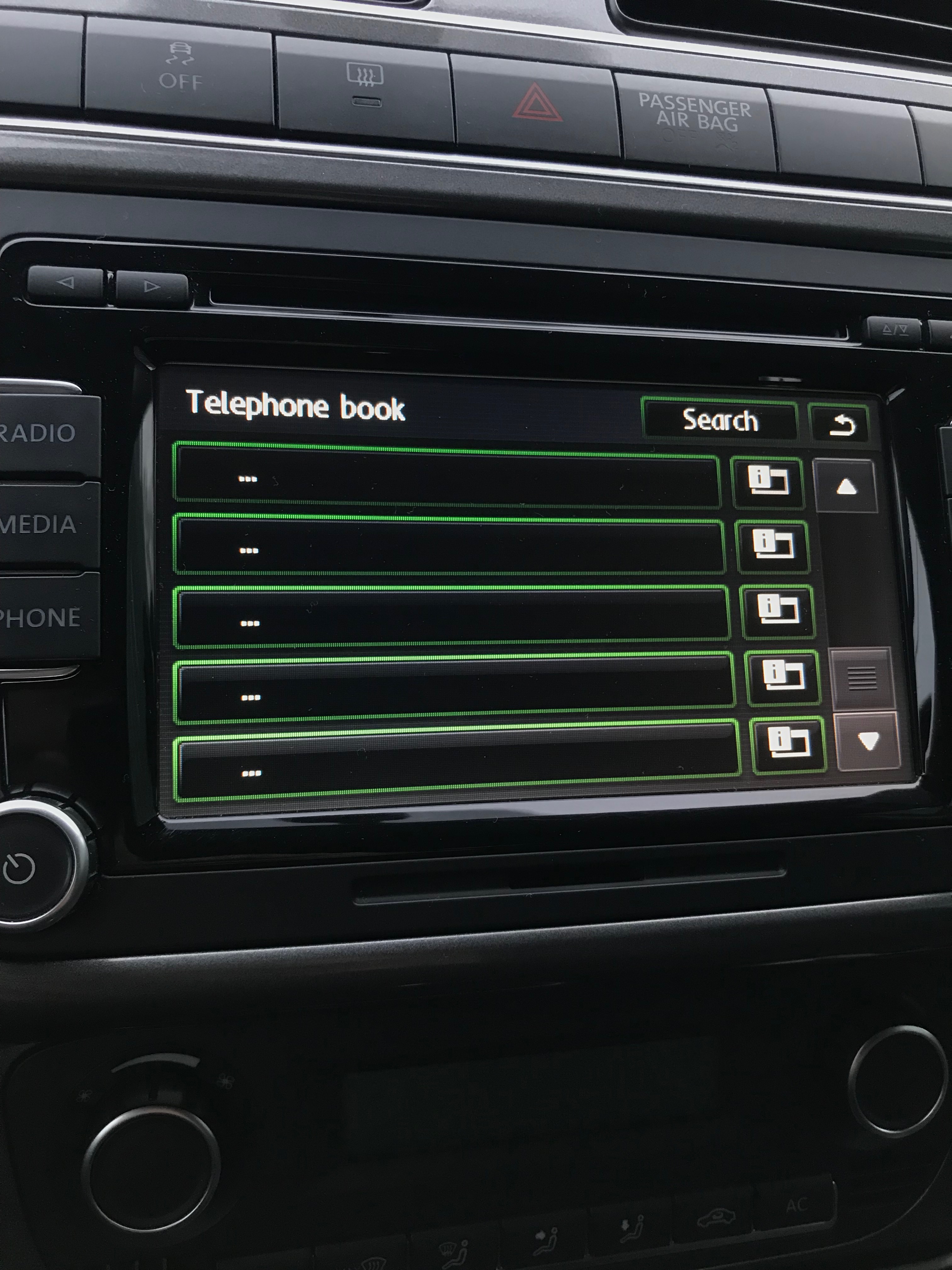

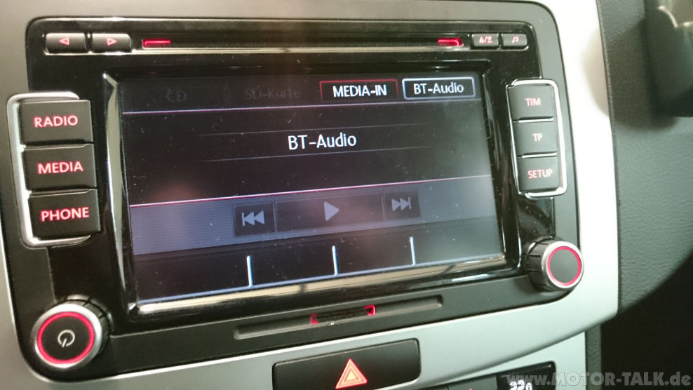

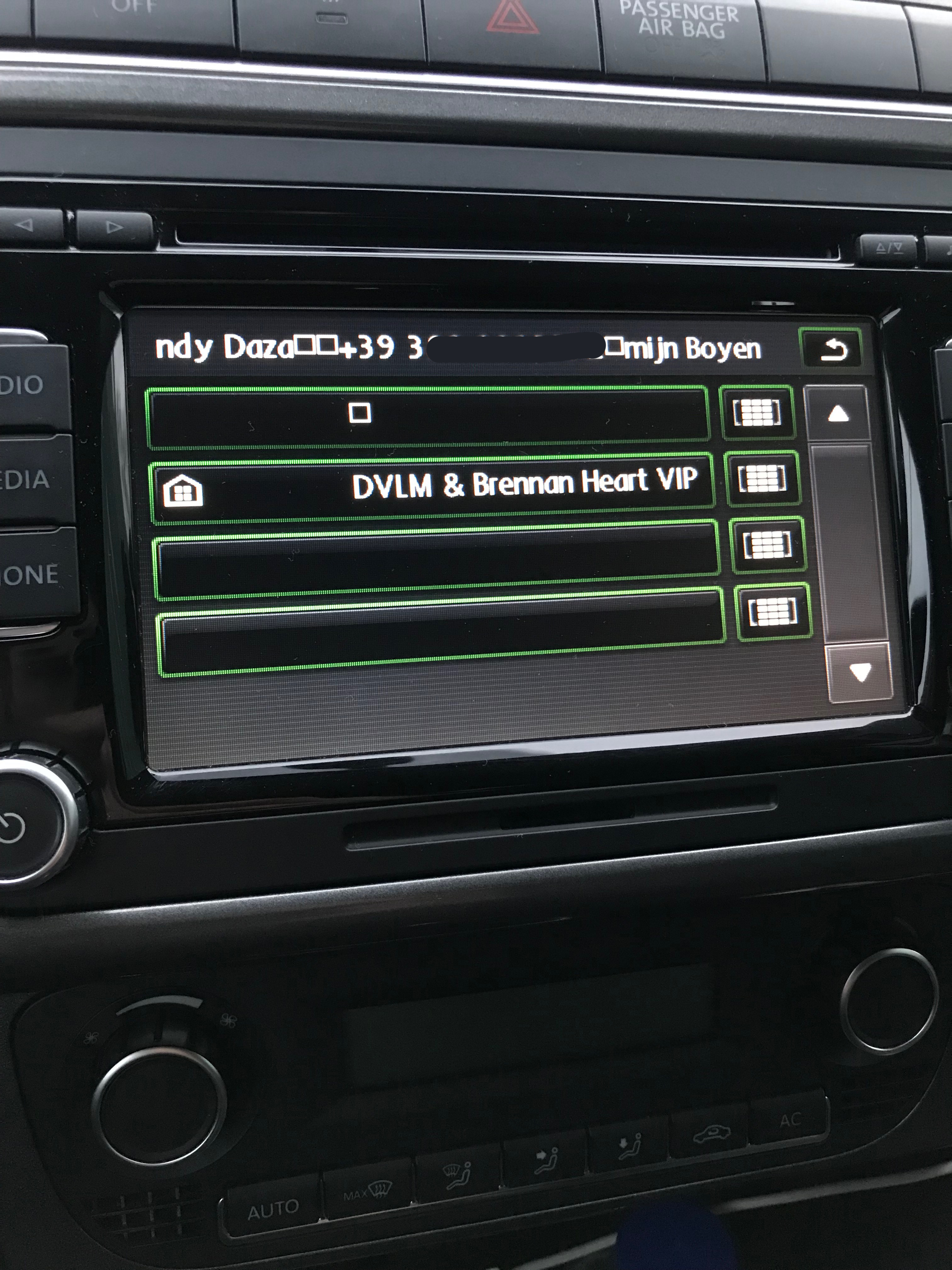

Have been working on the module again this evening. Everything works fine now! The phone was able to connect and vcds auto-scan gave no faults anymore!

Also my telephone book does some strange things. Just telling because maybe it has some relation to the music idk... My contacts in my phone are set like it should be. First and last name in their respective fields etc. I already did a telephone book update in the radio settings but it still looks like this:
The contacts name and number are in the same line separated by blocks and DVLM & Brennan Heart is a song on my phone. I don't know what it is doing there. I didn't set it as ringtone and it shows up in every phone contact?? Also unable to call from phone book.
But let us first figure out the music.
