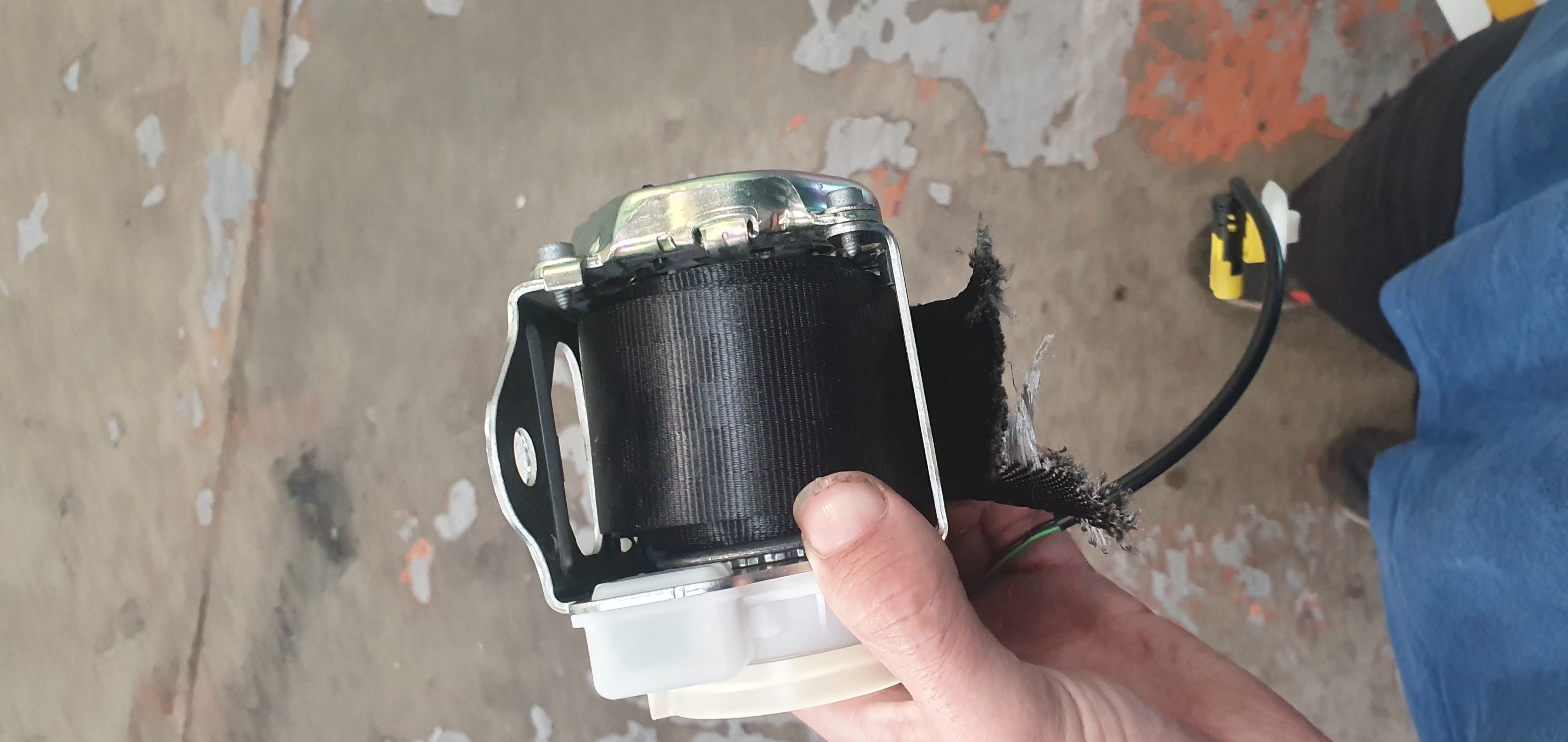

Anyone know how to remove the rear seats? My dog chewed through a rather expensive seatbelt. Cant find a bolt anywhere

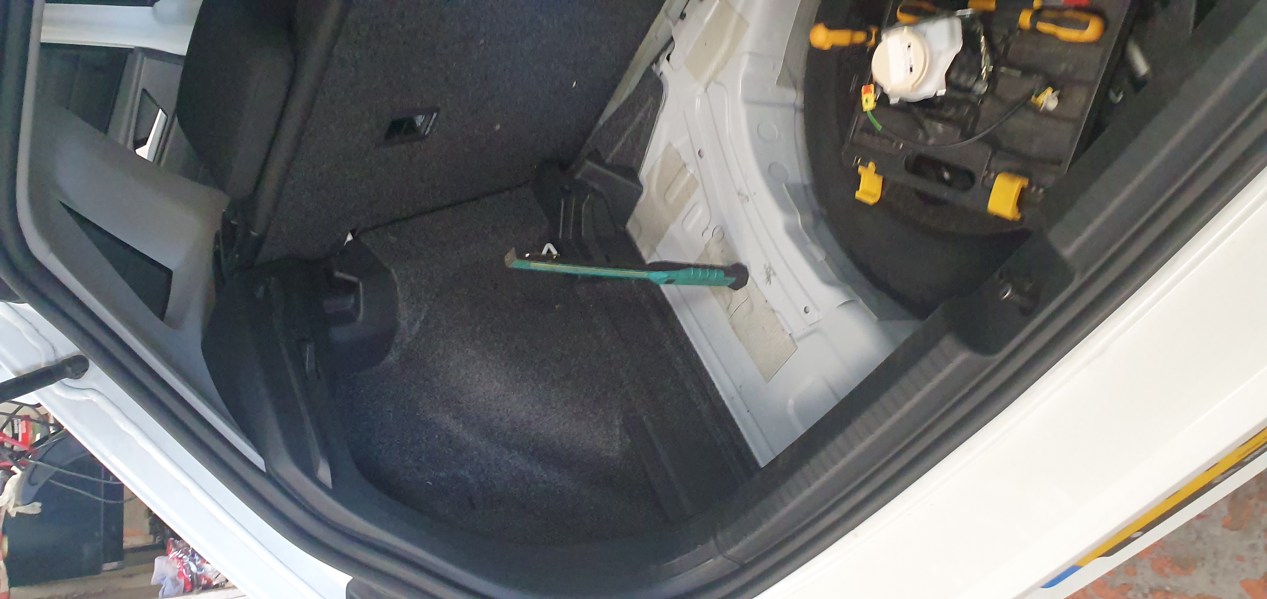

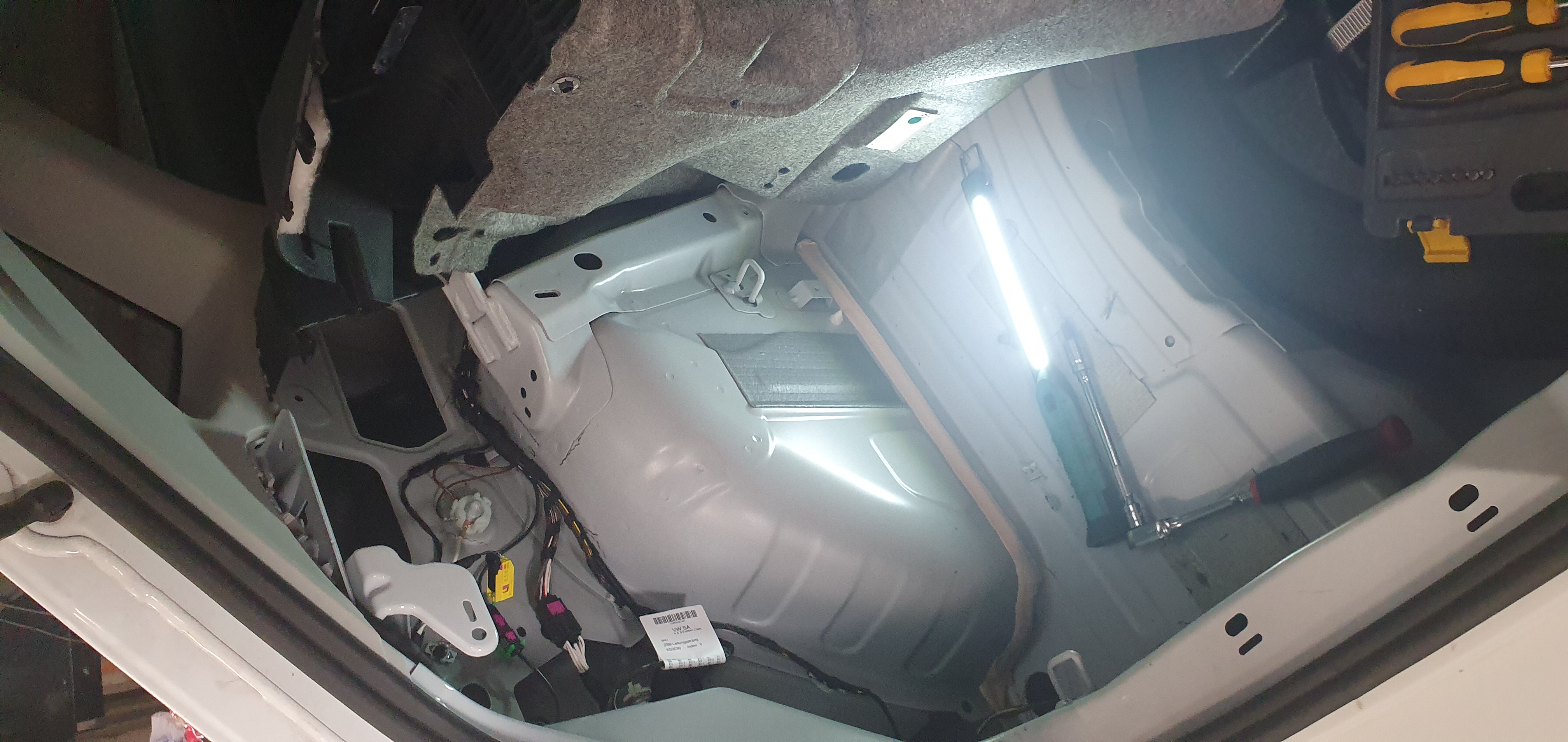

Cheers guys. I got then without breaking any clips. Being a mechanic helps (proper tools) the rear seats are a pain. Pretty much all the rear trim. All thr isofix slots out. And then they literally yank vertically out.
Ps VW wanted more to fit said belt than the belt cost. £170 for the belt £180 to fit.

Ouch, what sort of dog have you got that did that?

Labrador. He took about 20 seconds to get through it. First time he touched it too. Someone is now going in the boot

quite useful photos for doing some more soundproofing. I find that most of the noise comes from the back of the car being a cheaper hatchback. The boot area is usually lightly soundproofed

Thanks for the pics Zach and hope you lab changes his diet because replacing seat belts can become a costly affair XD
