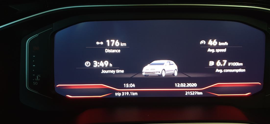

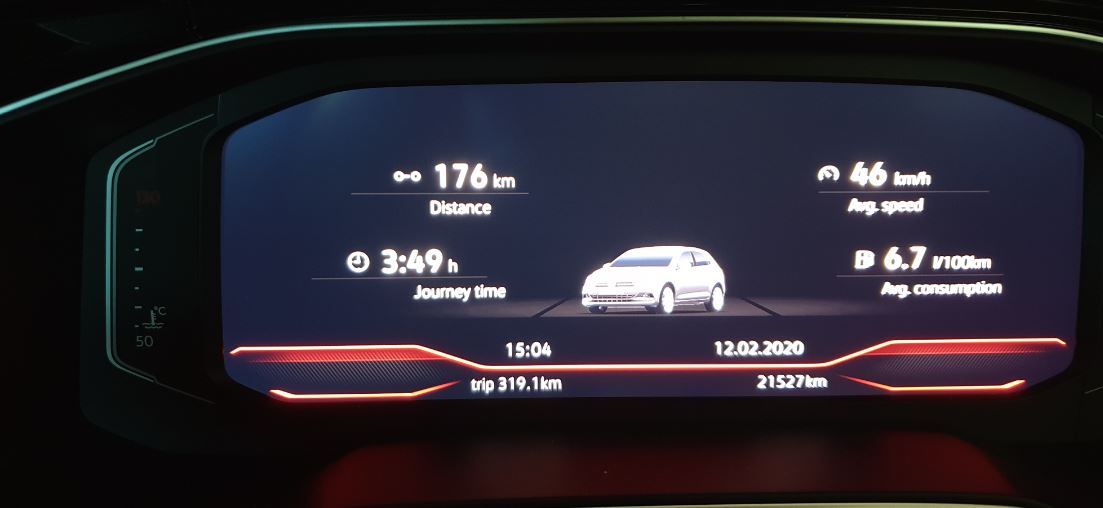

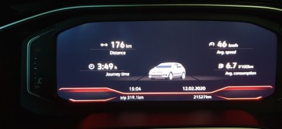

My journey today, not too shabby!
Re: Fuel consumption question
OomStu_ZA wrote: Wed Feb 12, 2020 1:28 pm My journey today, not too shabby!
Which is 42.7mpg.

Vonbek2004 wrote: Mon Feb 10, 2020 6:04 pm
I used to get 40-45 but it's literally just plummeted since Saturday.. i read further in group that some people said about the DBF thing.
I noticed that the exhaust is a lot louder than it used to be, gears are held longer, I.e. car taking the gear change from 3rd to 4th upto nearly 40mph on a flat..
Just sounds like GPF regen, nothing to worry about. Does stop/start also not work...that's another indicator
