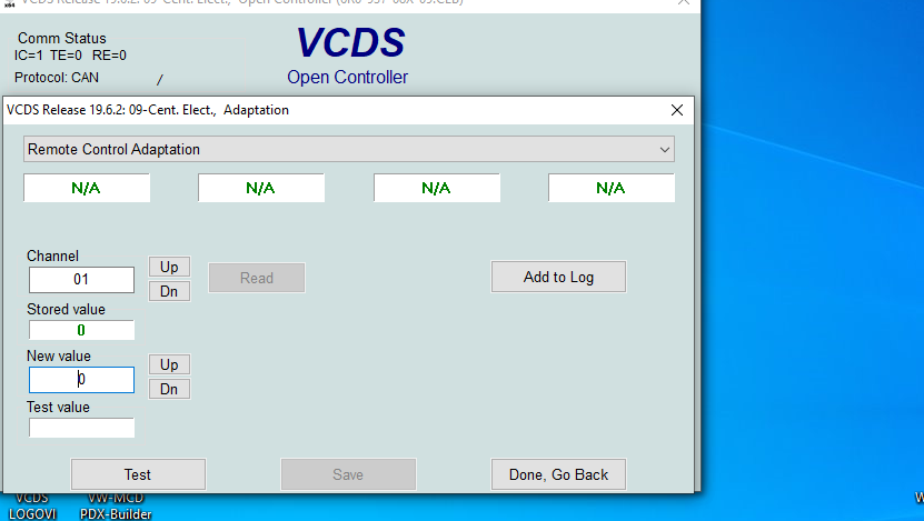

Guys,
Today i tried to adapt the key ( ok immo i transfered chip)
When I try to change the value of keys from 0 to 1 and test it still remains at 0. It doest want to accept it.
In coding central locking was already checked.
I have a cobra alarm fitted it also has central locking, maybe its blocking it or what?
Sent from my Nokia 6.1 Plus using Tapatalk

Is your bcm perhaps too low? I.e. 6R0 937 085

Your BCM should be perfectly capable of central locking via key fob, no problem.

They key still doesn't want to work: I hold the unlock button for few seconds VCDS seems to become unresponsive but still 0 keys. New value wont accept nothing than "0" , Test : 0, Save, unlock on keyfob nothing... :\
Can i remote match via ODIS?

Okay, now when we have our BCM coded out, we need to start remote key matching procedure. So go to 09- Central eletronics -> Adaptations
Follow the procedure like in video:
I had an issue where i input the value of new keys ( New value) and i test it it becomes 0, and you cant save. So just add 0, test, save -> Then Hold the unlock button for 1-2s and your car will give your a notification via blinker that the key is paired.
