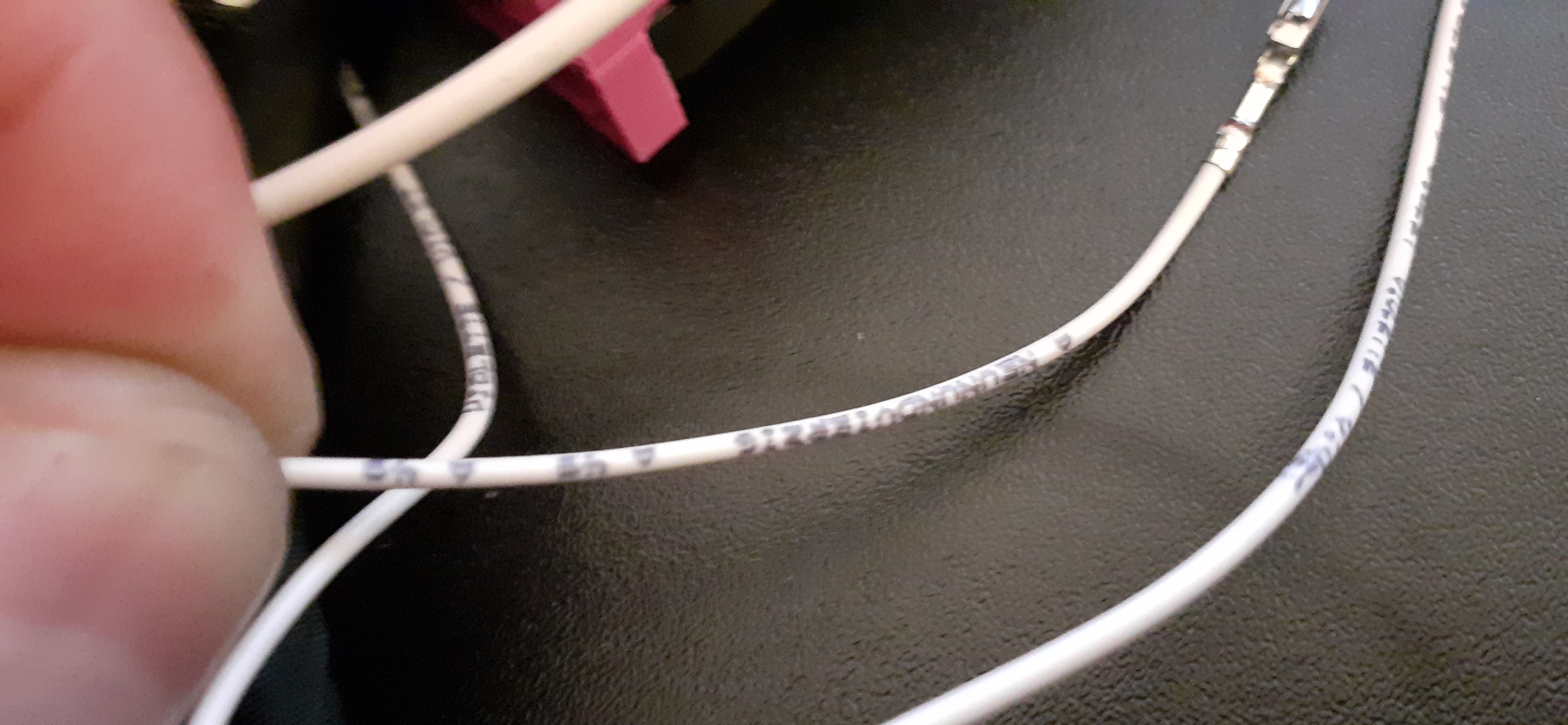

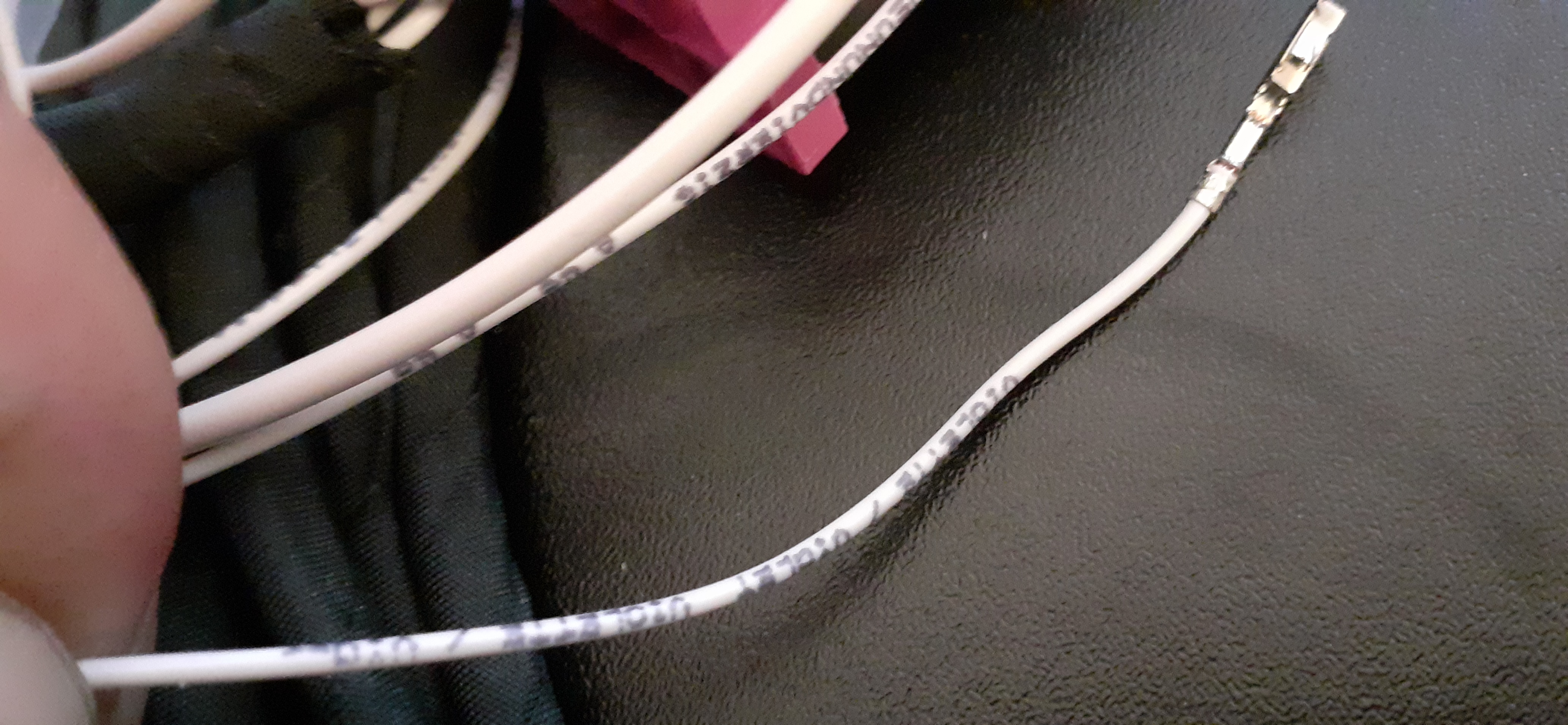

And there is no manual available, so i have 2 cables witch i am not sure where to connect.
Here there are:
-1st
, Here i think its written (BCM)A49, Is that Right?
-2nd
, Here its written "Violet" - Where should i connect it? IC connector pin17?

what are the other sides of the wires connected to?

1st one - (BCM)A49 - other side is connected to the relay
2nd one i think is going for the low water level sensor

Yeah connect it to T32/17 from the instrument cluster. Relay goes to BCM T73a/49
