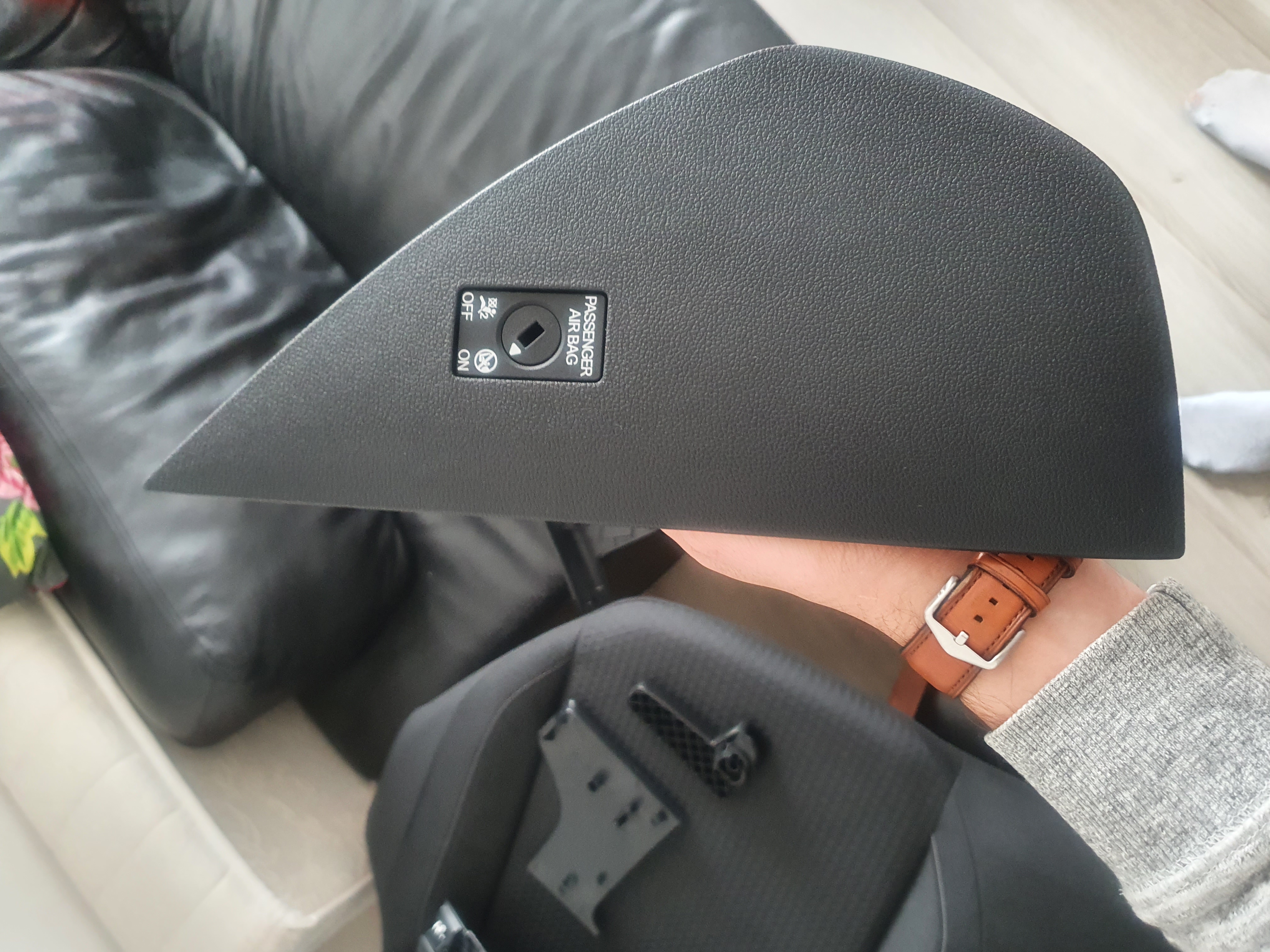

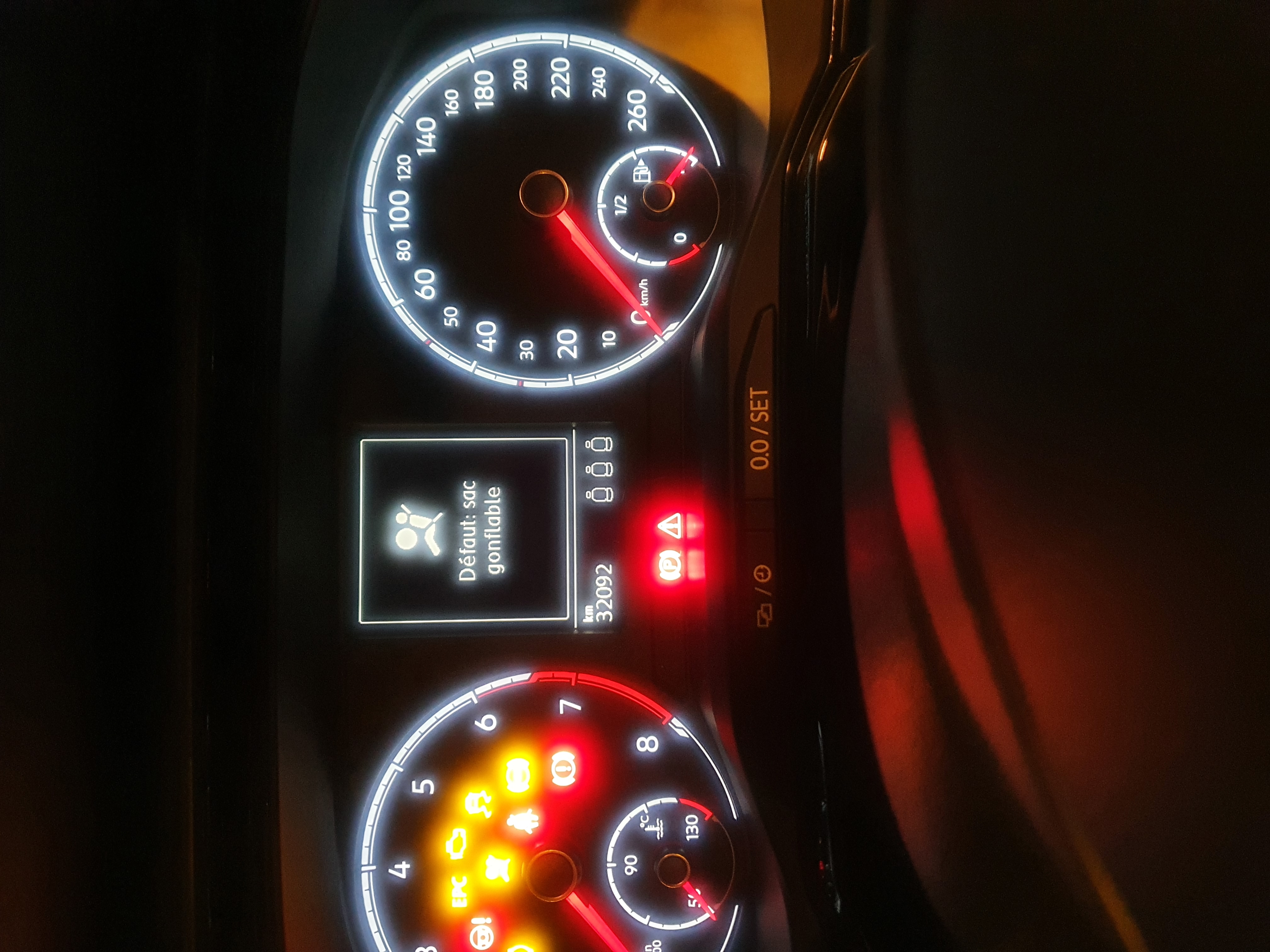

I wanted to ask about something. When I was installing the camera I removed one of the side trim panels of the dashboard (from the passenger side), which has an airbag connector, you can see the piece in one of the images. I passed the ignition with this panel disconnected and I saw an alert on the dash screen saying that there is a problem with the airbag. I didn't worry because I assumed it should be because this panel was disconnected.
However, after connecting and fitting all trim plastic panels again, I still have this alert on the dash screen. Any advice? I don't know how to remove it.. It's weird that it keeps showing the error and I checked the connector was correctly fitted.
This is the plastic panel I removed and fit back again:

This is the alert on the dash screen:
20201116_213333 (1).jpg (3.04 MiB) Viewed 1909 times
I thought the alert would disappear after connecting back the trim plastic piece. But it is not the case.

I think once the Airbag Control Module logged a fault, it will need something like VCDS to access the Airbag Control Module and clear the fault code.

Yup- once logged, it needs to be cleared properly to get rid of the warning. Not sure if you need a proper VW scan tool or if any regular scan tool can do it though.

Thanks @vc-10, @ho8882000. I have to do the 30k km service soon, I will ask people from VW to remove it then.

I did the same when fitting a RVC. Cleared the fault code in VCDS and all good. Didn't need to log into any modules.
