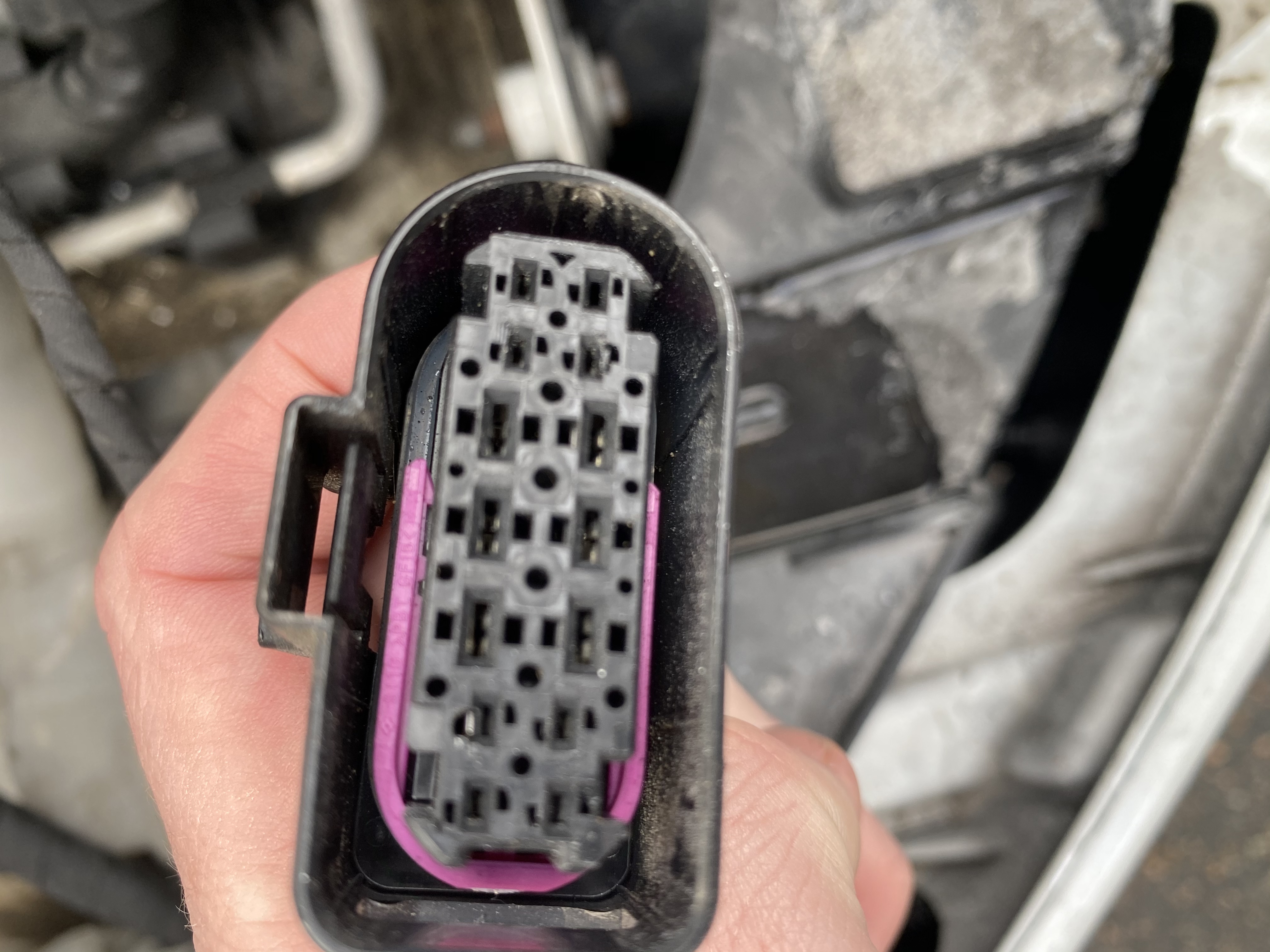

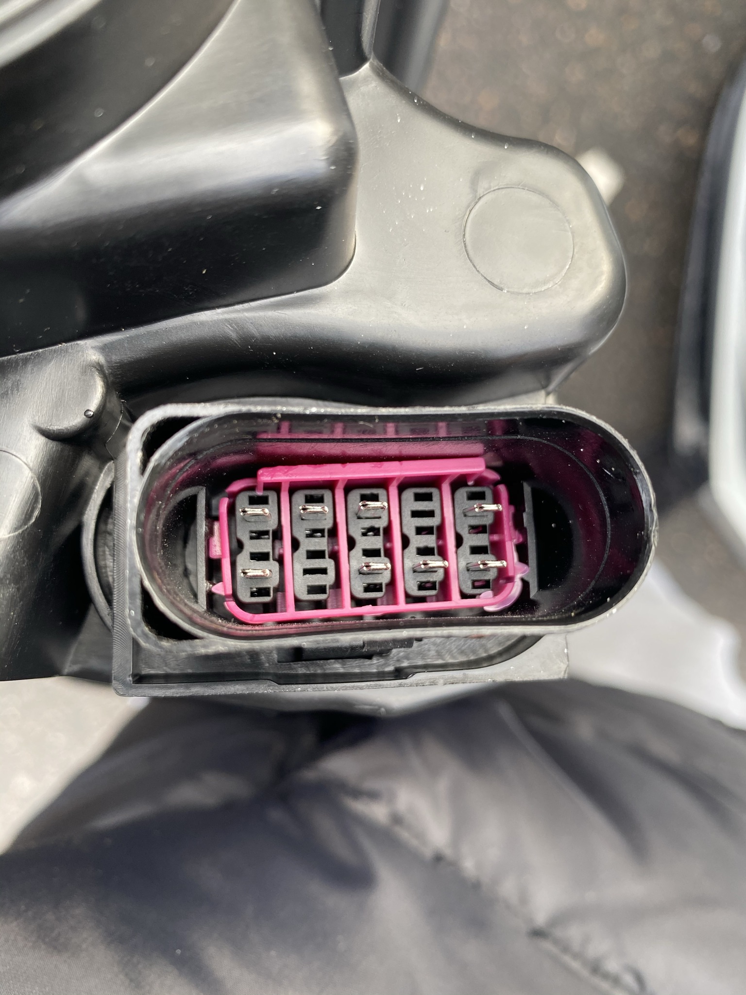

This is the headlight plug
This is plug on my car

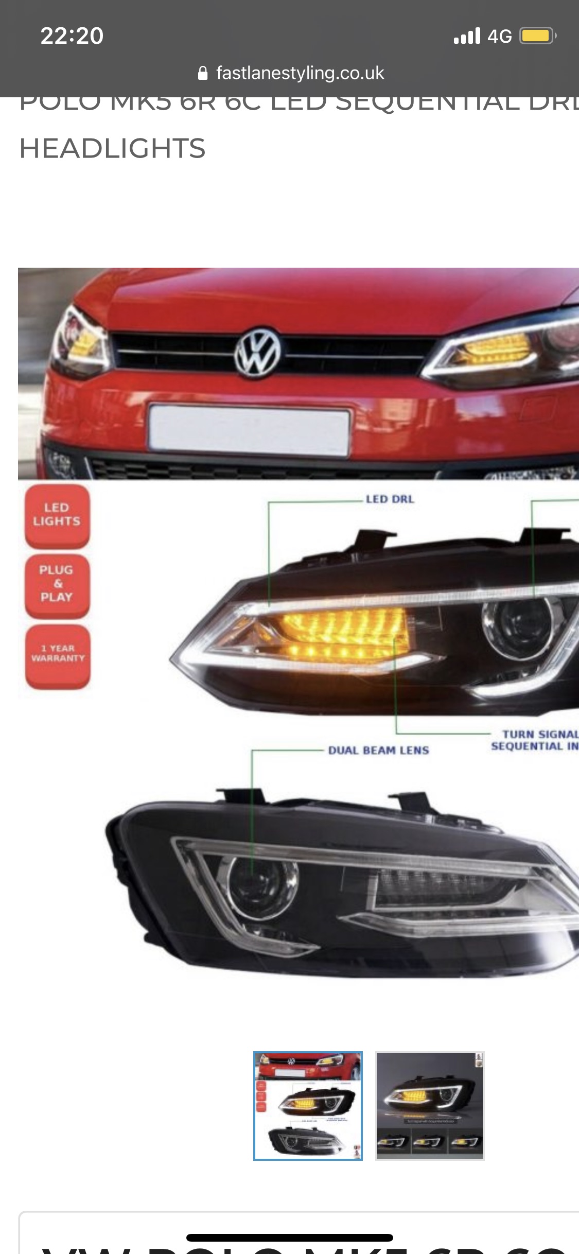

This is head light i brought
Magz90
Posts: 5
Joined: Tue Dec 08, 2020 5:20 am
Drives: Polo gti 6c
Location: Essex
Re: Headlights
Post by Magz90 »
Theres no part number on the site or headlight
Posts: 6693
Re: Headlights
So there is your problem, I guess. You bought a pair of aftermarket headlights with different connectors than the original LED headlights. That's not going to fit I'm afraid. Perhaps you can get away with just an adapter to convert from 14 to 10 pin, otherwise you might also need to re-code your BCM.
