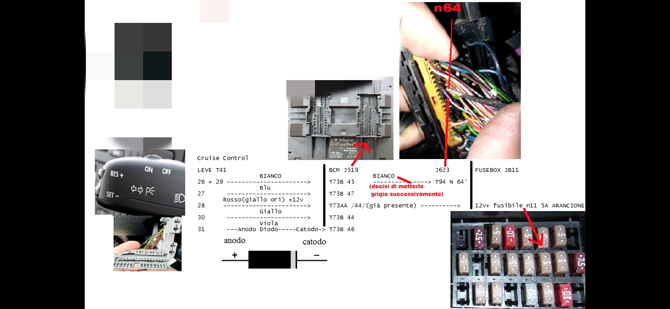

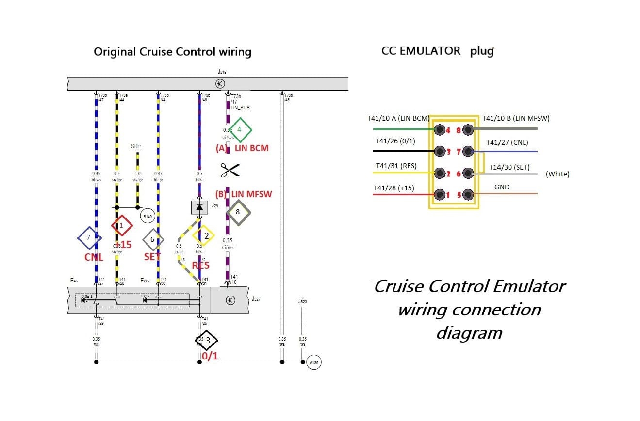

I'd like to retrofit ccs on my 6R. I do not buy the stalk with buttons so I retrofitted the ccs wirings together with cc emulator keeping the original stalk without button but cc does not work. Here's a recent autoscan and the new wirings.

scheme used for assembling the emulator
scheme used for assembly

You have an implausible signal error.
I'm not confident with CCS retrofit but many people here are.
Anyway you need to post a full AUTOSCAN to get support.
Posts: 6693
Re: Problem retrofit Cruise control
check the wire to the ECU please

iichel wrote: Fri Apr 30, 2021 1:04 pm check the wire to the ECU please
thanks to everyone for the help, especially to iichel, because thanks to you iichel that I double checked the wire that goes to the ecu and I found that I had not mounted the right connector and therefore did not make contact, now I have solved it and it works fine. Thanks again
