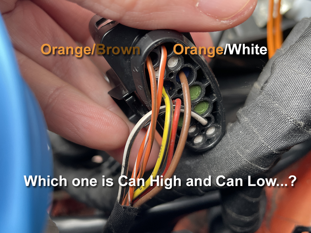

I'm going to add a couple of LED auxilliary lights to my Polo, so I need to tap into the Can Bus system. I got as far as to figure out that the orange cables are Can High and Low, but not which one's what...
The CanM8 is also purchased, so all I need is to figure out this detail before I short circuit the entire system.

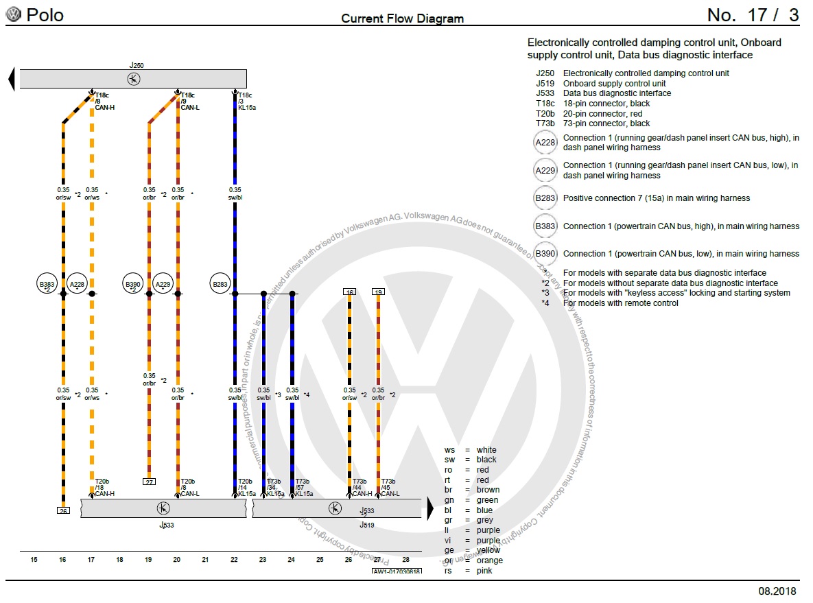

Maybe this will help you:
Re: Can Bus High and Low
orange/brown is always low. since brown is always the minus/ground/mass wire, it's easy to remember.
