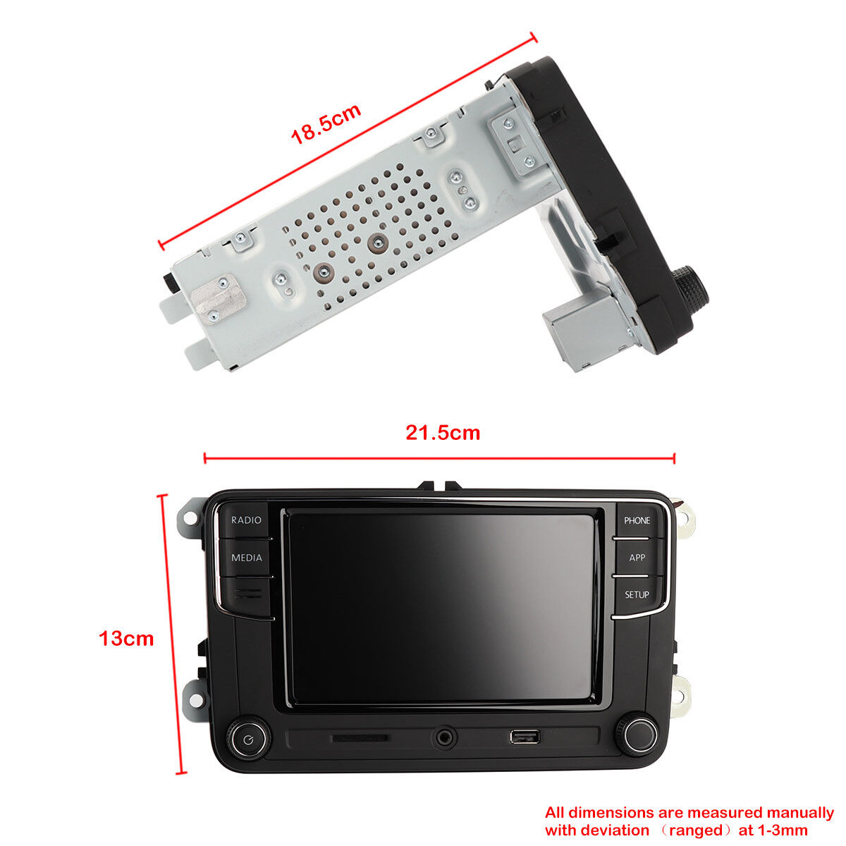

RCD 330 is the model you want,which looks like this so connections should be similar to your OEM unit, the RCD330 was originally designed for the Chinese and Russian markets
Look here and do your own research www.RCD330.com

The front side (face) doesn't look suitable for my car. Defently doesn't fit.
