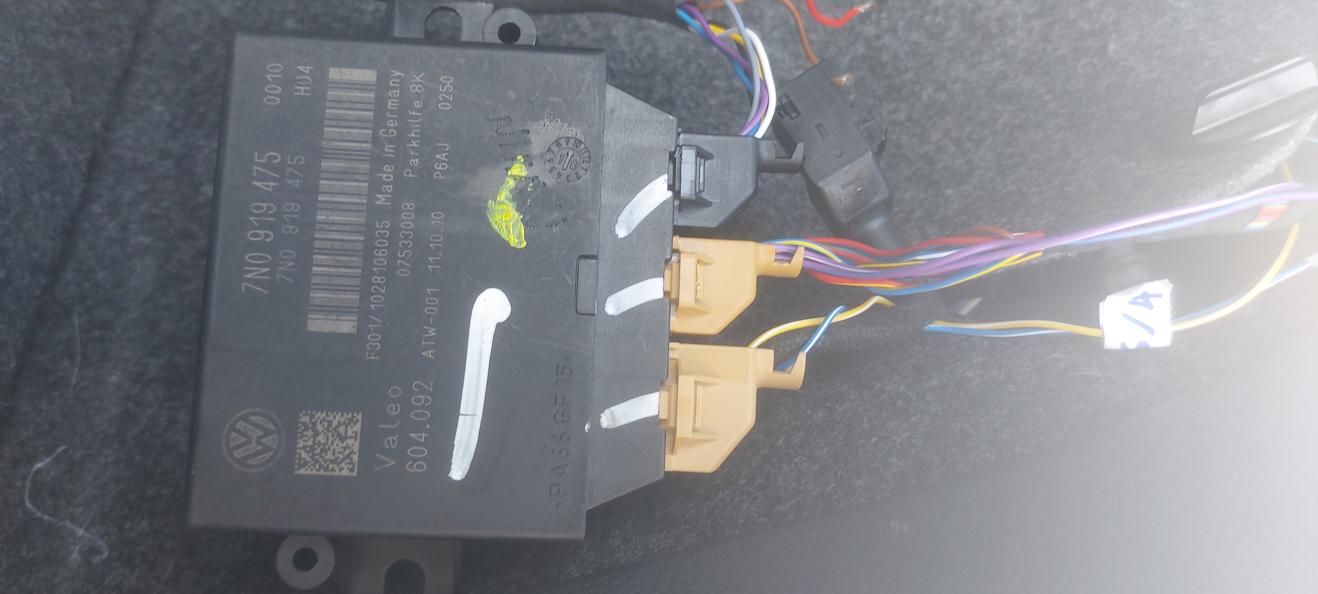

I'm retrofitting an 7N0919475 8k module into my 2014 polo 6r that came stock with an 6R0919475 4k module.
When I activate the 8k with the switxh I get a long beep for about 5 seconds and the the switch just flashes, same if I go into reverse.
I have checked all sensor wiring, switch wiring, and speakers. But the issue still persists.
Any and all help would be greatly appreciated.
-Solerz
Re: 2014 polo 6r 8k PDC malfunction
I don't believe 7N0 is a correct PDC controller for PQ25, you should use the 7E0.
Do you have an autoscan of the car from VCDS or another diagnostic tool? I'm sure it will tell some more.
I'd suggest to get the correct module
JB_Solerz
Posts: 12
Joined: Wed Aug 24, 2022 8:51 pm
Drives: Polo 6R
Location: England
Post by JB_Solerz »
This is the module I have. Is it possible to flash it with the correct modules firmware?
I don't think a 7N0 HW module will take 7E0 firmware, but you could give it a try.
JB_Solerz
Posts: 12
Drives: Polo 6R
Location: England
Post by JB_Solerz »
flashed it and all working. thanks for the help
