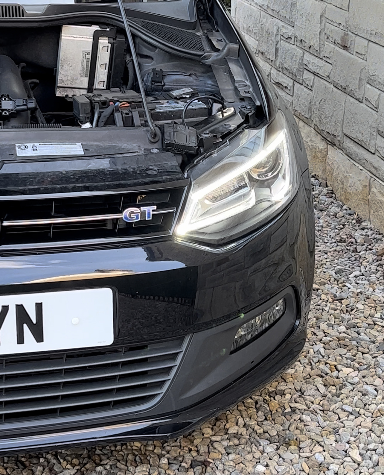

Hi all,
In great need of help with my HID headlight conversion.
Basically, I have a Polo Mk5 6R 2013 and I recently purchased VLAND headlights which use a D2H HID bulb which has replaced the halogen headlight and bulb.
A few weeks ago I installed the headlights but they started flickering. I've switched the bulbs and ballasts around which made no difference. Ended up asking the seller for a new pair of bulbs and ballasts which I installed yesterday to still have the same issue. Could this be an issue with a fuse?
I've tried asking around garages etc and they don't know what the issue is or they won't look at it. It's a pain seeing as the low beams don't work so I can't drive at night.
They usually work fine with ignition on but as soon as I turn the engine on they flicker then turn off completely. I've also seen people mention adding a resistor but a lot also claim it does nothing.
Link to the lights: https://www.ebay.co.uk/itm/133971336972 ... media=COPY
Thanks in advance for any help. :)

Hi Zainf7
Kindly post the pictures of your newly bought headlights. Backside pictures of headlights if you can post would be helpful.

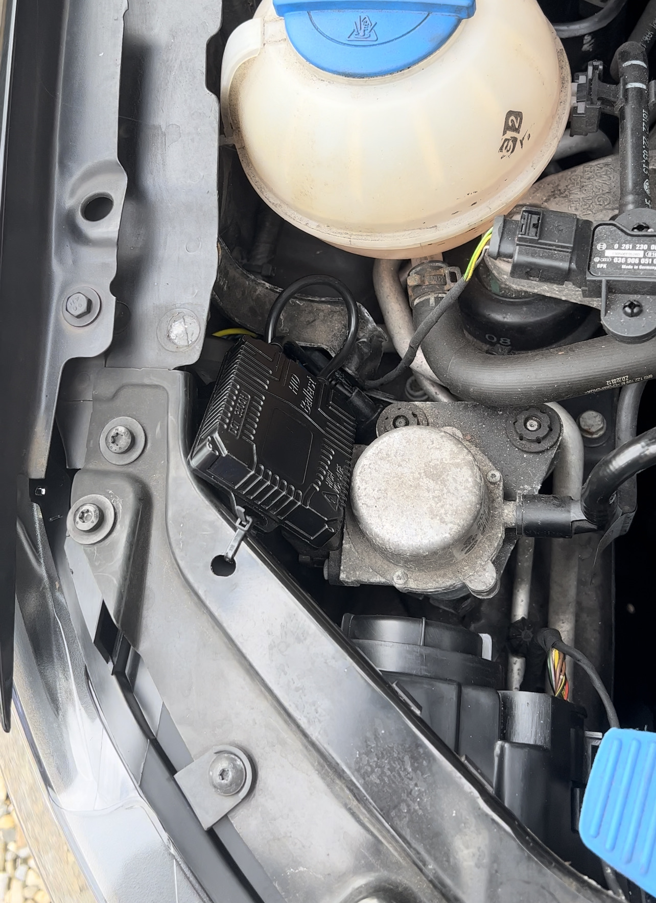

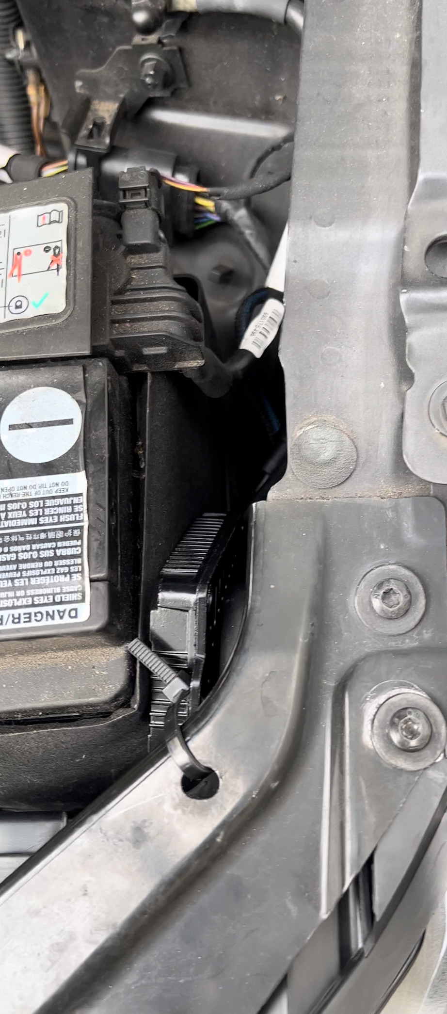

Thanks for your response.
Attached where ballasts are installed and the front headlight where the low/high beam isn't working.
