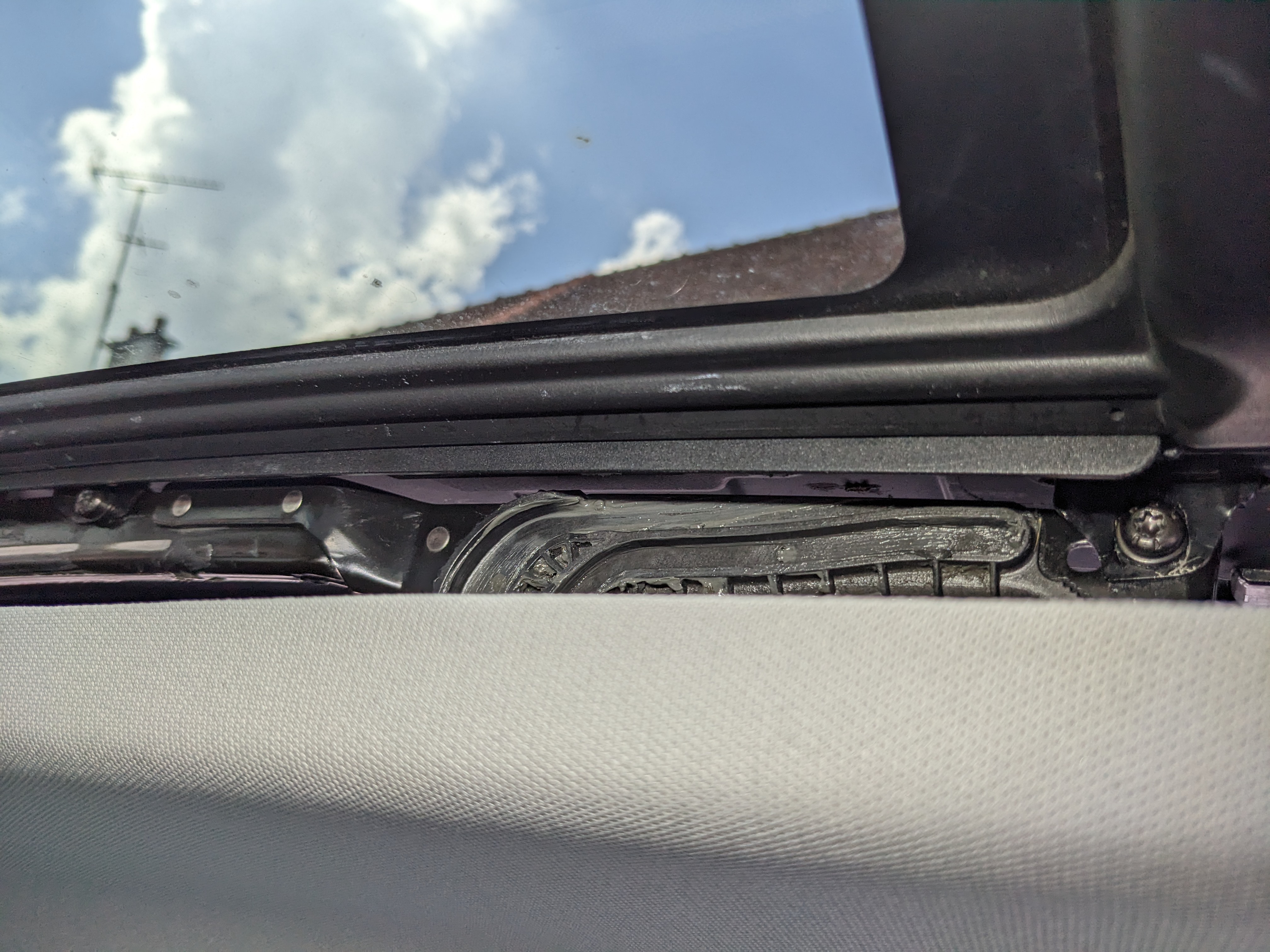

Hey fox, hope you're doing well.
The good days are back (at least) for the moment and today I used my panoramic sunroof.
Last summer I did a complet servicing:
-Glass panel removed
-Remove old grease and appluy new one (VW grease)
-Put back glass panel and adjust the height with the 6 screw with correct torque.
Before the servicing, I had (when closed) a rattle and also when in open position.
Now, only when it's open.
Screws are tight and glass panel is in correction position according to VW documentation.
Rails guide are well lubricate.
I see nothing.
Except one thing: when I bought the car (I'm the second owner) the panoramic sunroof was never serviced (no grease, except factory's one).
Do you think the rails guide worn out due to old grease never been replaced ?
Thanks for your help !

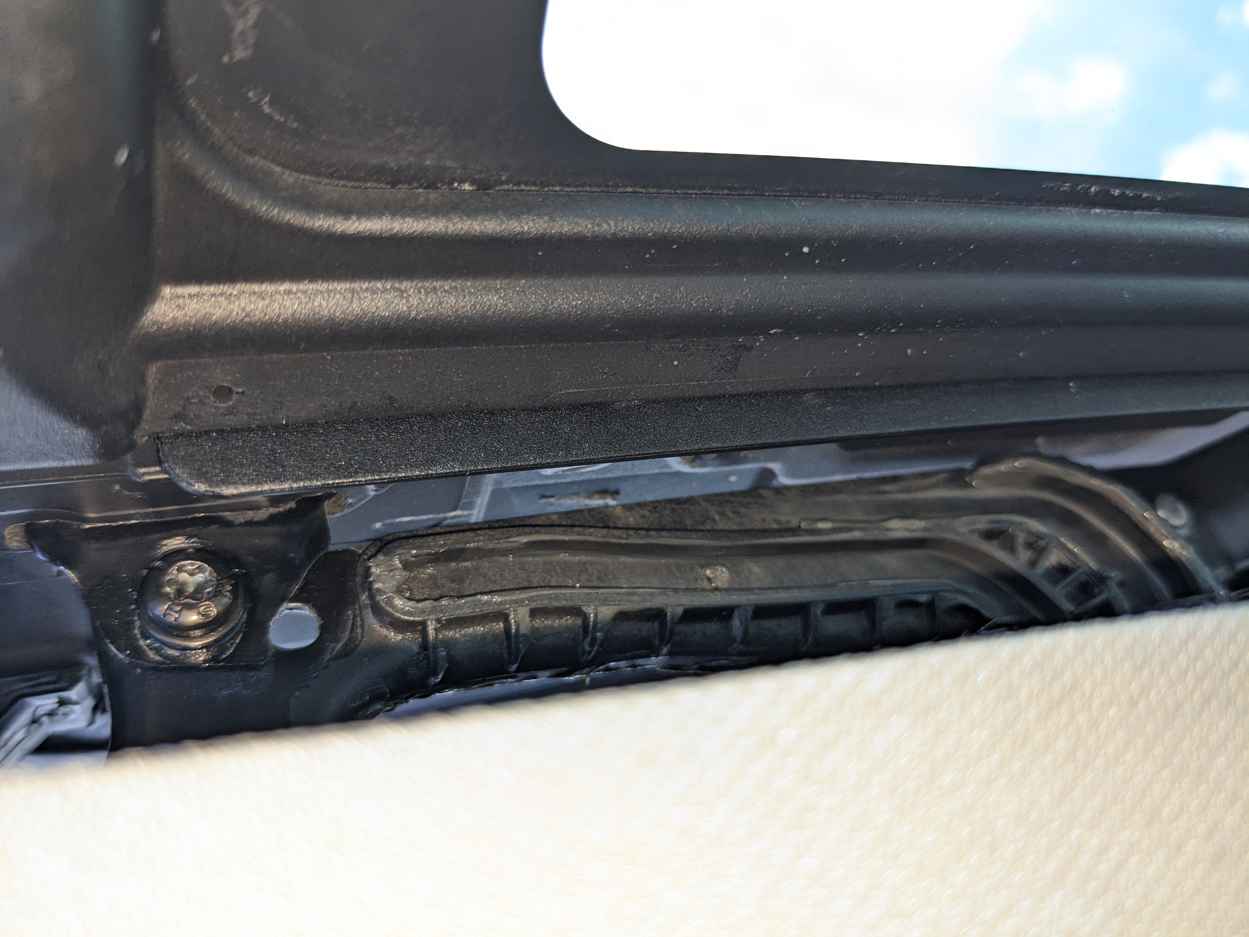

Before you can remove the 6 screws (3 on each side).
You have to remove like a sliding piece of plastic:
It slide backward to be removed and can be tight.
After, you can remove the 6 screws. Be careful, they need to be cleaner to remove the old threadlocking (blue Loctite 243) and DO NOT over thight them (5.5Nm)
Otherwise you will have to replace the sunroof assy. Pretty expensive.

Interesting. Very possible for the rail guides to be worn. Can you determine where the rattle is? You might need someone else to drive with you observing. What about the cassette itself, is it torqued to the roof properly? You will need to drop the headlining to check.

spartacus68 wrote: Sun Jun 23, 2024 9:02 am Interesting. Very possible for the rail guides to be worn. Can you determine where the rattle is? You might need someone else to drive with you observing. What about the cassette itself, is it torqued to the roof properly? You will need to drop the headlining to check.
3/4 of the rattle are coming from a loose glass panel and the rest could be also bad installation of the headliner.
All around the opering, on the inside, you have some metal clip. If they are damaged for whatever reasons, not installed corretly or loosed, you can have rattles
spartacus68
Posts: 119
Location: Aberdeenshire
Re: Polo 6C Sunroof rattle (open)
Post by spartacus68 »
Where the glass sits on the arms - is there foam pads, have they disintegrated? If the glass is making a noise, then something isn't sitting flush. 3M make adhesive foam pad strips for these sort of commercial applications.
