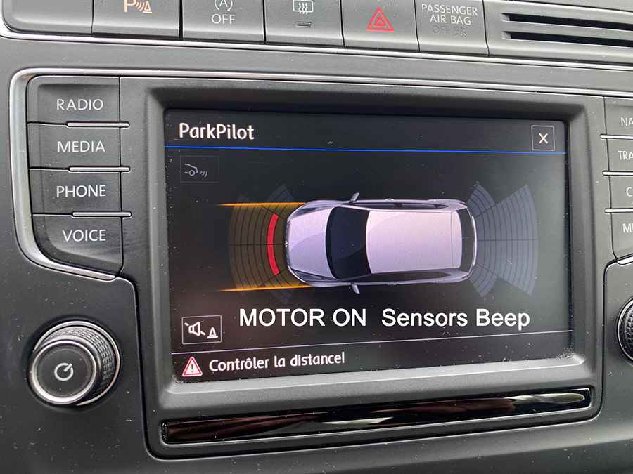

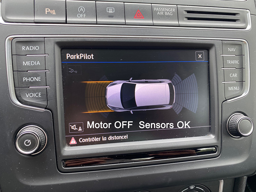

Hello,
I retrofited my park pilot 4k to 8k, oem, except for the front radars that i bought on ali.
I coded all, but i 've got a problem, when engine is on, front radars beep continually, when i stop the engine with contact on it's ok.
I don't understand why, front radars are painted, Polo 6c got abs and esc and i installed the pdc button.
Any idea ? coding seems to be ok. Other, my wiring come from passenger hole, so the the left and right sensor are inverted on OPS, is it possible to swap it by coding ?
Thanks !
radar not ok -.jpg (247.79 KiB) Viewed 15727 times
radar ok -.jpg (249.05 KiB) Viewed 15727 times
Posts: 6687
Re: Retrofit park pilot 8k problem
No you can't swap left and right but perhaps you can switch the cables either in the module or in the coupling point to the rear bumper.
Is your kit OEM or ali OEM?

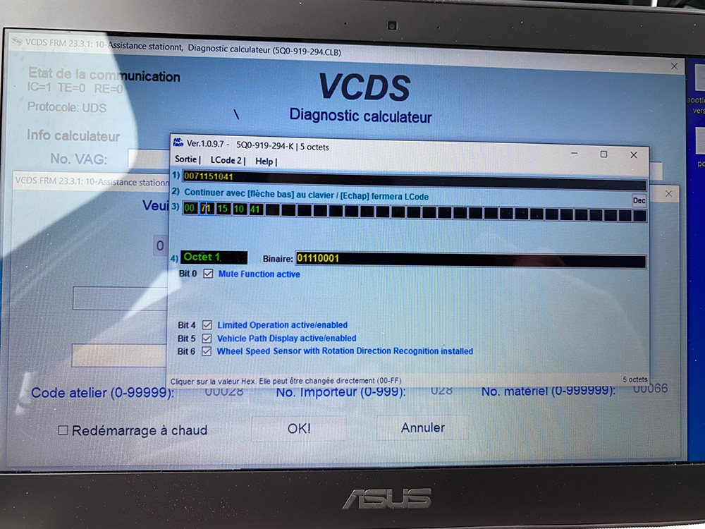

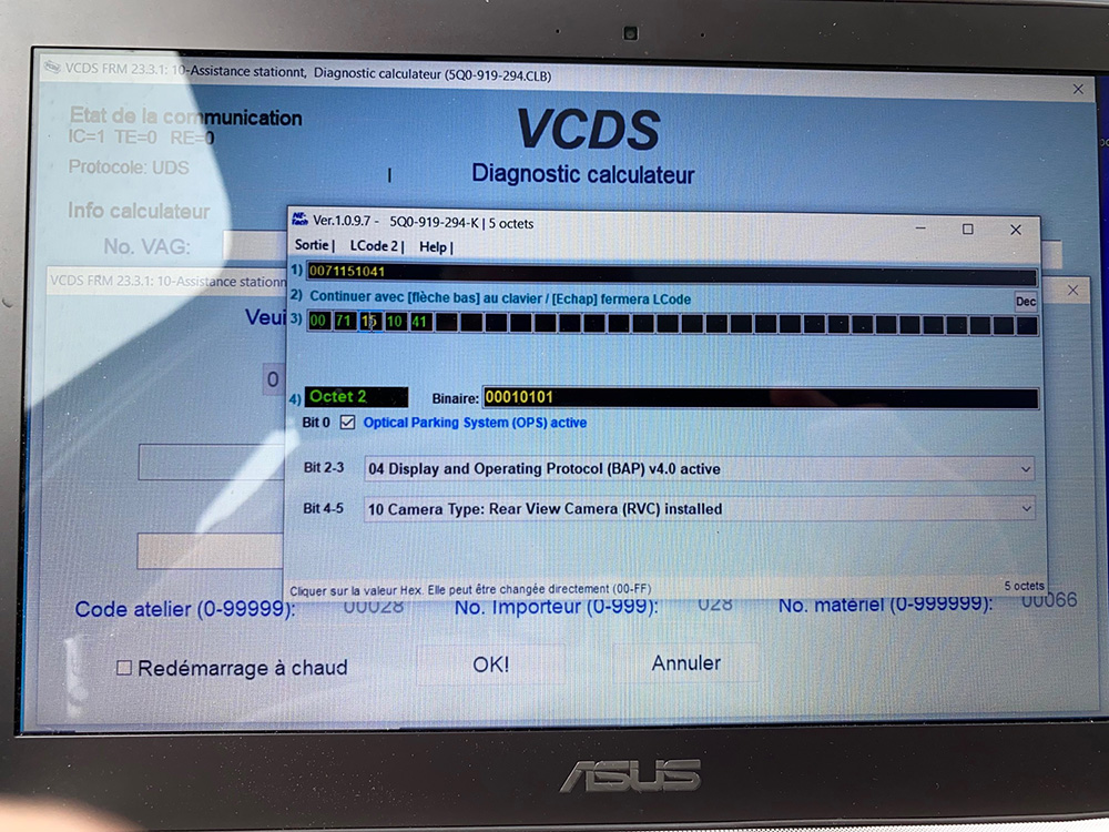

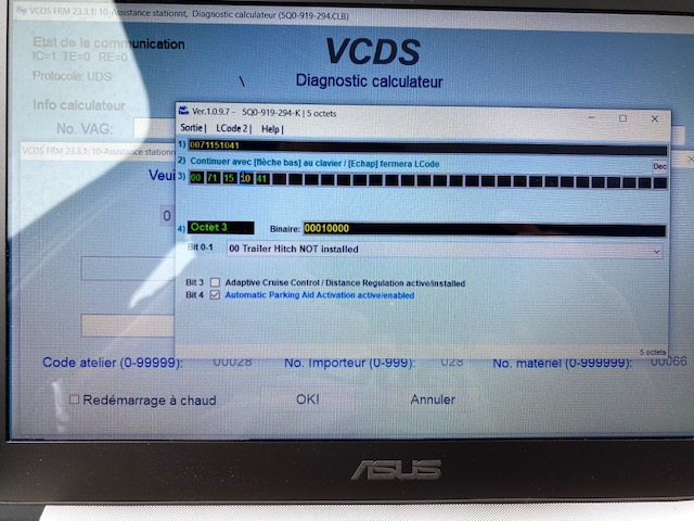

Code 1.jpg (316.08 KiB) Viewed 15658 times
Code 2.jpg (324.03 KiB) Viewed 15658 times
Code 3.jpg (97.81 KiB) Viewed 15659 times
Posts: 8908

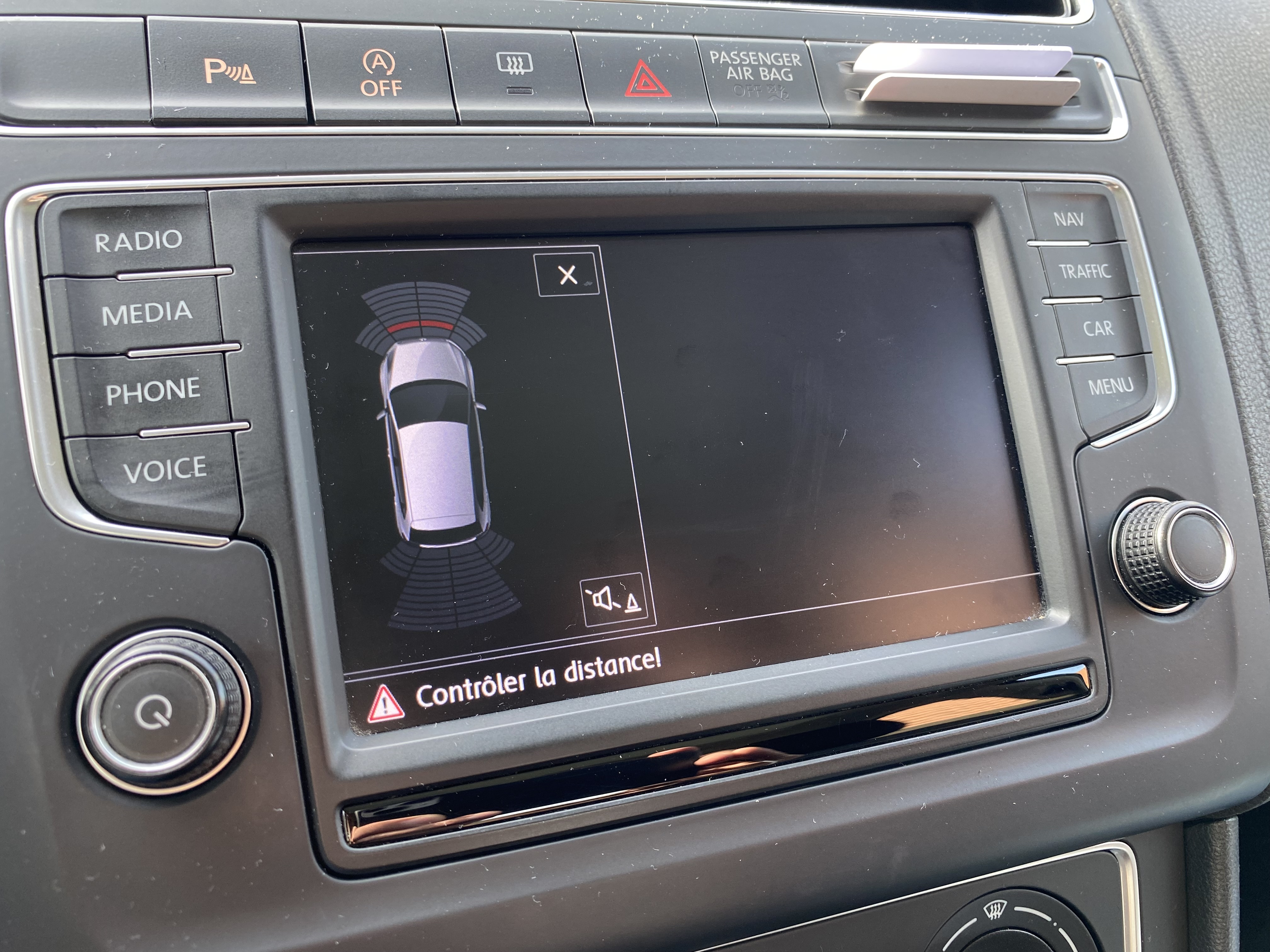

On carplay, when pdc is on, the screen become black, do you have same thing ? Or i need a new coding ?
On radio or gps no black screen.
