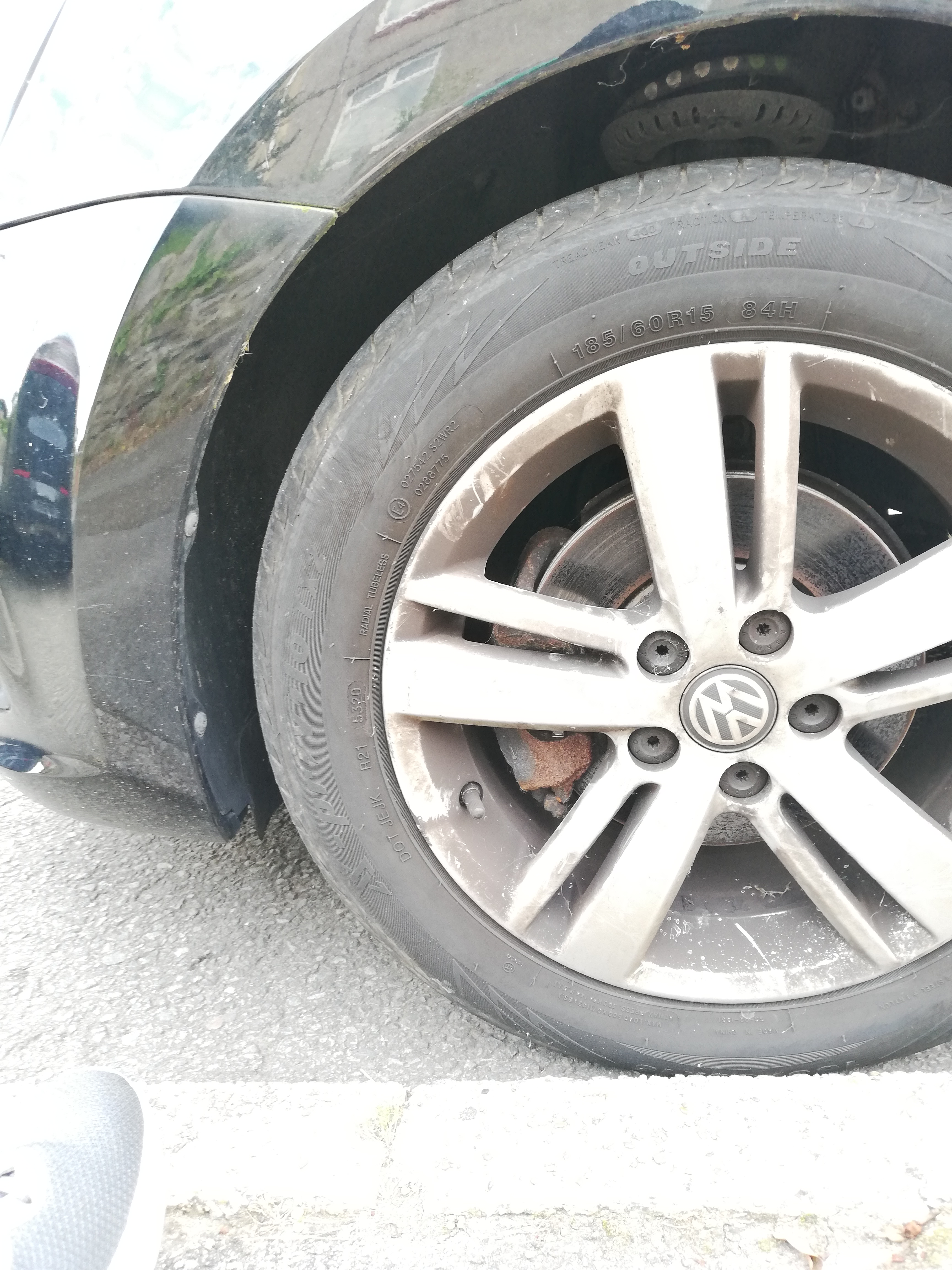

Hello,
I had all new discs and pads front & rear on 18/05/22 @ 25,373miles.
Car now has 25,526miles on the clock.
So the car has done less than 200miles since the new ones were fitted. Polo 6R 2017 plate.

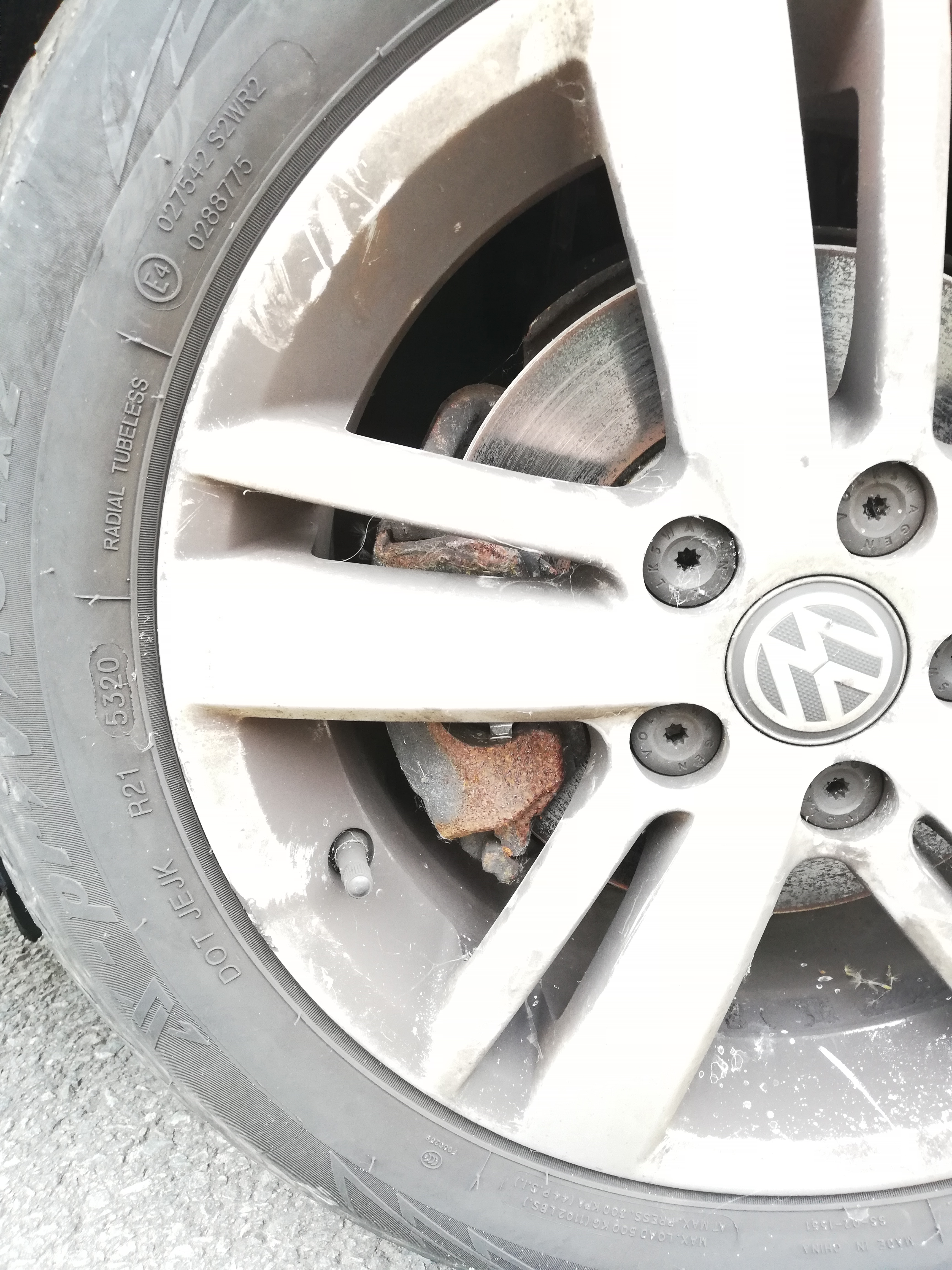

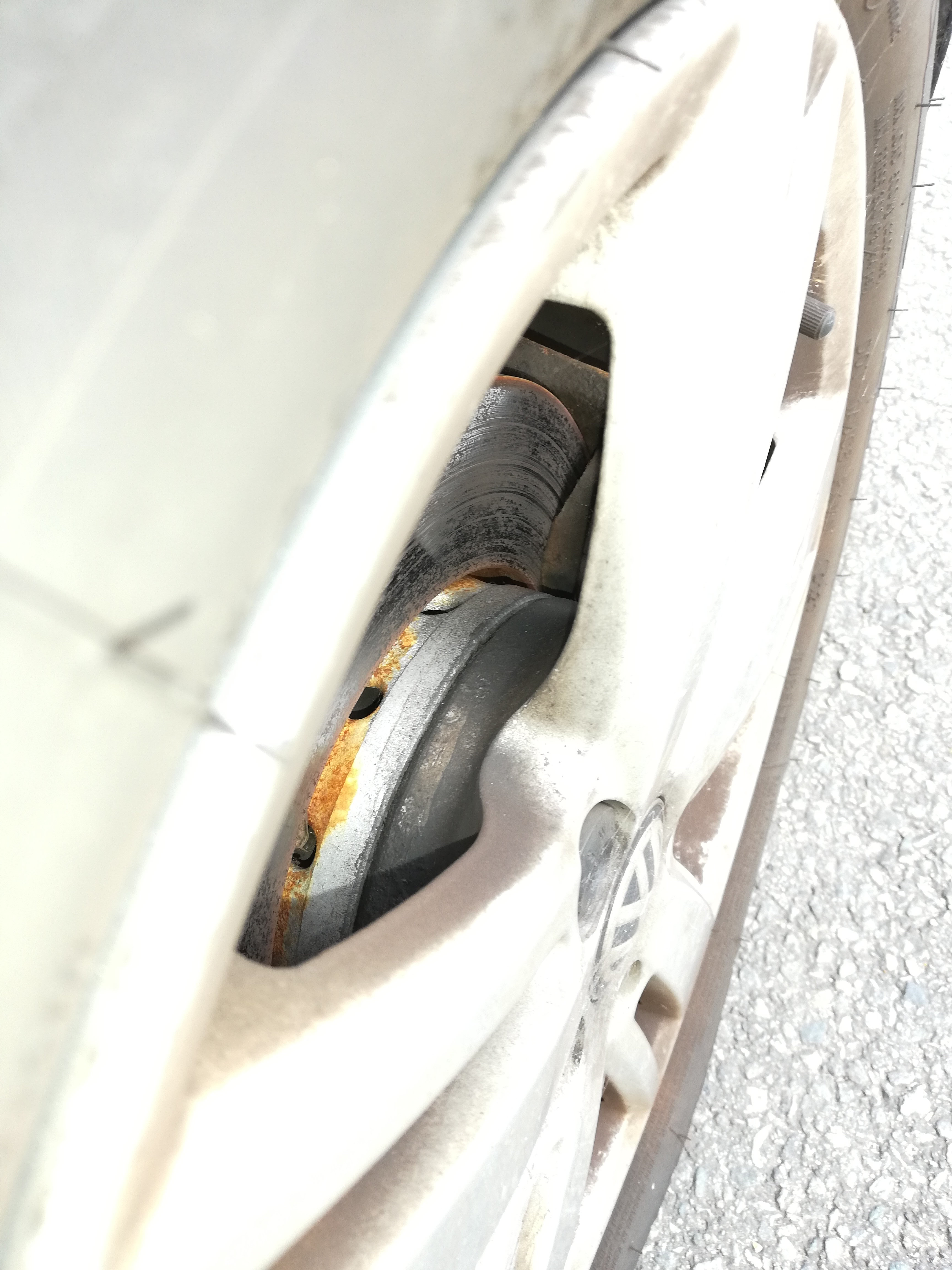

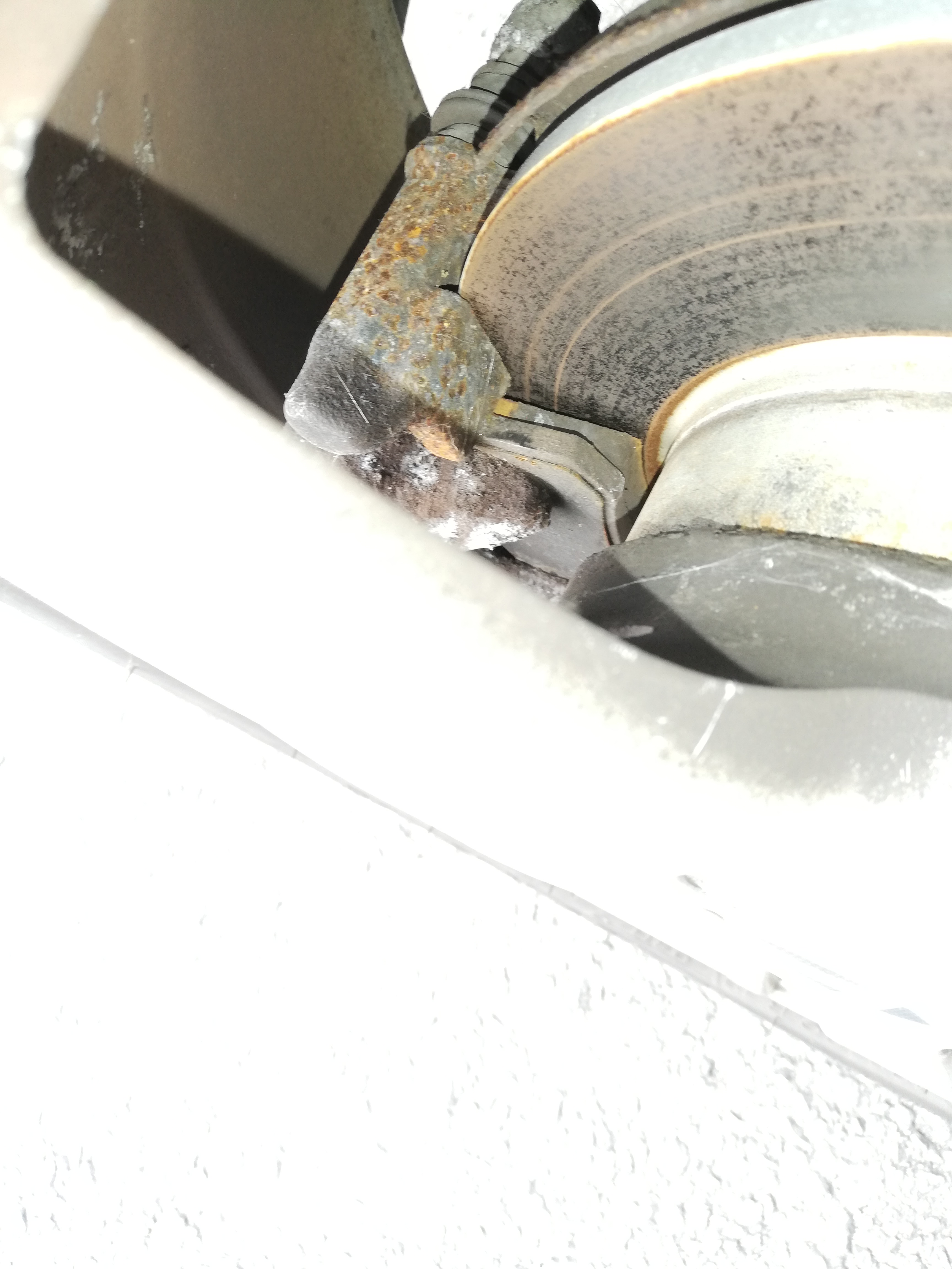

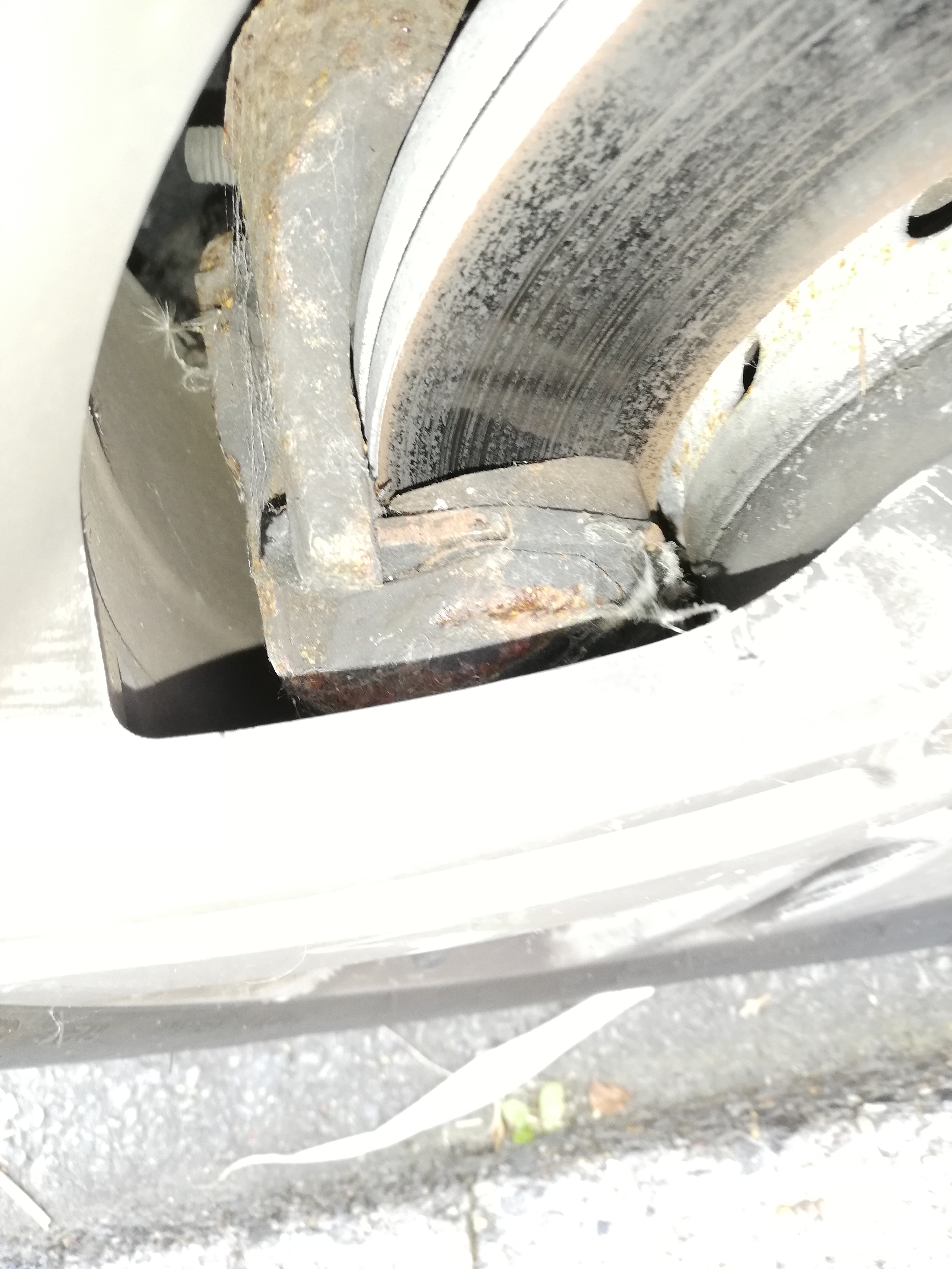

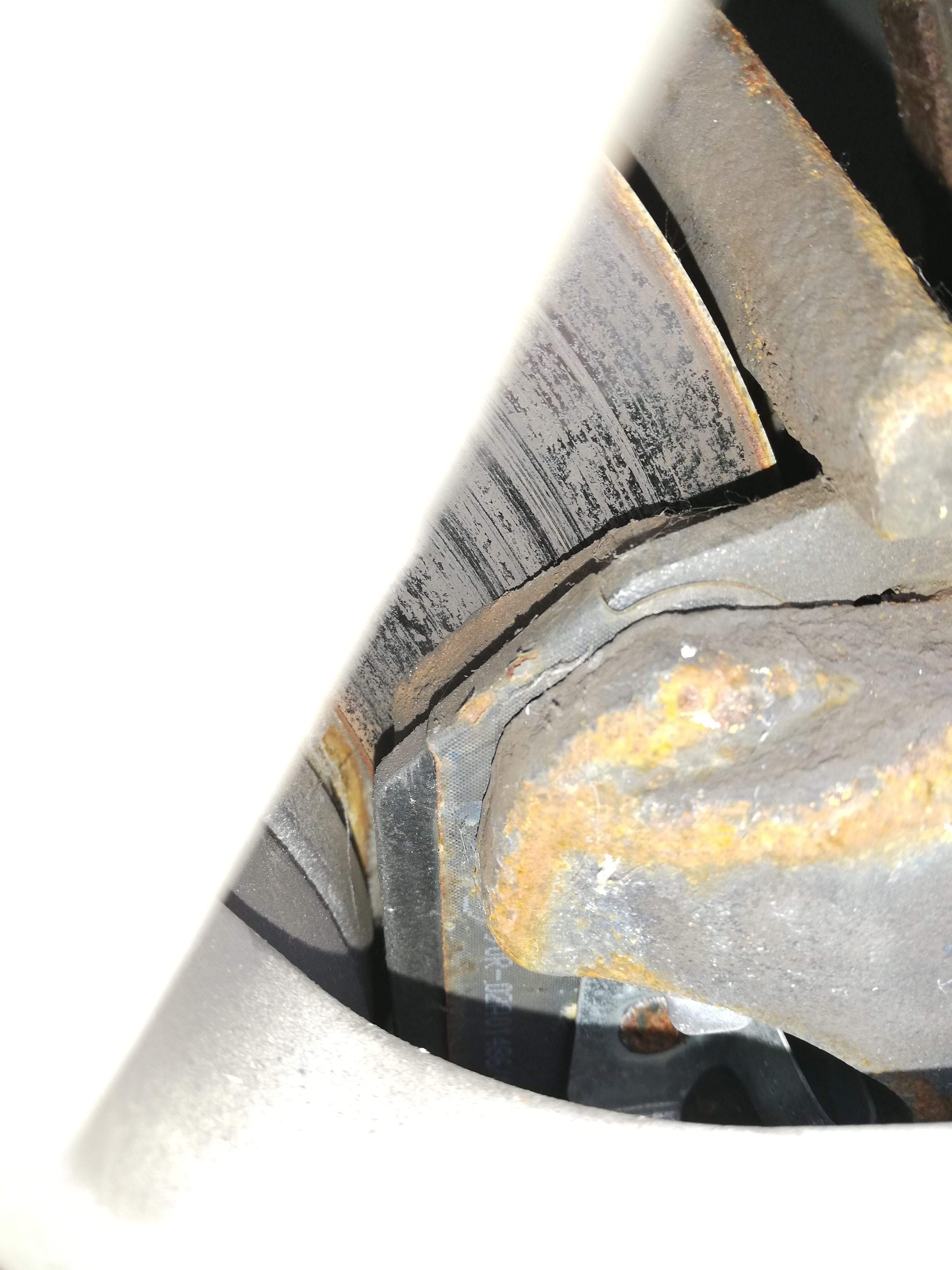

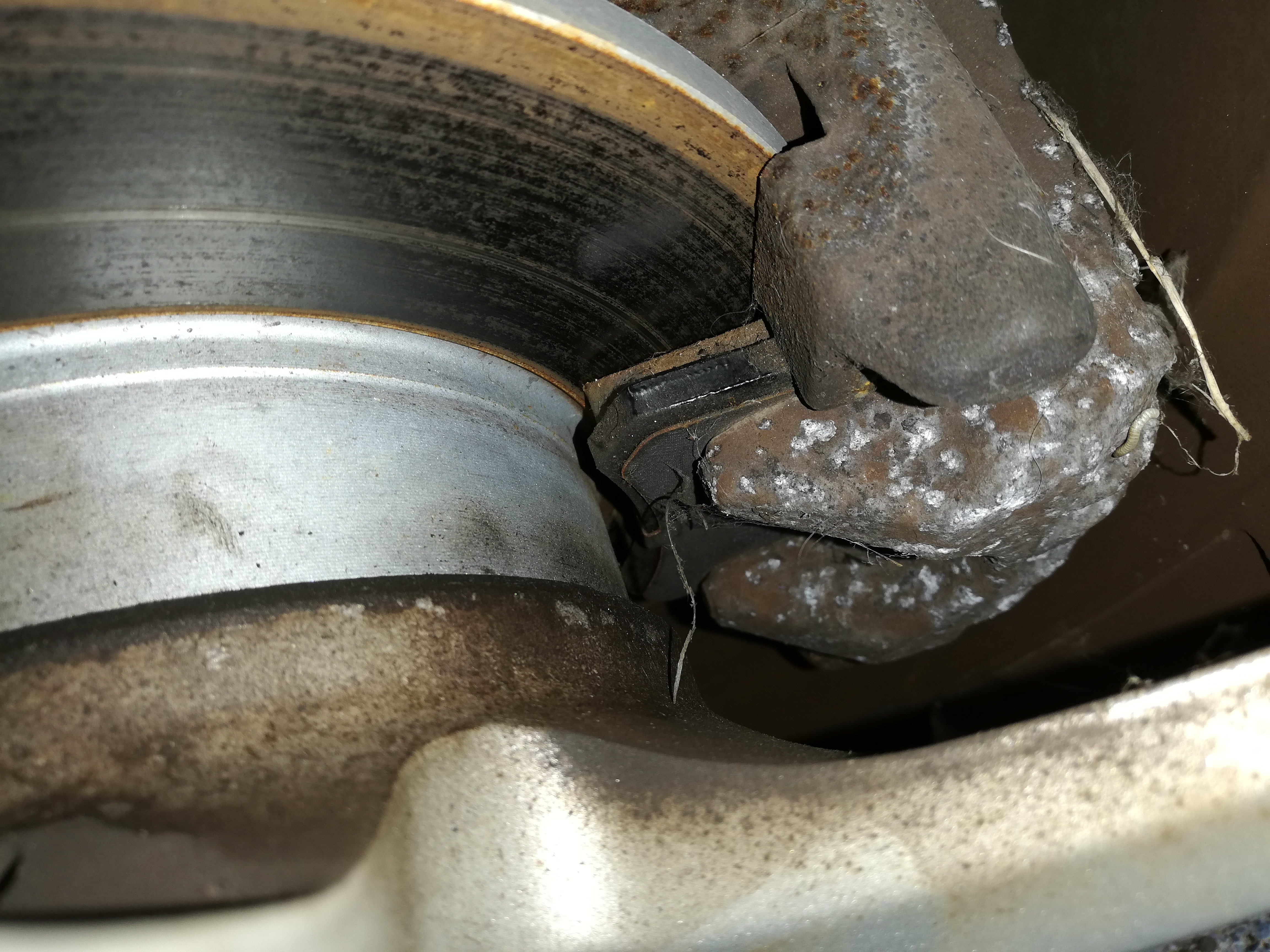

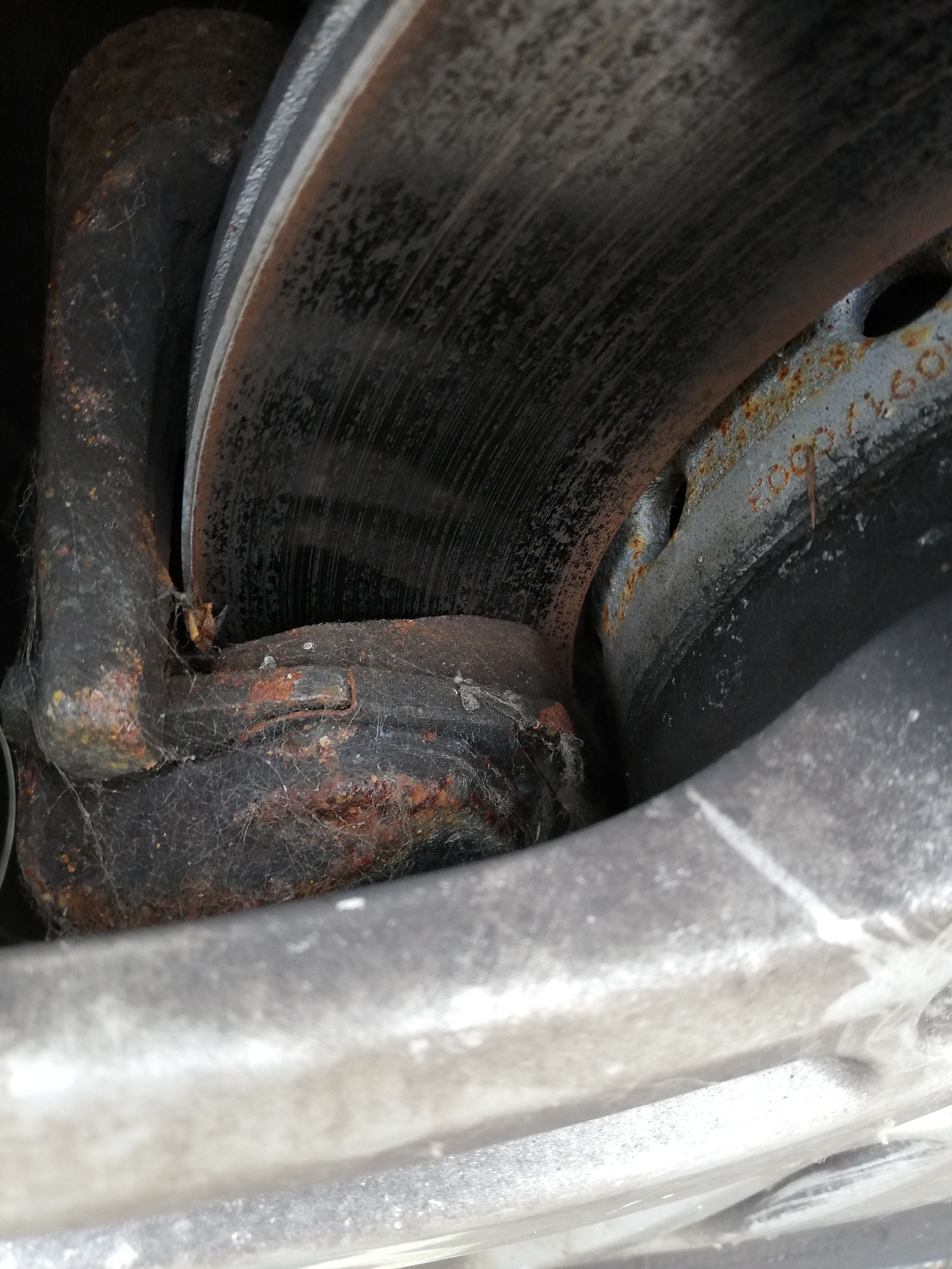

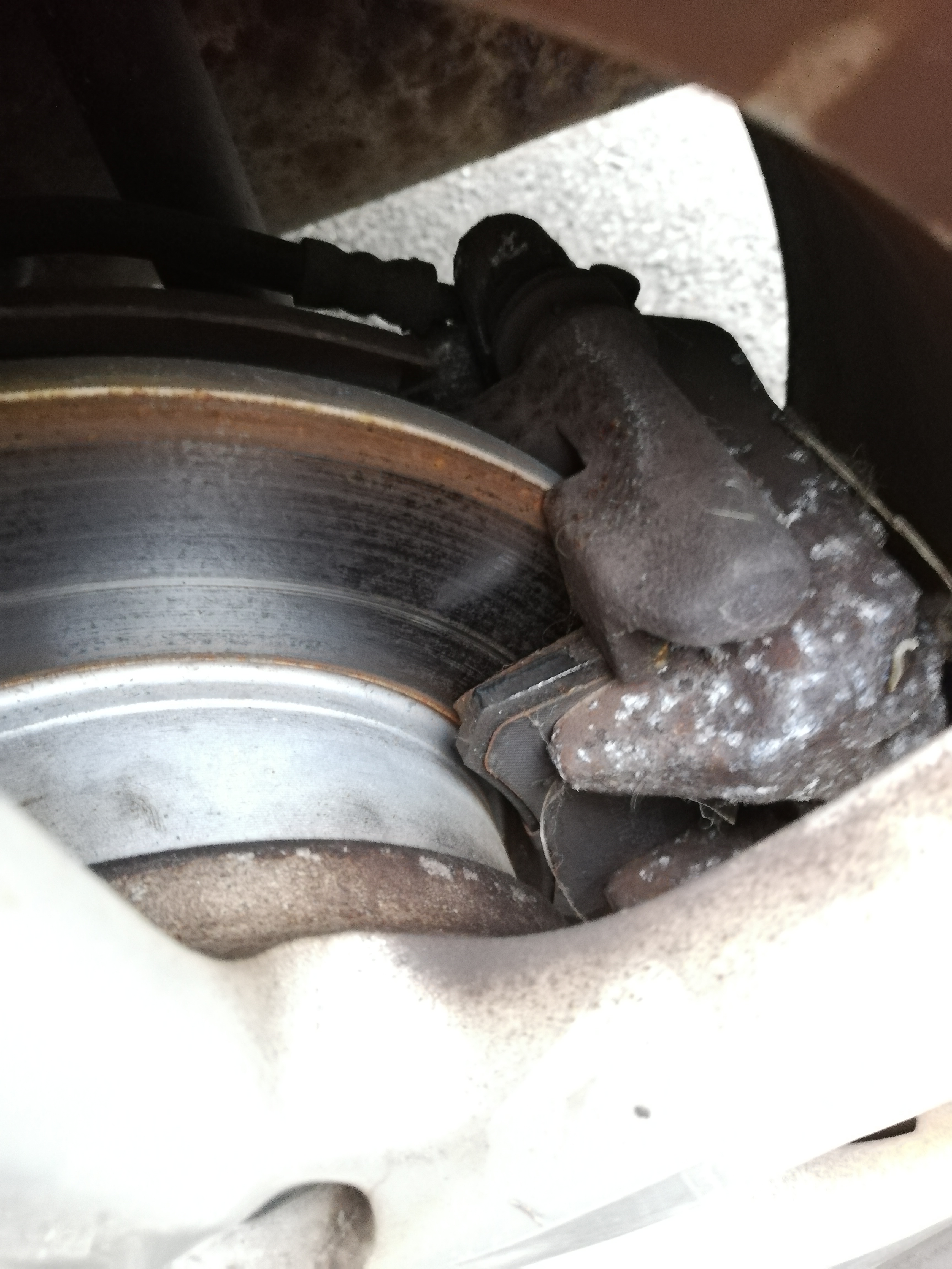

I had a look at the new discs & pads on the day they were done & I noticed that the front pads were not making full contact with the discs. The inside edge of the pads are making contact, but not the outside edge. Obviously this is not what you want with new discs & pads so I looked it up online. There was some suggestions that either the wrong pads had been forced in, the pads were not seated correctly in the calipers, the clips were bent etc etc.
But I don't know, maybe they're meant to wear in until they eventually make full contact with the disc?
Well 2 days after I had them fitted I had an epileptic seizure. So I had to stop driving immediately & surrender my licence to the DVLA.
So excuse the state of the pads & discs. The car has been parked on a driveway for 15 months not in use and the discs rusted up. I have drove around the block braking to attempt to grind the rust off with the pads but no joy due to the weird contact. The wheels also make a scraping sound when just driving/rolling. Like the pads are in constant contact with the discs. But this didn't happen when they were first fitted, it's just since they rusted up.
Yes I am devastated about the state of the new discs and pads. Cost me something like £760 to get them replaced. :x
What do you think? Doesn't look normal to me. But I'm not exactly a car expert. So I need some advice here.

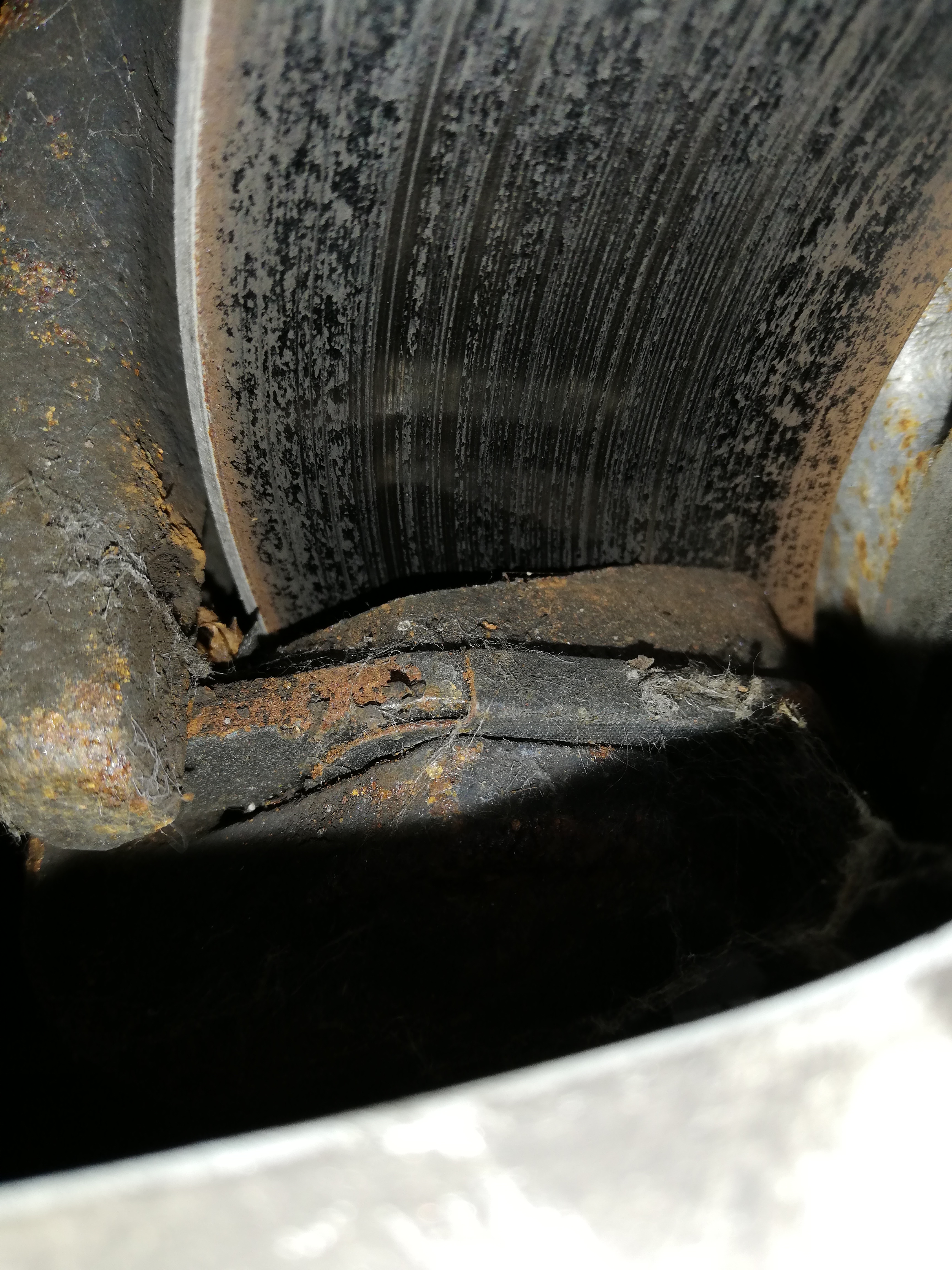

Will attach photos of front & rear pads/discs as the rear ones don't exactly look flat either. They look like they're flat for the most part but have a curved inner part creating a shadow. As if they've been fitted too close to the inside so the pad is slightly off the disc.
Car was parked with the handbrake up.

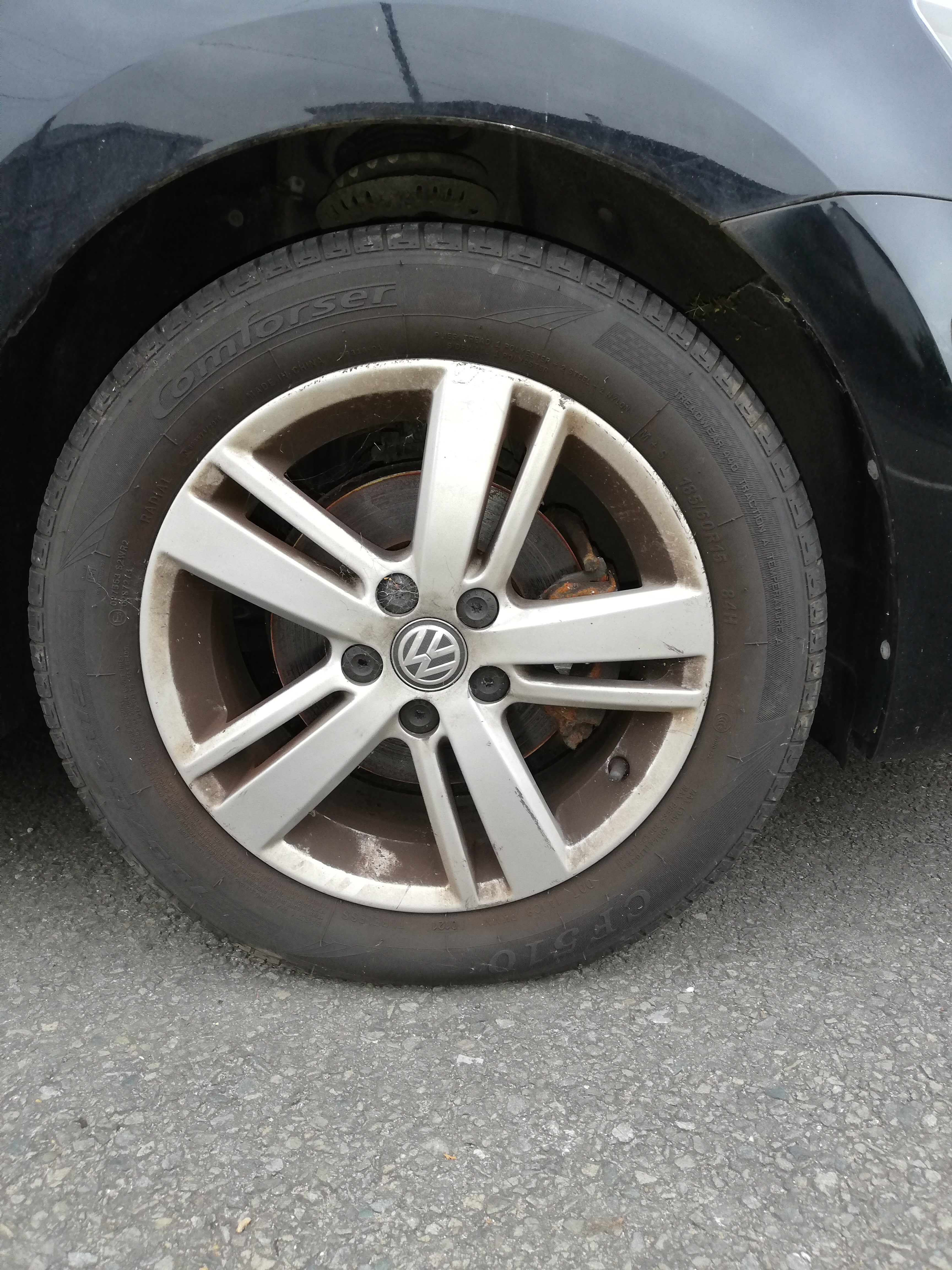

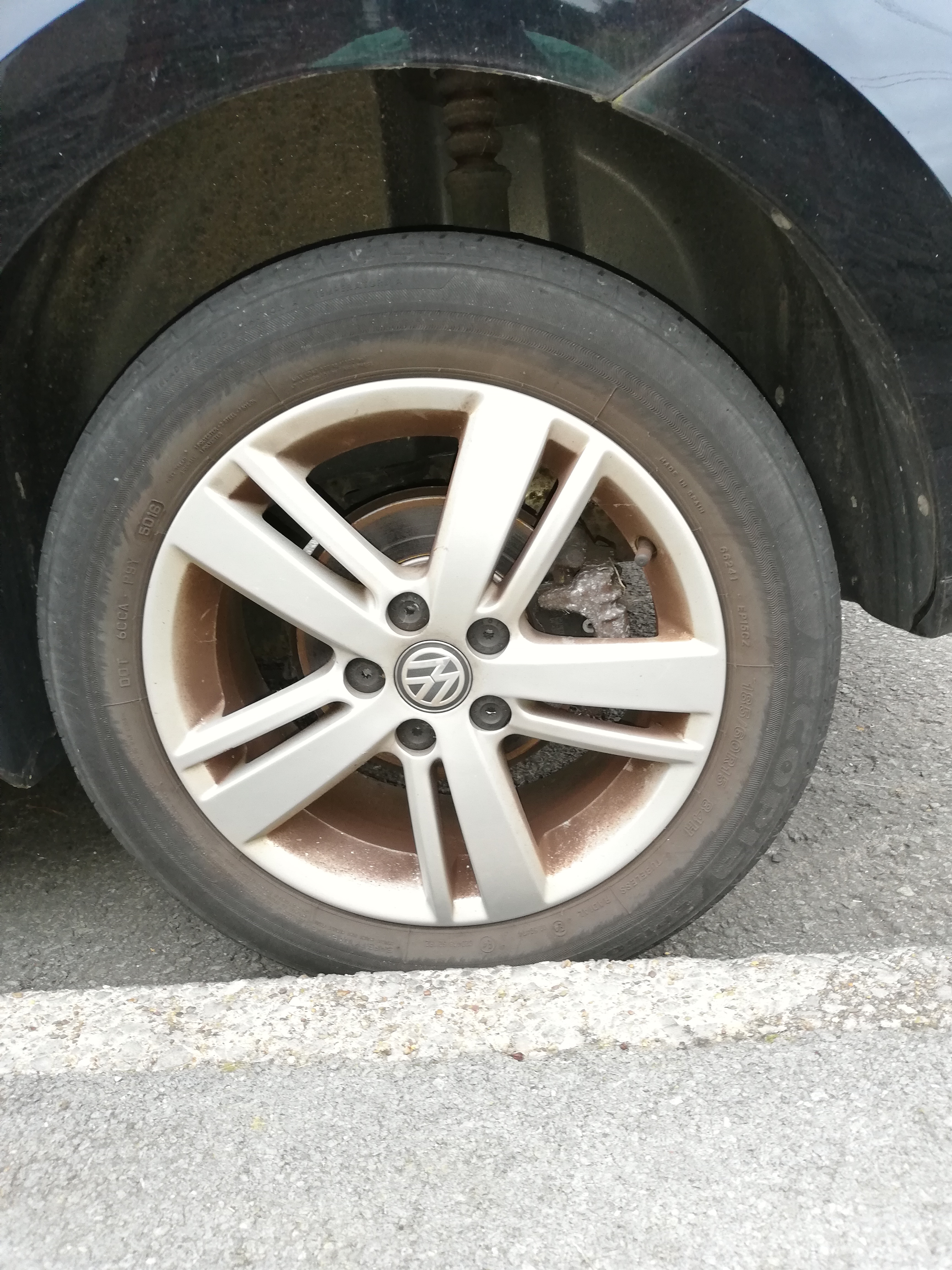

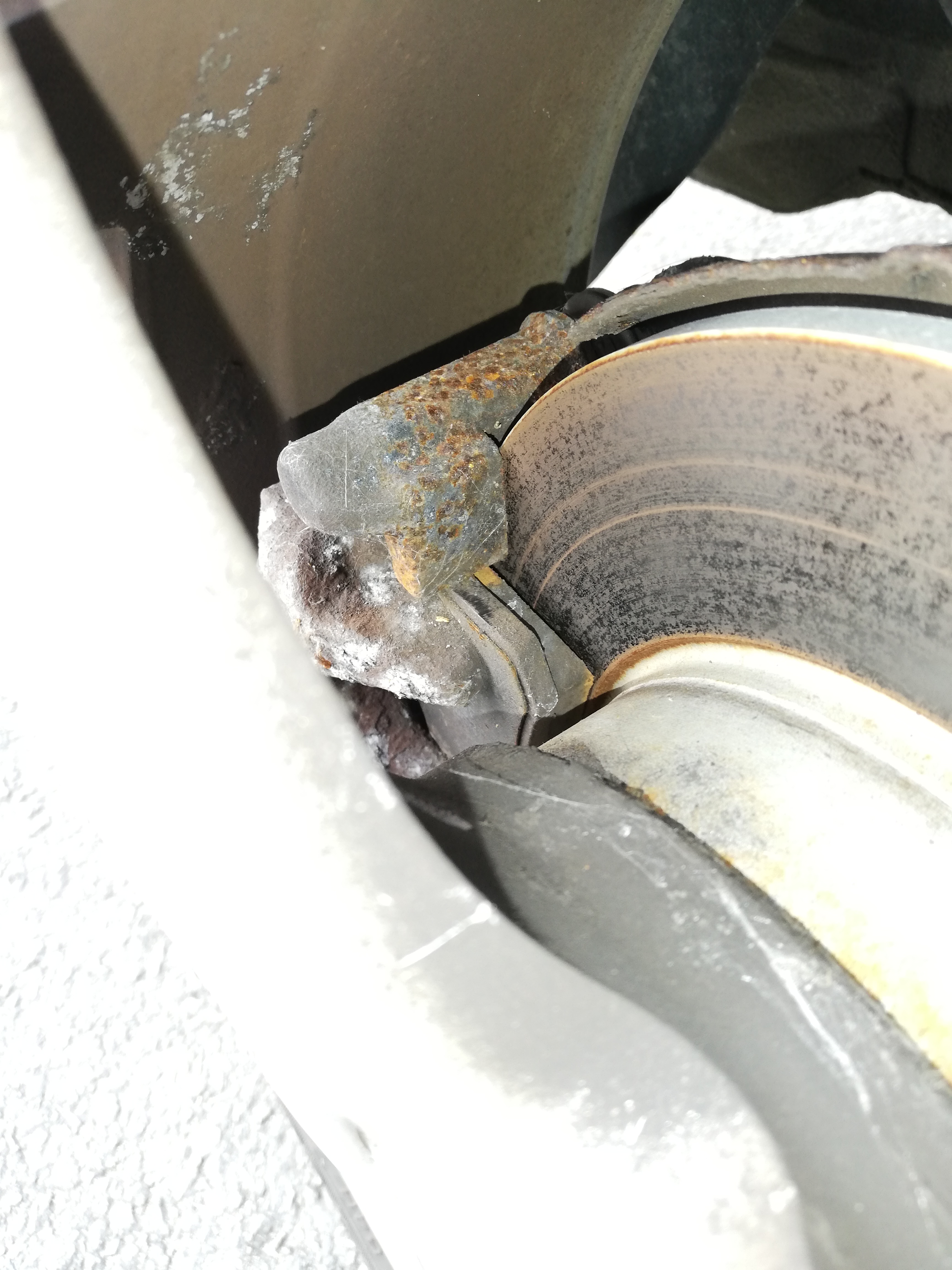

FRONT PASSENGER SIDE:
FRONT DRIVER SIDE:
REARS:
It's possible the garage I went to ordered the wrong type and then did some fuckery to get them to fit. Which might explain how there's such an angle on the face of the pads.
I don't know.
Please tell me it's not as bad as it looks :cry:

Sorry to hear about your seizure hopefully you're still on the up :)

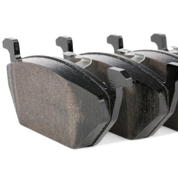

The front pads look a bit funky but I think that's more just from the camera angle. They seem to be making full contact but with the time they were sat a fair amount of rust would build up as you mentioned meaning you won't have 100% pad and disc contact until the rust is gone from the face.
Although there is definitely quite a sizeable chamfer on the front pads. I think if you were to take a picture with the phone up against the disc face you see a decent contact patch. Attached is a picture of pads for the 256mm front discs which I'm 99% sure are on your car being the 90ps model.
The rears look fine as well but just the aformetnioned rust on the disc face.
The scraping noise is either rust on the disc face scraping against the pad or a caliper may have seized in the time it was sat. With the handbrake being left on my money would be on one of the rears as they also have a tendency of collecting a lot of crap.
£760 seems a little steep considering the cost of the parts from the likes of ATE, Pagid, etc probably doesn't come near £300.
I'd take it for a longer drive with some higher-speed braking for example a national limit dual carriageway with some roundabouts after some of the rust has been cleared off driving on some slower roads to try and get the discs as clean as possible.
Once that's done it'll be fairly easy to see a seized caliper as the rust will still be there in a section of the disc.
Maybe consider a tank of momentum or vpower (whichever is cheapest or easiest to get) to help clear out the fuel system and the long drive will also help with getting the moisture out of the oil if you don't wish to change it.
Also being a 2017 yours is a 6C.
Hopefully, all that helps :)
256mm pads.jpeg (32.87 KiB) Viewed 3658 times

I'm sorry to hear about your health issues, but this car is just a victim of circumstances, and nothing more.
I'd suggest if you want to return it to proper running order, you hand it in to a garage for a bit of all round re-commissioning after its enforced lack of use.

The front pads I have look nothing like that. Those are flat and uniform whereas mine are L shaped/wedge shaped. With an obvious ridge.
On the passenger side outer pad it's making about 12-15mm of contact and the drivers side outer pad is making about 18-20mm of contact.
Is anyone able to upload a picture of their pads making contact with the disc? Preferably 6C / 6R but any will do for comparison

Sorry to hear your health issues. The pads are probably fine. If I remember correctly there’s an angle chamfer on front pads.
Volkswagen pistons do tend to seize. I rebuilt mine 50k miles all round last year with a brake kit from Autodoc, so new dust seals, square seals, ‘o’ rings and a brake fluid change. I also added the rear handbrake return springs and transformed the feel.
At the very least I would get the brakes dismantled, surface rust removed, clean guides and reseat pads with a light smear of ceramic grease. Brake fluid is due every 2 years too. It does take a good couple of hundred miles to bed in new pads and discs, so a few controlled stops would be in order too.

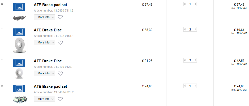

On the subject of the brakes, ATE parts are sub £200 for front and rear discs and pads if they unfortunately need replacing again.
Try and get the vehicle information document for your car from your local dealership's service department. That will give you all the PR codes for what's fitted to your car making getting the correct brake parts much easier if you don't want the garage to source the parts and they're happy for your to get them yourself.
The list attached should be the correct parts, but I can't be certain without the PR codes.
