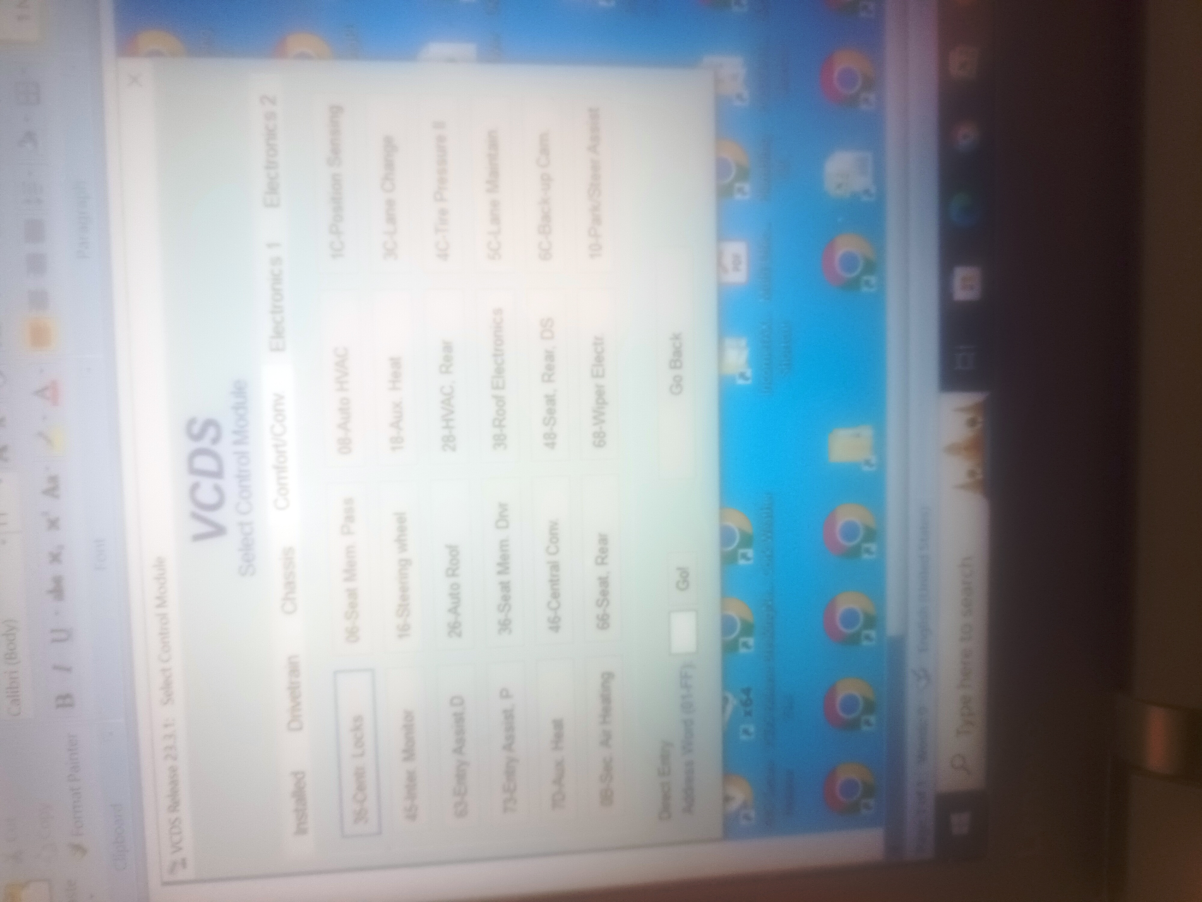

Johntheo1
- Posts: 189
- Joined: Mon Jan 11, 2021 8:52 am
- Drives: 2018 MK10 AW1
- Location: Cork
Re: Boot Unlocking
Thanks for all replies.
I feel I could do somthing if I could gain access to this but all the selections just time out after 30 secs with message "controller not responding", excuse quality of photo.
- VCDS Select Control Mode Photo.jpg (2.55 MiB) Viewed 3979 times
grazuncle2
- Posts: 365
- Location: Birmingham
Re: Boot Unlocking
Strange..
You'd think that if the remote does open the boot that the module is communicating properly
