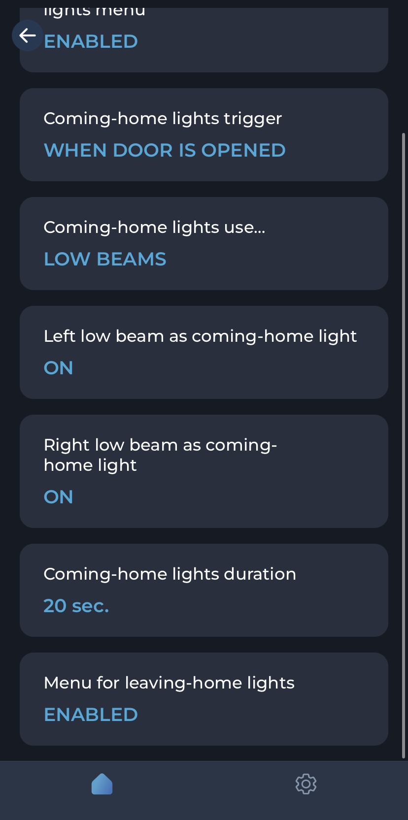

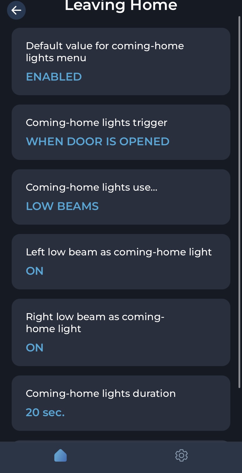

Today I tried to enable the coming/leaving home feature on my 2016 Polo 6C and to my disappointment neither the coming home or leaving home appeared to work. These are the settings from Carista:

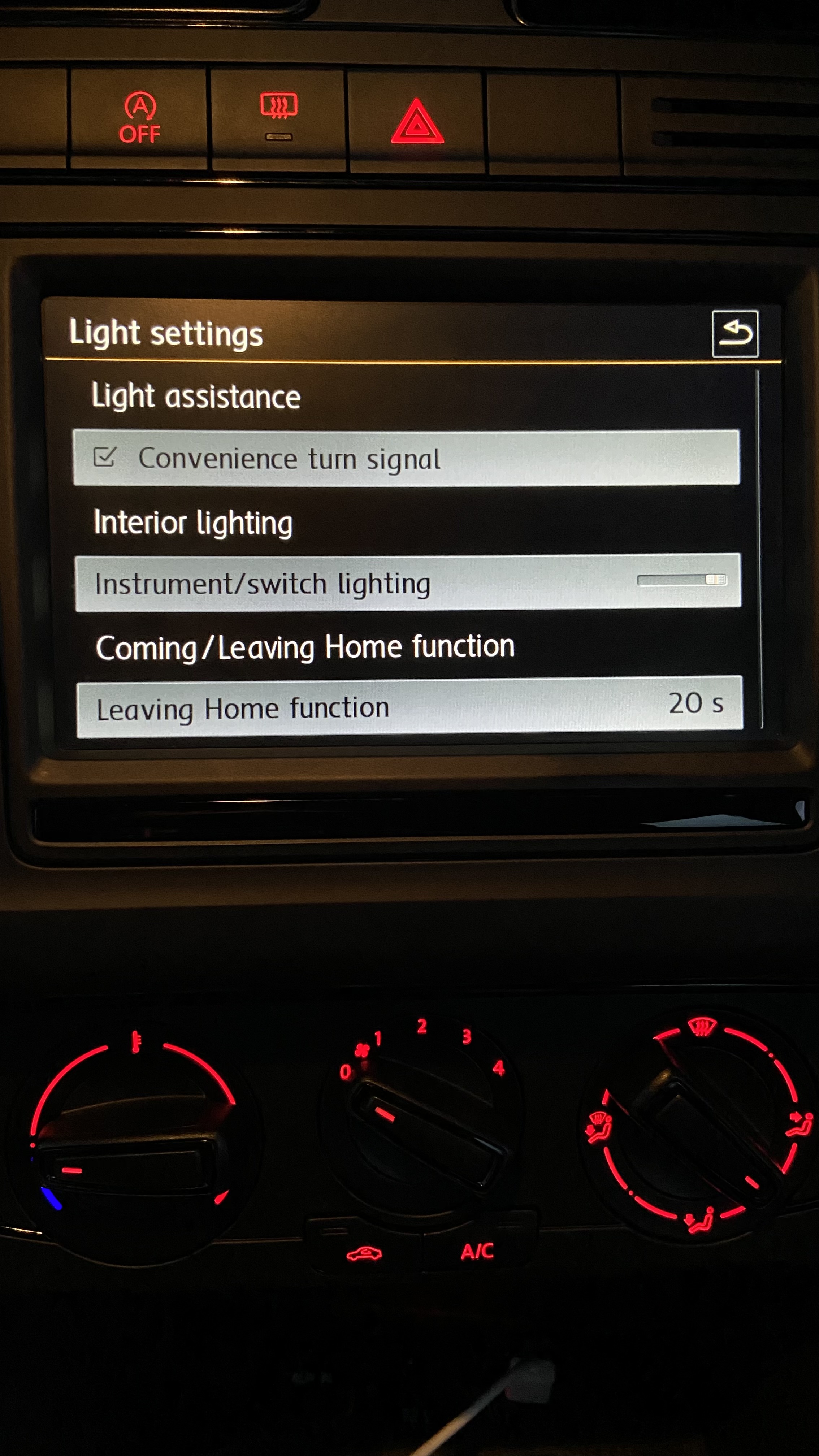

The settings on the MMI:
I should note that I don’t have the auto headlight function, but rather just the three settings on the light switch. Do I need this auto headlight feature? I tried turning off the ignition, flashing the lights for one second with the paddle, then opening the door… and nothing happens. Likewise for the lights when unlocking the vehicle. Perhaps my trim level doesn’t support this function?

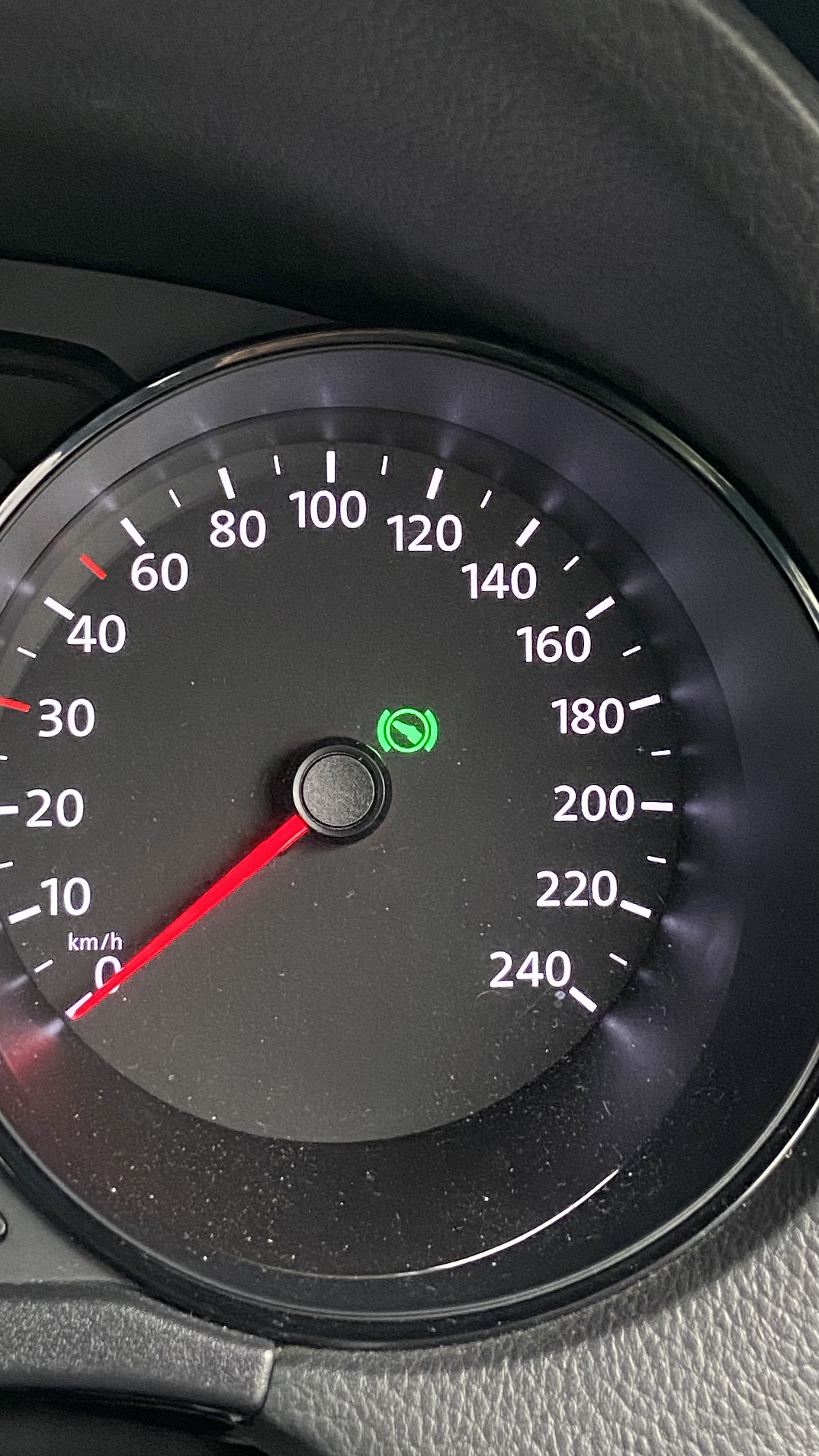

On an unrelated note, is it common for the speedometer needle to sit just below zero as seen?

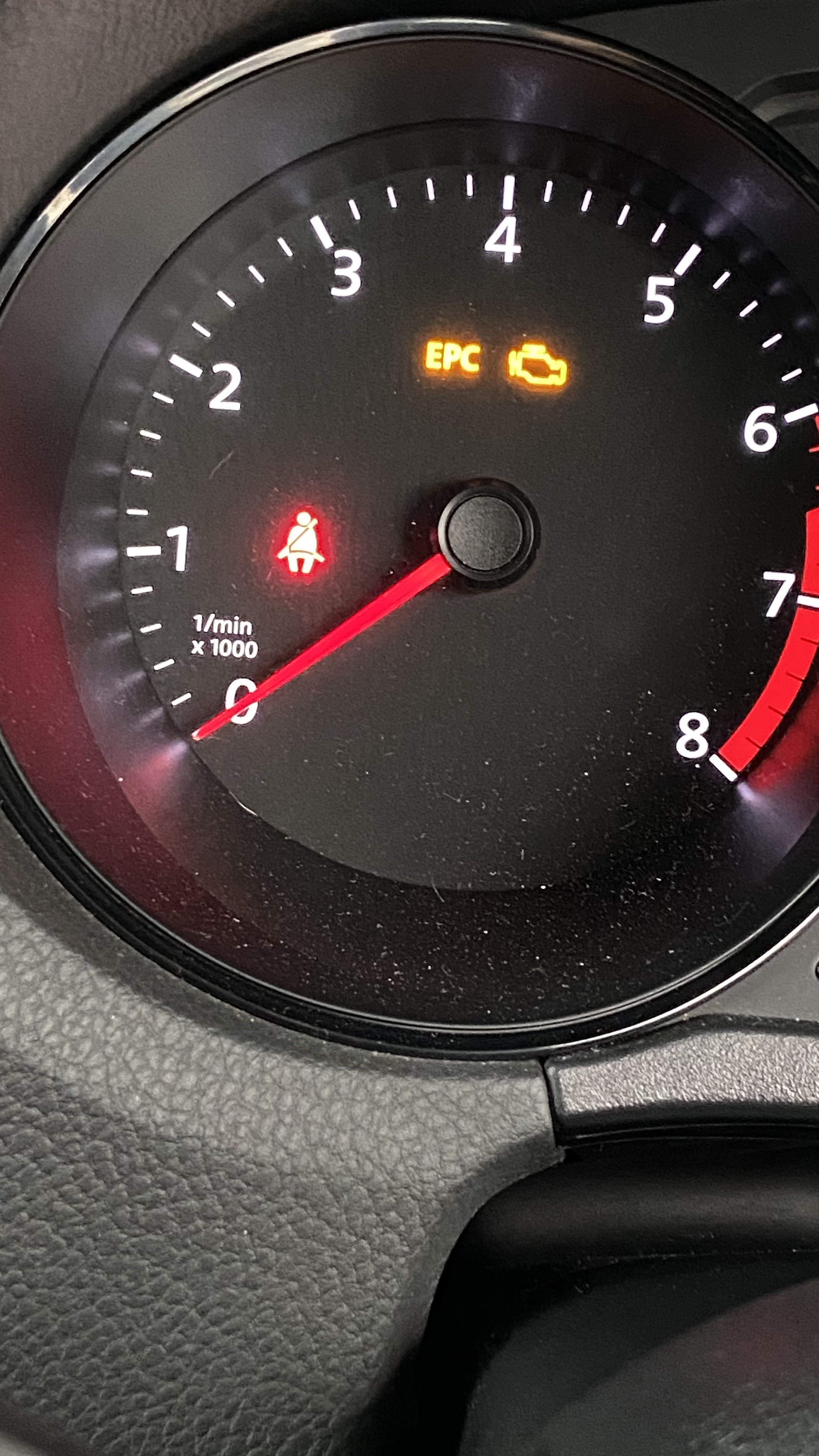

My RPM gauge needle sits at zero:
Re: Coming/leaving home feature on 2016 Polo 6C
Does your car have the oem automatic light installation?

I do not believe so unfortunately.
then the coming home and leaving home also won't work I'm afraid

Ahh ok! It was worth a try while I was enabling the needle sweep on the cluster unit. Speak of which, does your speedometer needle also dip slightly below zero? I noticed it when setting up the needle swipe and now it bugs me slightly :lol:

With G397 light/rain sensor, maybe you will get something if you install Auto light switch and new wire from T10/2 to T73a/43
, then you code the functions in the BCM to know if it works.
The position of the speedometer needle is as it should be.
Calibrating analog/common/prehist😁ric clocks has those things. The important thing is that it measures correctly in the most common speed range, that is, the one that if you exceed it you will be fined without mercy. https://www.youtube.com/watch?v=h5FHH9MV14o :lol:
mine does, yeah, and my 90 degree coolant temp meter is also not perfectly centered. that also bugs me. but it's my own fault since i regularly take apart my speedo

Haha that’s a bit reassuring to hear it happens. I’ll have to get used to it probably. I’m surprised the software doesn’t pick it up and adjust for it. Perhaps there is a way to tune the needle position through coding? Although I’ve never seen an example of this being done. The position could be stored in the EEPROM memory.
Posts: 9037
This is how it looks on my 6R (the camera lens also has an influence). Today.
Also calibrated with absolute manual precision 🧙‍♂️ with the VCDS Output Test for the instrument cluster.
I seem to remember that the Output Test provides two or three checkpoints within the entire range. You then 'interpret' the displayed data and with magician gloves correct the position of the needle 'manually' until you get the checkpoints correct (more o less 🤭).
