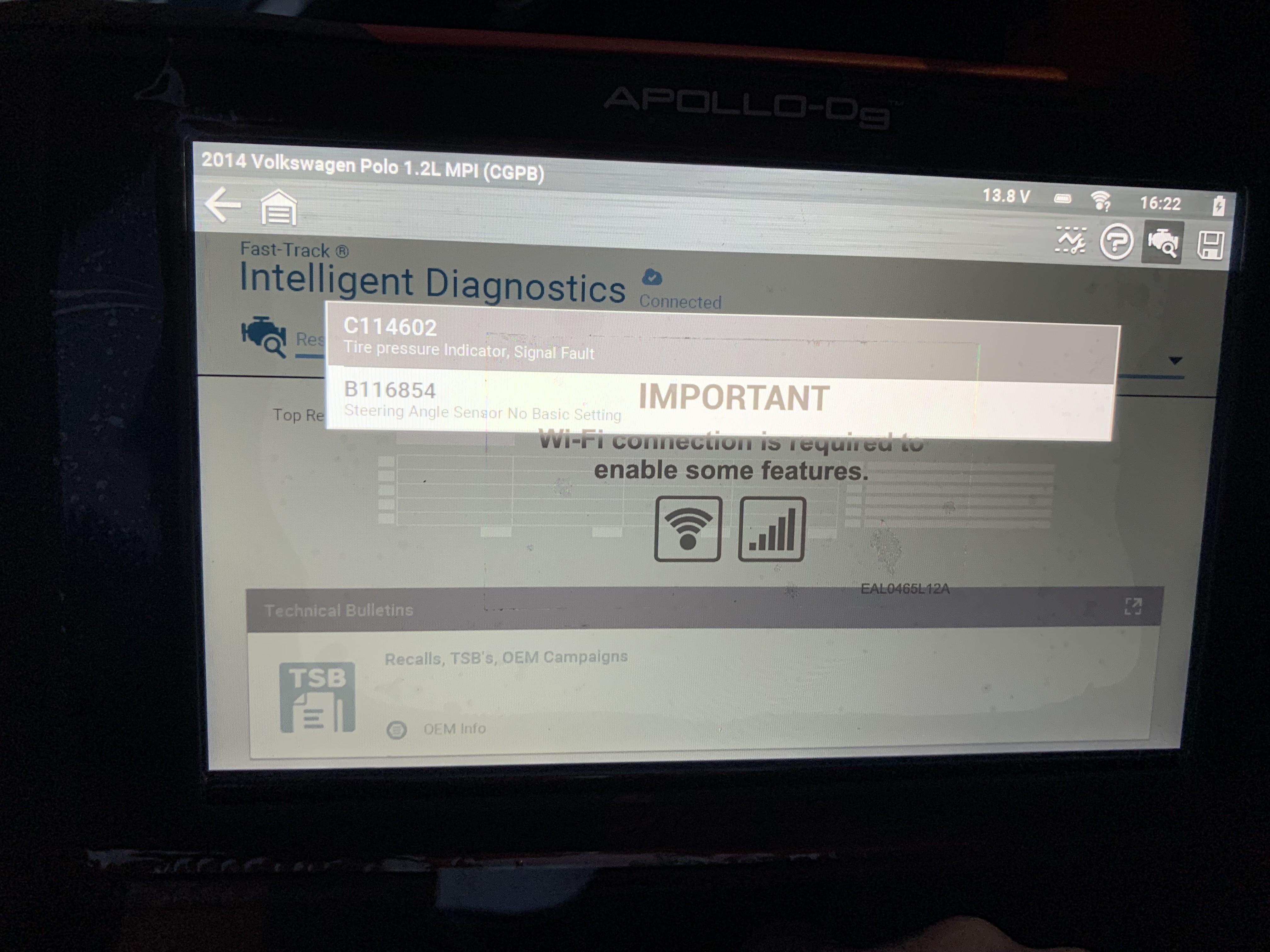

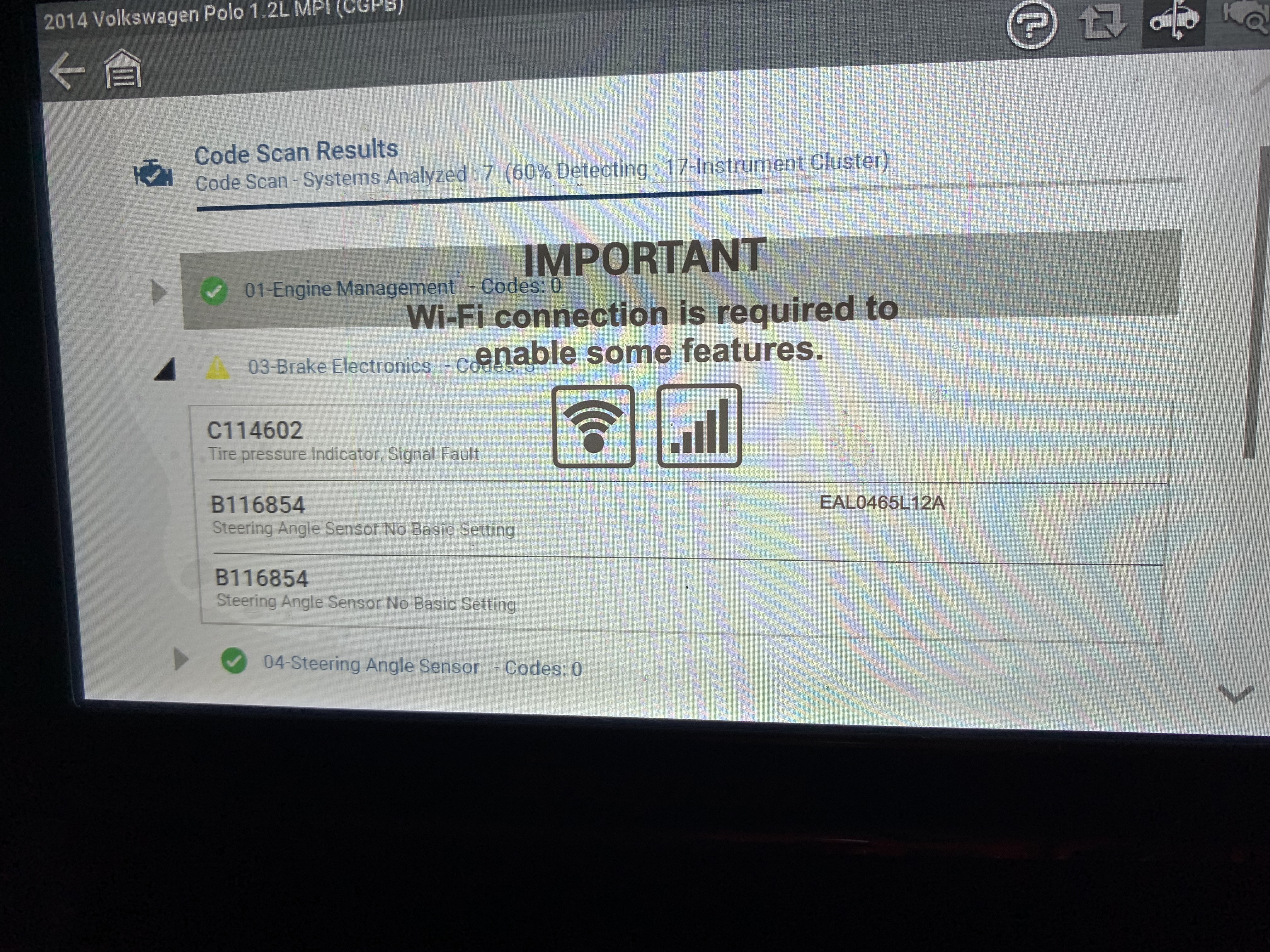

Just added screenshots
Scan
Scan

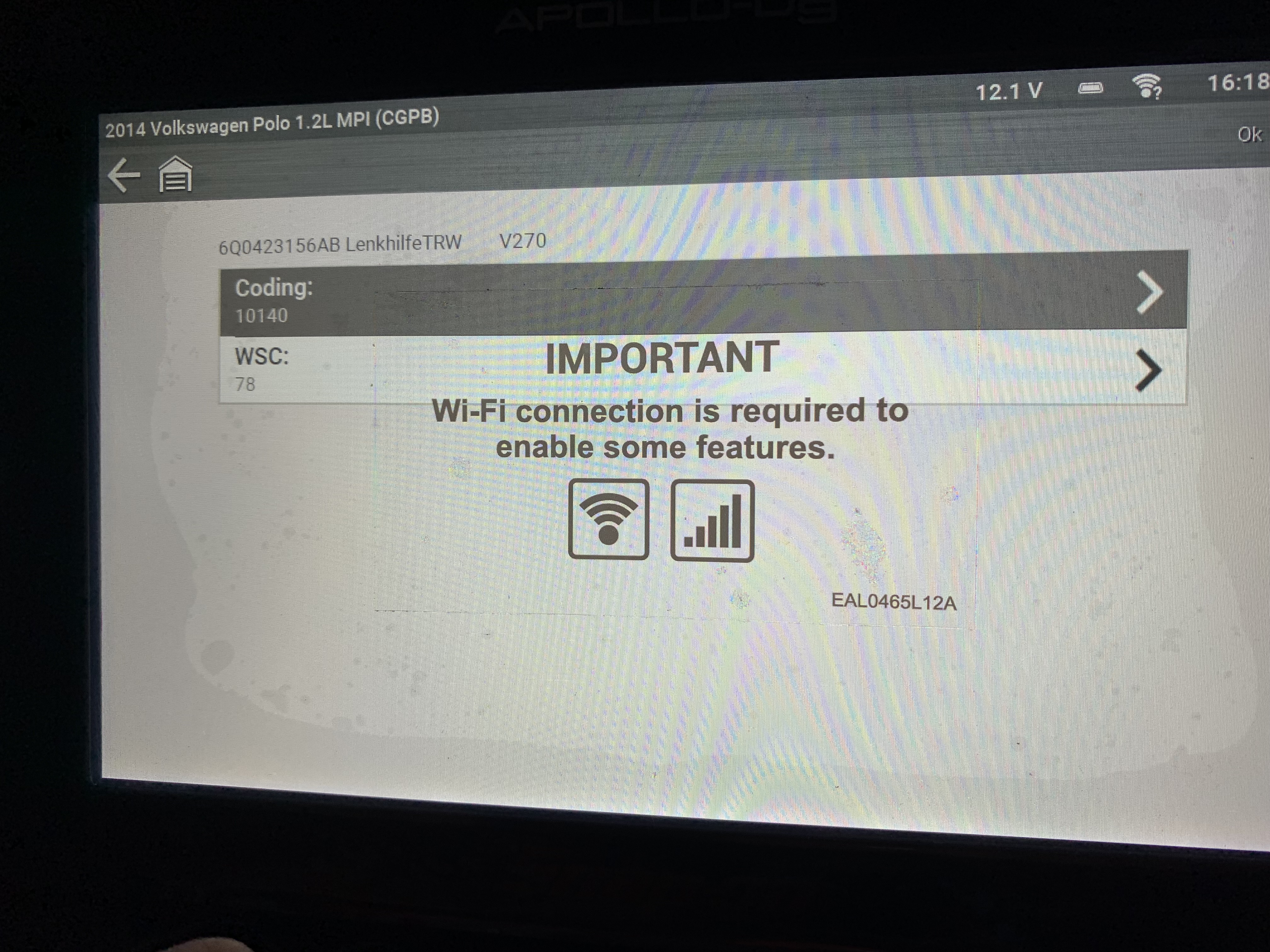

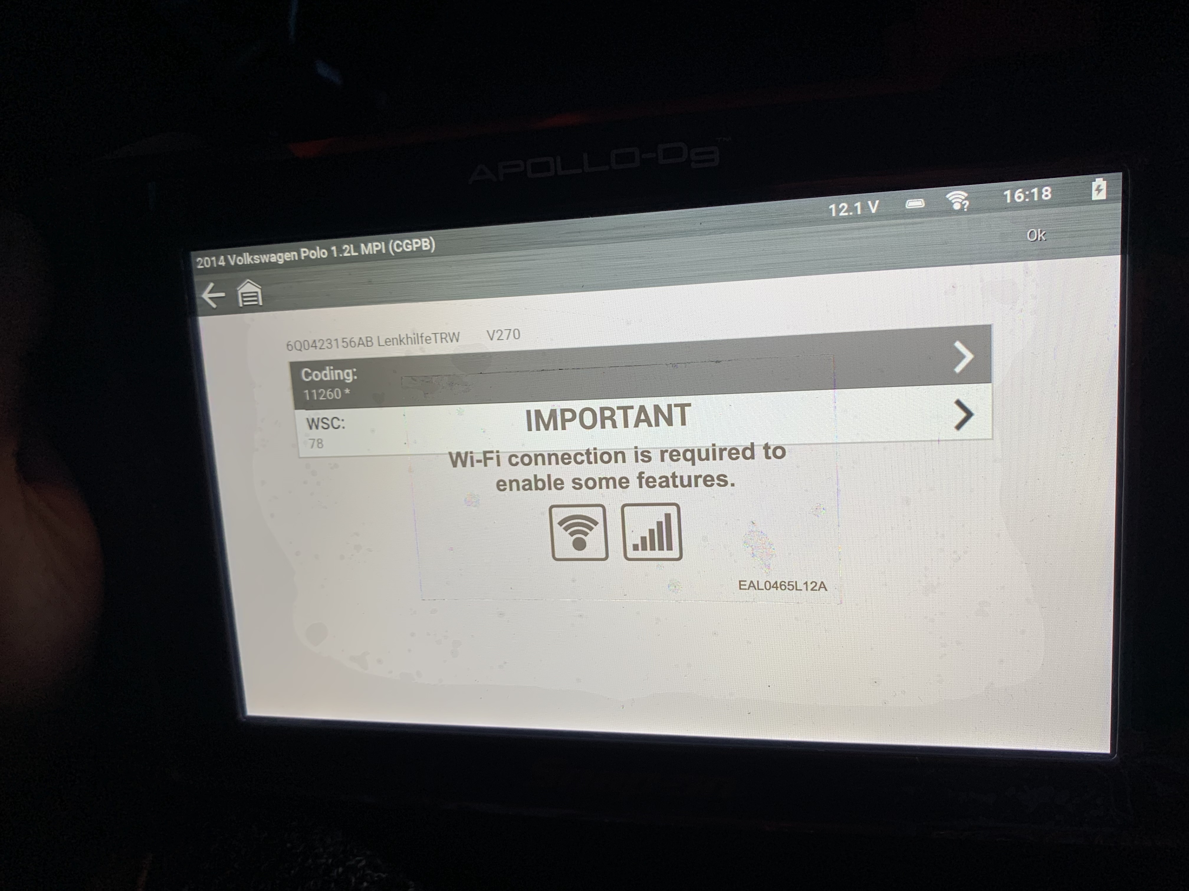

change the first digits of the pump coding from 112 to 101 or vice versa please and see what happens
Posts: 9037
Re: Aftermarket Steering Pump code HELP!!!
:!: To change the power steering coding (Address 44: Steering Assist), it must be done with ignition switch ON and engine OFF.
The most common/normal coding for 6R is '11250'.

Thank you both but still no luck, any other suggestions

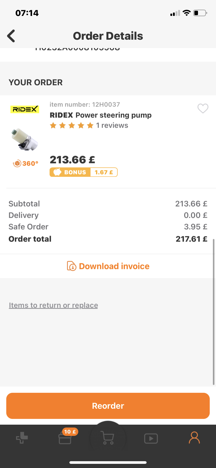

Could you please show us a link to the steering pump you bought at AUTODOC?
What part/reference number did you use to purchase the new steering pump?

This is the pump I ordered

have tried following the video with our launch x431 scanner and the latest snap on Apolo scanner . The problem the codes doesn't match
what is the current coding?

The pump is suitable for your 6R, I leave you the diagram here in case you want to check the fuses.
SA4 is on top of the battery.
SB26 under the steering wheel.

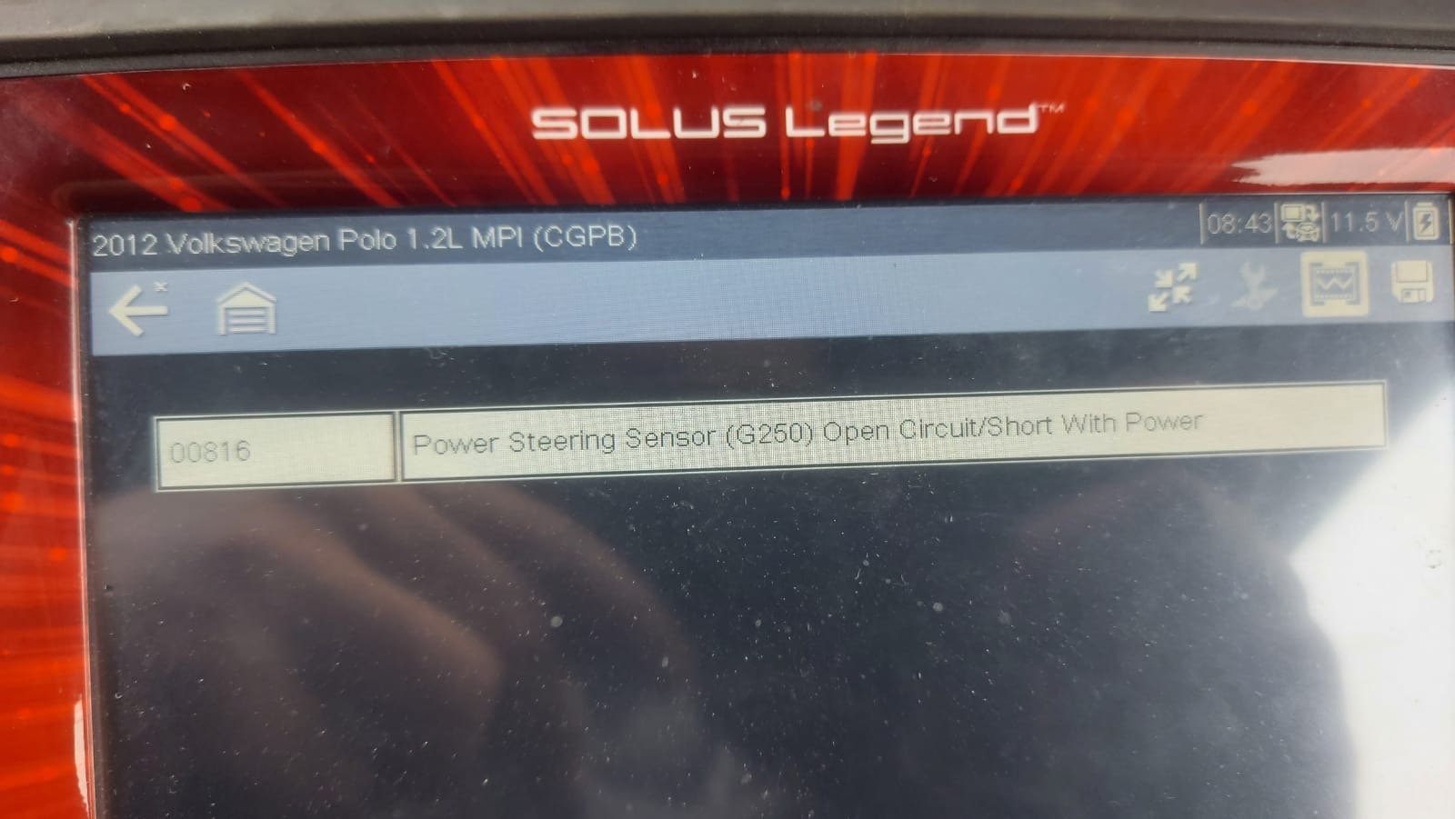

So still no joy I have attached some more pictures of faults etc, we even replaced the steering sensor but that doesn’t seem to be able to see the pump to communicate, I have tried all the codes in this post any more codes would be appreciated and does anyone know if there are any specialist VW mechanics around Croydon, Surrey, UK, CR5 post code, no decent reviews of main dealer mechanics

And these
