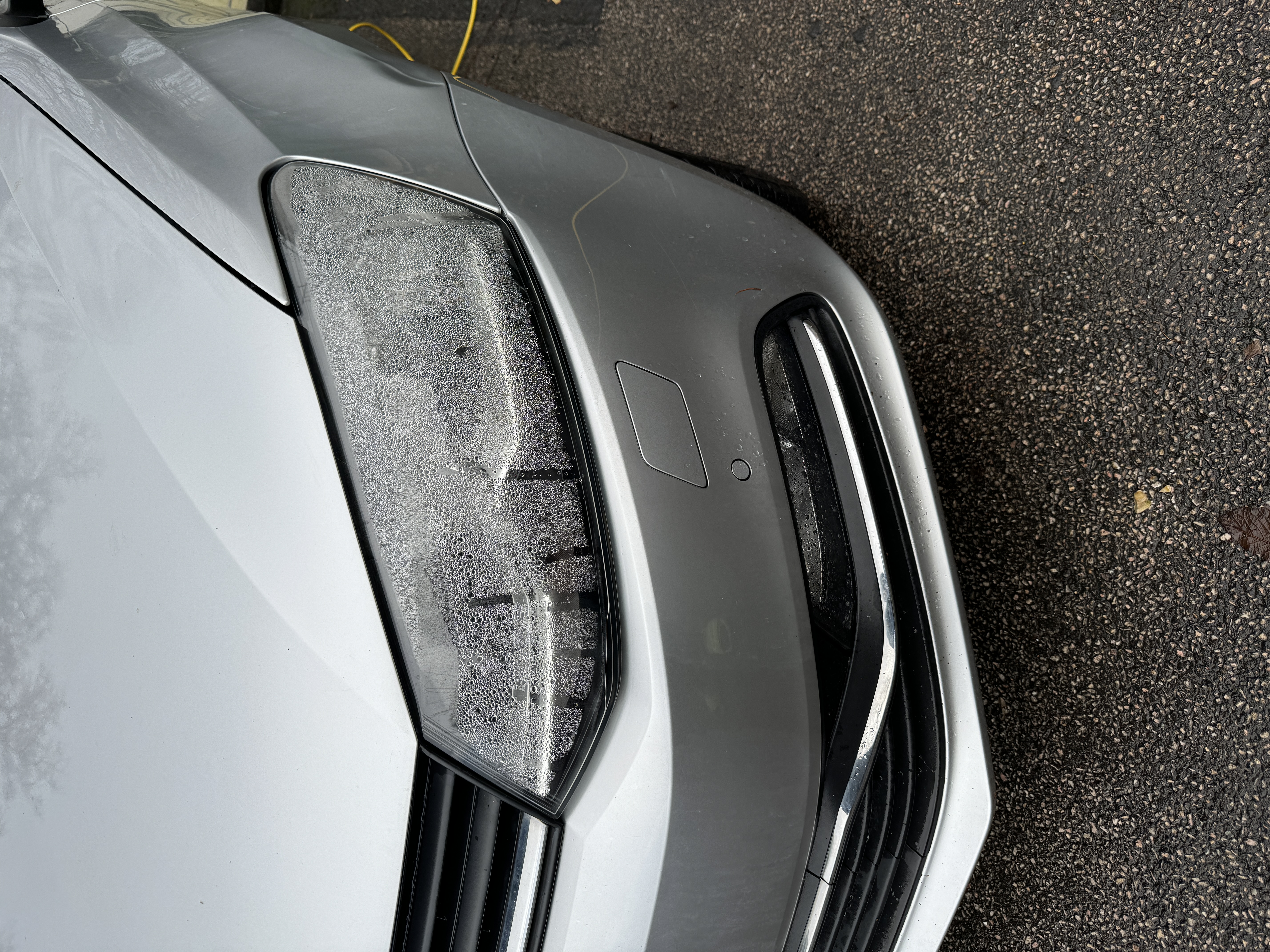

Hi there,
I have a Polo 6C SEL with the factory LED headlights, one of them is full of water droplets with a lot of water sitting in the bottom. This happened last winter and I removed it and took out the bungs and put a hairdryer into it to dry it out, this worked and over the summer it was fine, however now with the colder weather again it has started to fill with water again.
Is there anyway to fix this, if not if I bought a new headlight and fitted it will it need coding in. I have OBD11 and am mechanically minded but am unsure if these LED units require coding.
Many thanks,
Sam
Re: Heavy Condensation / Water in LED headlight
another headlight is plug and play, just needs mechanical aiming for the right declination angle.
