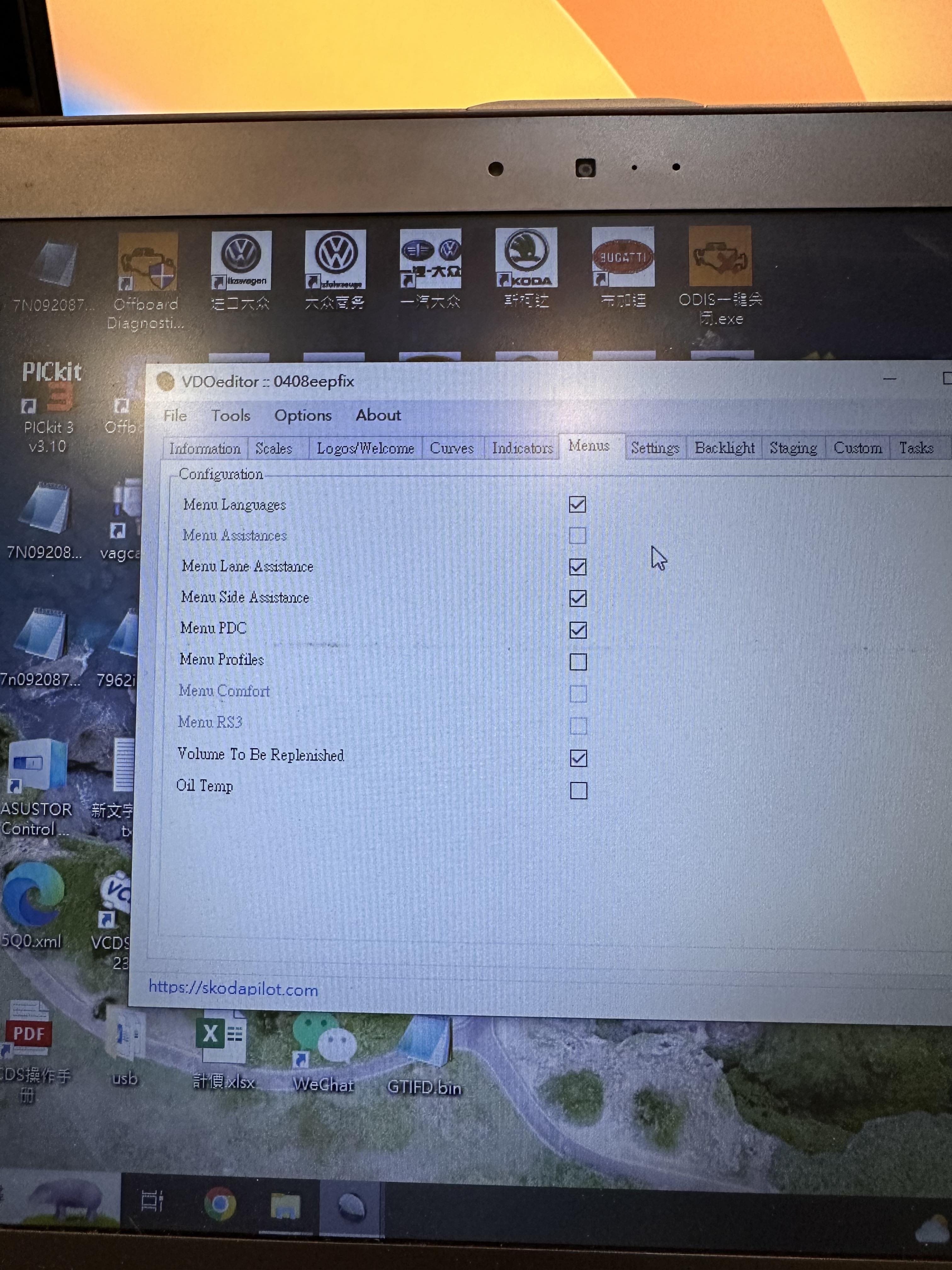

1. Upgrading the instrument cluster from Midline to MFA (6JA 920 940 C SW 0709)
2. Editing the instrument cluster EEPROM, Activating Lane Assistance and Side Assistance

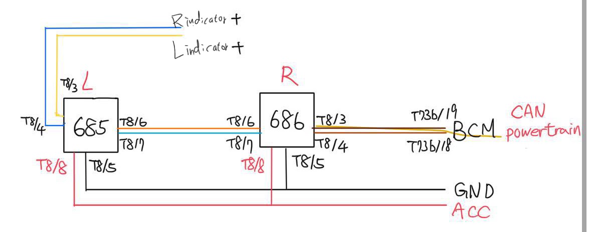

3. Installing the BSD module and Wiring (Not include indicators, still need some time)

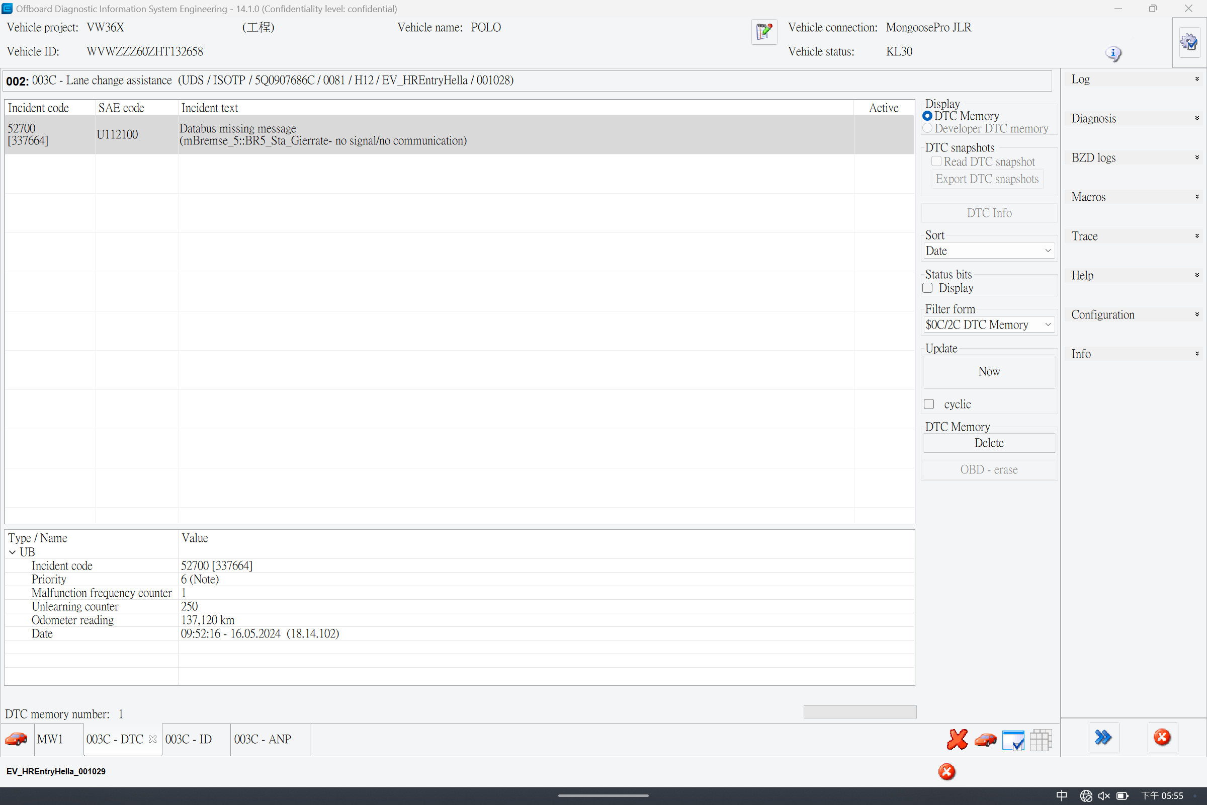

2. Coding, 03 01 11 02

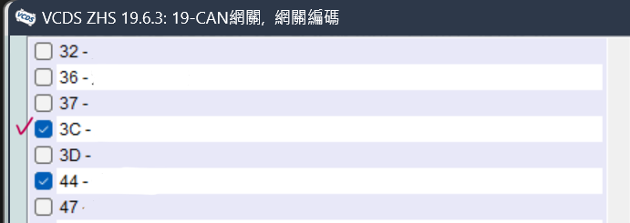

3. Chacking 3C-Lane Change in 19-CAN Gateway install list

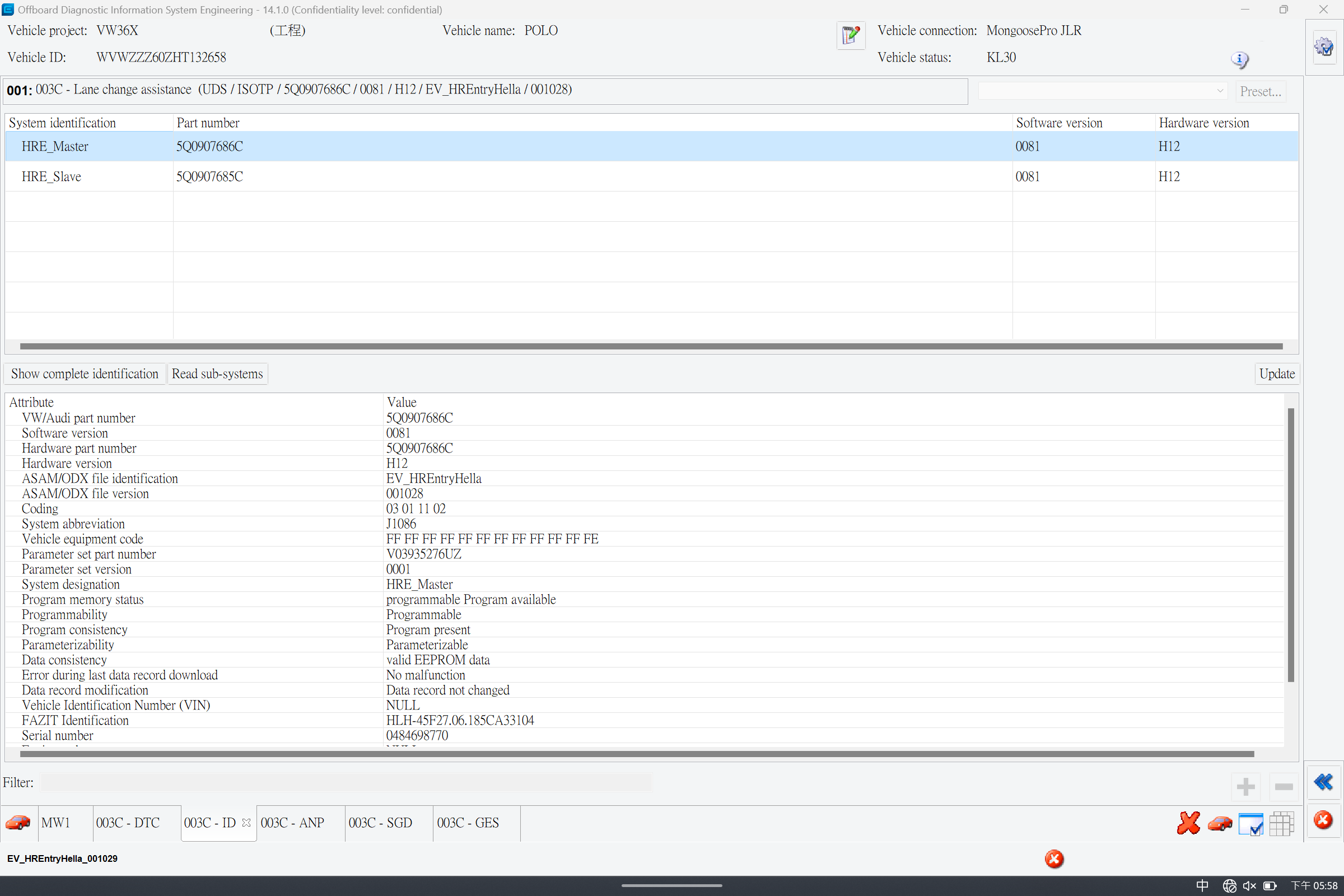

4. Updating the BSD module HW(5Q0 907 686 C 0080) to 0081
5. Filling the parameterization V03935276UZ

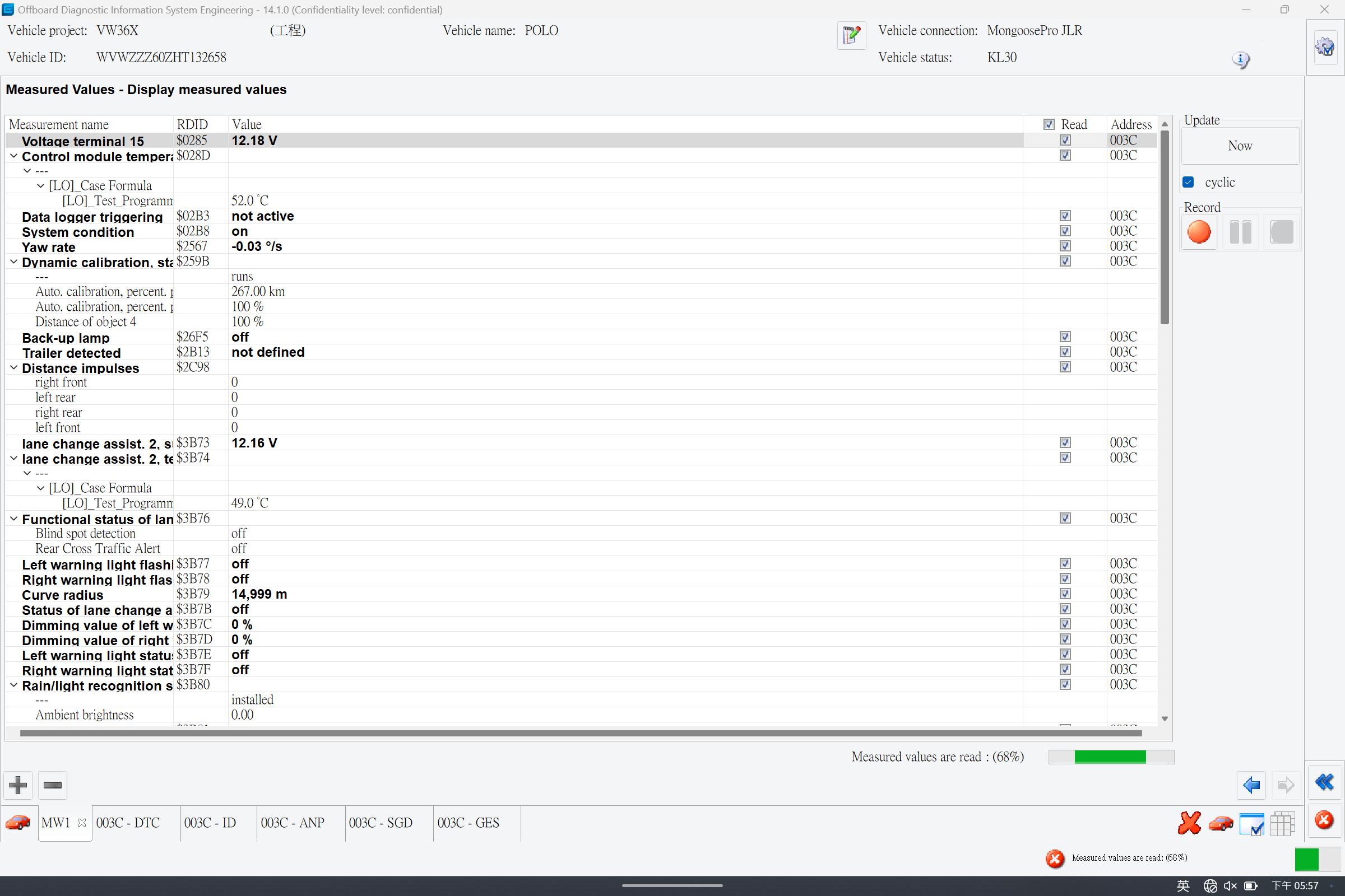

6. Activating the Analysis 4 in adaptation channel(with entering the access code 20103)

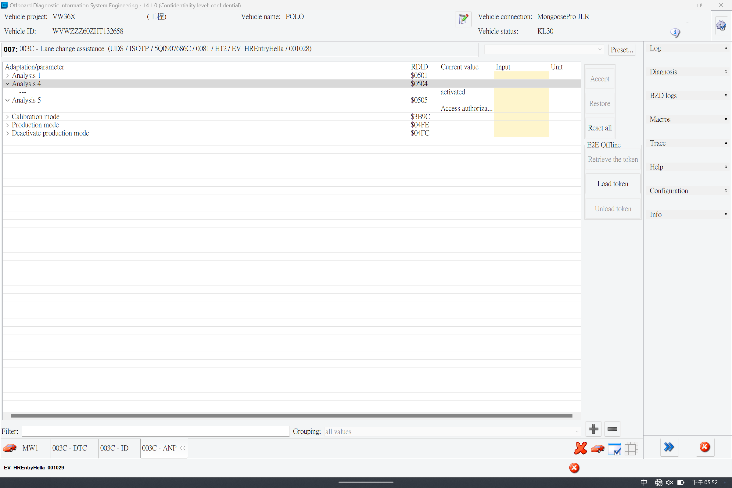

7. Auto calibration to 100%

So, I need to check 0454, To activate side assist, bit 0 must be 1, is that correct?
Posts: 9037
Location: Earth β™₯, Spain.
Re: Need help on Side Assist
Edit, updated!πŸ™
Side Assist indication, instrument cluster non-3D. MaDwArLoCk IC :arrow: https://a.d-cd.net/PyAAAgCH-uA-1920.jpg , https://www.drive2.ru/l/531400018091835697/
02DB ... enable bit1
Side Assist indication, instrument cluster 3D.
02F6 ... from 18 to 98 ... enable bit7
Side Assist menu.
0454 ... from 10 to 13 ... enable bit0 and bit1

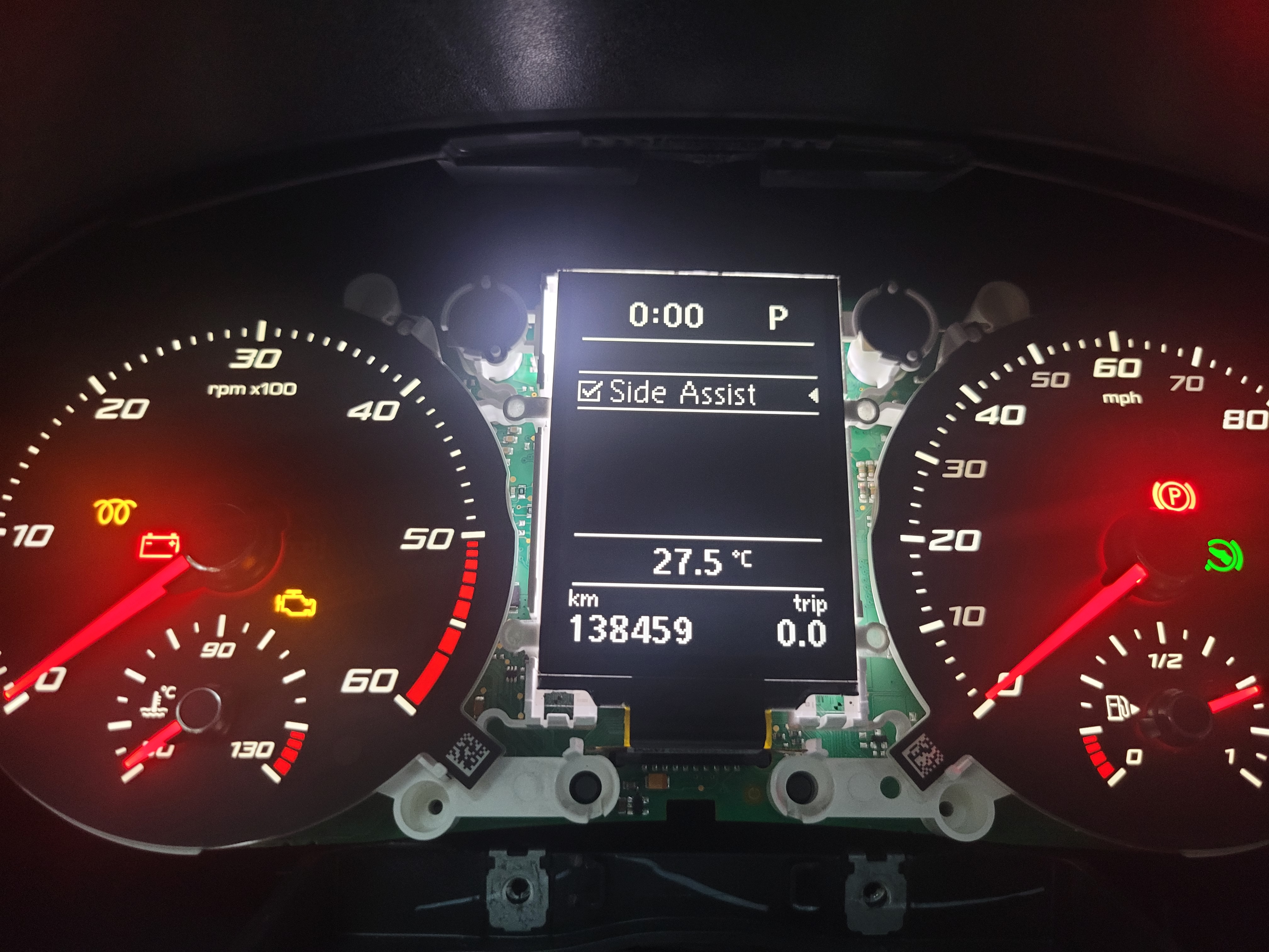

First, I want to thank iichel, patil, ciclo and til3tsio again.
After long time waitting, I received my CH341A for loading EEPROM few days ago.
I follow your suggestions to check 0454 and change from 21 to 13.
Guess what?It works!
I am so glad to see Side Assist menu finally show up on my cluster :D :D :D

ciclo wrote: Sun Jun 09, 2024 3:46 am
@Patil
Do you also have access to side assist from the MFD main menu? Or only from the assistants menu?
The darkness confuses us... :lol:
I have the side assist option only in assistants as I shown in the above post. In the main menu, after installing 1K8 OPS module, I got a separate menu for park assist through which I can enable or disable auto 8K ops.
@til3tsio thank you for additional information.πŸ‘
I guess all these assistants display on MID depend on IC firmware, Gateway version, Radio MIB models etc.. which will have different communication protocols with involved modules.
Posts: 9037
OK, thanks Patil.πŸ‘
I exactly wanted to know if 'Assistants' appeared in the settings/main menu, ... in addition to the Assistants menu.
To understand us, without the BSD radars installed (at this time), I do not have the 'Assistants' in the settings, however, I have the Assistants menu where is the Driver Alert.
patil
Posts: 577
Post by patil »
@Patil
Apologies for sharing incomplete information, my bad🀭
I do have separate blind spot sub menu inside the assistant menu in settings. I can access side assist in both settings as well as in the main screen.
πŸ™
