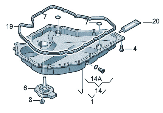

I have a leak from the sump pan so I need to change the pan and gasket. Can anyone tell me the genuine part numbers for both? Or confirm if an alternative brand will fit properly.

06K 103 600 L (Sump)
06K 103 649 (Gasket)
D176501A1 (Sealer)
N0282222 (Seals)
These are for the DAJA and the DAJB Engine 1.8 ltr

Thanks, when you say sealer and seals… are they needed also? I thought it would just be pan and gasket?

Sealer goes between the sump and the gasket.
Seals should replaced, there are 2 on the sump, you could re-use them but that is not recommended

Thanks again Maarten. Are you aware of any youtube videos on this? Im going to do it myself but the only vid i could find was just sump and Sealer. No gasket used. I always thought it was either gasket or sealer and never both.

Sump is nr 1
Gasket is nr 19
Sealer is nr 20
Seals are nr 7

Thanks again. What about the oil level sensor i saw a video where that is reused but they changed the seal on that also?
I don't think this is a difficult job but I cant get my head around needing the sealer with the sump that has a gasket in as the videos i see only sealer is used when there is no gasket.

I do not see a seal on the image.

Do you know part number for number 4? The actual bolts

N91071701
