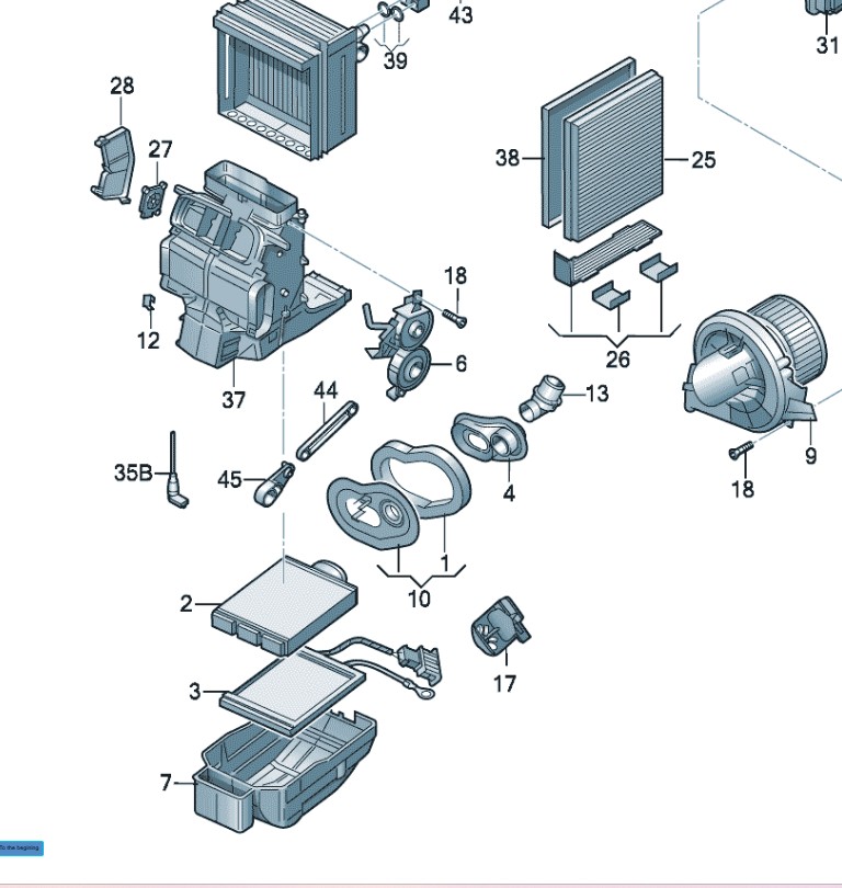

So for the hot and cold air mix I need the V68 motor? That is located in the evaporation somewhere in the middle?
Maarten
Posts: 557
Location: The Netherlands
Re: Location of Blend air flap!
Post by Maarten »
It is located inside nr 37
Nr 6 is the actuator
HVAC polo 2003.jpg (107.81 KiB) Viewed 28247 times

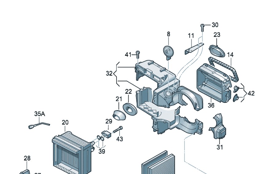

Maarten
Posts: 557
Post by Maarten »
Nr 31 is for recirculation (the fresh air flap)

The thing that I want isn’t the motor? (Nr27)? With part number 6Q0 907 511.
Maarten
Posts: 557
Post by Maarten »
Konc13 wrote: Wed Mar 12, 2025 9:13 am So for the hot and cold air mix I need the V68 motor? That is located in the evaporation somewhere in the middle?
The V68 is the one that regulates the temperature mix indeed
Maarten
Posts: 557
Post by Maarten »
Konc13 wrote: Wed Mar 12, 2025 9:21 am The thing that I want isn’t the motor? (Nr27)? With part number 6Q0 907 511.
Yes it is
