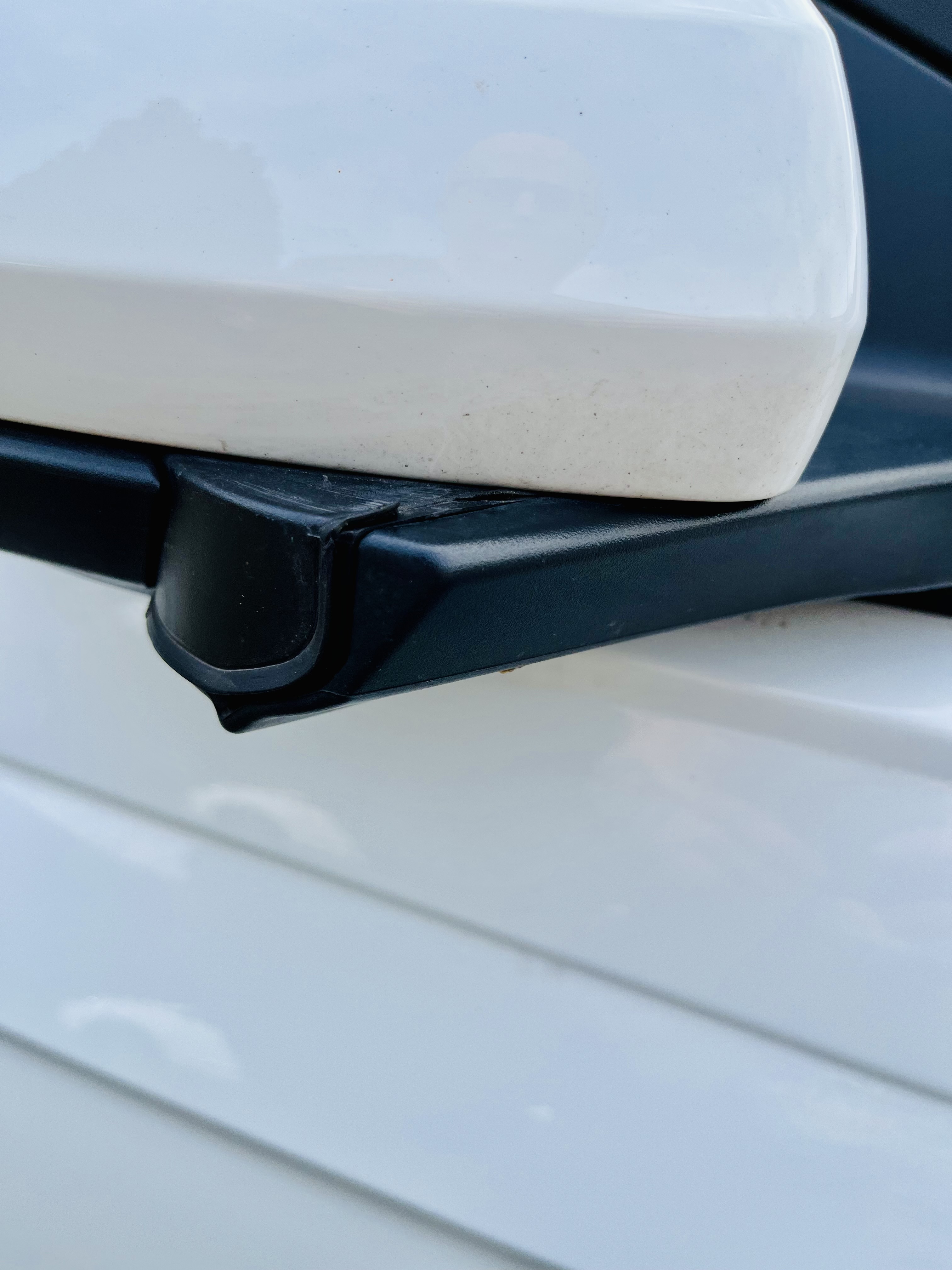

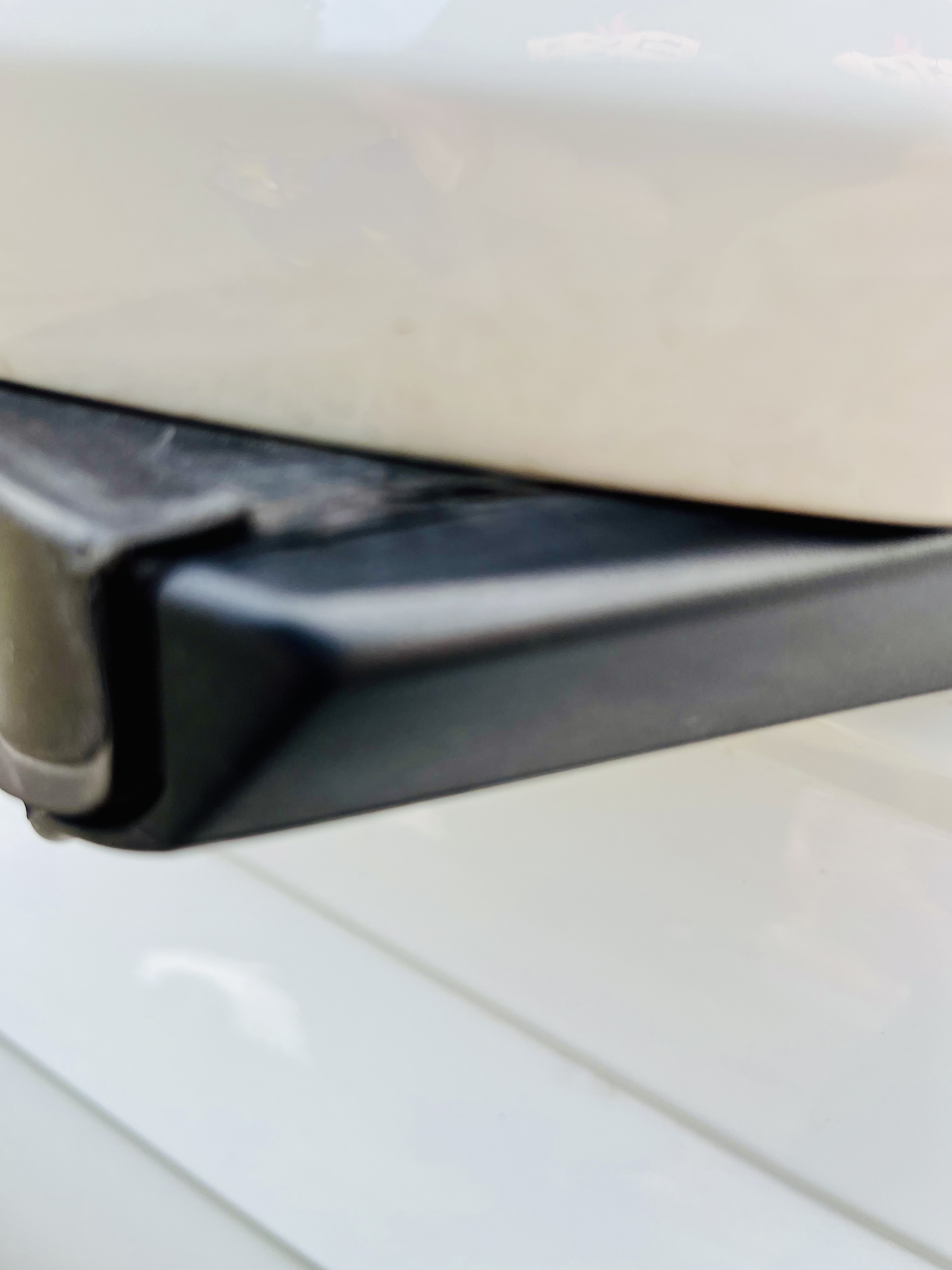

Has anyone else had an issue with the rubber seal on the mirror arm of a 2023> BZ GTi? As the seal on the offside arm where it runs under the folding mirror is torn. This seal is not cosmetic and is meant to prevent water from entering under the mirror and working its way down to the folding mirror mechanism.
I’m gonna raise a warranty claim for this and see what happens

It’s never happened to me before, even on the previous AW car, and the other side is fine. It’s not as if it’s a cosmetic issue because it’s designed to prevent water and dirt from being pushed underneath the mirror and working its way into the folding mirror mechanism. What I’m not sure about is the seal a separate item/part No or will it need a complete assembly replacement

Update:
The car finally was fixed under warranty, a complete new mirror arm was fitted, reusing the old mirror back and mirror lens. However they managed to break the mirror lense while installing it in the new arm, so I will have to return tomorrow morning to let them fit the new mirror lens. So as an apology they are going to send me a hamper for my troubles.
In a side note: I was told that this isn’t the first case where the seal has failed, and it seems that this is a QC issue with the seal sits proud and isn’t seated between the case halves, and that they suggested that it is a good
idea that if you can press the seal down with your fingers and you hear it click, it’s likely that it wasn’t fitted correctly
