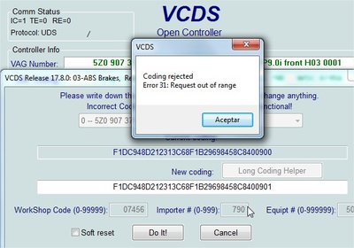

ciclo wrote: Sat Mar 24, 2018 8:05 pm Byte17 Bit0 enabled, activates the indirect TPMS in modules ESP9.0i front H03 0003 , yours is ESP9.0i front H03 0001.
F1DC948D212313C68F1B29698458C8400901
Try it. (with the right parts installed)
Tried it, no success :(

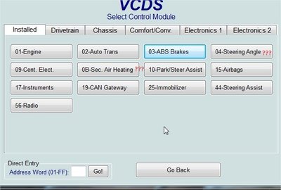

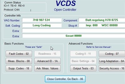

ciclo wrote: Sat Mar 24, 2018 8:05 pm Forget the battery module if you don't have it installed in you Suran.
This module doesn´t show as installed, but is accessible.
VCDS Release 17.8.0 Select Control Module2.jpg (5.84 KiB) Viewed 4512 times
VCDS Release 17.8.0 61-Battery Regul.,  Open Controller (1K0-907-534.CLB).jpg

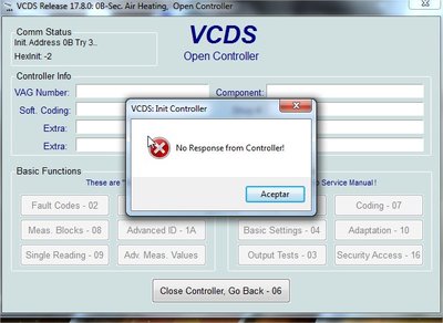

Also, what I told you before, I don´t understand why these modules shows as installed but they aren´t accessible:

Have you checked that the indirect TPMS is available in the IC coding?

Indirect TPMS is also available in ESP9.0i H03 SW 0002, just as some info 8)

I am curious is there possible to XDS activite.
Please try this variants
F1DC948D212313C68F1B29698458C8400904
F1DC948D212313C68F1B29698458C840090C
also lets try is it is possible to set the ESPoff button to deactivite the ESC fully, not only ASR
F1DC948D212313C68F1B29698458C8401500

Coding was accepted and working as expected!
Also, got these pics for ciclo !
Finally, IC coding byte 2 not 0 is rejected [emoji853]

firegrafik wrote: Mon Mar 26, 2018 3:09 pm
EdgardoRodriguez wrote: Mon Mar 26, 2018 2:51 pm
Hi! What is this about firegrafik?
Do you have any posible code for trying indirect TPMS ??
Found this on a russian page:
Вот для примера лог кодировки блока 03, идущего на поло с завода:
Адрес 03: Электроника тормозной системы (J104) Label: 6R0-907-37x-ESP90.clb
Part No SW: 6R0 907 379 BN HW: 6R0 907 379 AS
Компонент: ESP9.0i front H03 0001
Серийный номер: --------------
Кодировка: 51DD4864422707C48A19126A4251E041090C
Мастерская #: WSC 01530 935 00200
VCID: 0B1E5B35A26D8F1822-805E
The guy states that has indirect TPMS working. Which shows the firmware? the first highligthed "Part No SW" or "Component" section?
My ABS module shares HW and Component parts, but Part No SW: 5Z0 907 379 K
I feel confused :shock:
I suppose it is firmware limitations. the software 5Z0907379K doesn't allow the RKA (indirect TPMS))coding. Because of this I asked to try
firegrafik wrote: Sun Mar 25, 2018 1:45 pm I am curious is there possible to XDS activite.
F1DC948D212313C68F1B29698458C840090C[/size
To clarify if there some more limitations of your ESP control unit firmware.
OK,
missed that part. Later today I´ll give it a shot and then tell you.
In case I am limited by software, is there any possible way to flash another one? Knowing that i am not a VW Technician unfortunatelly (no access to those tools)
