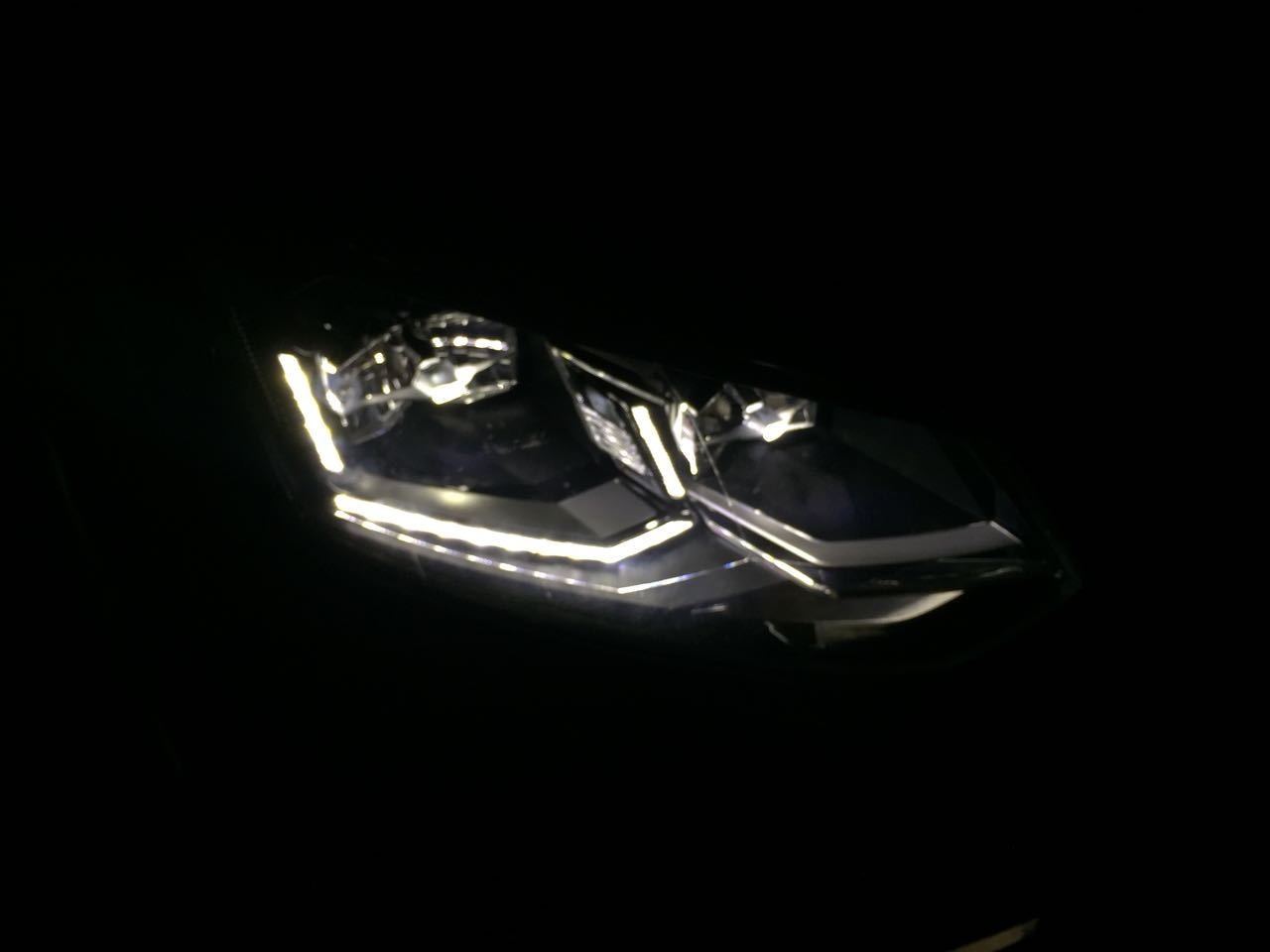

Hello Fernando,
I am still waiting for BCM for LED headlights. Meanwhile last weekend one of my friend Nikhil(he is also member of uk-polos) visited my home, he has very good knowledge on 6R Polo wiring, he saw all parts I have acquired, told him I will install LED headlights and waiting for specific BCM for LED headlights, Firegrafik Friend from Russia will send and it will reach in another 15-20 days. Waiting for parts kills. :(
Then he insisted me, will do adaptation of BCM Max 7E0937090C(Bi Xenon lights) for existing Halogen dual beam lights, connect auto headlight wires, route all necessary wiring for DRL, Fog, reverse light and license plate light, keep everything ready when you get BCM for LED just swap BCM, Crimp T14 connector and install LED headlights. Some errors will come up(Like DRL wires not connected) but we can leave with it for some days I too liked his idea; because of 2 things half of work will be finished and most important I will get his help for installation. 
Apart from above installation, I have also planned for retrofitting cruise control and G85 (Steering angle sensor) for cornering light, these also will be finished.
I will cut short installation process because I am poor in writing and not taken any pictures of installation because we did installation in basement parking with poor light. (We used emergency light n torch for light).
After adaptation of BCM Max on halogen lights, we installed new stalk with cruise control button, steering angle sensor and connected all wires for the same. Connected battery, did necessary coding using vcds. Scanned for errors except DRL not connected everything was fine, worked perfectly.
After this contacted Firegrafik and confirmed with my present BCM 7E0937090C which is meant for Bi Xenon headlights, if I use this for LED headlights only parking light won’t work. Everything else DRL, high beam, low beam will work. So itch of installing it and seeing started, so thought will leave without parking light till new BCM arrives, crimped n connected T14 connector and installed LED headlights. 
Now everything is working. Except parking light when headlight is on. Here I am attaching scan report. Please check coding. I used smg_shardul’s topic for coding. Fog lamp was not getting on, because coding is for Bi-Xenon, made small change in coding for that. Now fog is working. Please check coding and guide any changes.
Thank you very much for providing all the help.
will add more clear images soon.
