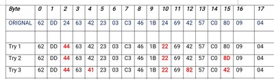

Please try these two codes:
62DD4463422303C046172271425AC0800904 #1
62DD4C63422303C046173271425AC0800904 #2
62DD2463422303C046172471425AC0800904 org

Re: Polo 6R ABS CODING
philipmathew, at this point I'd suggest you to enter the coding for the brakes that are of the closest size to yours (288 front and 232 rear).
Since you are driving a FWD car, I guess it is more important to have correct coding for the front brakes than for the rear ones.
Plus to this, consider that some brakes codings can be accepted by the ABS Unit only if you also modify the specific bytes of Engine and Transmission.
After many tries on different Polo 6R and Audi A1, I understood these ABS Units (8.2i and 9.0i) are programmed to accept only specific combinations of engine/transmission/brakes codings.
For example: if in the Unit has been programmed that your engine/transmission combination can only have "256mm front-drum rear" and "256mm front-232 rear", the Unit will never accept any other brakes coding!
You also need to change Engine/Transmission bytes with others that the Unit is programmed for having other brakes codings.
In less words, you need to trick the ABS Unit, making it see like you have another Engine/Transmission combination, to unlock the brakes coding you need.
So, it's not a matter of firmware version as someone keeps to say!
Let's make another example!
The ABS Unit 8.2i can accept coding only for:
256mm front - drums rear;
256mm front - 232mm rear;
288mm front - 232mm rear.
But only the 6R GTI and 1.6TDI 105cv have the last brakes setup from favtory.
So the 8.2i Unit has been programmed to accept the last brakes codings only with 6R GTI and TDI Engine/Transmission bytes combination.
If you try to enter the last brakes coding with (for ex.) 1.2MPI or 1.2TSI Engine/Transmission bytes, the Unit will never accept the coding, because it has not been programmed for that combination (literally: "request out of range").
But if you also change the Engine/Transmission bytes with those of 6R GTI or TDI...
voilà! "Coding Accepted!"

Interesting facts!! Thank you for the reply. Meanwhile, with the help of a friend we have managed to source the VCDS logs of ABS/ESP module for a variety of VAG cars that use the 256mm front brakes and rear drum combination.
Can you help me with decoding the engine specification byte and trying a change in that and transmission, along with brake combo change to 288mm front and rear drum to see if it works?
Here they are:(All these cars have 256mm front discs and rear drum brakes)

Unfortunately, all the Polo's in India have the 256mm front and rear drums. I can get a scan of the 6C Polo 1.8L TSI GTI (312mm front disc and 232mm rear discs) here in India but that being a CBU import to India, it will most likely have similar coding to what you have in Europe.
My question is whether we can trick the module to think we have a different engine - tranny combo as Jay-Jay mentioned, so as to get our desired brake combo of 288mm front and drums in the rear. Changing the engine code and transmission byte perhaps along with the brake combo code and leaving all the other bytes same?
- Posts: 6405
No, the scan of the 6C GTI won't be useful since it's equipped with a different ABS unit.
Ideally, it would be a Polo RHD sedan with any engine and 288/200 brakes. But if those aren't made, then the possibilities become exponentially more.
Personally, I'm not a big fan of coding the ABS wrongly on purpose. But feel free to have a go with this information:
ESP9.0i PQ
For Byte 2,
2C/24 - 256mm front discs and 200mm rear drums
28 - 256mm front discs and 232mm rear discs
44 4C - 288mm front discs and 200mm rear drums
48 - 288mm front discs and 232mm rear discs
68 - 312mm front discs and 232mm rear discs
78 - 312mm front discs and 256mm rear discs

Thank you so much! Same here, I'm not a fan of coding it wrong but getting the right code for the brakes I feel is important. But I'll give these a try and see. Also the logs I mentioned above are all RHD, so you can add to the list of engine codes for RHD to byte 15 as well.iichel wrote: ↑Mon Jul 16, 2018 8:43 pm No, the scan of the 6C GTI won't be useful since it's equipped with a different ABS unit.

Mine ABS control unit with firmware 6R0 907 379 AS also doesn't accept such coding. So the only advice I have is to retrofit rear brakes to the disk type.
Hi firegrafik, i am trying to do the same coding on polo 1.2 tsi. It has same setup like phillip mathews. 288 mm disc at front and drum at rear. I have tried differant coding with differant engine options but nothing is getting accepted. I am ready to flash skoda rapids abs 9.0i firmware on my module if harware is supported. If anyone here can send me autoscan of rapid with 288mm front disc and rear drum then i can get required firmware and try to flash.
I am attaching codings which i tried
