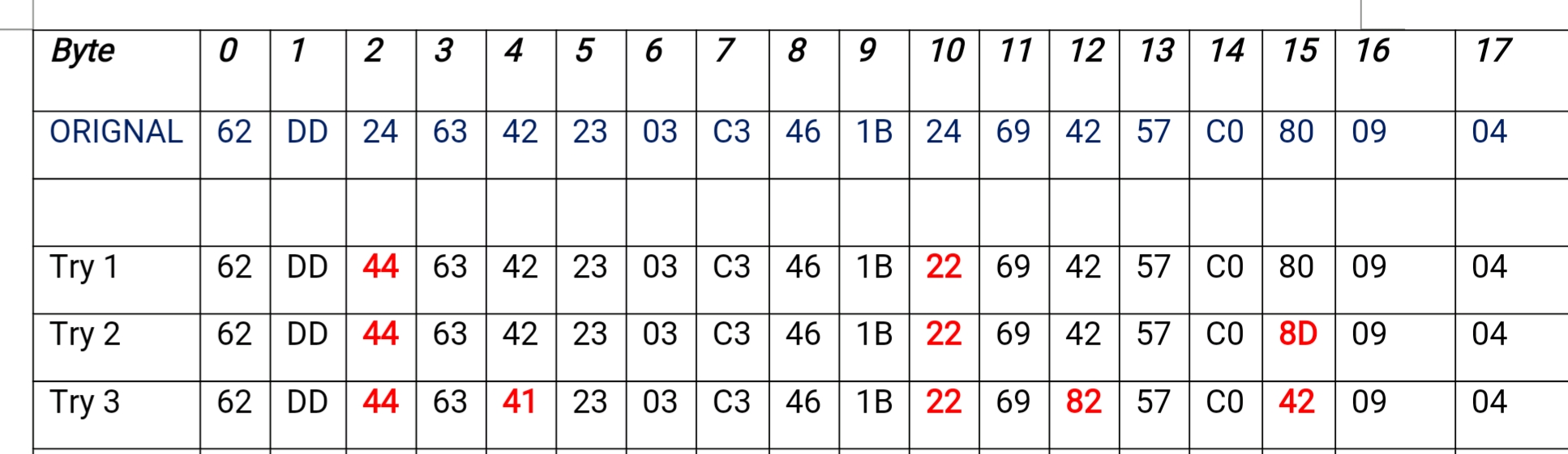

Re: Polo 6R ABS CODING
Please try these two codes:
62DD4463422303C046172271425AC0800904 #1
62DD4C63422303C046173271425AC0800904 #2
62DD2463422303C046172471425AC0800904 org

iichel wrote: Fri Jul 06, 2018 1:48 pm Please try these two codes:
Just tried both of them, with and without security access. It’s still giving me the “Request out of range error.” Any other coding or procedure possible?

Jay-Jay wrote: Sat Jul 14, 2018 10:49 amJay-Jay
Interesting facts!! Thank you for the reply. Meanwhile, with the help of a friend we have managed to source the VCDS logs of ABS/ESP module for a variety of VAG cars that use the 256mm front brakes and rear drum combination.
iichel wrote: Tue Jul 10, 2018 9:09 am Without reference data, it's hard to say whether this combination of chassis/engine/brakes is possible in the ABS coding. I'm sorry.
Can you help me with decoding the engine specification byte and trying a change in that and transmission, along with brake combo change to 288mm front and rear drum to see if it works?
Here they are:(All these cars have 256mm front discs and rear drum brakes)

Unfortunately, all the Polo's in India have the 256mm front and rear drums. I can get a scan of the 6C Polo 1.8L TSI GTI (312mm front disc and 232mm rear discs) here in India but that being a CBU import to India, it will most likely have similar coding to what you have in Europe.
My question is whether we can trick the module to think we have a different engine - tranny combo as Jay-Jay mentioned, so as to get our desired brake combo of 288mm front and drums in the rear. Changing the engine code and transmission byte perhaps along with the brake combo code and leaving all the other bytes same?

No, the scan of the 6C GTI won't be useful since it's equipped with a different ABS unit.
Ideally, it would be a Polo RHD sedan with any engine and 288/200 brakes. But if those aren't made, then the possibilities become exponentially more.
Personally, I'm not a big fan of coding the ABS wrongly on purpose. But feel free to have a go with this information:
ESP9.0i PQ
For Byte 2,
2C/24 - 256mm front discs and 200mm rear drums
28 - 256mm front discs and 232mm rear discs
44 4C - 288mm front discs and 200mm rear drums
48 - 288mm front discs and 232mm rear discs
68 - 312mm front discs and 232mm rear discs
78 - 312mm front discs and 256mm rear discs
Byte 4:
21 - Manual transmission 5 spd
23 - Manual transmission 6 spd 1.2 TSI 105hp
41 - DSG
42 - DSG (Polo India RHD, 1.2 TSI CBZB)
43 - 5/6 speed manual (GT, WRC, 2.0 TDI), Polo GTI, BM
byte 10:
Inverse of byte 2
Fill in HEX:
4c
Binary:
01001100
Make inverse:
00110010
HEX: 32
byte 12:
Inverse of byte 4
Fill in HEX:
42
Binary:
01000010
Make inverse:
01000010
HEX: 42
byte 15:
Engine type and steering wheel
40 - BXW CGGB CBZA CBZB CGPA CFHA CFNA CTHE + LHD
42 - CAYB + LHD
4D - CAVE, CDLJ + LHD
4E - CFHD + LHD
52 - CFWA + LHD
55 - CPTA + LHD 80 - CBZB + RHD

Thank you so much! Same here, I'm not a fan of coding it wrong but getting the right code for the brakes I feel is important. But I'll give these a try and see. Also the logs I mentioned above are all RHD, so you can add to the list of engine codes for RHD to byte 15 as well.

firegrafik wrote: Thu Jul 05, 2018 5:55 pm Does your abs unit have ESP?
Anyway, on practice, front 288 and rear drum brakes configuration I have met only on Skoda Rapid. So VW ABS control unit firmware could not be prepared for such configuration, and that's why it doesn't accept such coding.
Mine ABS control unit with firmware 6R0 907 379 AS also doesn't accept such coding. So the only advice I have is to retrofit rear brakes to the disk type.
Hi firegrafik, i am trying to do the same coding on polo 1.2 tsi. It has same setup like phillip mathews. 288 mm disc at front and drum at rear. I have tried differant coding with differant engine options but nothing is getting accepted. I am ready to flash skoda rapids abs 9.0i firmware on my module if harware is supported. If anyone here can send me autoscan of rapid with 288mm front disc and rear drum then i can get required firmware and try to flash.
I am attaching codings which i tried
