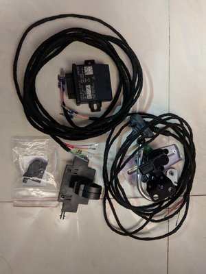

AFS Kit ready
Waiting for level sensor bracket
Thanks a lot Firegraphics for your guidance
Thanks a lot ciclo for parametizing AFS module without this project was incomplete
Thanks a lot Madwarlock for AFS Module
