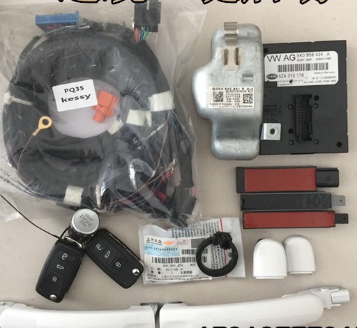

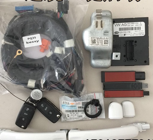

found full kit of KESSY, seller says full kit is new, he also has used ELV and KESSY module everything else new as an option for less price. attaching picture too.
Kessy module 5K0959434E
Electronic steering lock 5K0905861C
Full wiring kit
found a guy who has VVDI and ODIS with some experience.
So wanted to know PQ 35 wiring kit can be used?
Please guide!
Re: retrofitting kessy to the Polo 6R
Yes, the wiring is identical between PQ25 and PQ35 for the antenna and ELV and Kessy module.
You need to improvise in how to connect relays (+15, +75, converter box).
