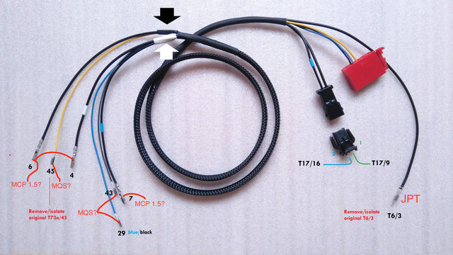

ciclo - what length did you make your looms:
- CAN LINES
- BCM - LIGHT SWITCH - DIMMER
- AUTOLIGHTS
Thanks in advance

If you mean the length of the wiring for the BCM adaptation and automatic lights wiring for T5, here are some wiring lengths that Adam87 gave me:
Fuse box - BCM ~ 225cm
Fuse box - Light switch ~ 220cm
BCM - Light switch ~ 75cm
BCM - T41 ~ 183cm
BCM - T32 ~145cm
BCM - T10o ~376cm
They are in centimeters, I hope you can handle them.
I remember he told me that a few more centimeters are added to real lengths.
To take into account that each one can have a different perspective of what is the ideal route. :)
Tips:
Measure the length of the wiring taking into account its entire route/path (elbows, curves, angles, etc.), it is a priority to follow the original wiring path (sometimes it is not entirely possible).
Add 20cm to the measurement taken, for cuts, crimps, and facilitate installation/removal.
I usually finish installing the wiring (crimping of the connector terminals, etc.) in the vehicle itself and I usually add a lot of wiring to the length taken.

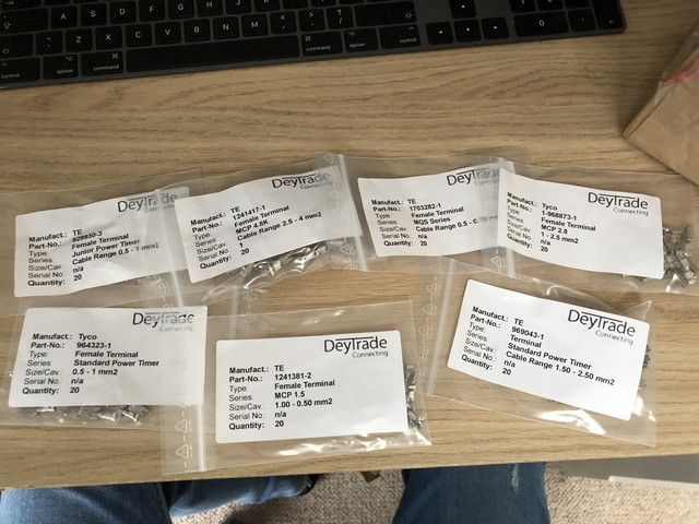

My terminals arrived
:D
I can now begin the BCM upgrade and loom making.
I have my RLS sensor installed now and loom ran in, just need to wire in the cables and activate this.
