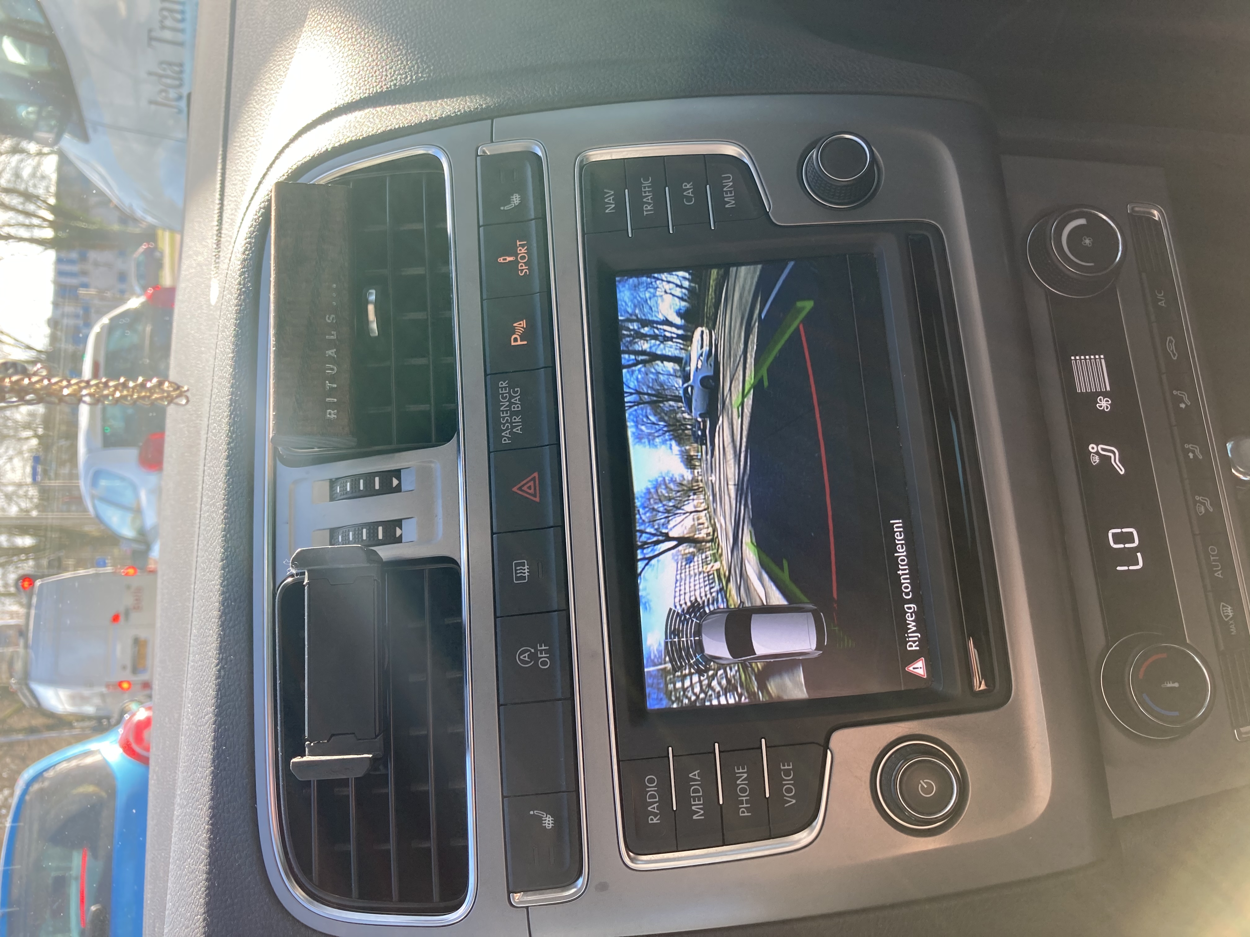

No i see only black screen and then it turn off withe message ''Parkpilot is not available'', but i remove it. I will install OEM flip camera in it, I still waiting voor the harness.

I install OEM golf 7 camera logo on my polo without any issues thanks everybody for the previous problem

Mocro wrote: Fri Feb 26, 2021 9:38 pm I install OEM golf 7 camera logo on my polo without any issues thanks everybody for the previous problem
Hello Mocro.. good job👍
I hope you did proper wiring this time))
