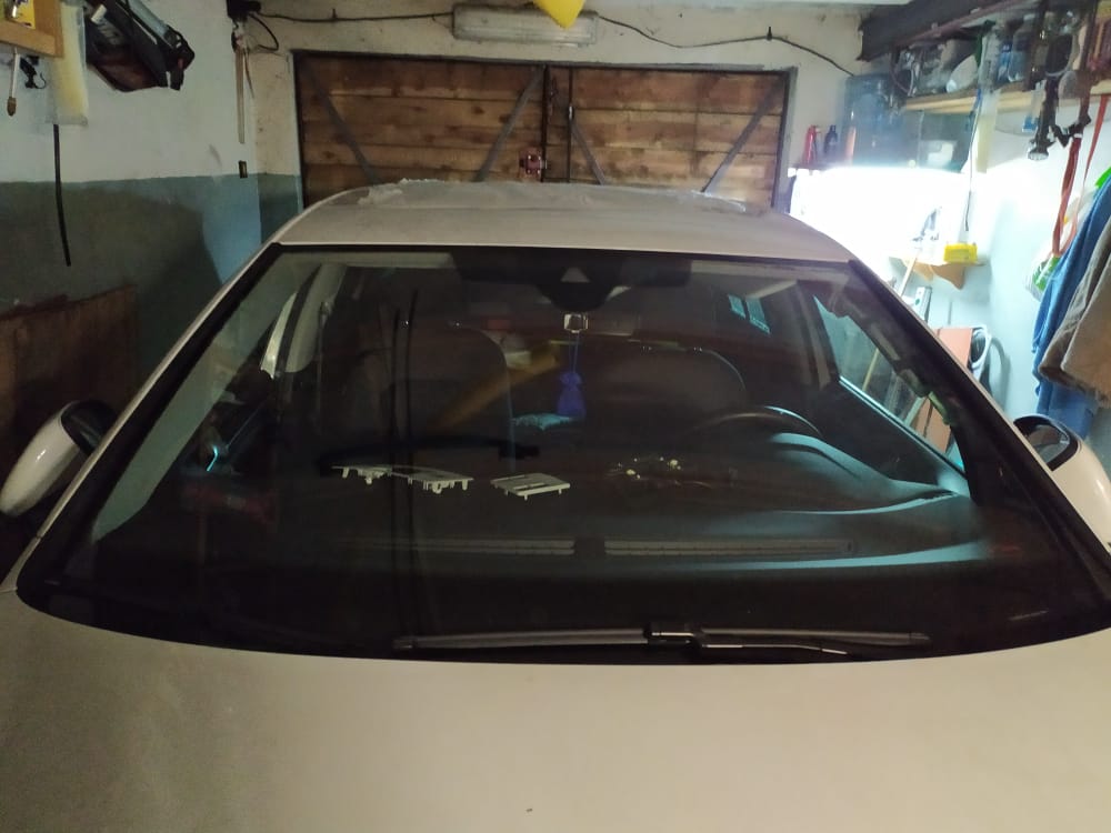

Today I installed the wiring harness for the a5 camera :D Remaining camera for calibration:)
Glass replaced,Now I have to check if it works :)

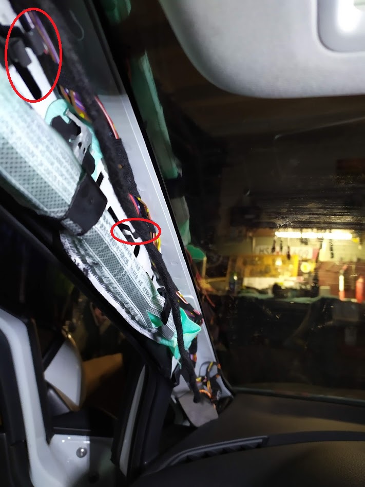

Any special tips to fully remove the A-pillar trim?

ciclo wrote: Sat Feb 13, 2021 6:35 pm Great, it looks good.
snow on the roof?
I had a problem getting him out
They hold the three hooks firmly from the top, it is more difficult to put it back on
,It is now a cold winter in Poland :)

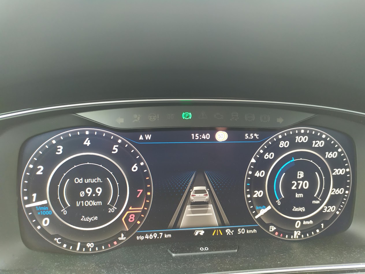

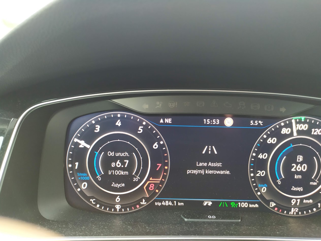

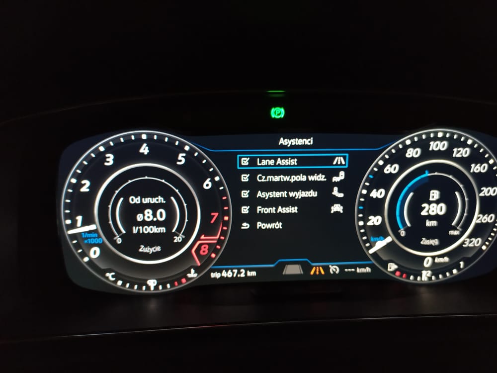

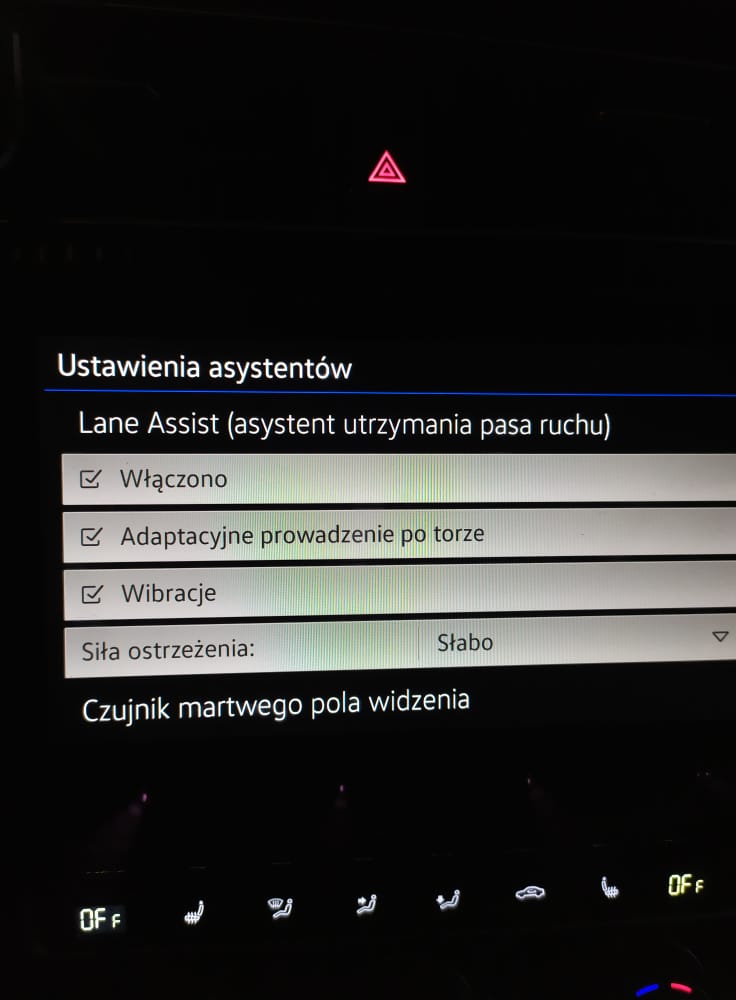

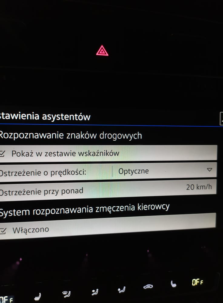

Now I can enjoy lane assist :D works well I followed the topic slavika :D https://www.drive2.com/l/579920916469778092/
-Lane assist
-Emergency Assist
-Traffic Sign Recognition
Does Traffic Jam Assist work with a manual gearbox ?

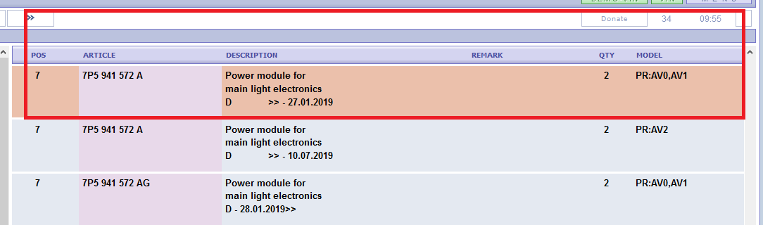

DLA wants to too, but a little later I have to buy headlights first, but I wonder if my current lamp modules will fit for DLA, or are they different for DLA.I have a 7P5 941 572A(AV0,AV1) A module Because I can change right-hand or left-hand traffic on the radio.In PR headlamps: 8IU There is no pr code in module 7P5 941 572 A :roll:
TJA Likewise, I thought that only for dsg. :D
PR:8IX
PR:8IX
PR:8IU
PR:8IU
Posts: 8969
Re: GOLF 7.5 FL R-LINE
The control units of your current LED headlights are correct, they should only be flashed for Matrix headlights when you install 8IU LED headlights.

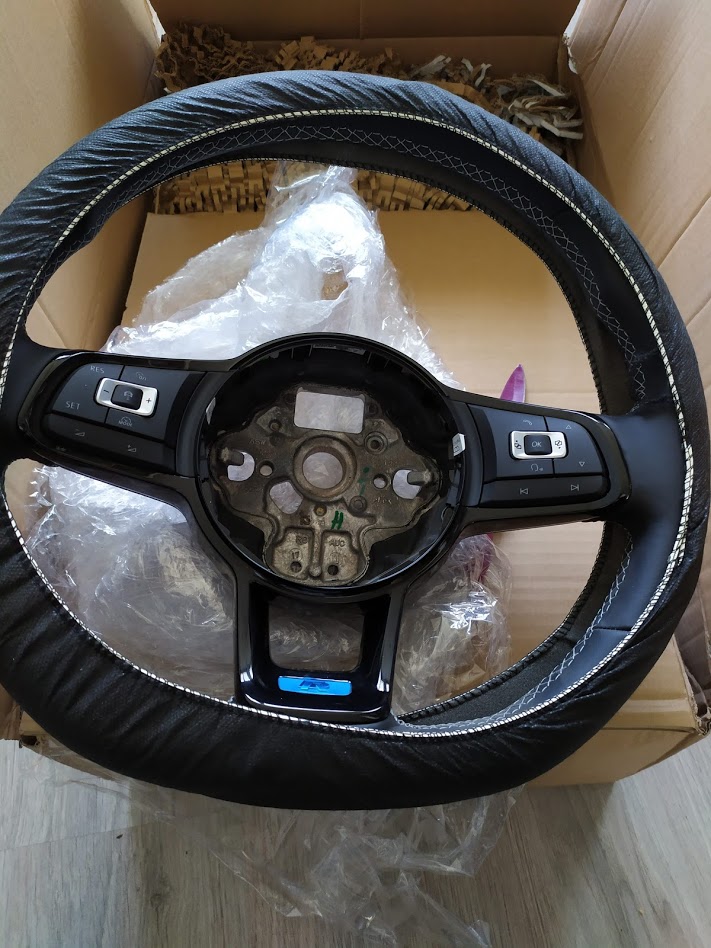

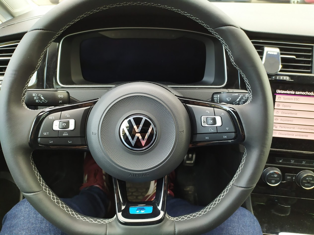

Steering wheel 5G0419091HQ
Posts: 8969
Super!
Nice VW logo and nice color on the AID.👍
My wife ordered me to remove the GT Sport Steering Wheel and reinstall the Original ... 🤣
