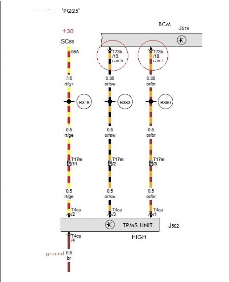

Hey, could you possibly confirm which canbus pins the TPMS needs connecting to for Transporter? Just to save me trawling through everything :D I plan to connect mine tomorrow assuming my foglights come to life.
Shadow109
Posts: 154
Drives: Vw t5.1 2013
Location: Israel
Re: BCM Max Transporter 2013
Post by Shadow109 »
Sure, this will help you

Thanks, that's a big help, I had assumed it would be on the CAN convenience network (of which my towing module is connected to, and was conveniently located under the front seat :) ) but alas, further wires to run to the BCM :D fortunately it's all still in pieces.

There are only two possible CAN BUS to connect RDKS in the PQ25, ... or in powertrain CAN lines, or in the new dashboard/instrument cluster CAN lines, in no case in the convenience CAN lines.
The recommended one, and according to diagramas for Amarok, is the powertrain CAN.

ciclo wrote: Sun Mar 21, 2021 5:42 am There are only two possible CAN BUS to connect RDKS in the PQ25, ... or in powertrain CAN lines, or in the new dashboard/instrument cluster CAN lines, in no case in the convenience CAN lines.

Issues:-
HBA isn't working
new Instruments fault
TPMS didn't show anything on. the MFD
edit : I have noticed that the TPMS Controller (3AA 907 273 H) is ending with H Not F
Posts: 8912
Have you coded BCM channel 53 also to '1'?
For Direct TPMS to work on PQ25 it must be:
Address 65: Tire Pressure (J502) Labels: 3AA-907-273.clb
Part No SW: 3AA 907 273 F HW: 5Q0 907 273
Component: RDKBERU30 H04 0011
'H' it is for other platforms, doesn't work for PQ25, ... accidentally tested. :)
You need to flash that TPMS unit with the correct firmware, ... then you must load the zdc file with the parameters of the tire pressures that you have chosen.
