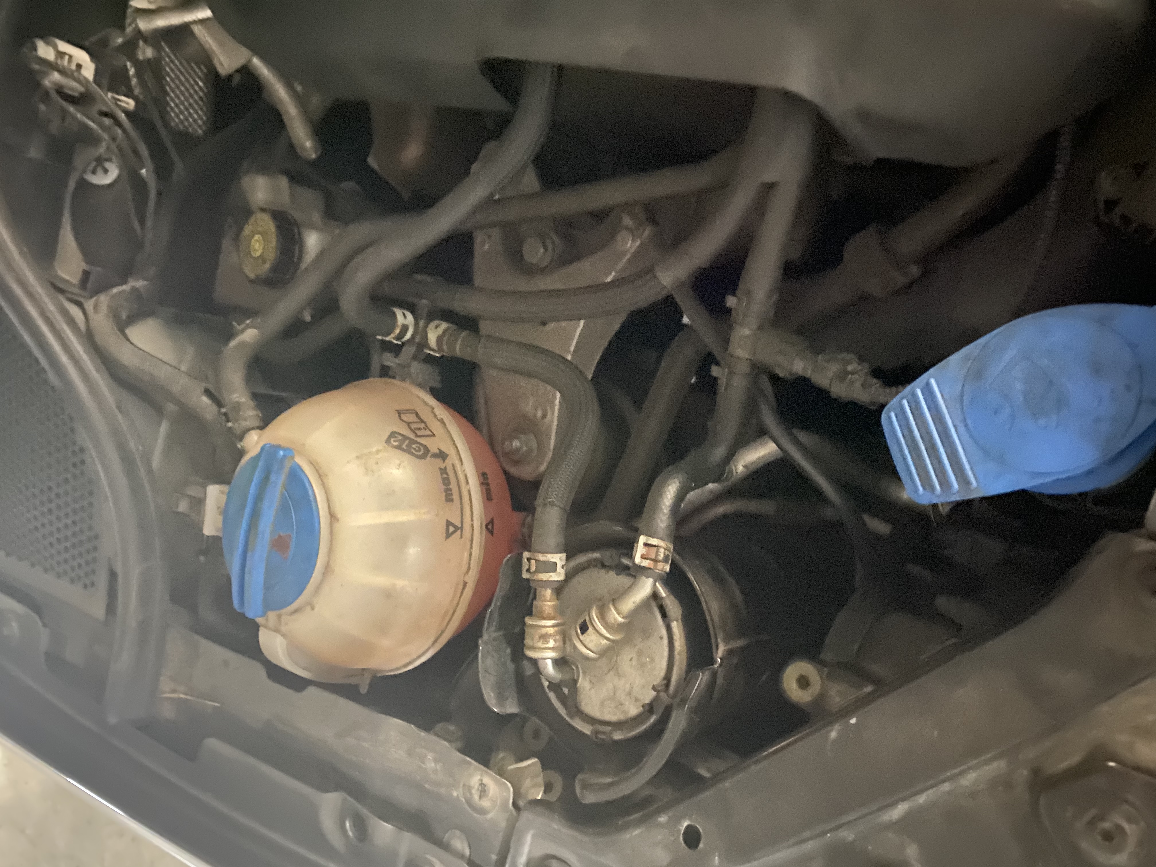

mounted on the fuel filter in the engine bay behind right hand side headlight

Doesn’t seem to be there :lol: .

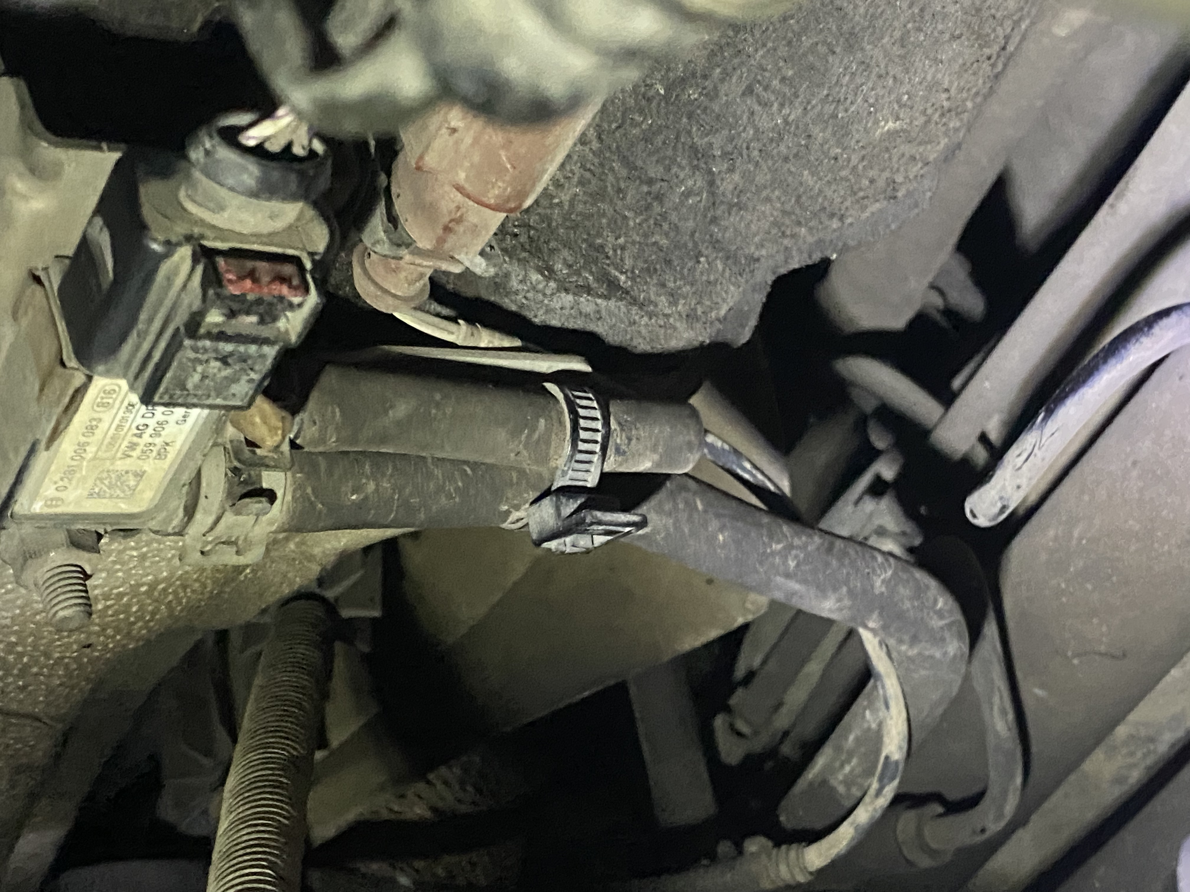

Re: DPF Sensor
Ah I see, your steering wheel is on the wrong side.
look on the other side, on the firewall between the engine and the cabin
would be nice if you could post some pictures of its actual location, thanks

Wooo thank you! :D Finally found it.
Now, should I be concerned that one of the hoses ends right there?
Re: DPF Sensor
Looks pretty acceptable to me
