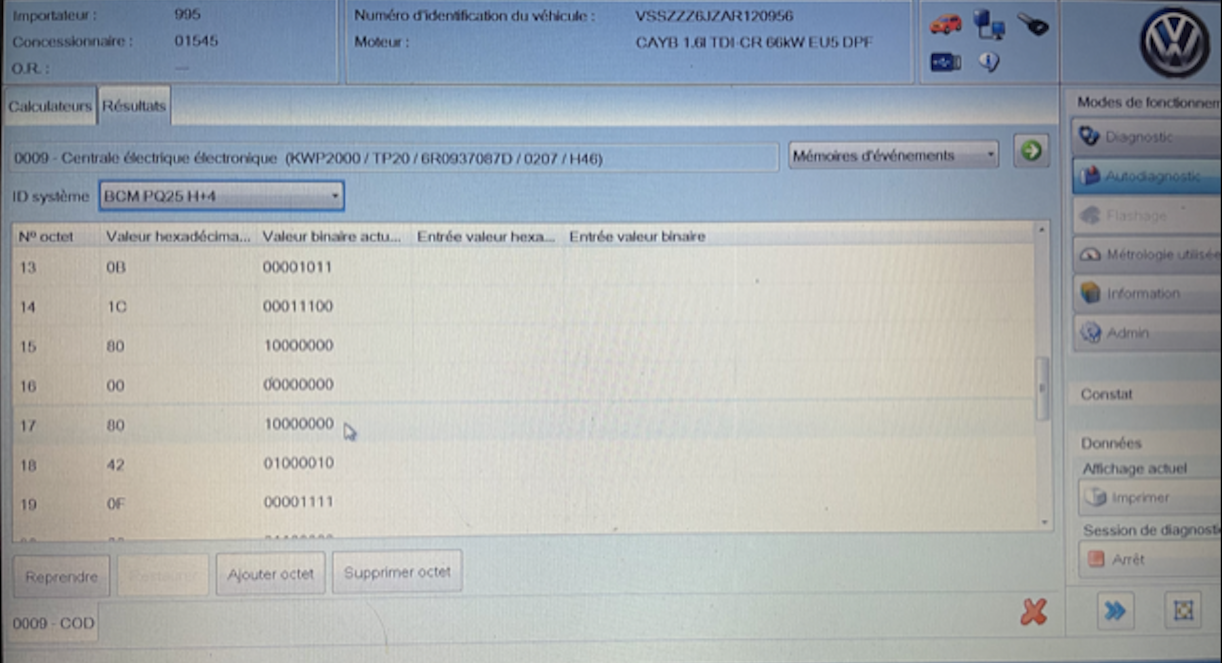

In the block of measured values of the 09 (see picture)
- when I activate the cruise control, the values do not change

fuse OK? bcm byte 17 bit 7 ON? ECU byte 5 bit 5 ON?
BCM BIT 17.png (3.98 MiB) Viewed 27443 times

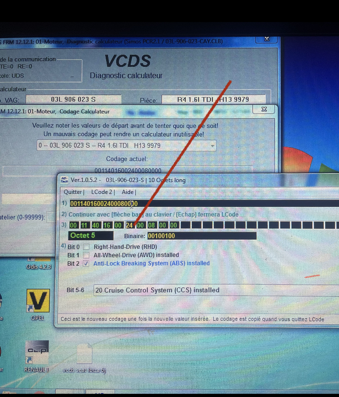

You did not code the ECU for cruise control.

thanks iichel, i don't understand why it wasn't coded though i activated it.

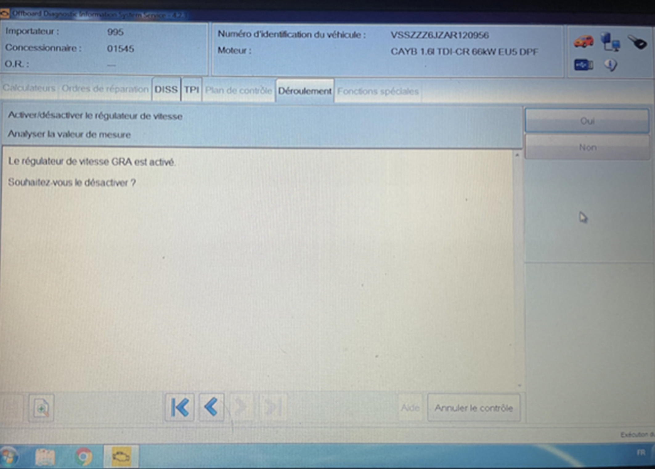

I just checked, the regulator is activated in the ECU. I don't think it's coming from there.

vcds 12.12. bro, seriously?

HAHAHA, this is just to show you the coding.
but I use Odis

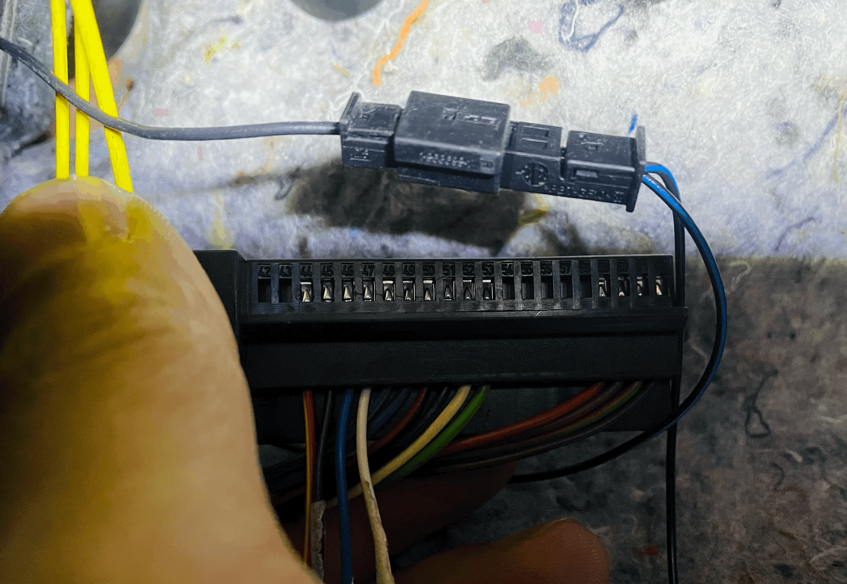

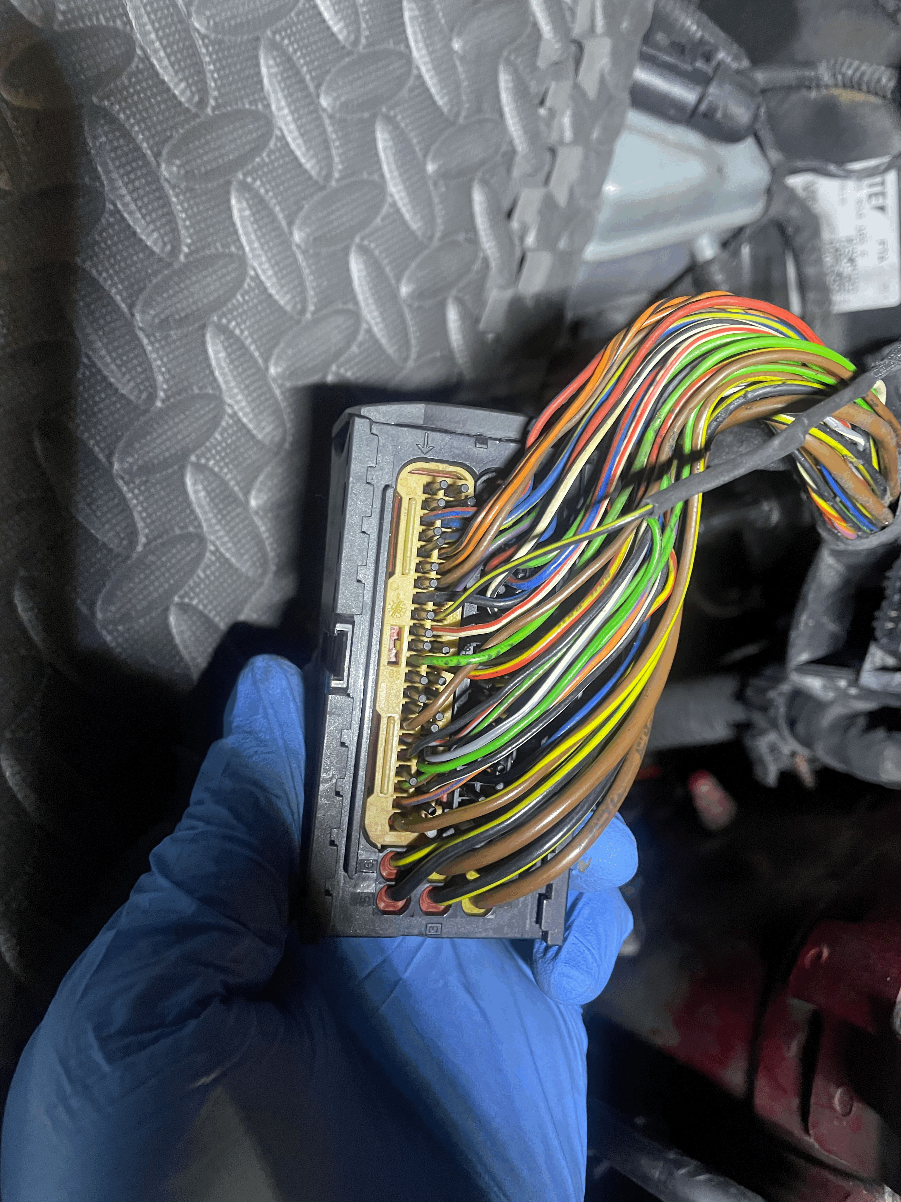

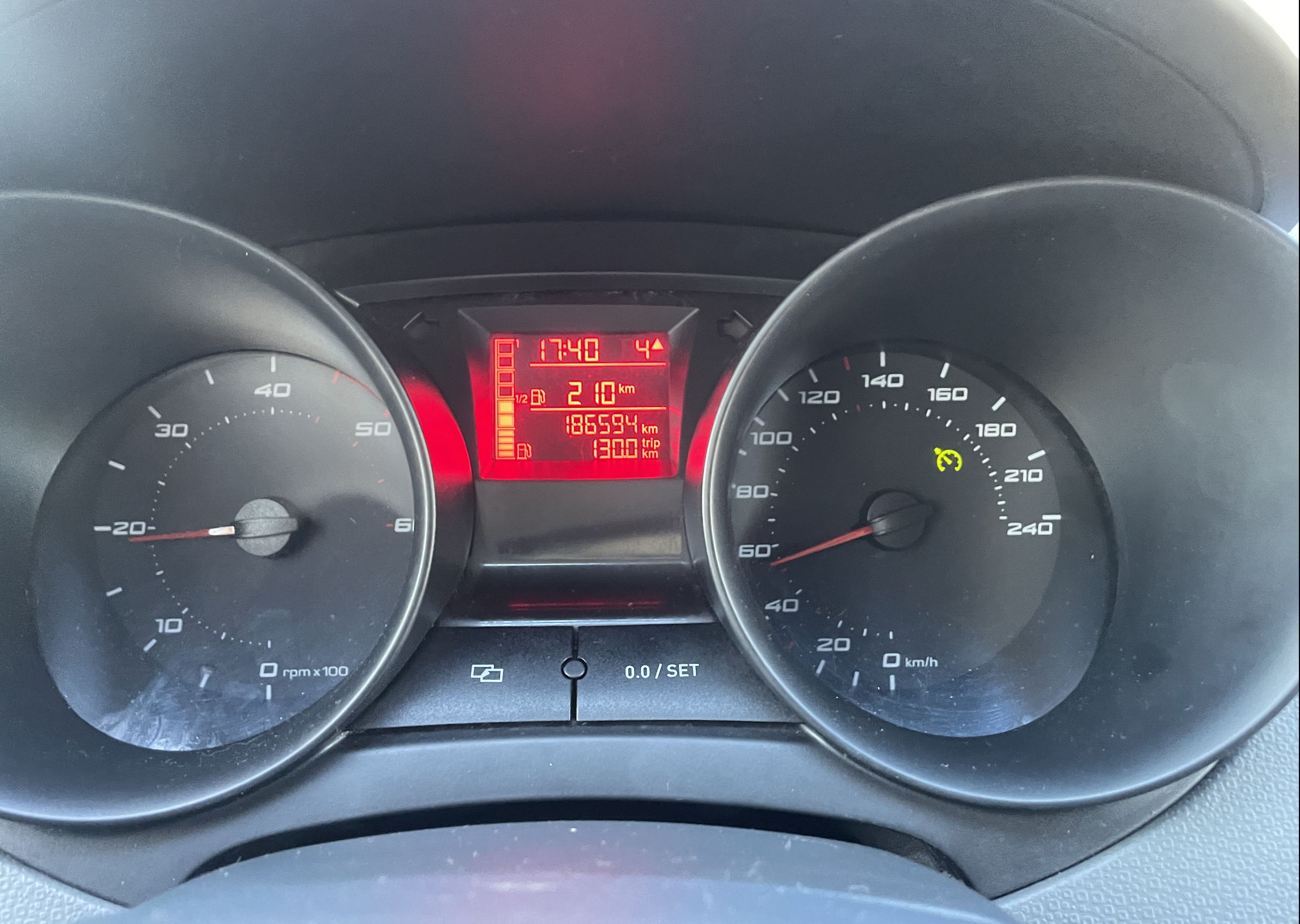

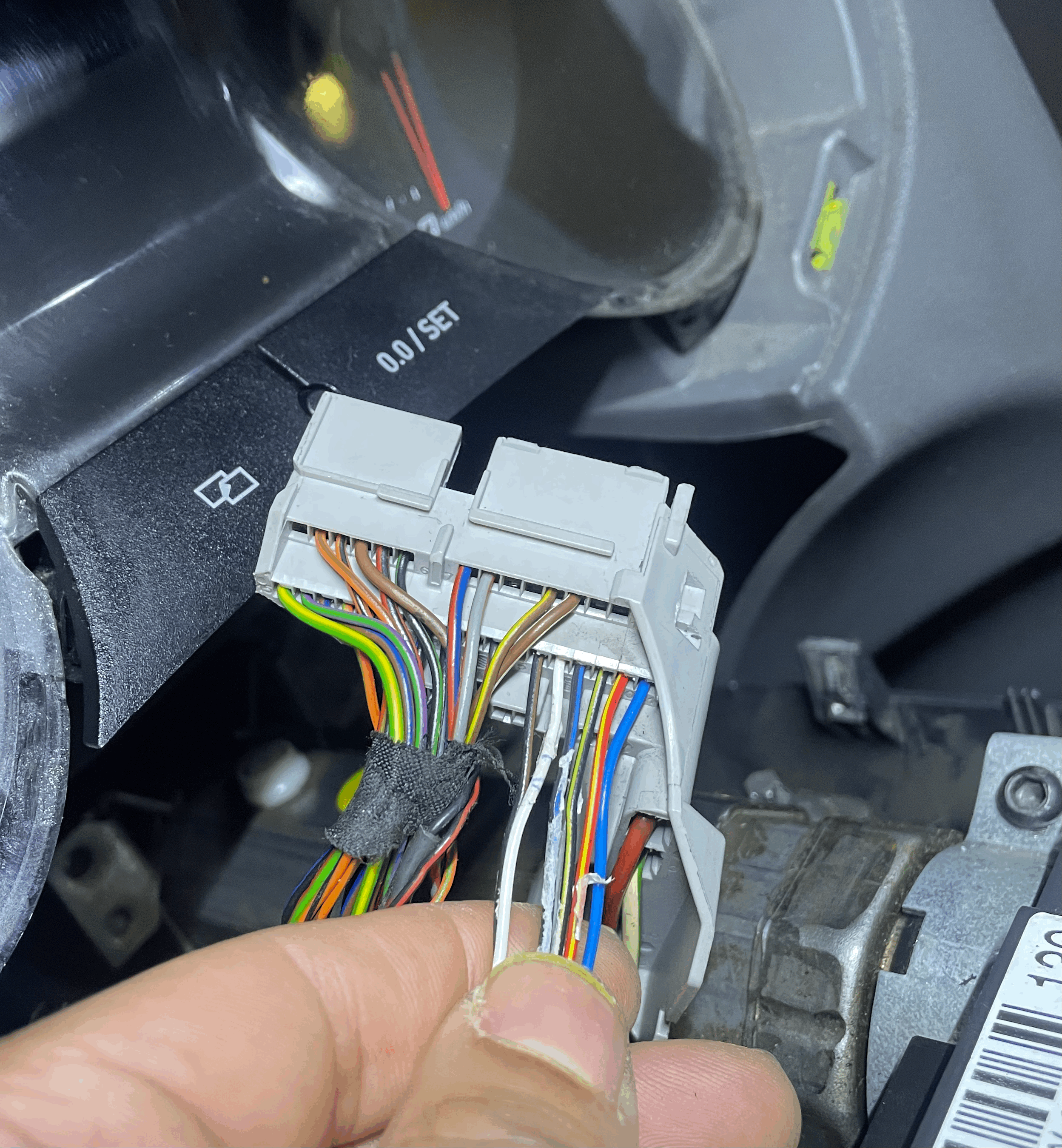

I solved the problem. :D It was a false contact at pin 28.
thanks
