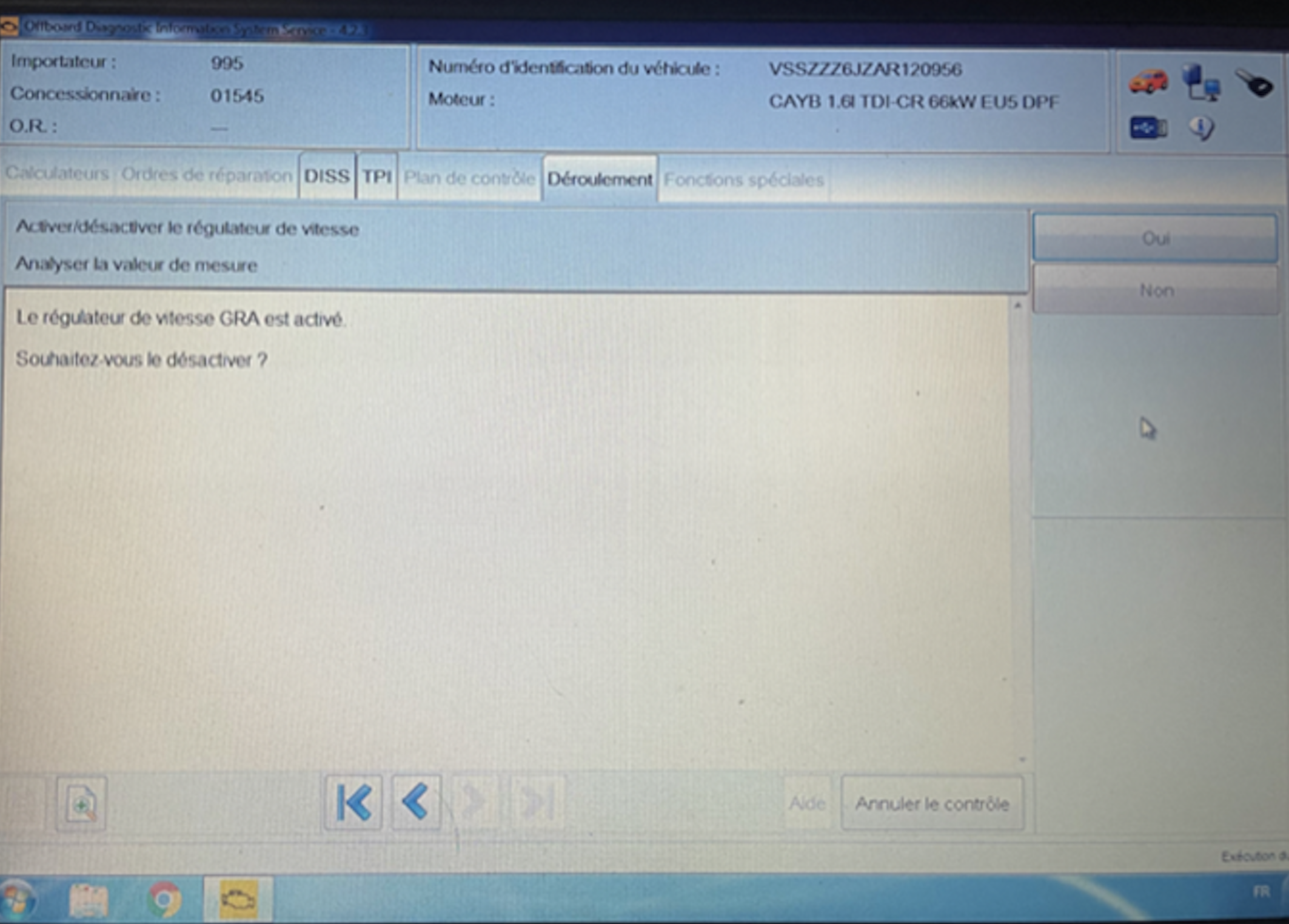

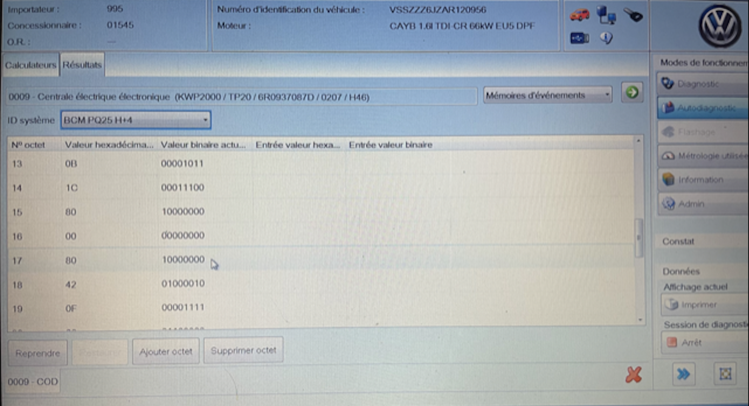

I have done the coding of the BCM and the engine ECU with Odis.

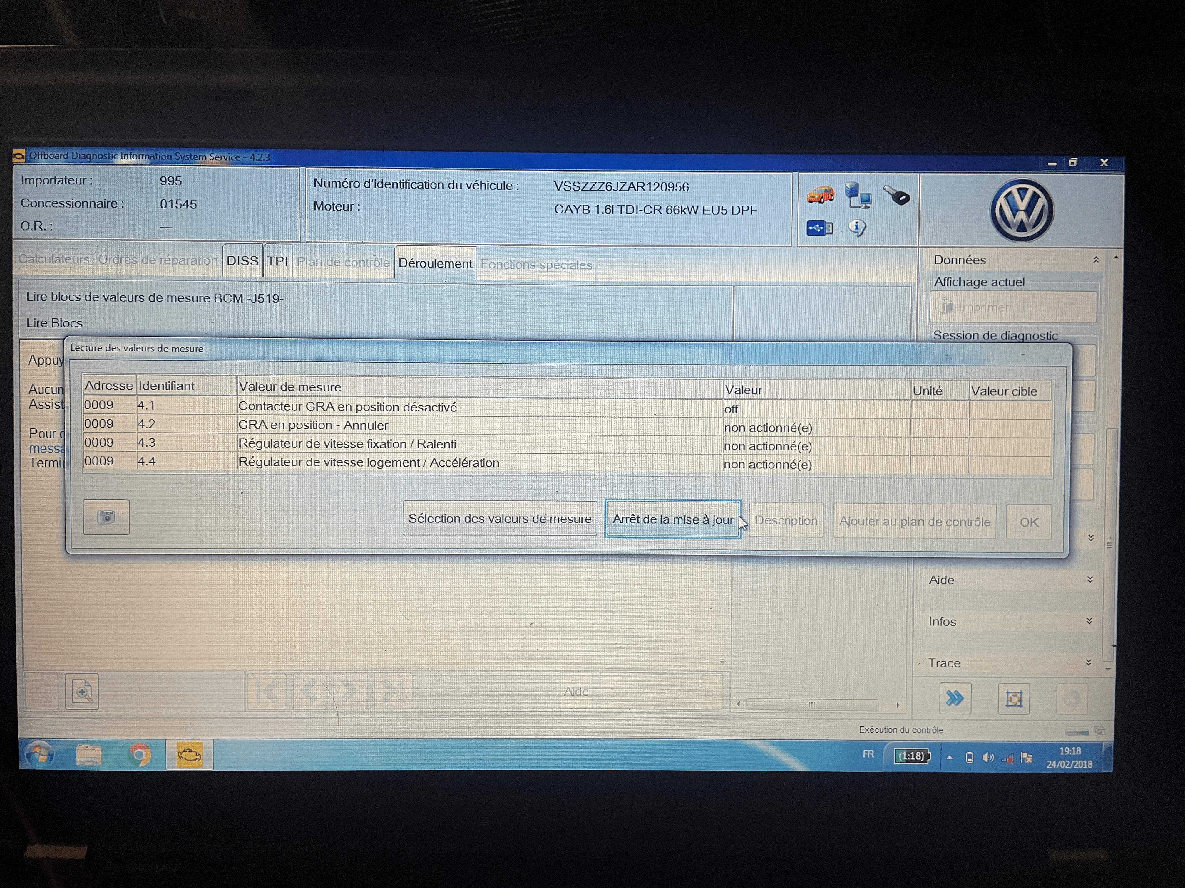

In the block of measured values of the 09 (see picture)
- when I activate the cruise control, the values do not change
I tested the cruise control with a multimeter, the buttons work. :roll:
Do you have an idea? thanks
Re: IBIZA 6J 1.6TDI 2010 Problèmes de modernisation du régulateur de vitesse

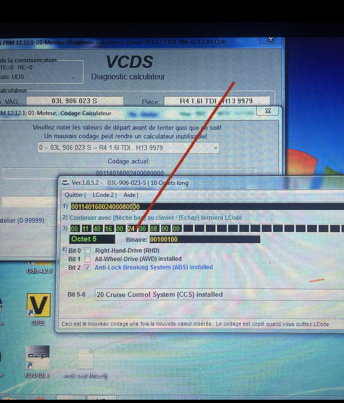

fuse OK? bcm byte 17 bit 7 ON? ECU byte 5 bit 5 ON?
MIKAR
Posts: 7
Joined: Fri Mar 04, 2022 9:50 pm
Drives: seat ibiza 6J
Location: france
Post by MIKAR »
Thank you for your quick reply.
I thought there was a problem with the fuse but it is in good condition.
I have 12v at pin T41 (28).
The coding in the ECU and BCM are normally good.
I will send you a copy of the vcds later today.
ECU GRA OK.png (3.52 MiB) Viewed 31252 times
BCM BIT 17.png (3.98 MiB) Viewed 31252 times

You did not code the ECU for cruise control.
MIKAR
Posts: 7
Location: france
Post by MIKAR »
thanks iichel, i don't understand why it wasn't coded though i activated it.
thanks again :D
MIKAR
Posts: 7
Location: france
Post by MIKAR »
I just checked, the regulator is activated in the ECU. I don't think it's coming from there.
vcds 12.12. bro, seriously?

HAHAHA, this is just to show you the coding.
but I use Odis

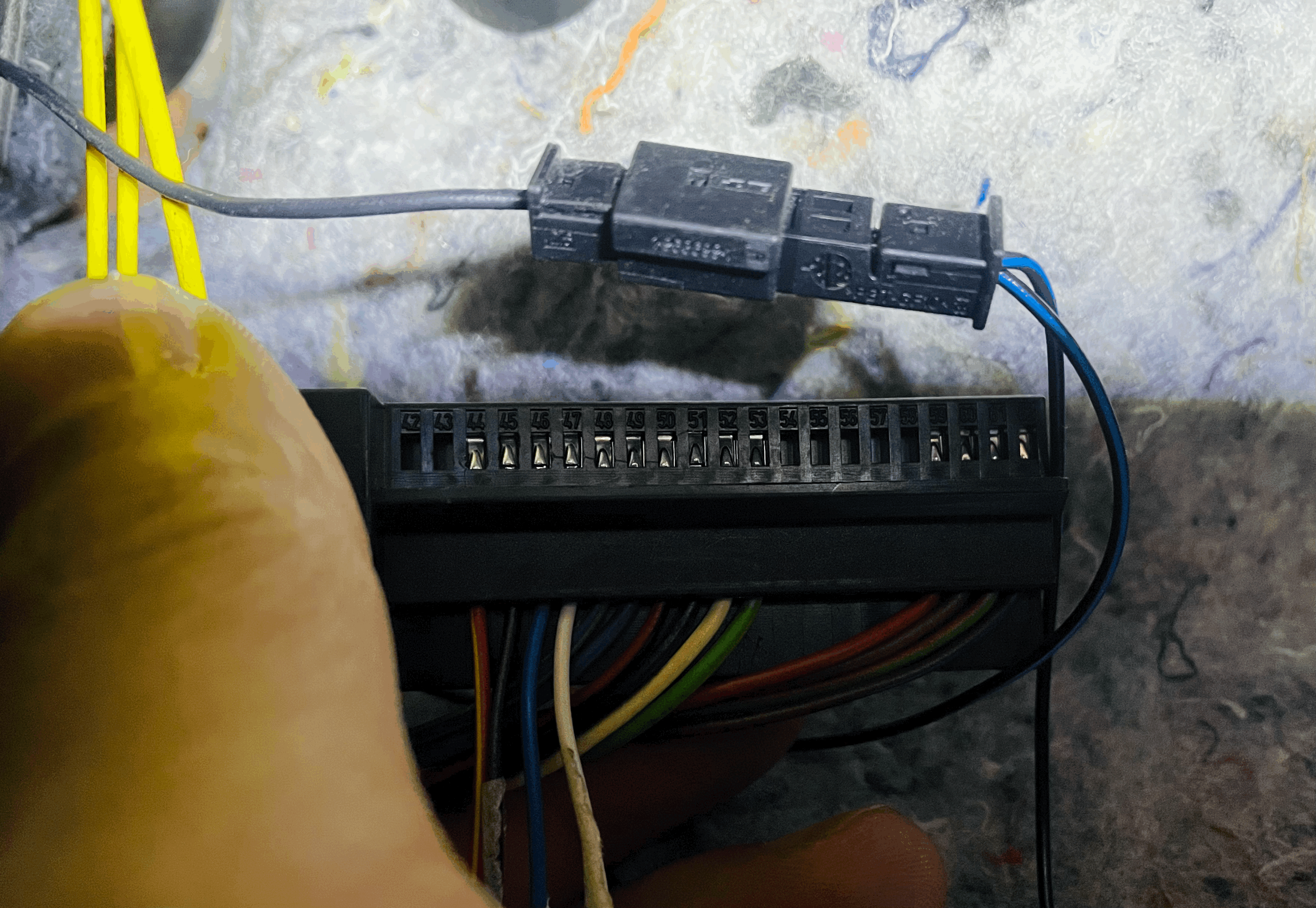

I solved the problem. :D It was a false contact at pin 28.
thanks
