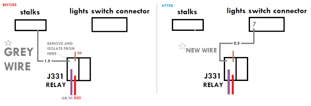

You probably have a low beam relay that operates the low beam. It is not controlled by your BCM.
This is an image that ciclo made for the Polo 6R with J331 low beam relay.
I suspect it works the same on your Transporter T5.1, perhaps the colours are different. I think this installation will solve (part of) your problem.
If you flash your high beam, will it illuminate a separate high beam light or will it 'click' the bixenon lens?

Post by BlackT51 »
When i flash with hibeam, lowbeam stops working
