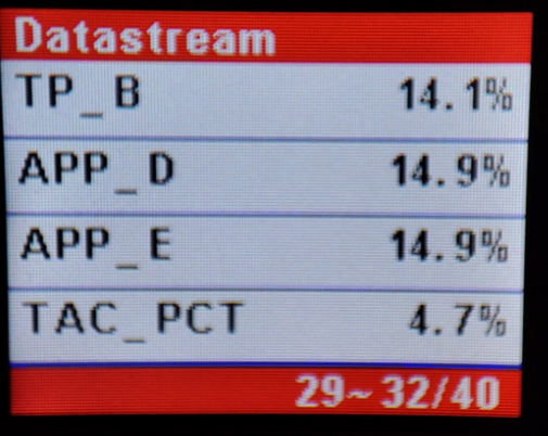

Hi all
I would have posted this in my current ongoing thread but would not expect anyone to read it there: viewtopic.php?t=78313
Could anyone let me know what the OBD value you have for Throttle Position (TP_B) at idle or just standing with ignition on via your scanner please. I can't find a specific reference to it on a search.. general values are said to be anywhere between 0 and 20 but that is dependent on the car/make. I can't find a specific reference/value to a Polo AW
Mine is 14.1% I have no idea if this is normal or high and if it may explain my, at working temperature, high Idle speed of 1,200 rpm
Any help appreciated

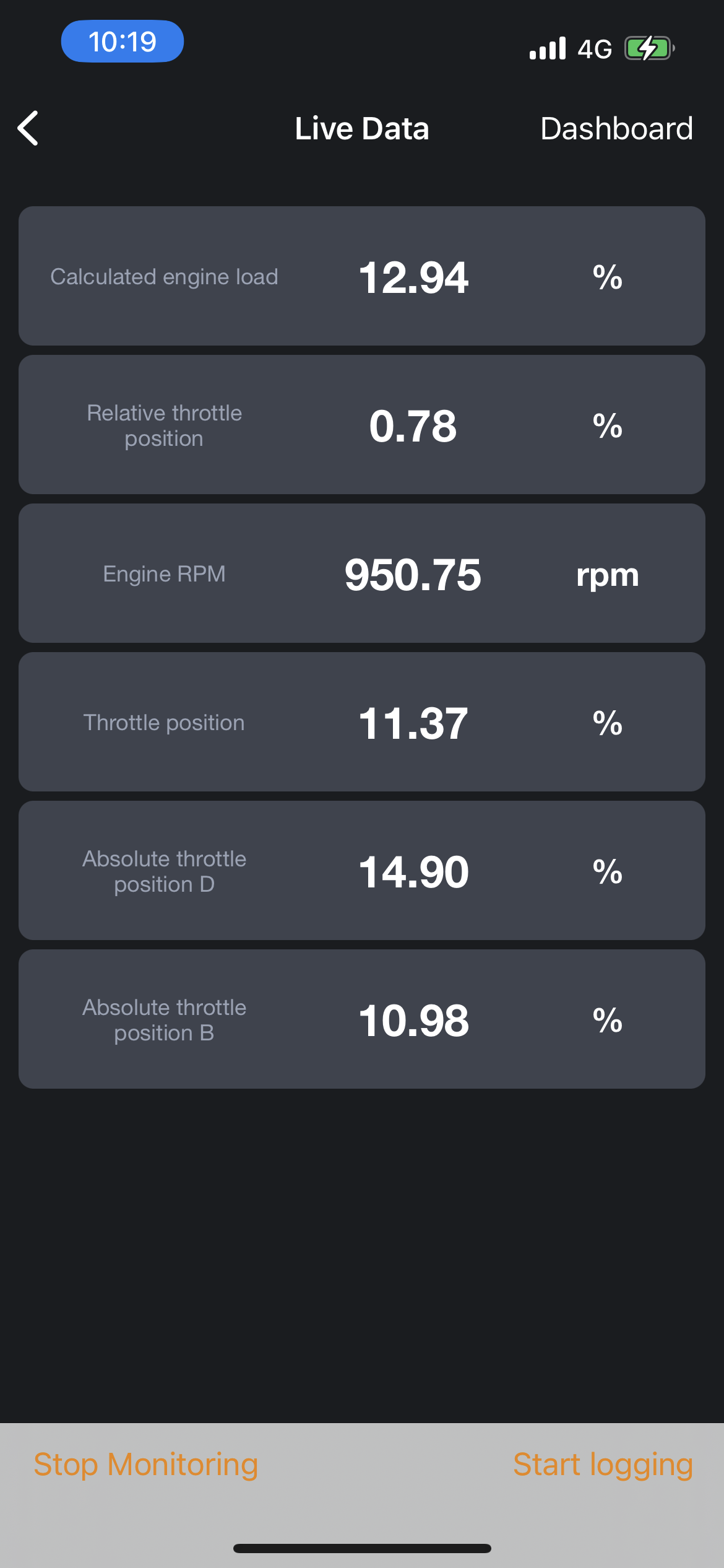

Harrihealey02
- Posts: 261
- Joined: Sun Dec 23, 2018 12:33 pm
- Drives: 2018 SEL
- Location: Essex
Re: what is your TP_B value on your 2018-22 1.0 TS1
As you can see this is with my engine at just under 1000 revs, looks like 950 is my usual RPM and the results are with my foot of the pedal just idling with a warm engine.
grazuncle2
- Posts: 365
- Location: Birmingham
Thanks for taking the trouble to do this test and posting the results..
there is a lot more information in your example!
regarding the position percentage values of your car @ 950 rpm.. I'm not convinced that my similar percentage readings.. around the same on most of yours.. are indicating a throttle position problem now. I otherwise would have expected yours would be high revving at idle too.
I don't know enough to say anything else... I can only say to the garage service dept (when i get it to them in two weeks time
) that the figures fluctuate a little lower when touching the throttle. other than that I'm at their mercy, or lack of it.
anyone else have input or experience of this issue?

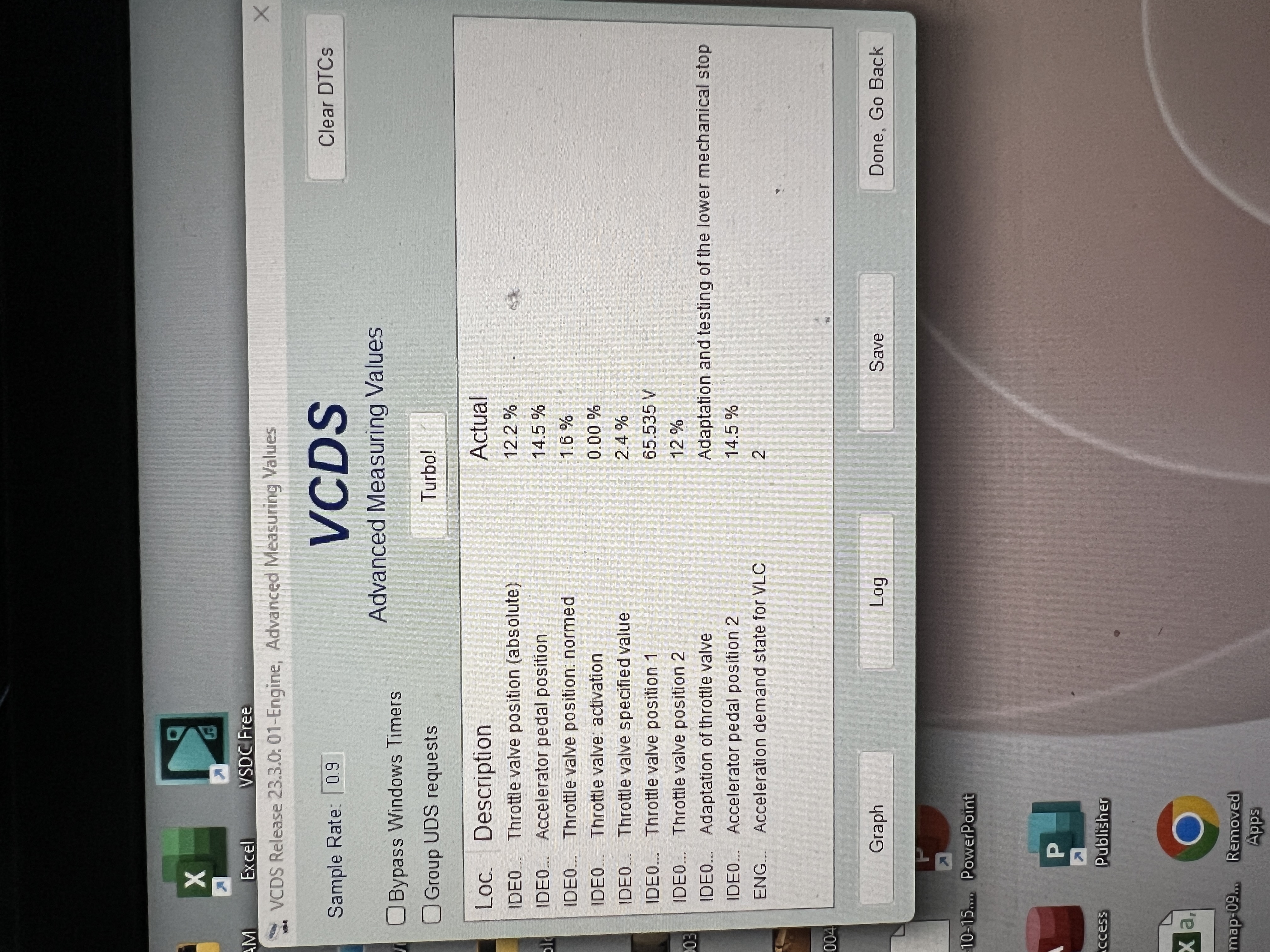

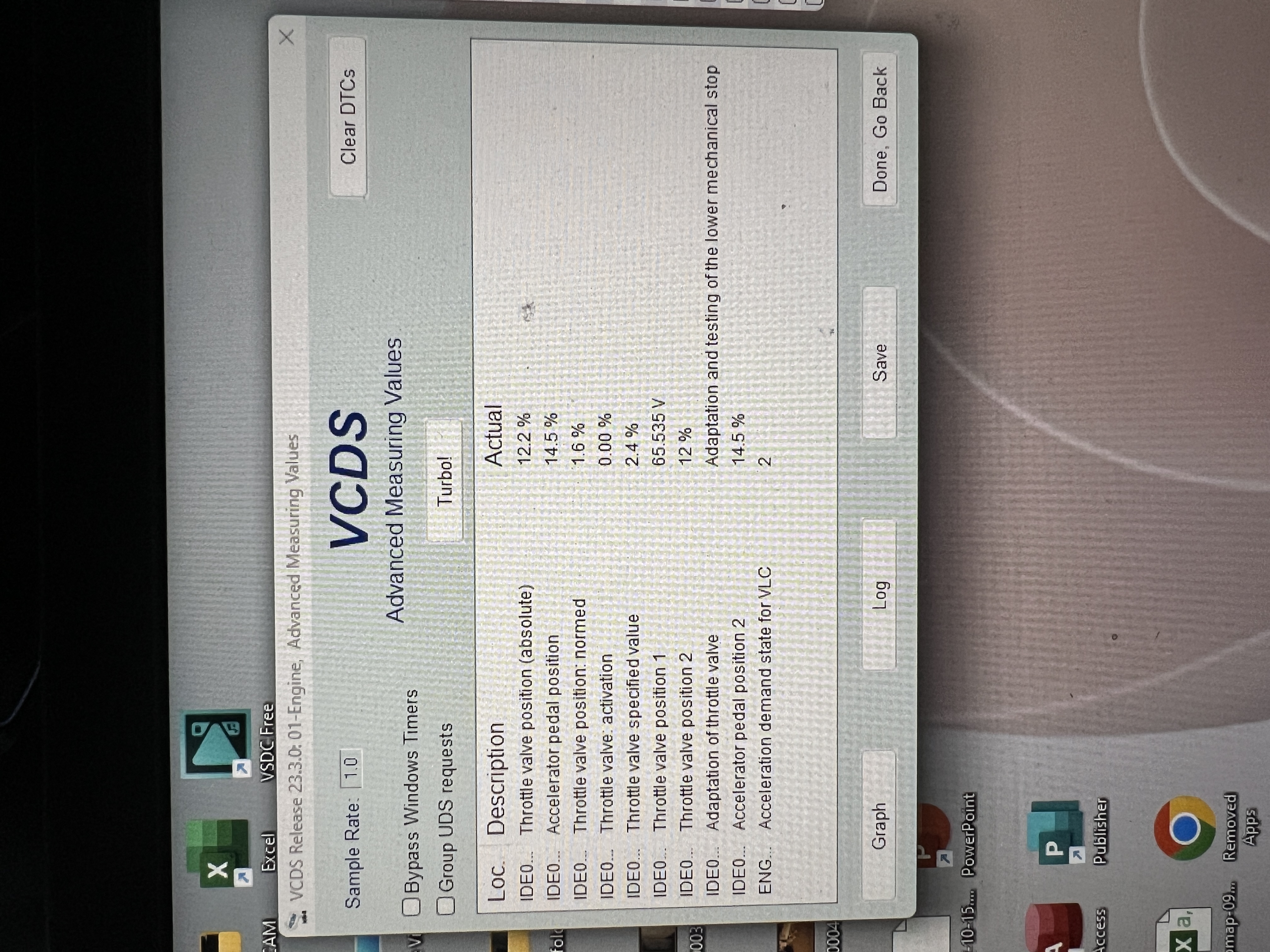

Harrihealey02
- Posts: 261
- Drives: 2018 SEL
- Location: Essex
There is one thing I notice on your reading, the TAC measurement unit is at 4.7, and on mine the same looks to be around 2 at idle, and when I revved mine to around 1.5k revs, my Throttle Valve Positon moved up to 4.5% and this number is similar to your TAC measurement unit, and your revs are around the same as what mine were when my reading was at 4.5 ish. This tells me that your throttle valve position is around 4.7 at idle when it should be around 2. This is the only correlation I can see. I don't mind helping with this sort of stuff as I am a into technology and this interests me

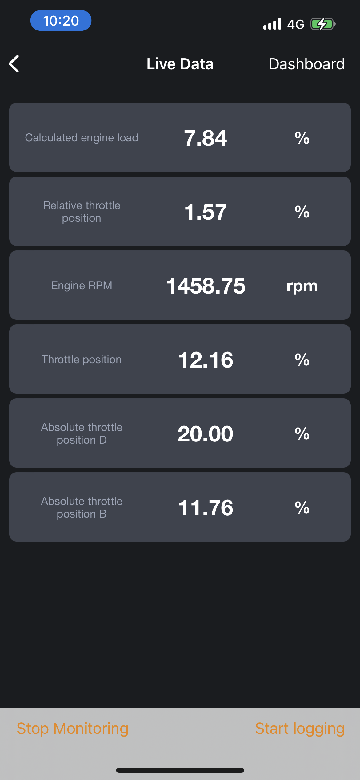

Harrihealey02
- Posts: 261
- Drives: 2018 SEL
- Location: Essex
I just took a reading including my Rev counter so you can see my usual idle and when revving to 1.5k
- IMG_8878.png (371.74 KiB) Viewed 3670 times
- IMG_8877.png (377.58 KiB) Viewed 3670 times
