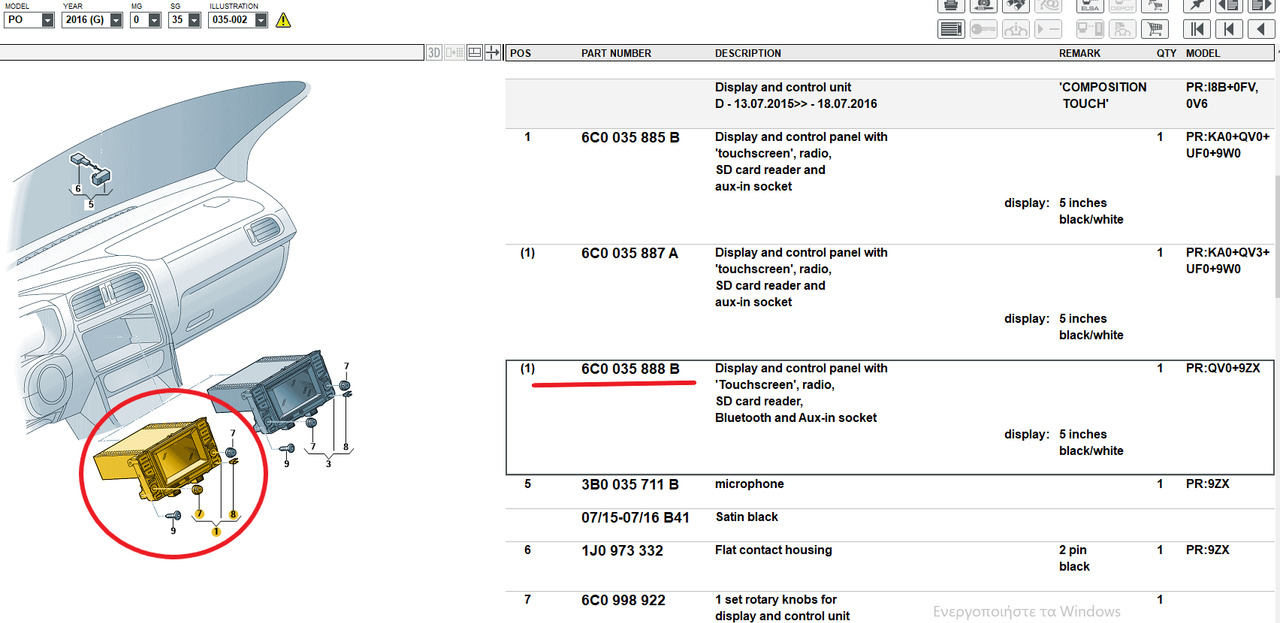

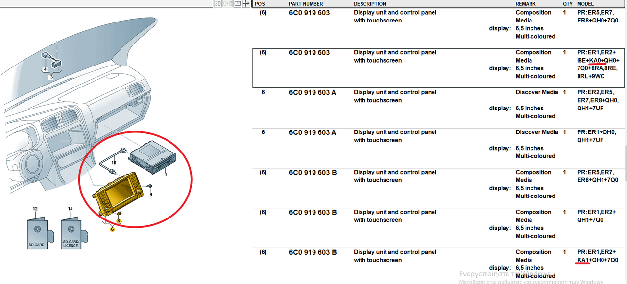

Image Image
Those are the choices from the ETKA, composition COLOR and composition MEDIA
The PR code KA0 is without rear camera system and the KA1 is with rear camera system. I don't know if the unit with PR Code KA0 is capable to manage rear camera.
If I install one of these, will I be able to fit a regular (non VW) cam afterwards and what would I need? (perhaps some signal converter, etc.)

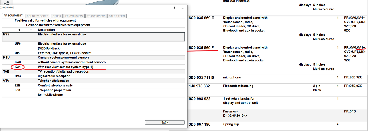

I am willing to buy this one.
The Pr Code KA1 is for Rear View Camera (type1)
For sure this unit can have rear camera.
What Type1 is ? I mean what kind of camera i should buy ?
This is the original code
Posts: 6685
Re: Polo 6c Composition touch possible rear camera retrofit
I'm not sure what type 1 means. In my experience, a most of aftermarket camera's with a 2-wire signal will work. I haven't seen one that didn't so far.

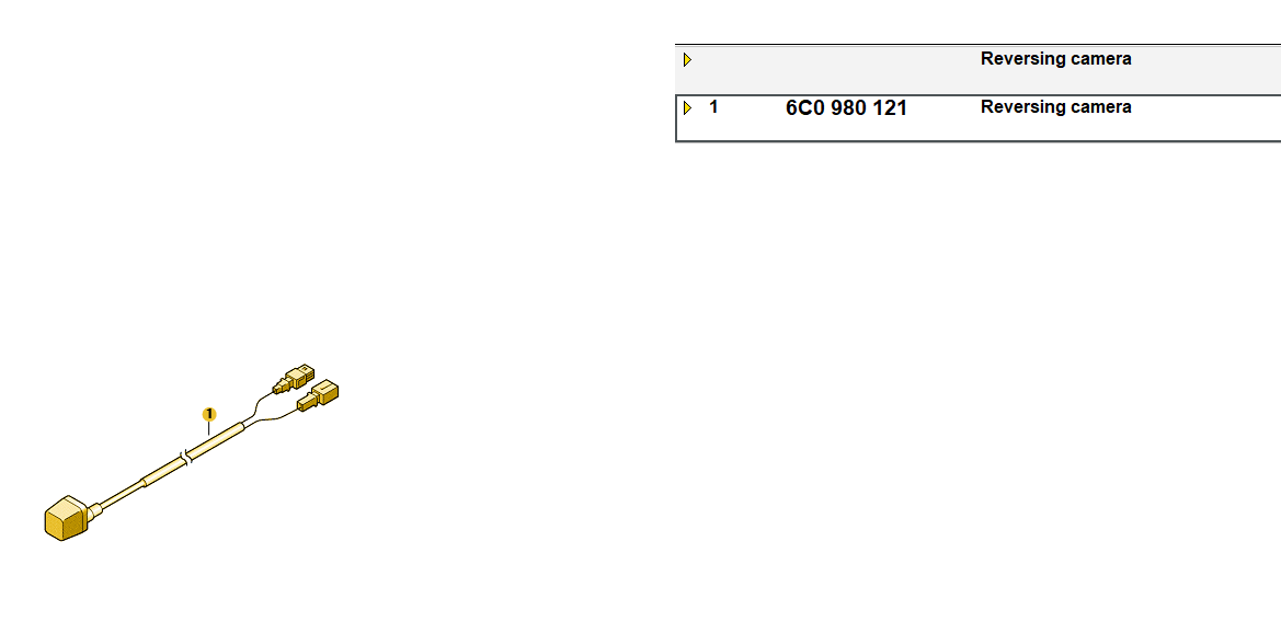

As i mentioned the camera VW code is 6C0980121
The camera described as Low Line
I can't find any other information about resolution and the TV system type ( i think it is NTSC).
