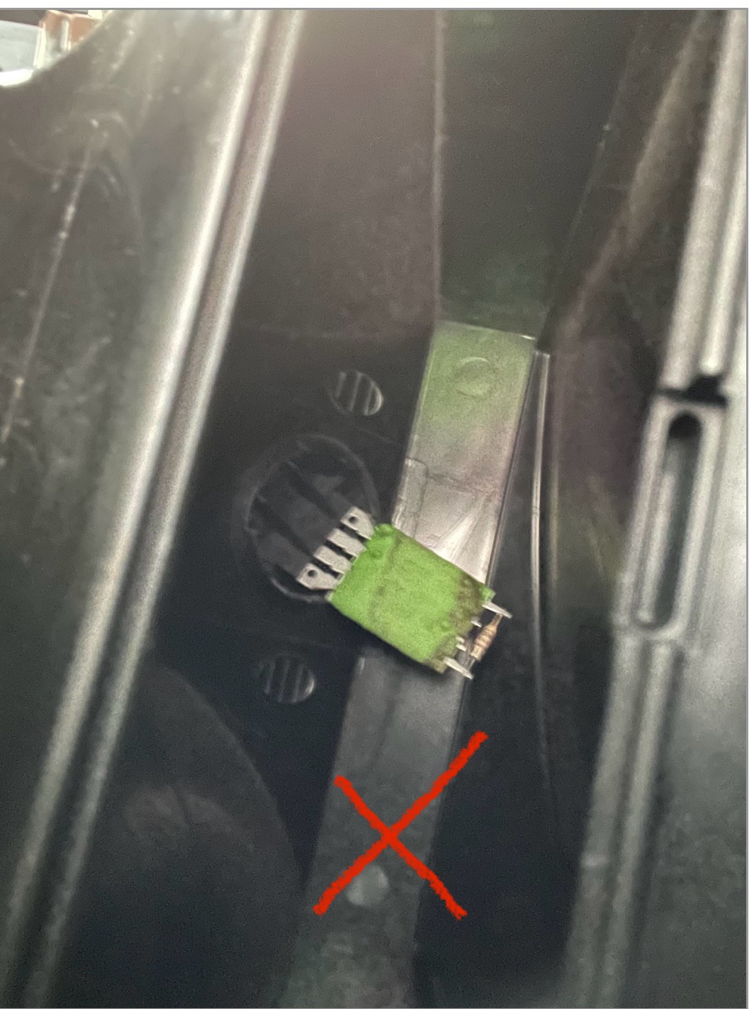

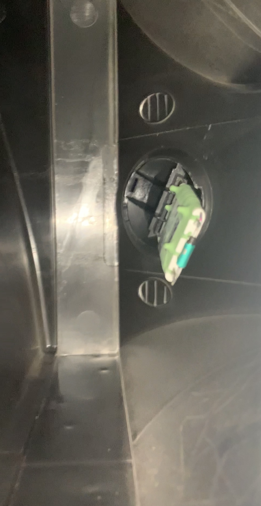

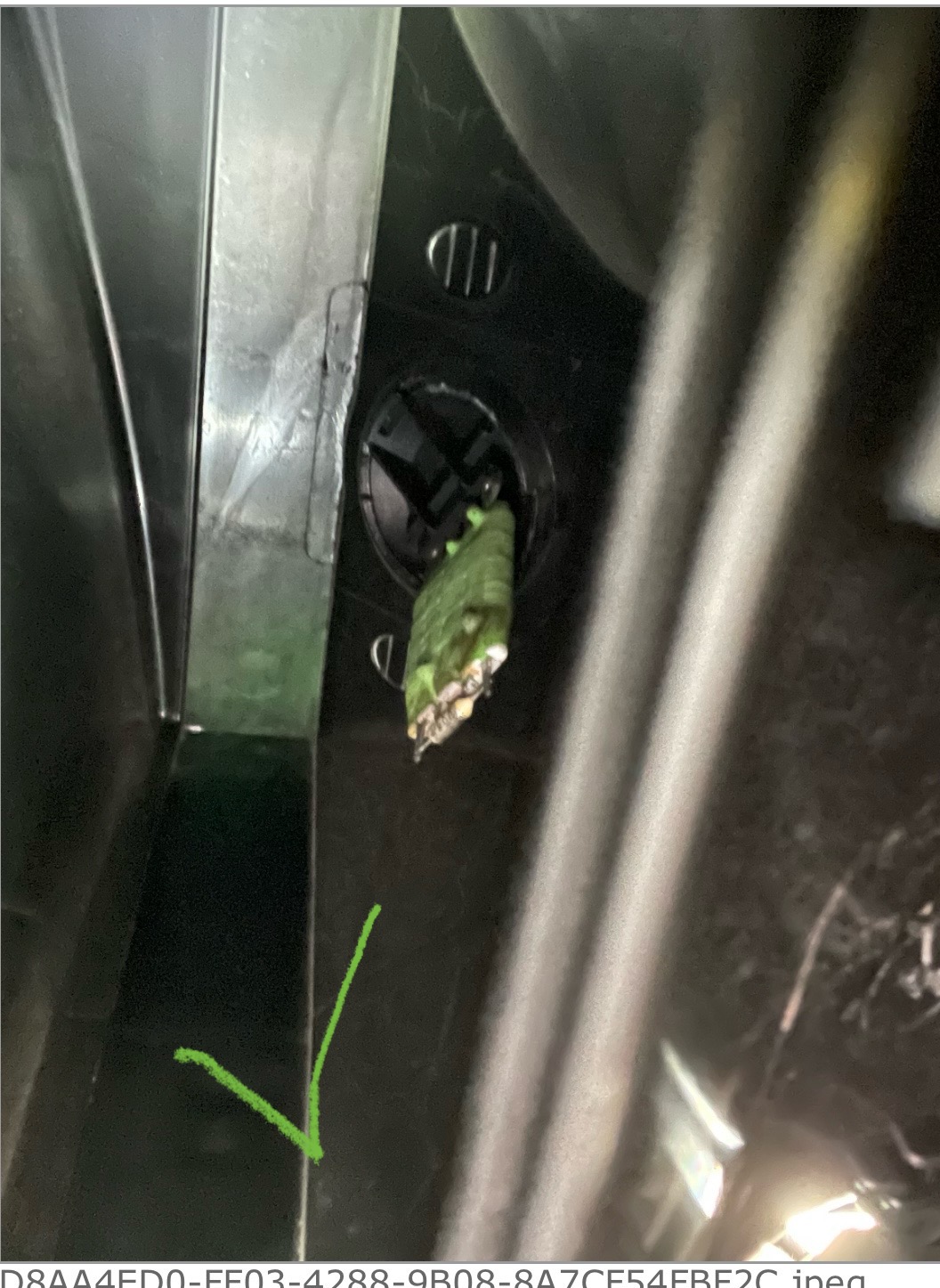

Hi there , i replaced the heater resistor on my polo ages ago, its a fiddly job but easy enough to do,
Its a weird one tbh as it didnt register till after i removed the pollen filter that i smelt burning from the dash a week or so before i had an issue with no heat on the first/ second heat cycle , anyway i purchased the resistor took pollen filter out & it has signs of burnt material & melting on one edge of it , i took the resistor out & it was black with burnt areas on the green part.
I quickly realized that for some odd reason it was touching the pollen filter & burning it & shorted the resistor , maybe i had pushed the filter in to far when i replaced it some sime beforehand ??
Anyway the resistor can clip in two ways but this is where you have to remember which way it clips in , if you clip it in the wrong way round the angle of the green bit will point the wrong way & potentually touch the pollen filter like mine did , i have sent a post ages ago with pics showing both ways it clips in .
I have noticed that some pollen filter cradles have a plastic sheaf that helps slot the filter in the hole but my polo gti hasnt got the plastic sheaf . Not sure if it was ment to have one or not but i got my car brand new of the vw dealership in 2016 .
If you smell any burning please check the resistor position as it may be that if youve clipped it in wrong.

Logic leads us to think that the resistor should be inserted vertically when installing it, however, the images are a very good contribution, logic is not always the correct way to proceed.

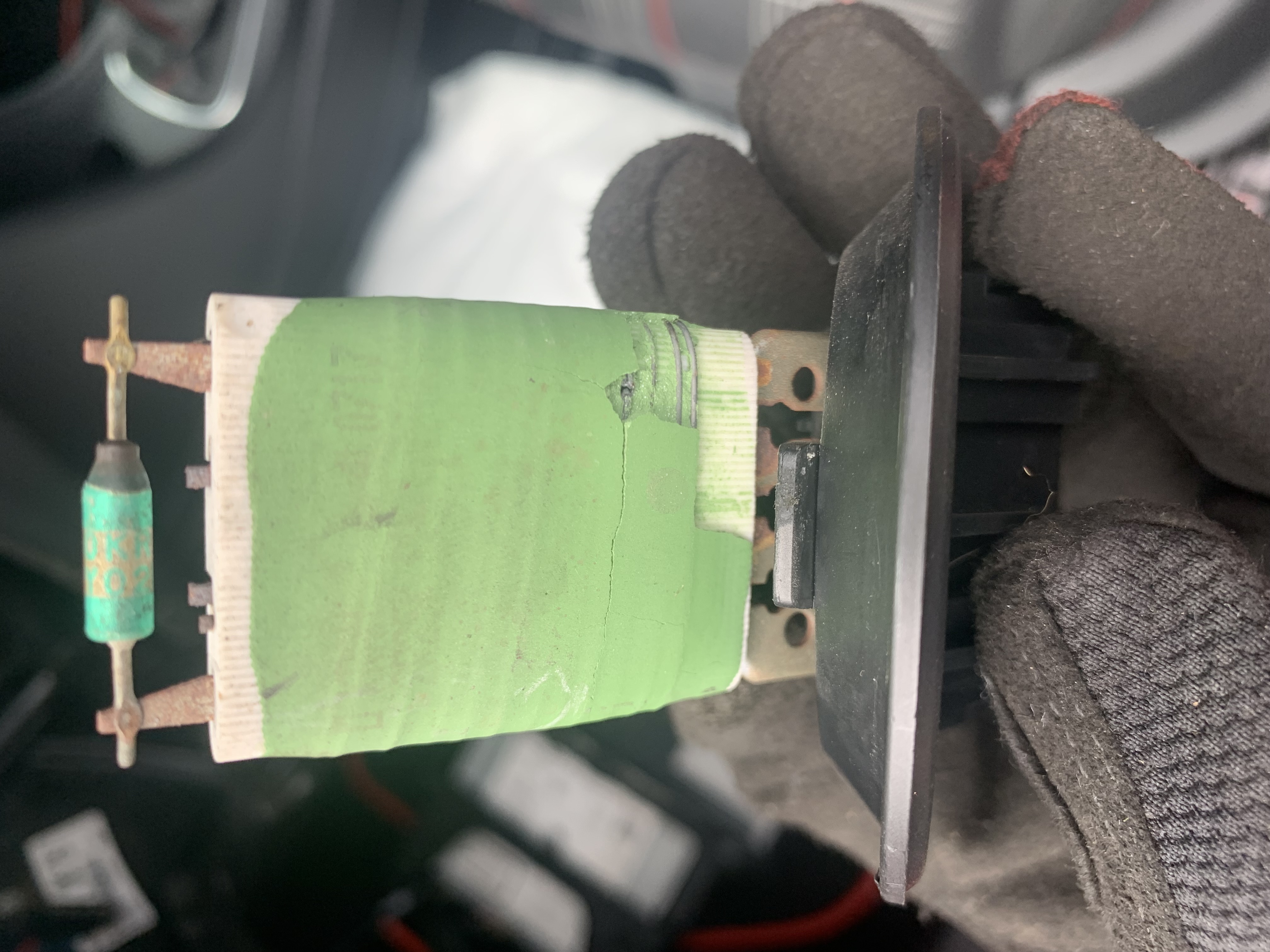

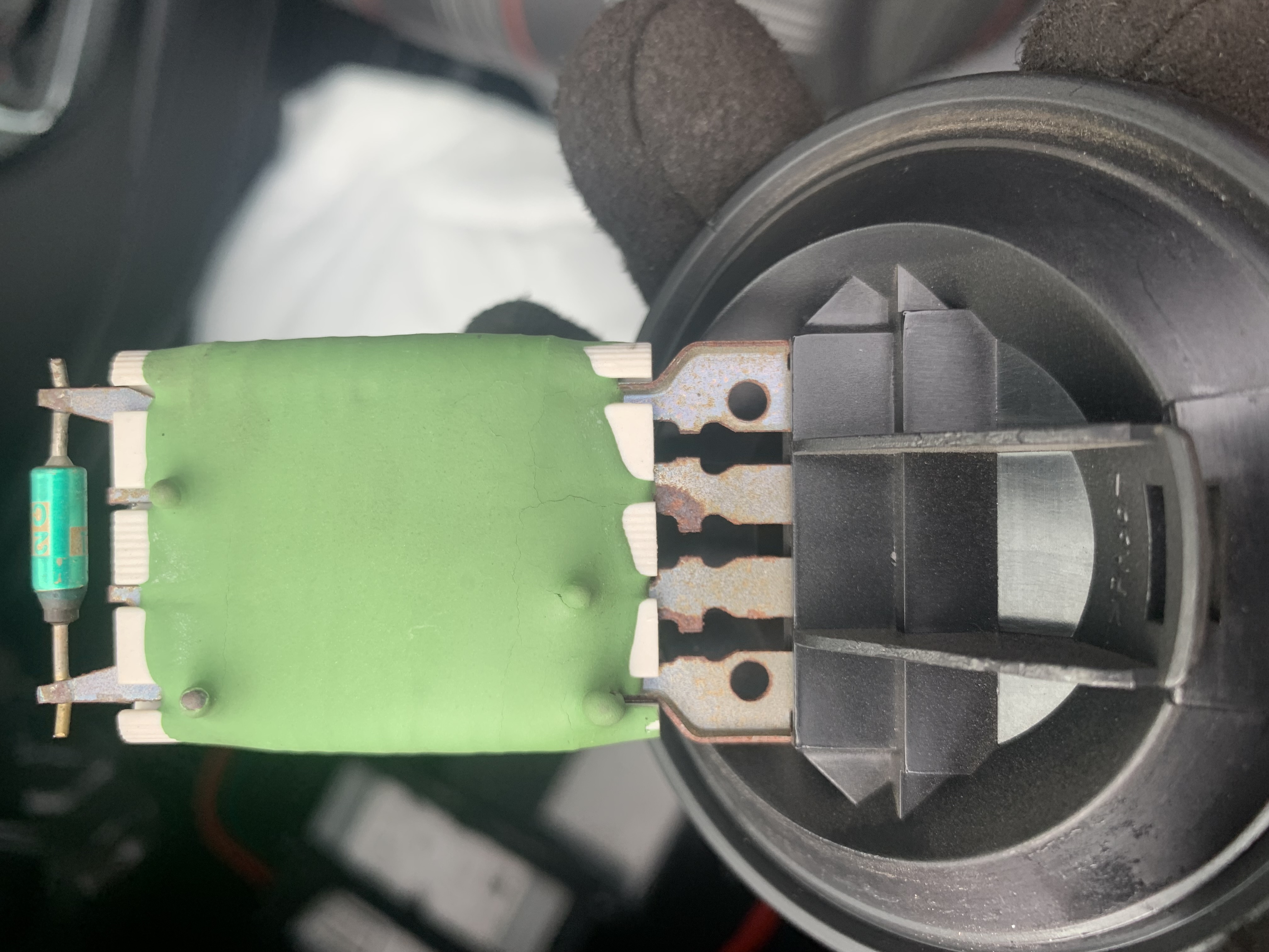

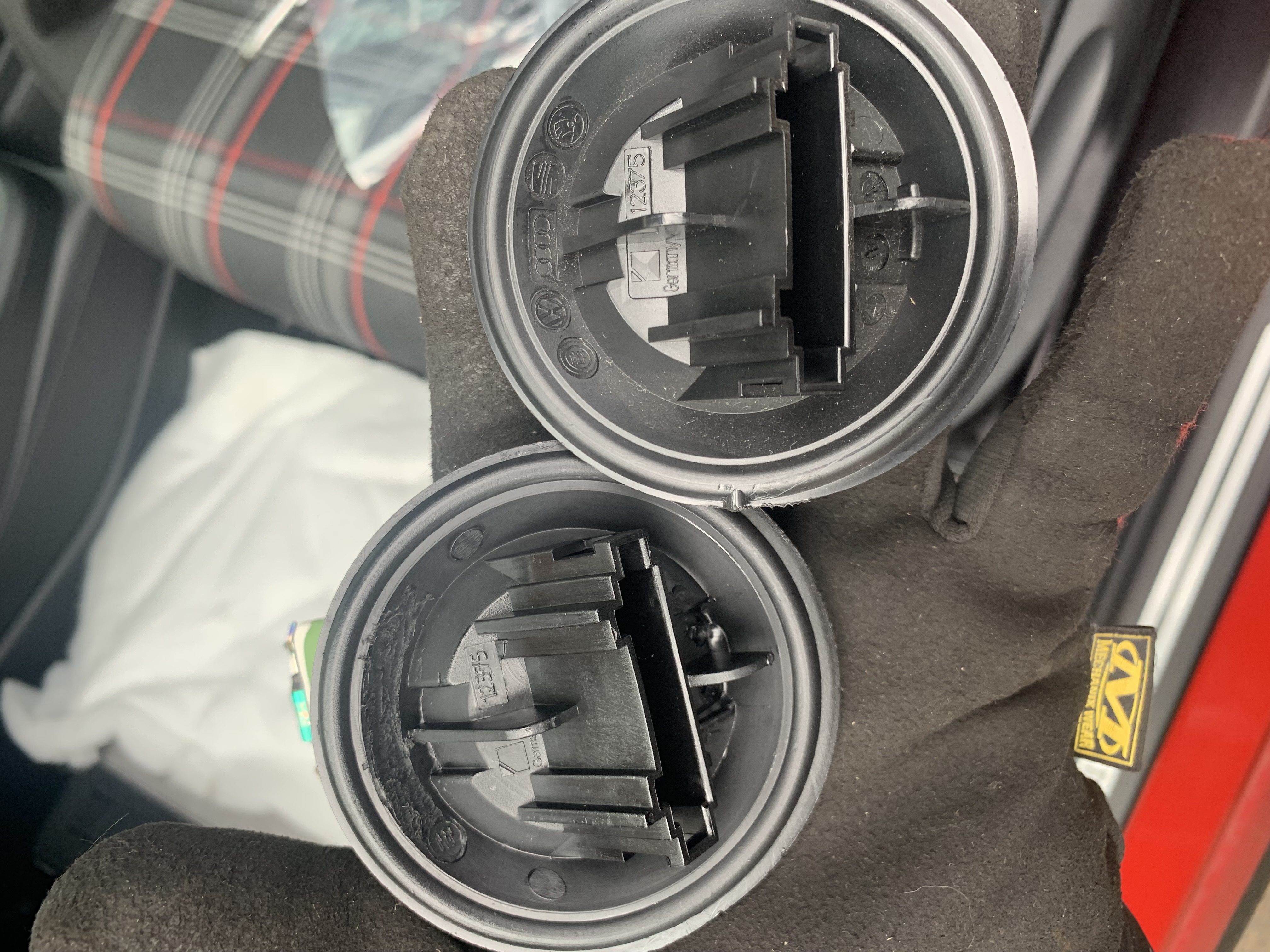

Managed to find some tiny channel locks that fit in the space quite well and got it in. I didn't feel a click but it's straight and even I couldn't get it back out
. If that bracket from the airbag that holds the glovebox was able to be removed the job would be so much easier.
Fans are back so I'm no longer driving around constantly turning the fan on and off while going deaf when it's on.
Seems my old resistor got a bit hot and also rusty which I thought was a bit odd. Although it is pre-filter so technically exposed to moisture from the outside.
Also seems Mahle is an OEM for the resistor pack as there were some interesting markings that had been removed

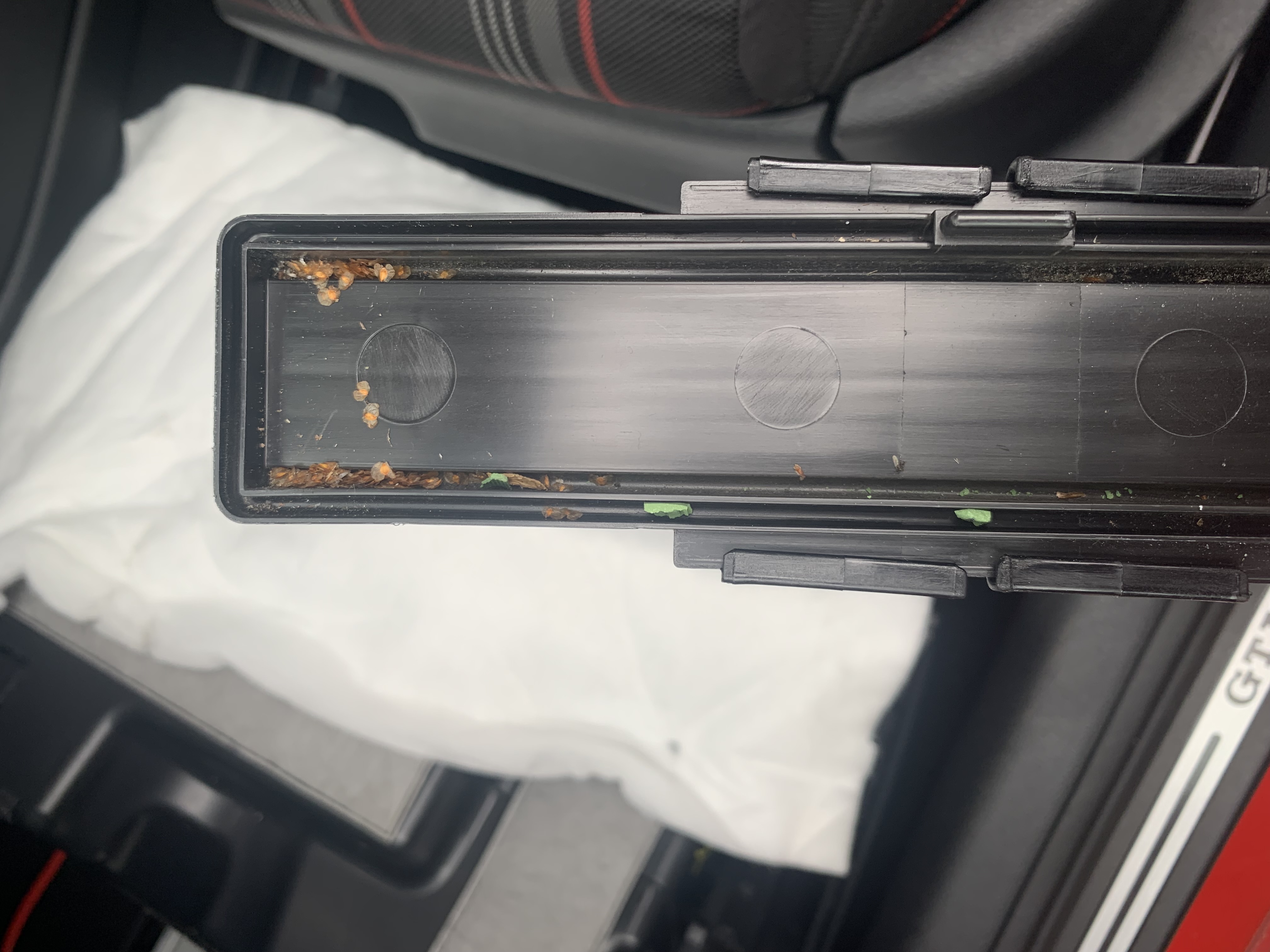

If you do carry out this job it's worth removing your cabin filter as the green "stuff" collects in the filter As for getting the pack out. I was able to turn it with a flathead screwdriver being very careful not to slip and stab something with it. Push it up into the cavity behind the airbag then out with the resistor coming out pointing to the back of the car. Unplug, replace with new and do all that in reverse.
30-45 minute job without being rained off but I've had my glovebox out before so was made quicker by knowing what had to come out and how.
