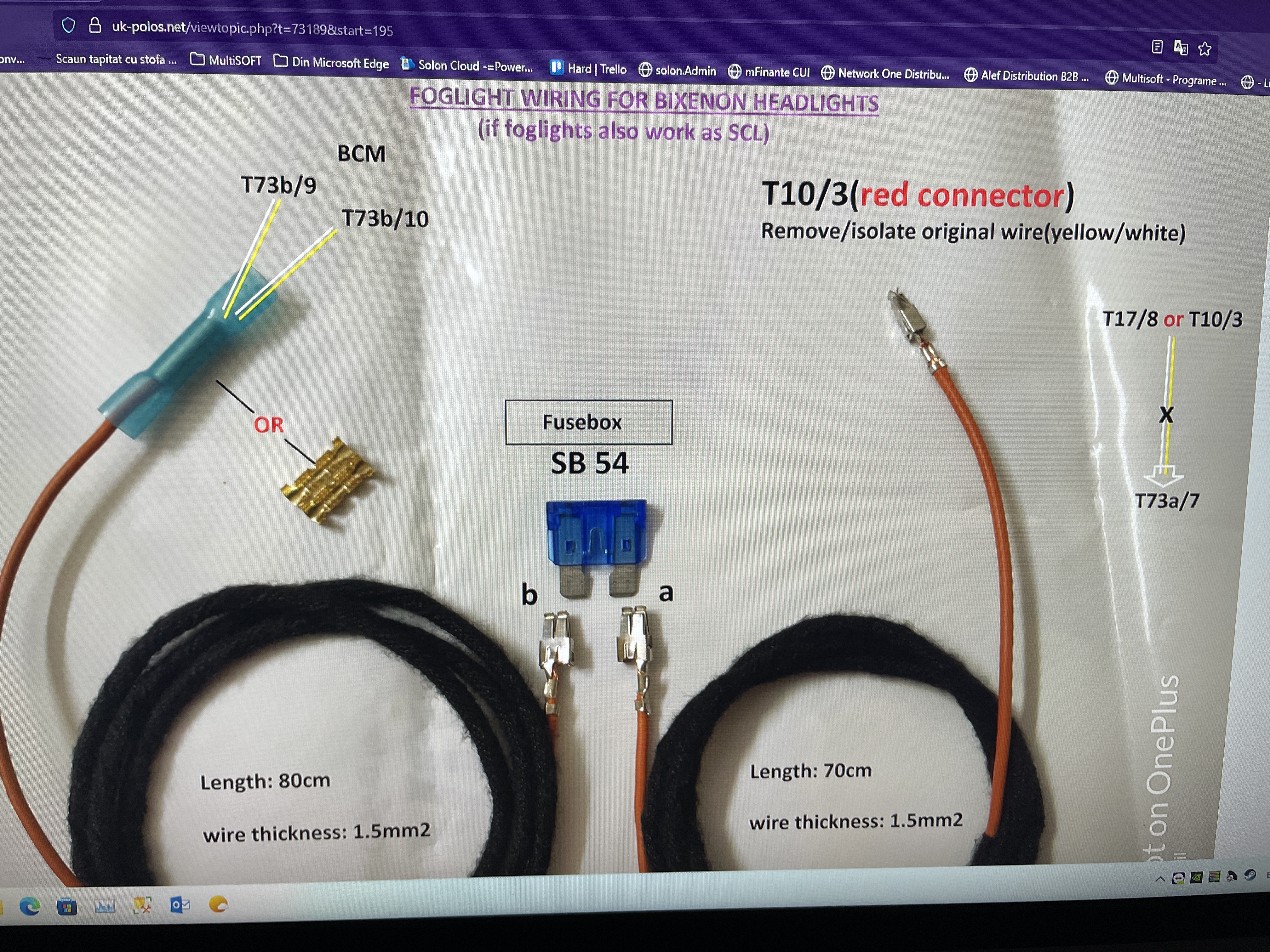

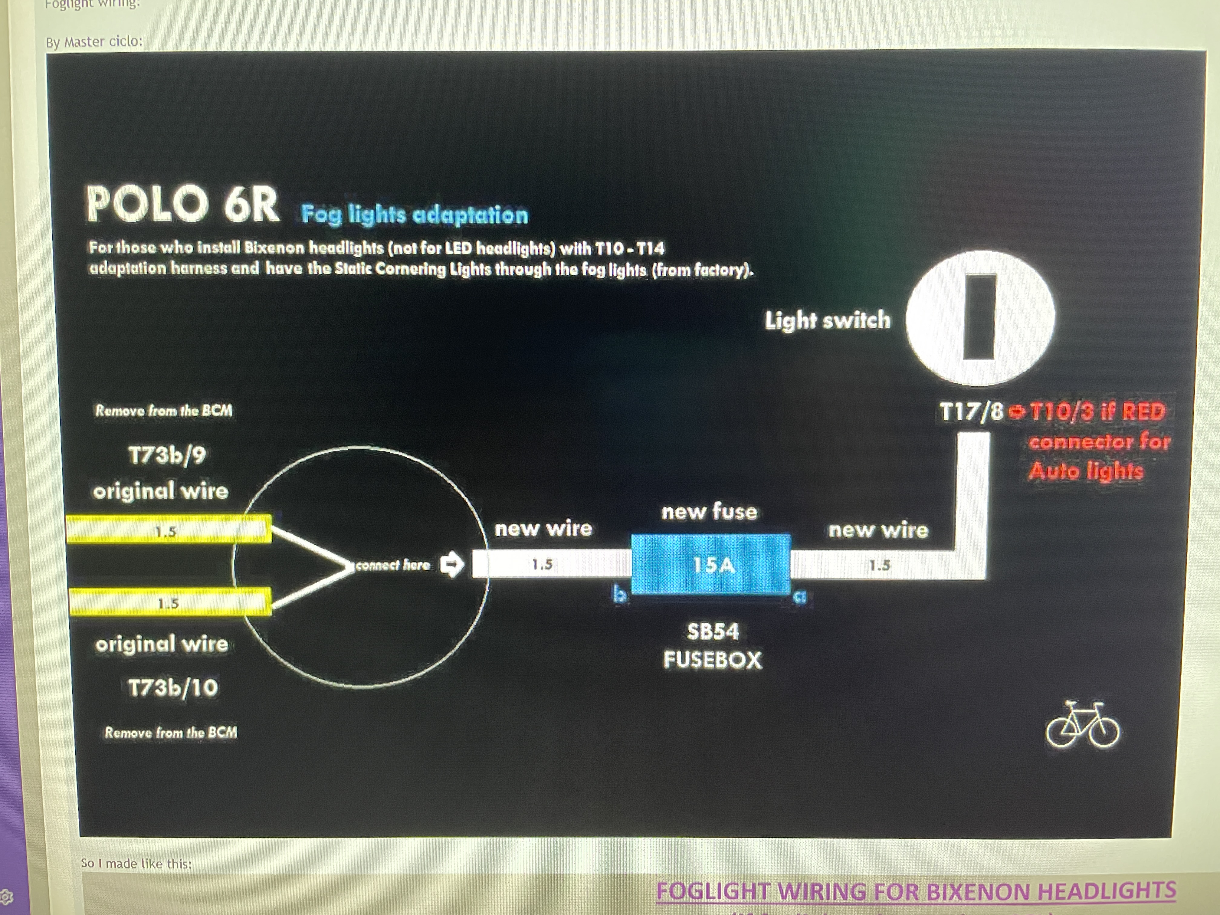

The result for the above configuration:
1) Light switch 0 = LEDs and high beam work (shutters and lights).
2) Light switch "position lights" = LEDs and high beam work.
3) Light switch "on" = LEDs still on, xenon headlight comes on, high beam works fine with lights (Bi-Xenon) and fog turn signals work if I signal.
4) Light switch "fog lights" = LEDs still on, fog lights in headlight do not work, high beam works fine with lights (Bi-Xenon).
I am attaching the scan after this installation as you asked and some pictures of the beast.

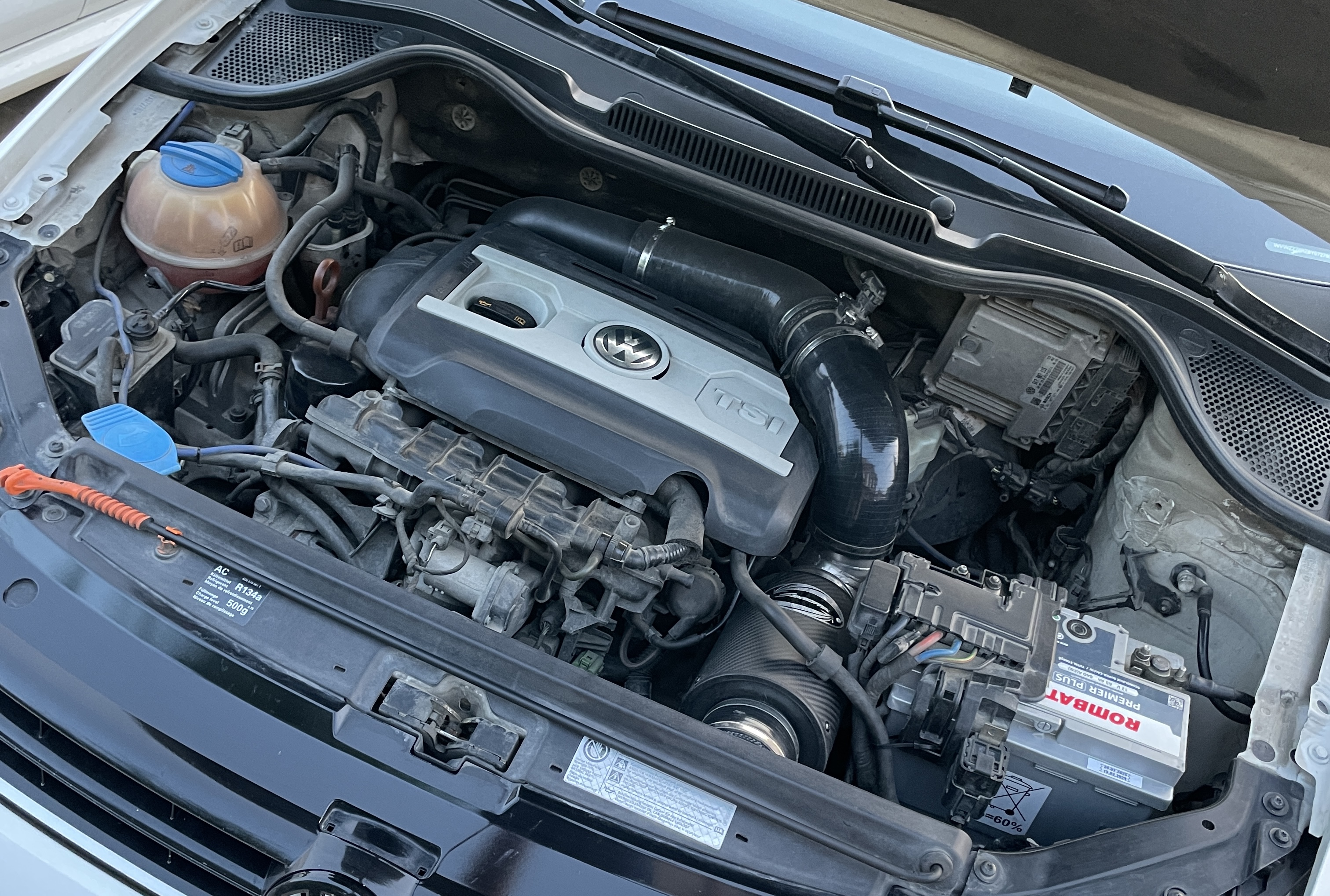

Re: Polo 6r GTI - Bi-Xenon installation Issues
- IMG_2972.jpeg (3.63 MiB) Viewed 1918 times

- lvu89
- Posts: 9
- Joined: Sun May 25, 2025 8:31 pm
- Drives: VW Polo 6R (WRC 2501/2500)
- Location: Constanta, Romania
- IMG_2970.jpeg (2.37 MiB) Viewed 1915 times
- Posts: 9037
Thanks for showing us the beast.
Everything's great, except for the SCLs (static cornering lights) and the license plate lights... as expected.
The lights you're referring to as fog lights in the headlights are called SCLs. Info:
viewtopic.php?p=493598#p493598
Easy to fix...
SCLs:
Since your original installation had SCLs in the fog lights via fuse SB57 -according to your fuse box-, all you need to do is transfer the positive wires from your old fog lights connectors to the 14 terminal in T14 connector on your bi-xenon headlights (T14/14).
Example image (cornering lights only - blue lines). https://drive.google.com/file/d/0B2nv91 ... -One-hbY_Q
LPLs:
To fix the license plate lights problem, you need to run a NEW wire from T73b/7 to the positive terminal of both license plate lights. Cut the original wires for the license plate light supply (be careful, it's still live and must remain that way, and must be carefully insulated) and connect the new wire to both license plate lights. It's not necessary to remove the bumper, it can be done in the trunk area by removing the rear trim.
Example image:
Do these two simple tasks with the negative battery terminal removed!!
Please tell us the results. Thank you.

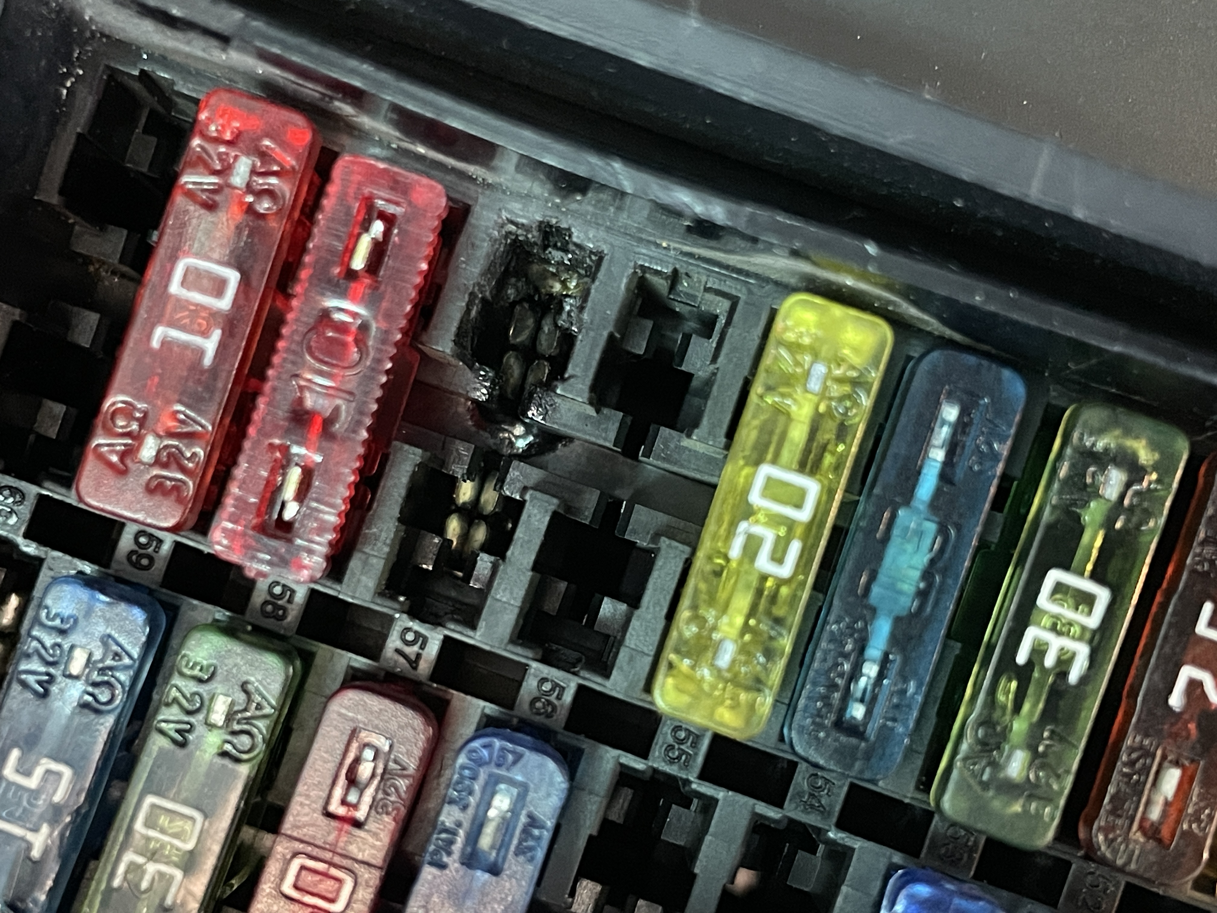

oops! Something is wrong. Now, checking the SB57 7.5A fuse I noticed this:
It seems to have heated up/melted. Why?
- IMG_2992.jpeg (2.1 MiB) Viewed 1891 times
- Posts: 9037
This may be due to having both bulbs/lights powered by the same line/wire, both the old fog lights and the new SCLs.
How they work is defined in the BCM coding... If bi-xenon headlights are installed, it should be coded as 'front fog lights with SCLs not installed' (I coded that way).

Well the old fog lights are connected to the SB54 fuse according to this diagram.ciclo wrote: Sat Jun 07, 2025 12:29 pm This may be due to having both bulbs/lights powered by the same line/wire, both the old fog lights and the new SCLs.
So I don't think that's the reason. I'm afraid it will get worse. What should I do?
- IMG_2939.jpeg (3.36 MiB) Viewed 1856 times

Obviously, I don't know what "real" modifications you've made to your 6R's wiring; that's something only you can know.
In this image you showed of your SB fusebox
https://uk-polos.net/viewtopic.php?p=608311#p608311 , fuse SB54 is missing!, but fuse SB57 is present... and then you show a picture of the SB fusebox with the SB54 fuse installed and the SB57 slot with superficial burns
https://uk-polos.net/viewtopic.php?p=608382#p608382 ....
I have some fortune-telling skills, but I didn't think they were necessary here.
Because of the front R bumper, you currently don't have front fog lights, so the original wiring or wiring them through fuse SB54 doesn't make sense under any circumstances. This wiring is through the light switch, without BCM control and, of course, without SCLs.
The wiring for the SCLs in the bi-xenon headlights must be done with three wires.
- one wire for the BCM power supply from fuse SB57.
- and two wires from the BCM to the bi-xenon headlights.
And in your particular case (front R bumper) you must remove the T17/8 wire from the light switch connector and insulate it appropriately.
The following diagrams will make it clear.
L
R
+30 (15A fuse)
Do it this way, and your SCLs will be operational.
L
R
+30 (15A fuse)
