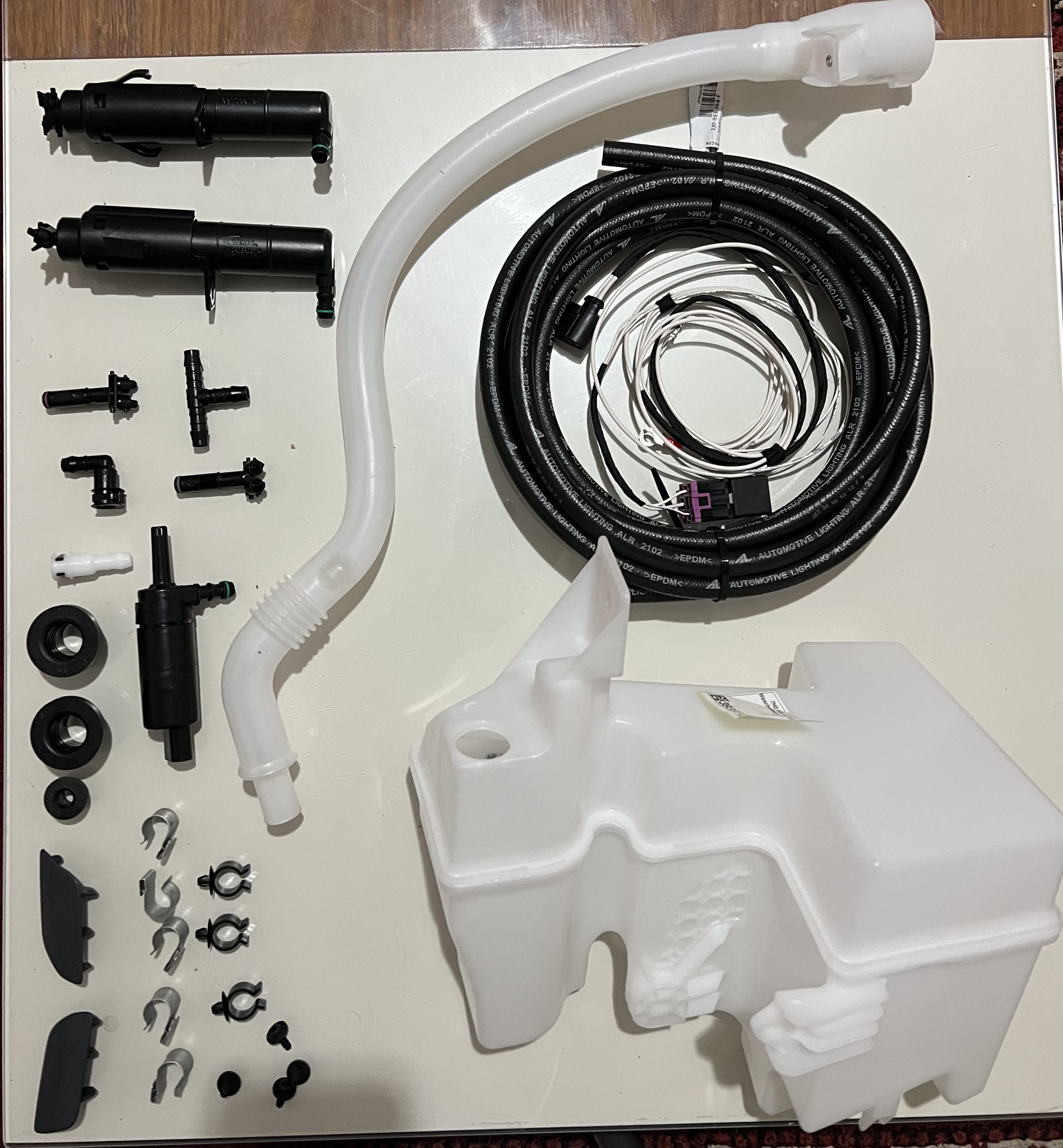

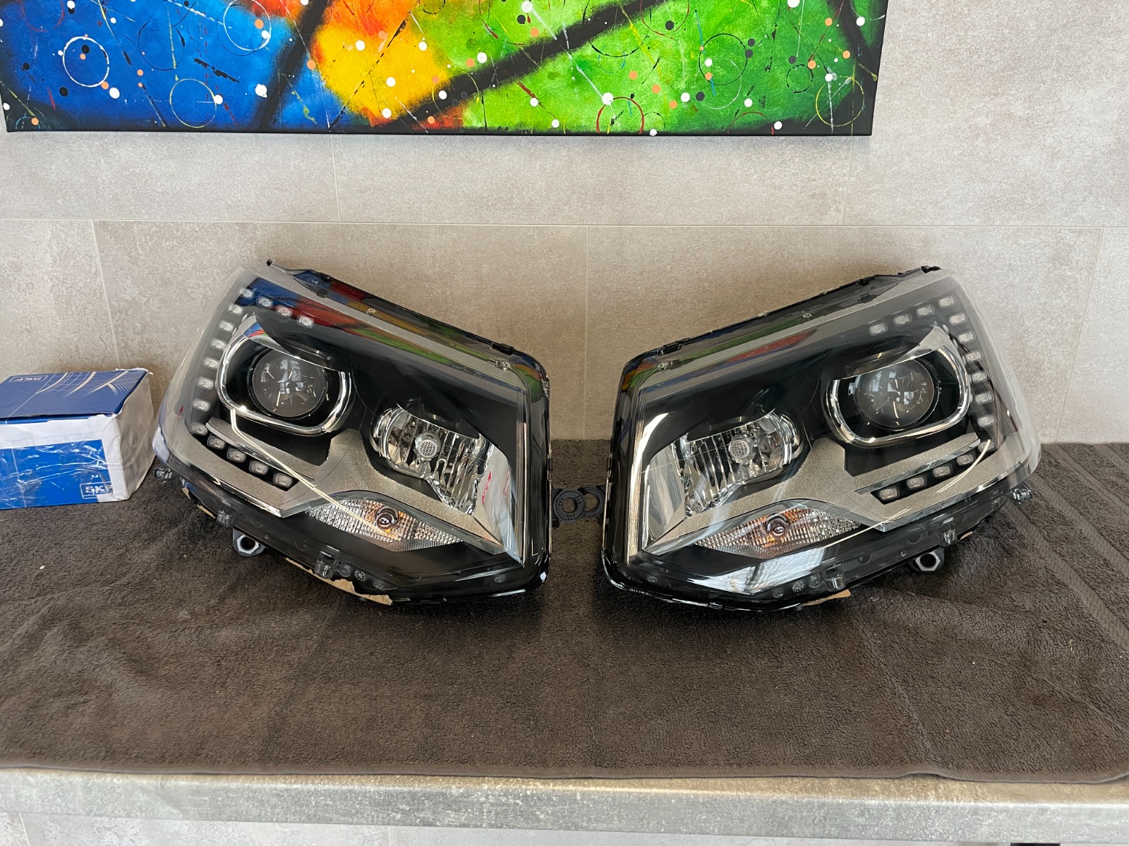

New mod :-
Bixenon headlight + Auto range + headlight washers
Shadow109
Posts: 154
Drives: Vw t5.1 2013
Location: Israel
Re: BCM Max Transporter 2013
Post by Shadow109 »

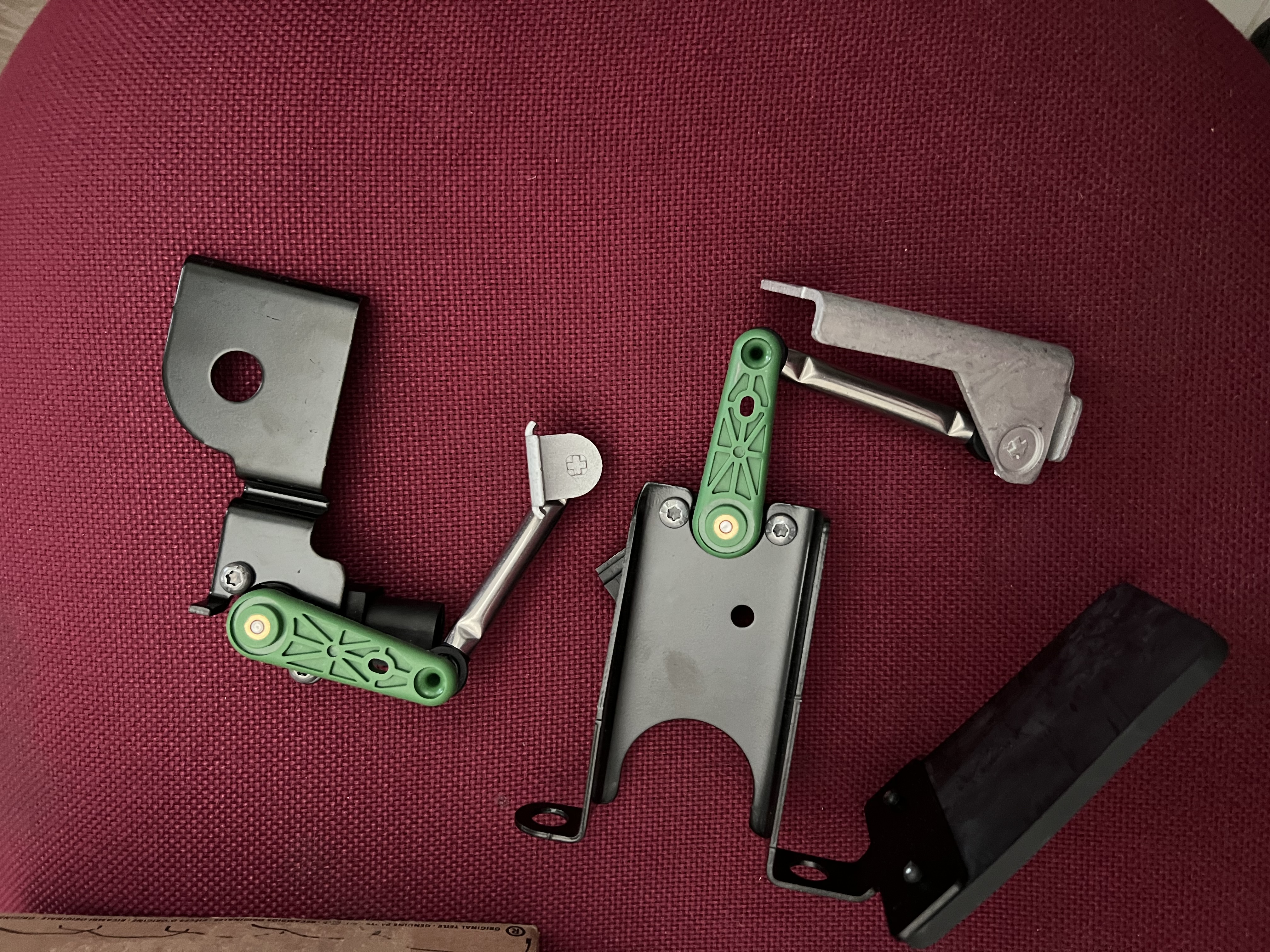

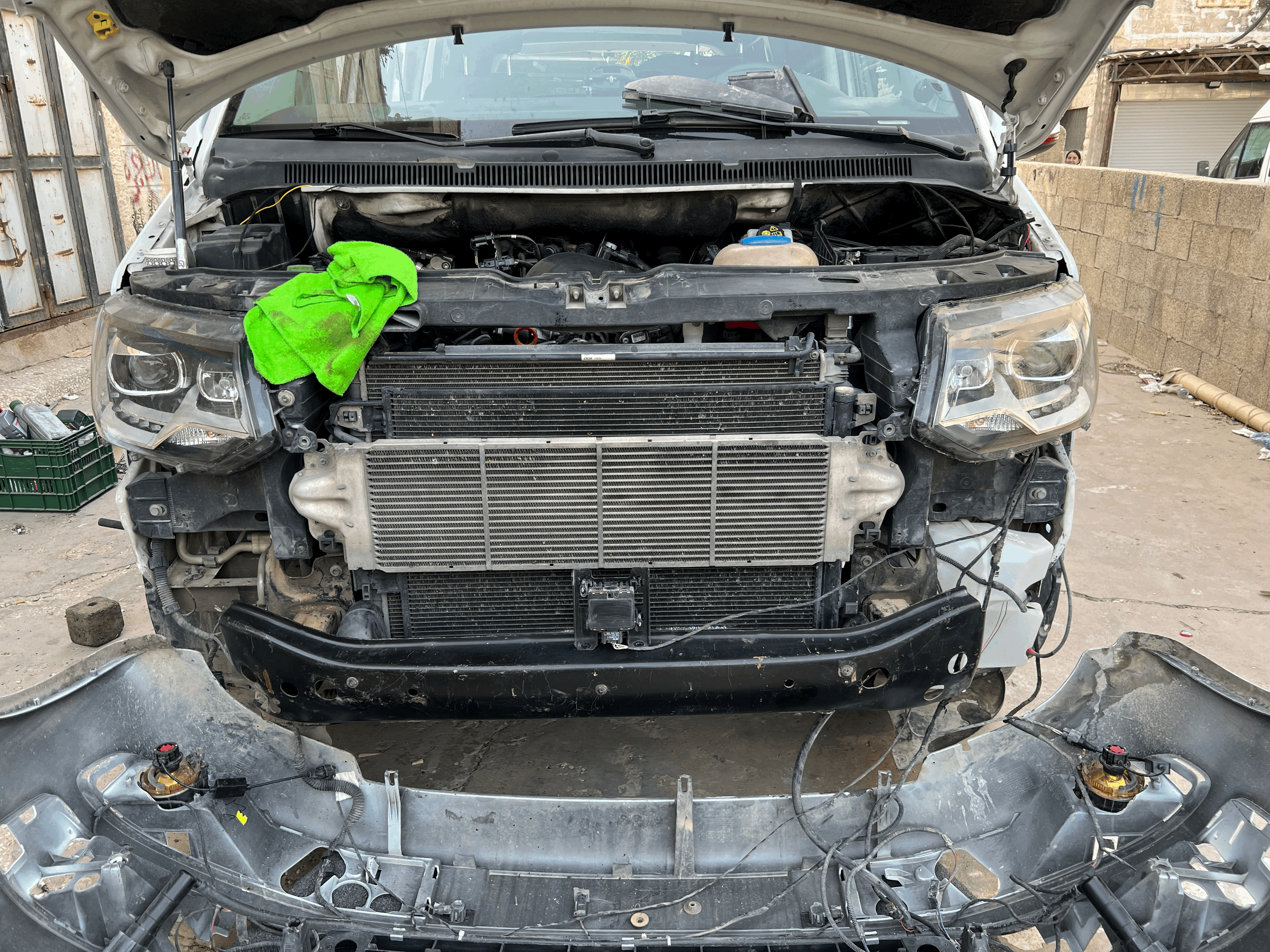

SO.. I have fitted the headlights, added new wires for drl and 58r/l
I still didn't connect the level sensors
everything works as expected exclude the lift HB light
I have tried to swap the bubs, checked all the fuses

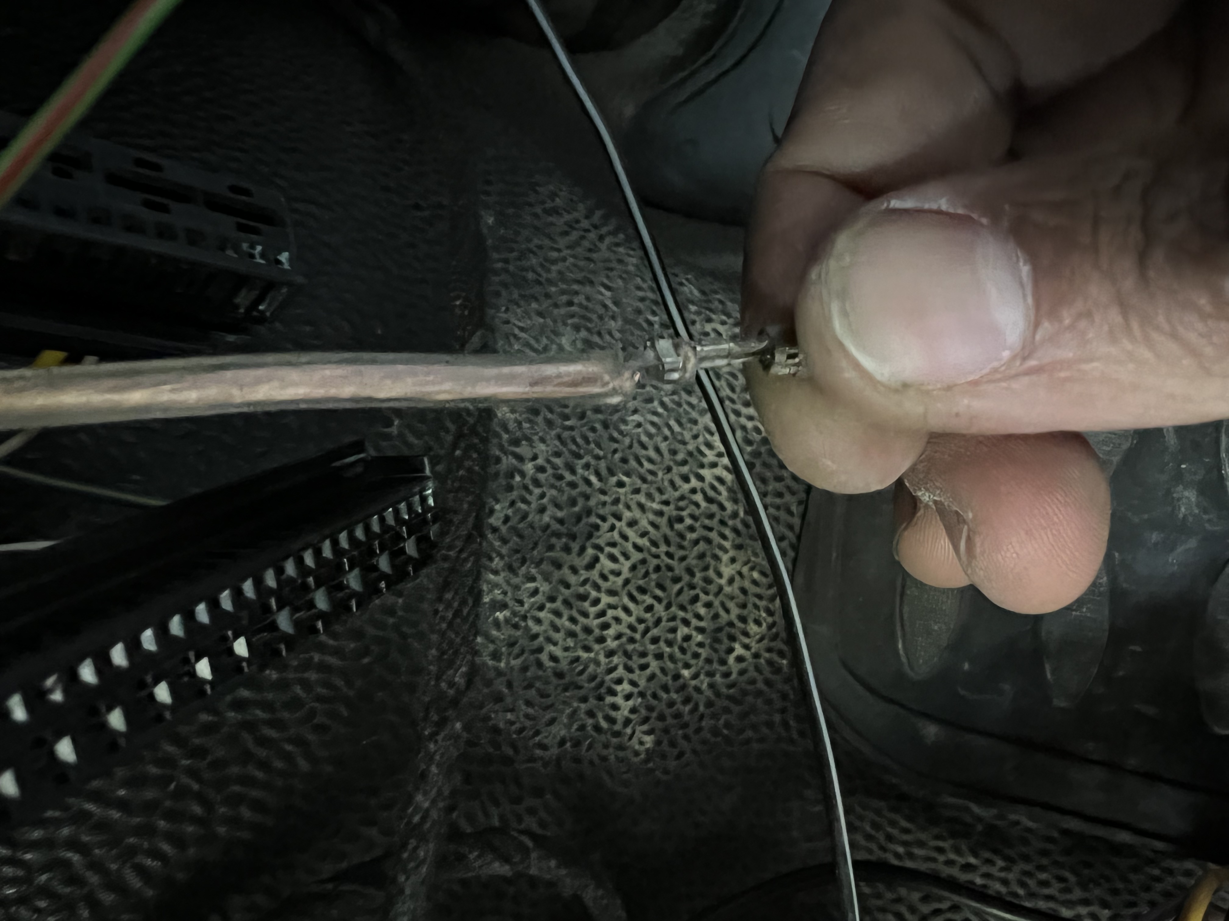

then I checked the wiring diagram for HB light, and I fund that the current is going for HB right and lift to the BCM But the lift HB Current is not going out from BCM
I tried several coding possibilities, then I tried A different BCM, But no success
this is my current autoscan:-

Any ideas ??

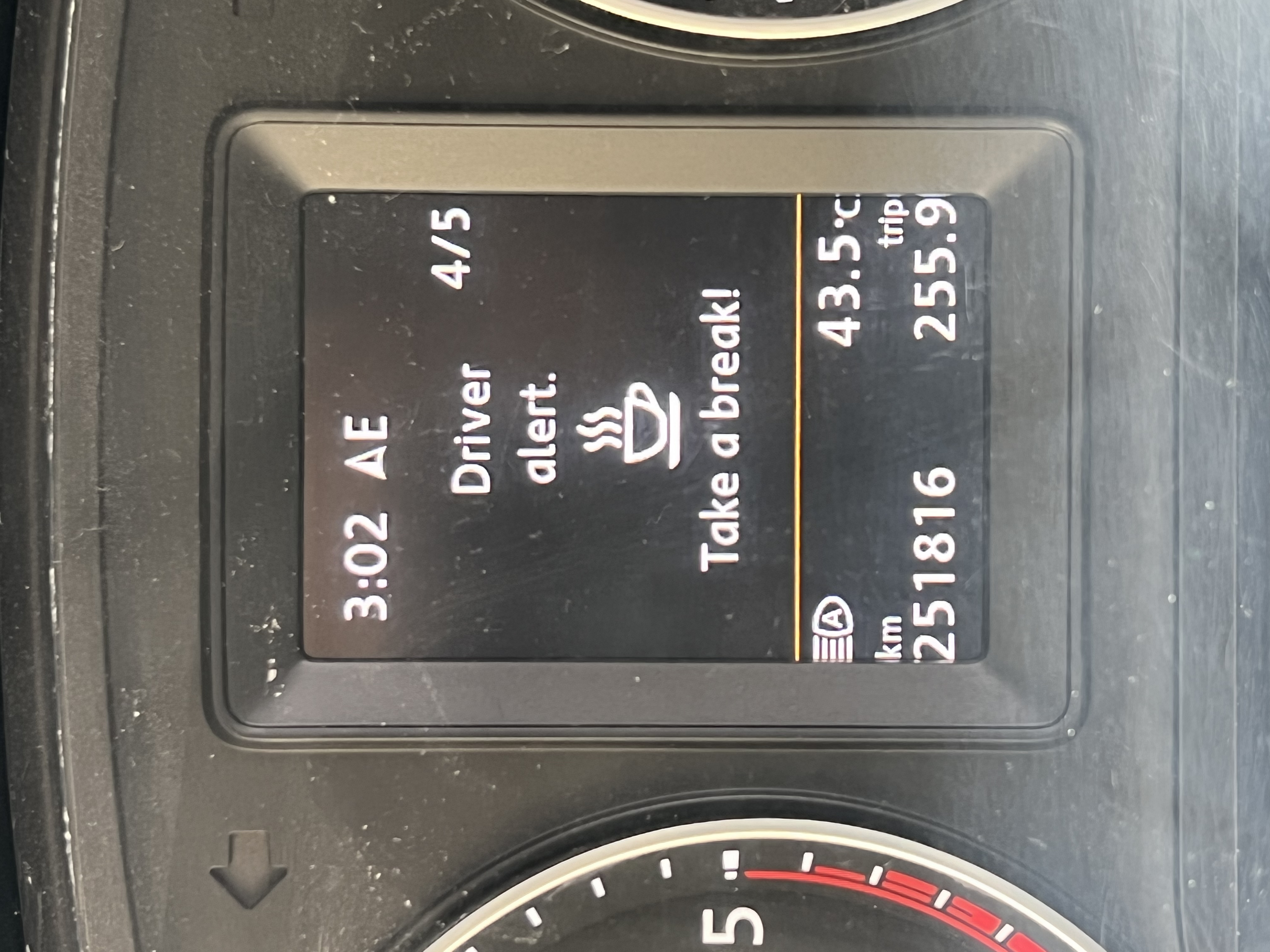

My first time to see the MKE on the new T6 3D cluster 🥰

Shadow109 wrote: Fri Apr 01, 2022 5:32 pm
Any ideas ??
The BCM coding is correct for Bixenon with 'T6 electrical installation' (but you already know that :wink: ).
Assuming that the electrical installation for HB is correct (two different wires from pins T73a/1, T73b/1 --> 2 fuses -- each routed for each headlight -HB-), we cannot draw any conclusions until the level sensors are installed, ... because you already have the J431 unit connected.

So after a lot off digging, I decided to change the wire T73/1a, and the surprise was when I disconnect it from the bcm
after fixing the current wire everything worked like a charm

New mood
6000k bi-xenon low beam
6000k H7 highbeam
6000k front fog lights
and full led rear lights
After coding similar to t6 led coding, I still have 2 faults:-

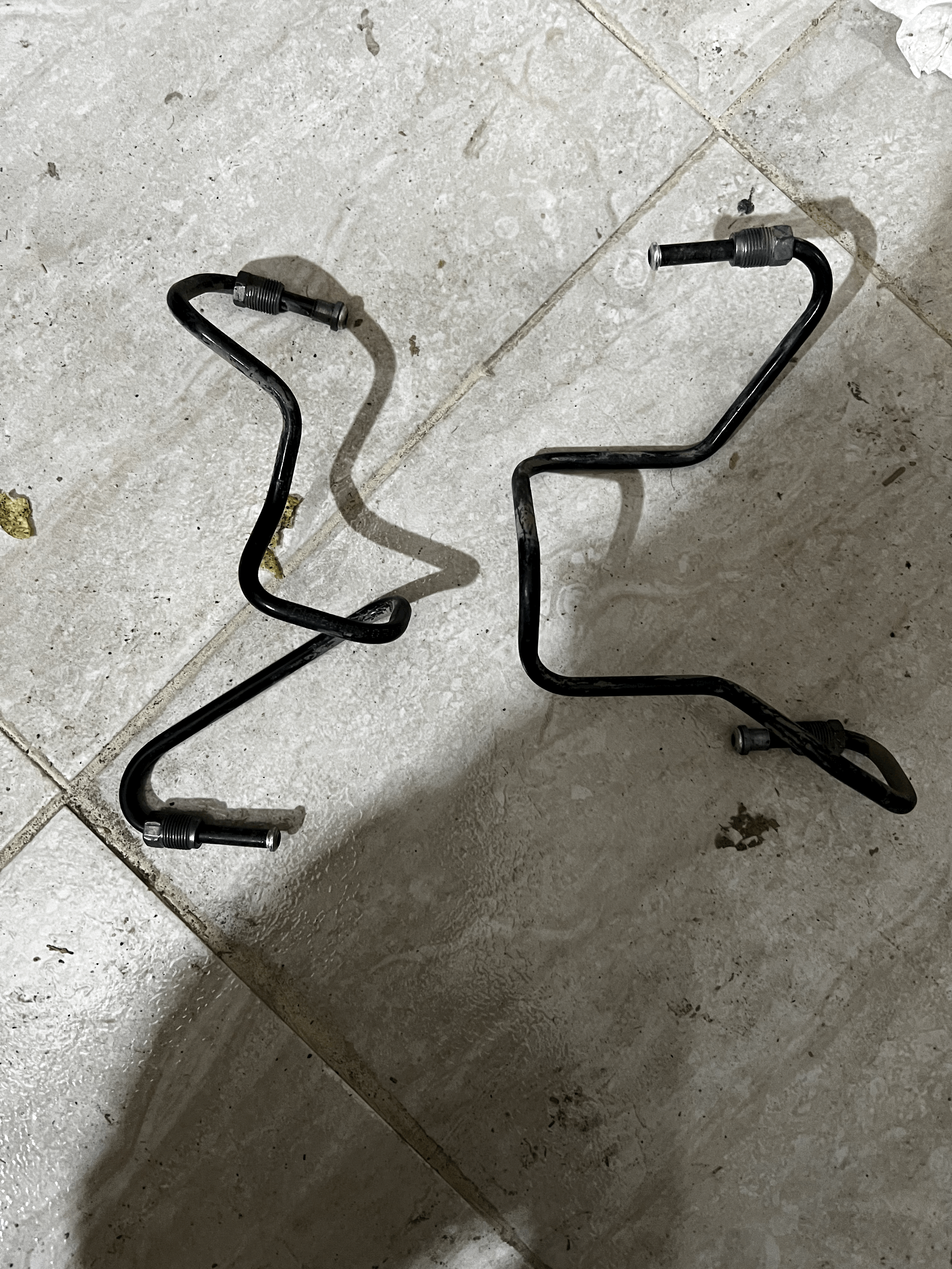

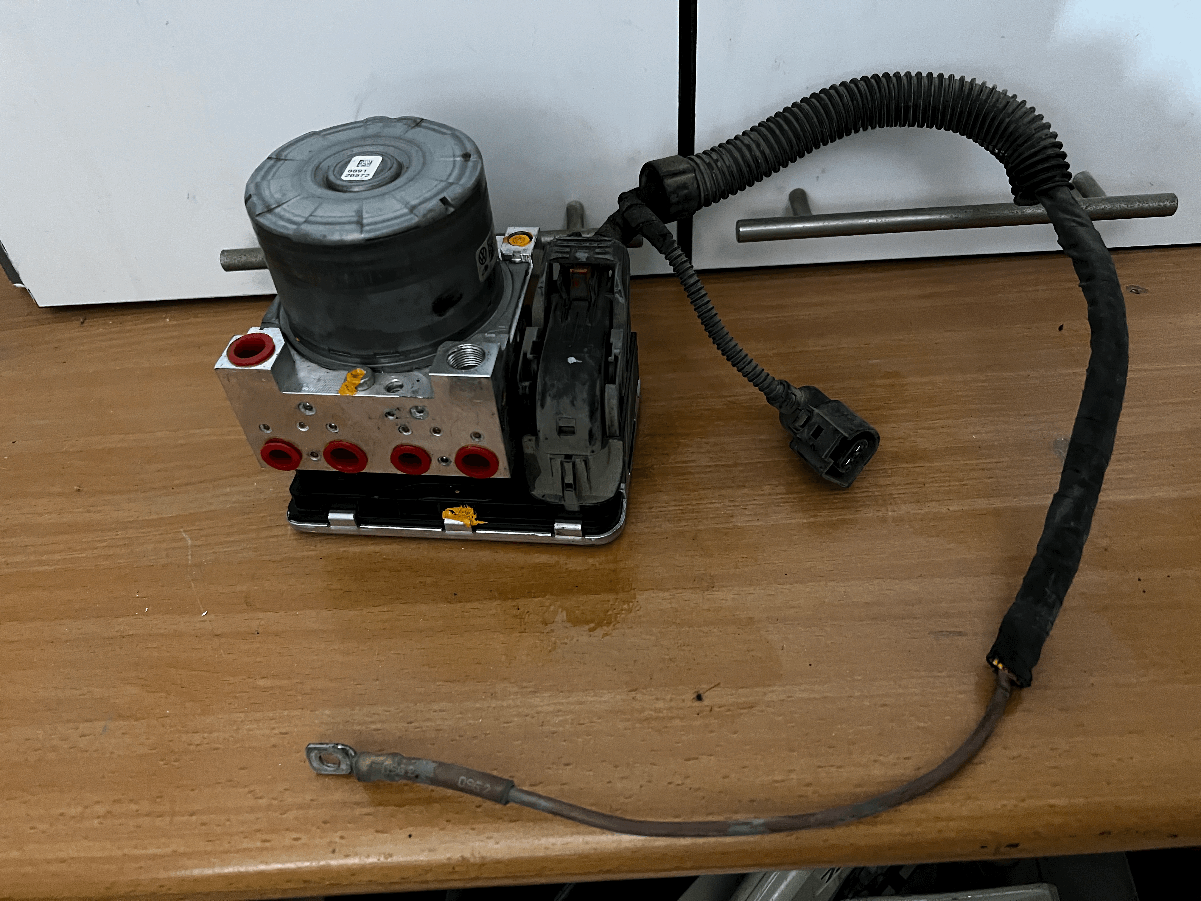

1.parts needed :-
ABS pump with its connector
1 M10 to M12 Connector and 1 M12 to M10 Connector
2 oil pipes form ABS pump to master (used from T6)

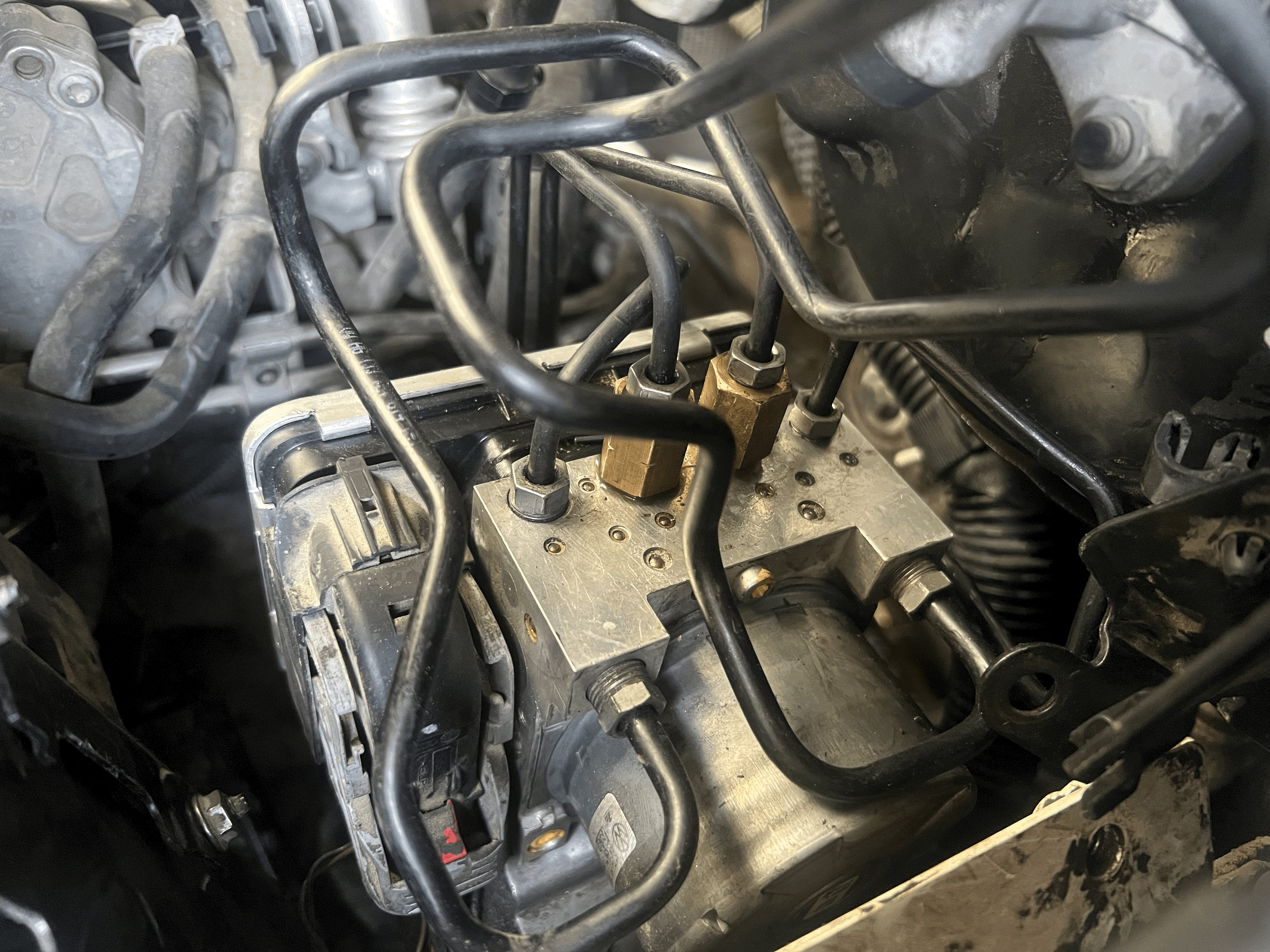

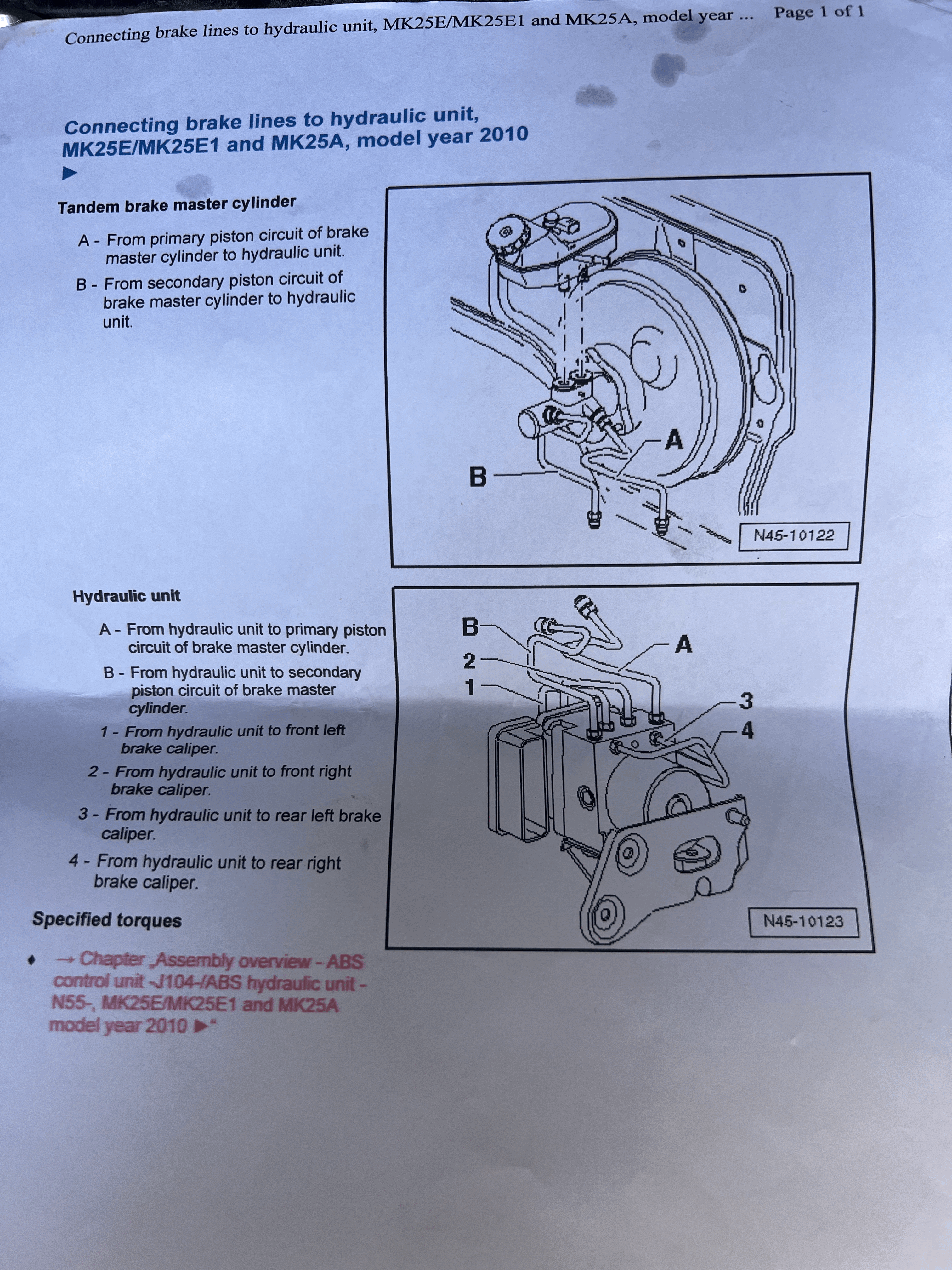

step 1 :-
When changing the ABS the order of the oil. pipes will be different from T5 order, some bending is needed
step 2 :-
repining the wires
step 3:-
coding, I will attach a .clb file that I have made that will make coding the mk100 a pice of cake

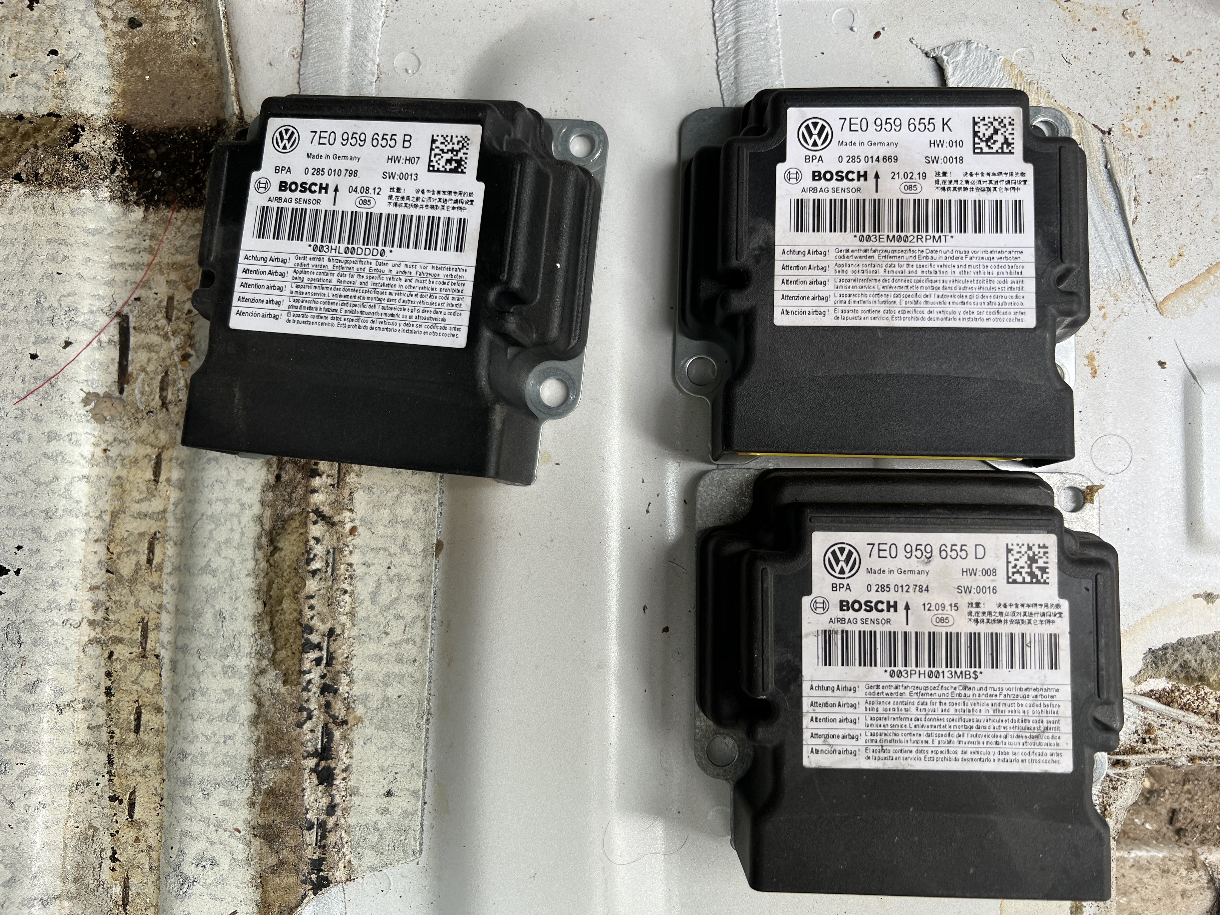

To solve the Airbag fault in the ABS unit I have took two t6 Airbag units from a friend
One is HW08 and the other is HW10
The HW10 seems not compatible with my airbag connector
So I had to stick with the HW08

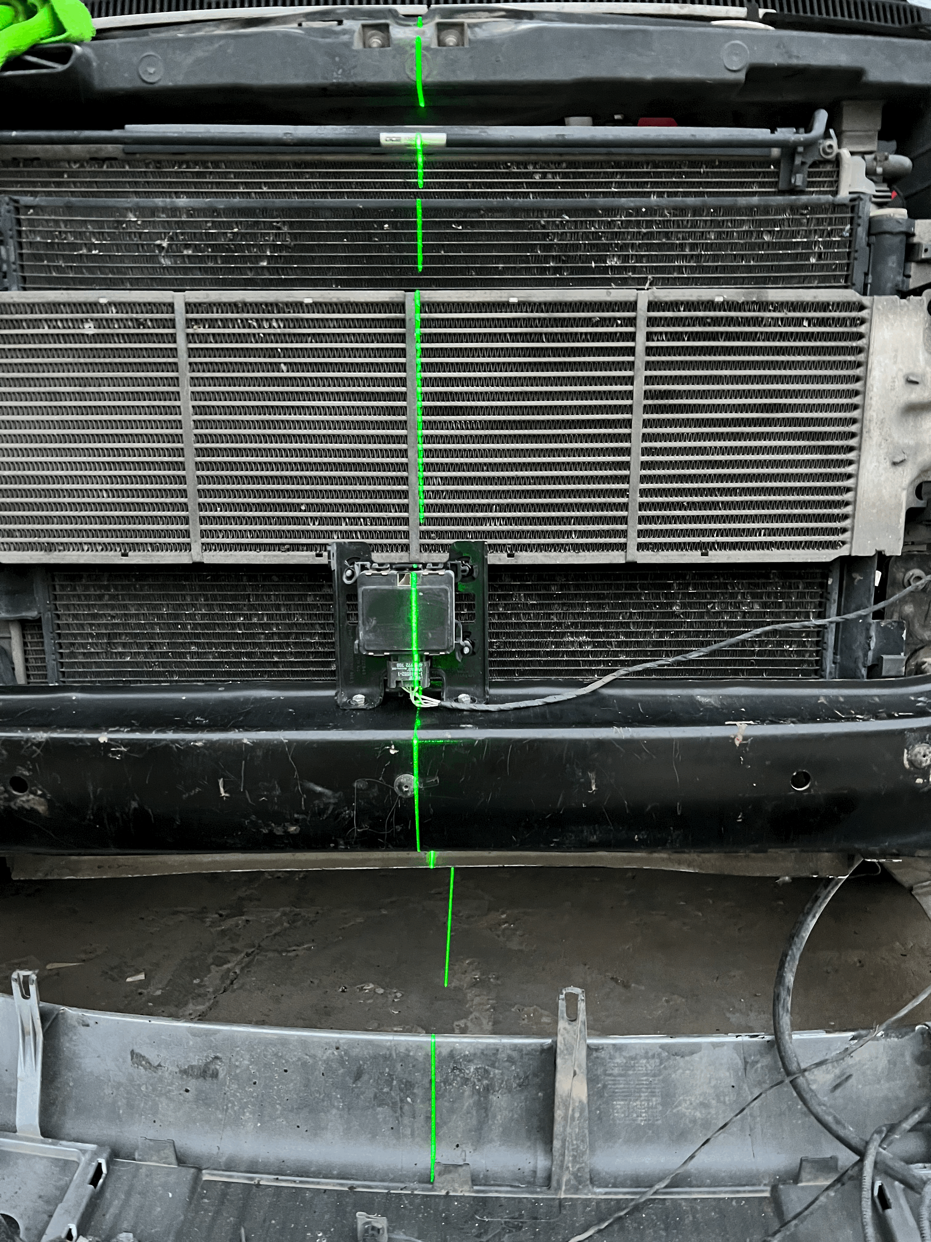

attaching ACC unit in my front bumper :-
until now :-
Radar fitted
ABS changed
Airbag Controller changed
Cluster CP done
ECU patched
CCE removed

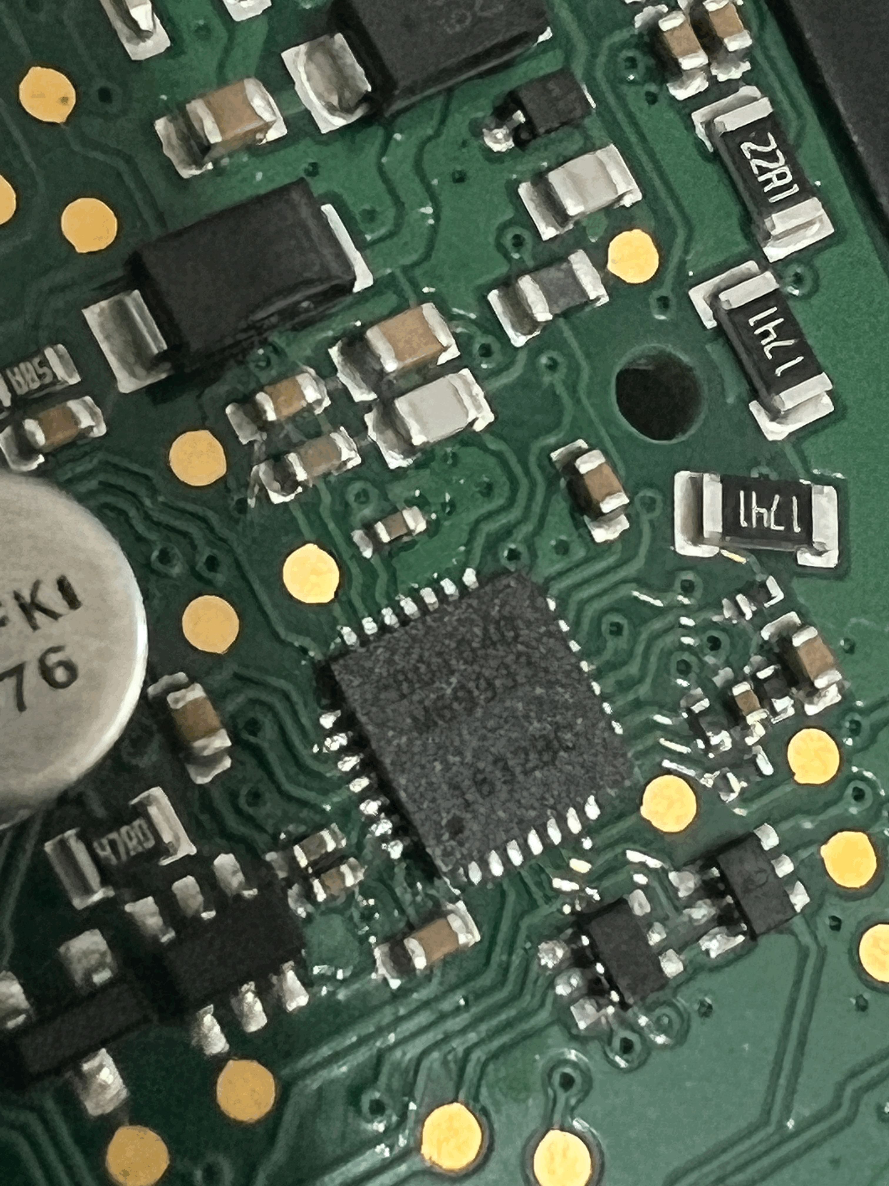

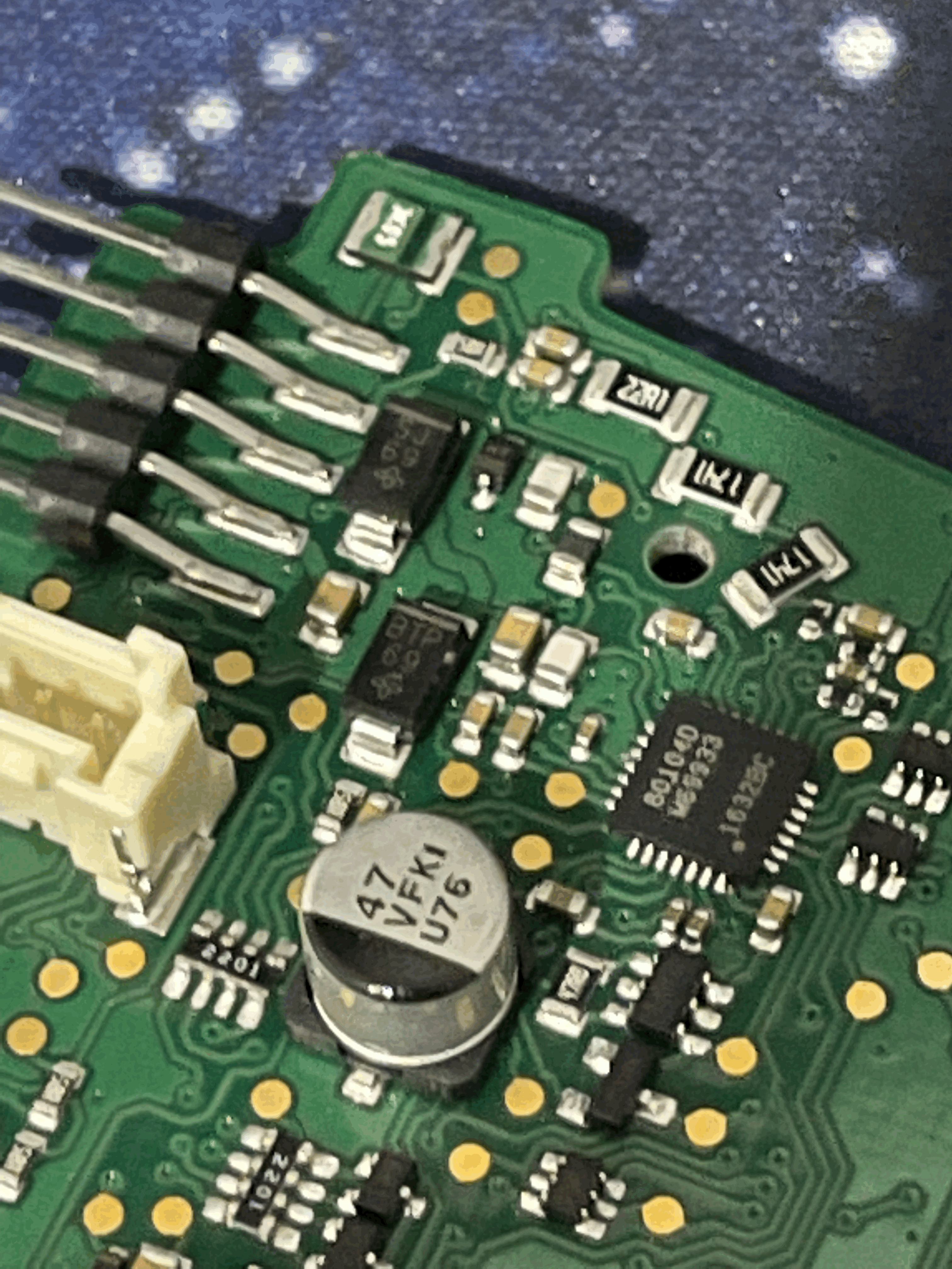

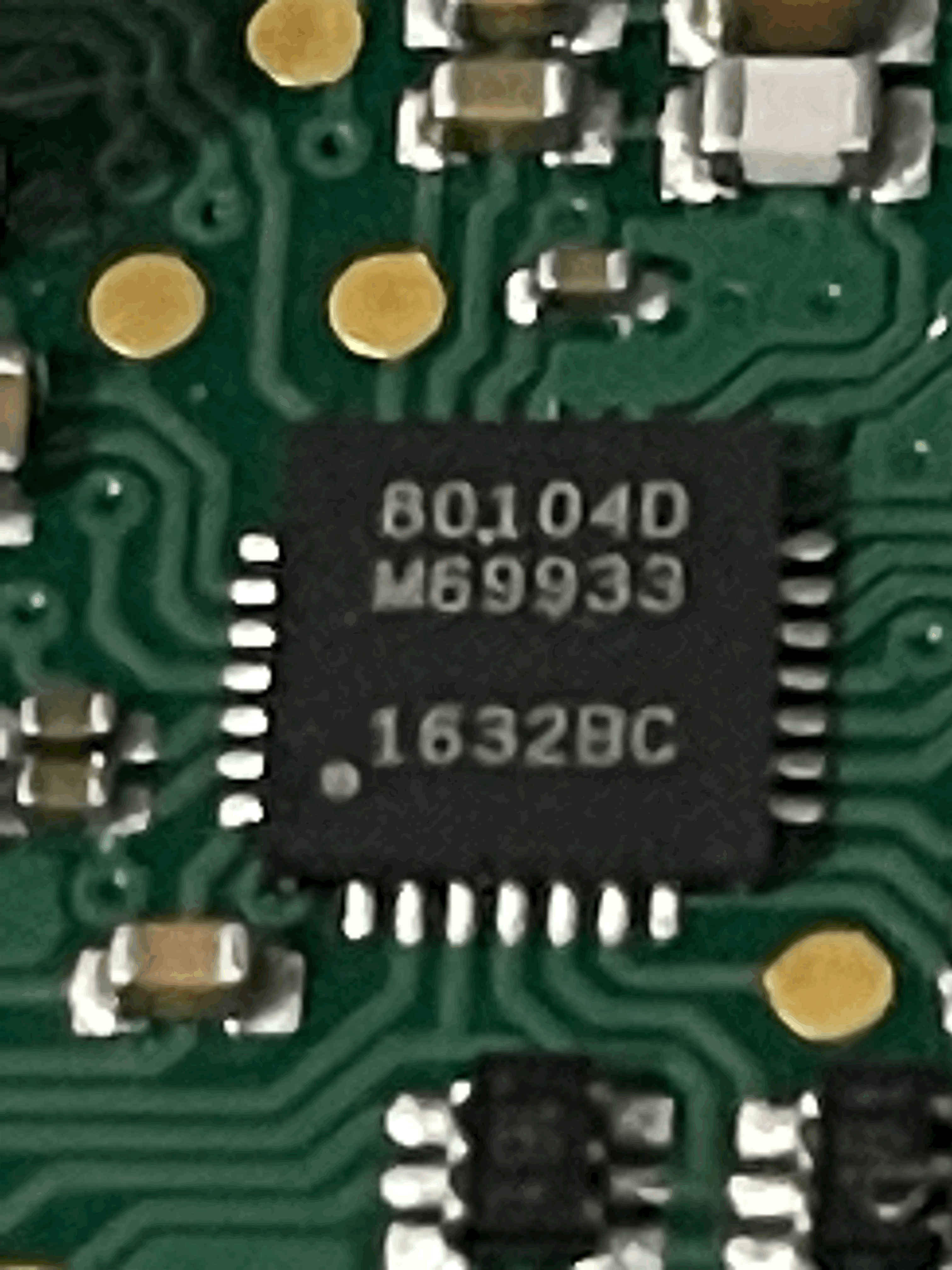

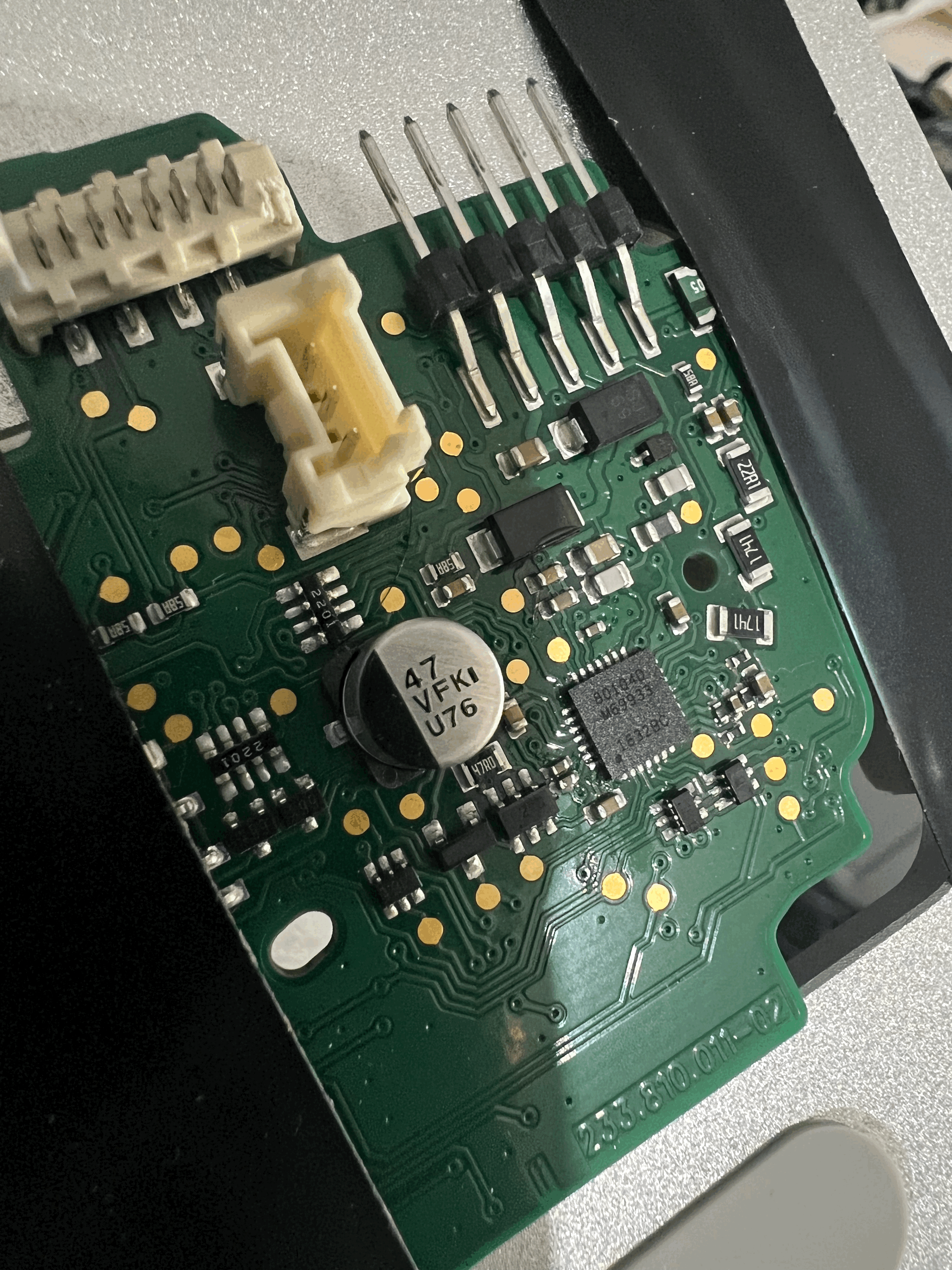

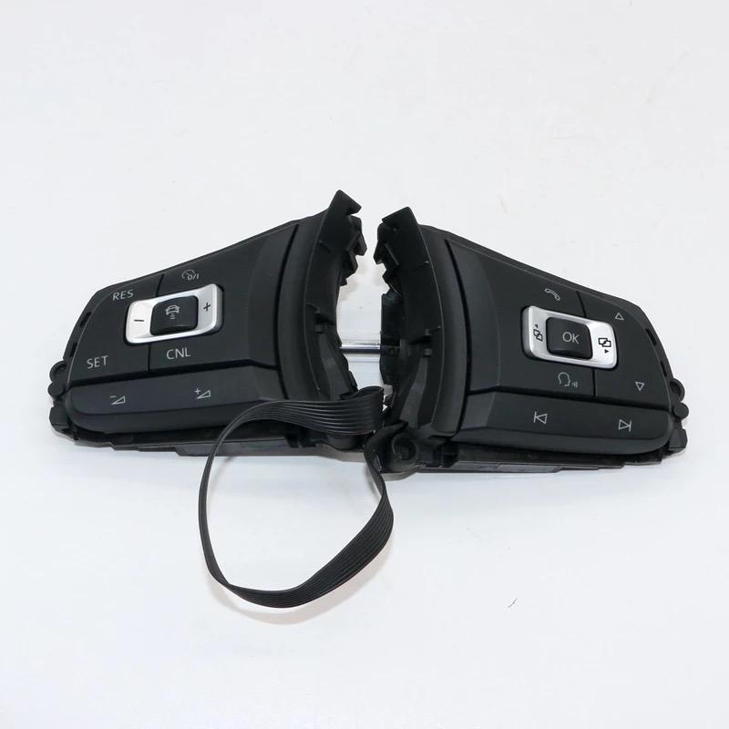

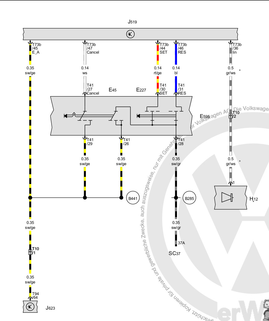

the last mission was to deal with my Steering Wheel buttons, sine I don't like T6 Steering Wheel and I wanted to keep my GTI Steering Wheel, I had to face more issues
First I have moved buttons LIN from T73b/17 to T73b/36
and then tell the BCM by clicking byte 29 bit 6
then modifying CC wiring to match T6
WhatsApp Image 2022-03-08 at 1.46.20 PM.jpeg (111.15 KiB) Viewed 11127 times
WhatsApp Image 2022-03-08 at 1.42.07 PM.jpeg (89.35 KiB) Viewed 11127 times

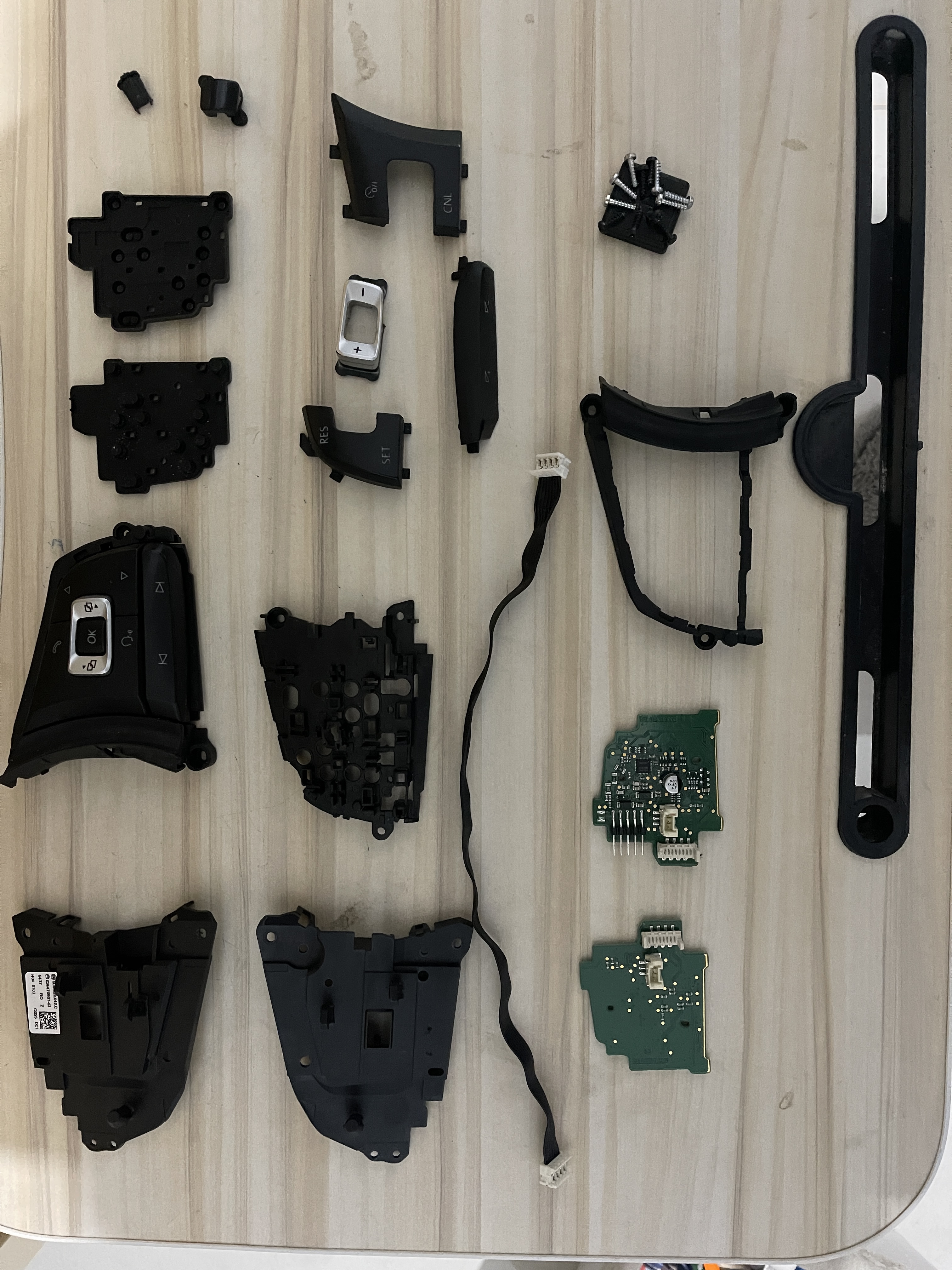

Mainly RGA in in T6 is going directly from ACC unit to the buttons
after these changes we need to tell the BCM by clicking byte 17 bite 2
Changing my buttons to scirocco, hopefully it will work
WhatsApp Image 2022-07-12 at 10.22.46 PM.jpeg (32.9 KiB) Viewed 11127 times
Subsystem 4 - Part No SW: 6C0 959 442 C    HW: 6C0 959 442 C
   Component: E221__MFL-DC1  H04 0103
   Serial number: 29160002125520036437
   Coding: B0FFFF
the buttons seems to respond in 01 measurements, but still have faults in engine and ACC

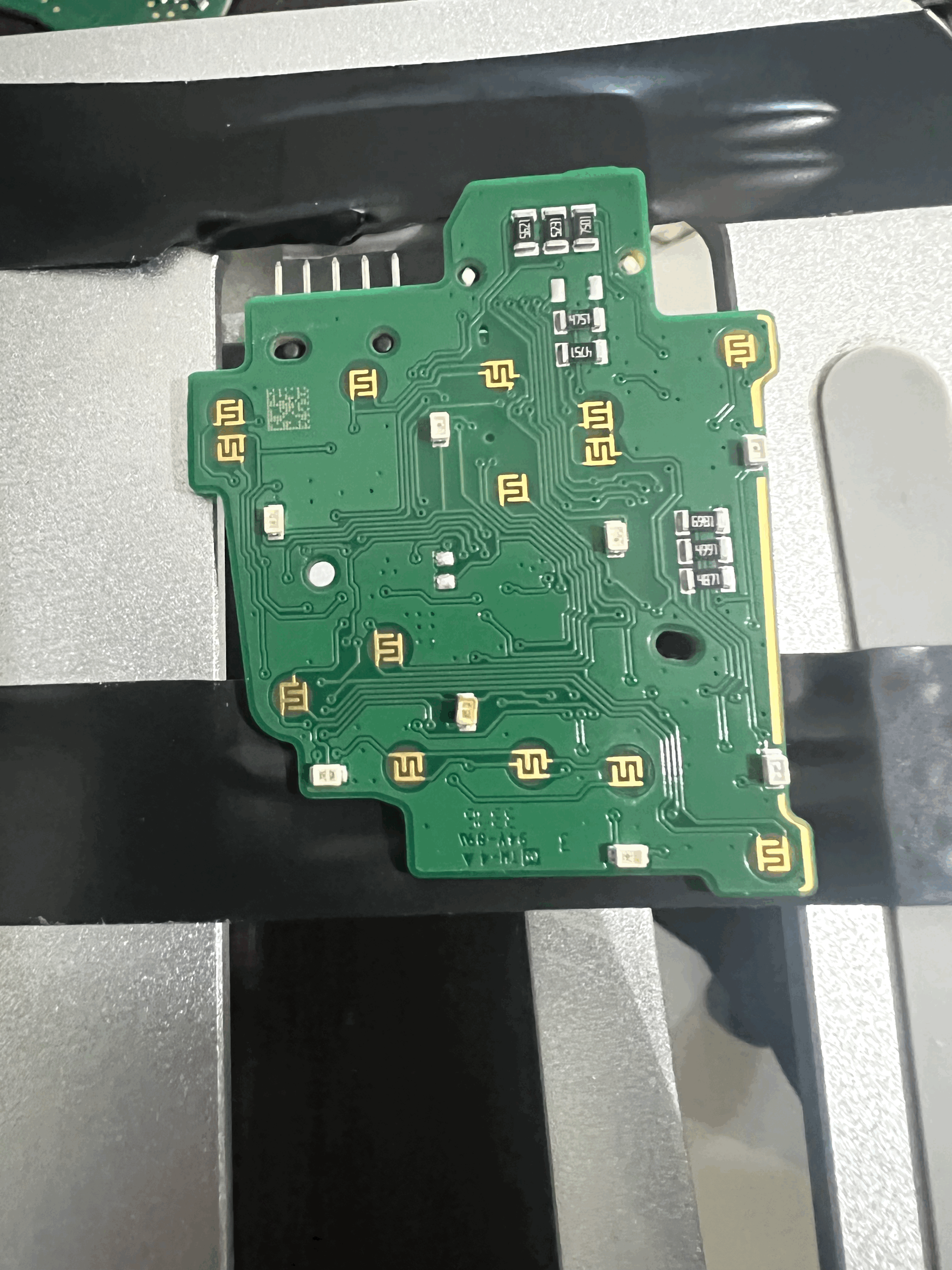

I tried to change the buttons coding to match T6 buttons but still with the same faults
my last chance was swapping the Buttons IC
finally Everything works like a charm 8)
